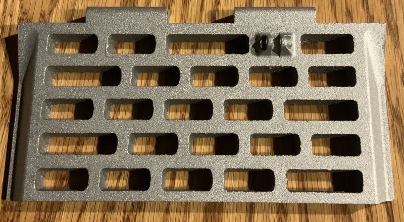

Looking at various photos, both on the web and here in the forum, it appears that the smaller engine deck grates have variable patterns. Were there a couple different patterns for those grates during the production cycle?
I see some grates, the smaller ones are the ones I'm talking about, that seem to have a pattern of smaller cutouts on the edges than the plates that came with the 2023 kit. My grates look like this:
Note how all the oblong holes are pretty much the same size.

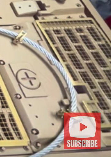

The other form I have seen has smaller oblong holes at the left and right edges. Here's a screen capture from a video that was posted to YouTube by a builder here:
Note the small holes at the edges of the grate. I've been unable to find a good, clear overhead shot of the real grates on an early Tiger, so I'm wondering which is correct.
Are the grates included with the 2023 kit in the right pattern?
Thanks!

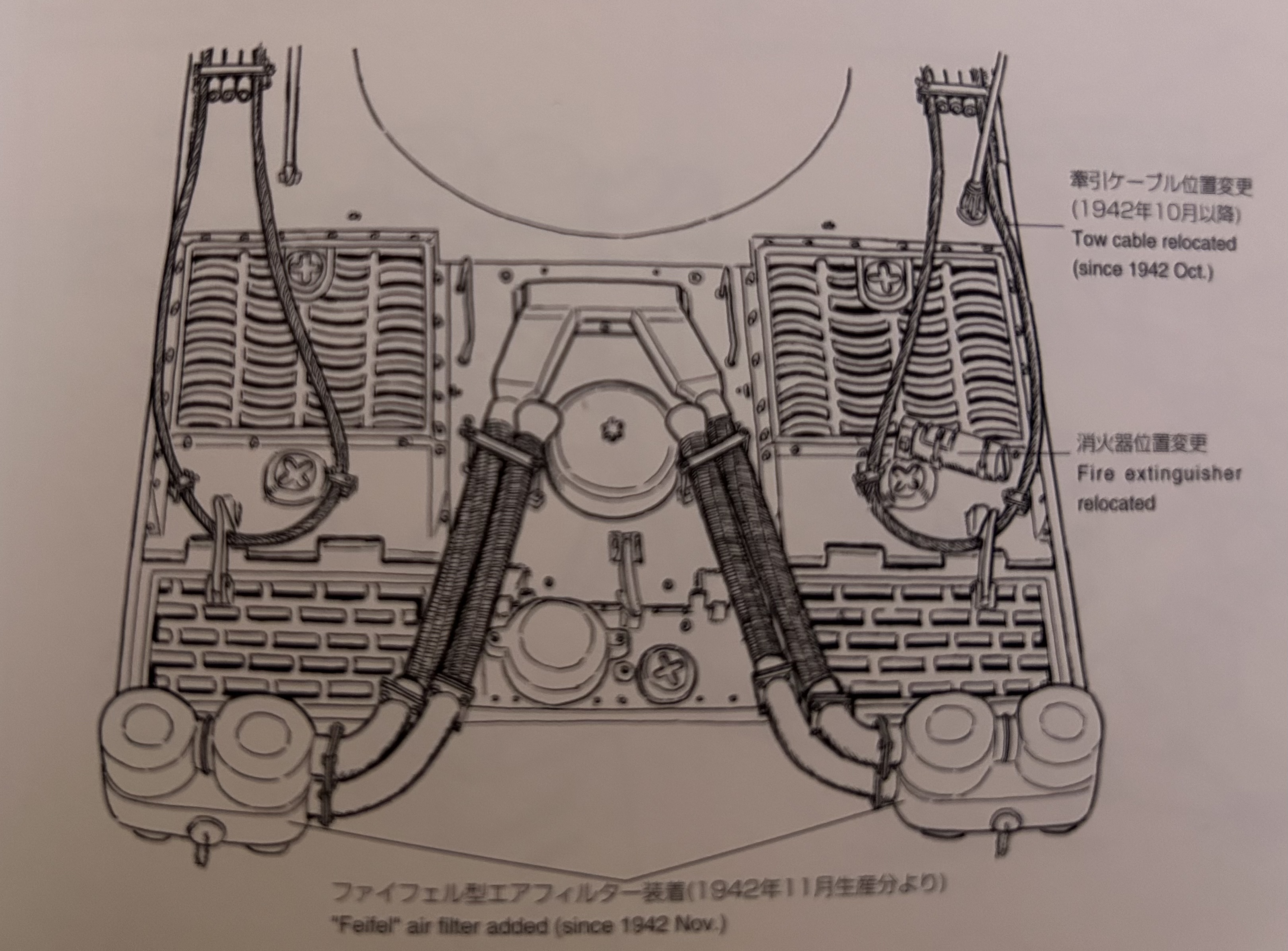

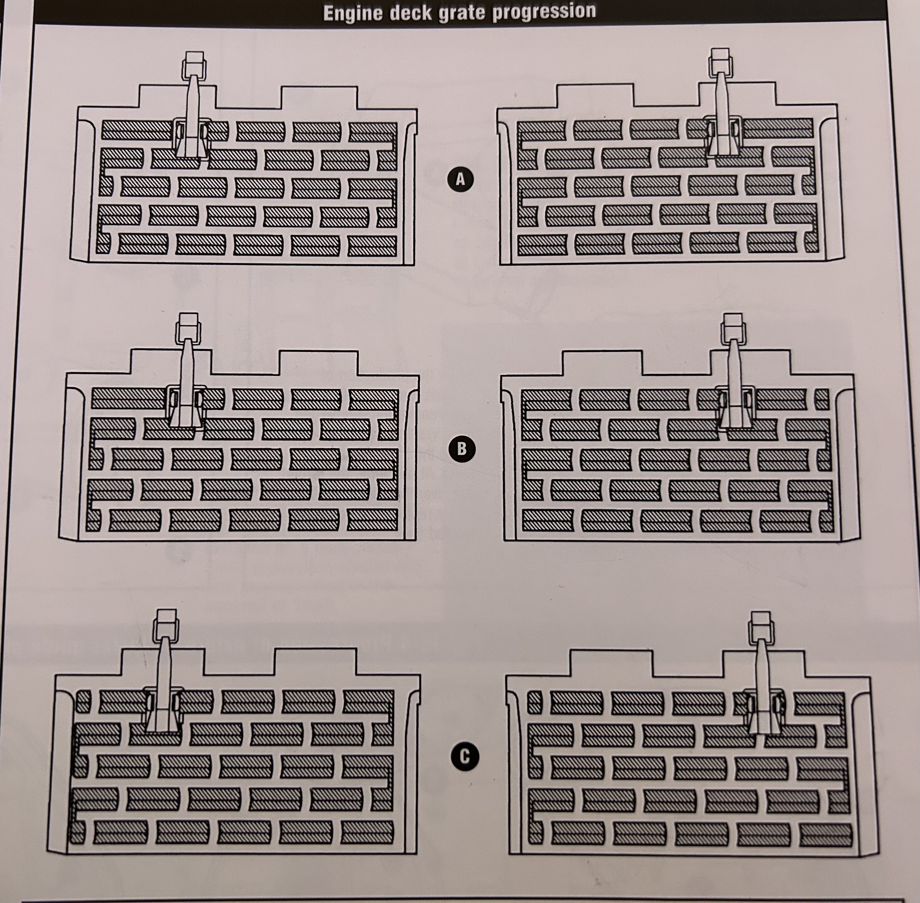

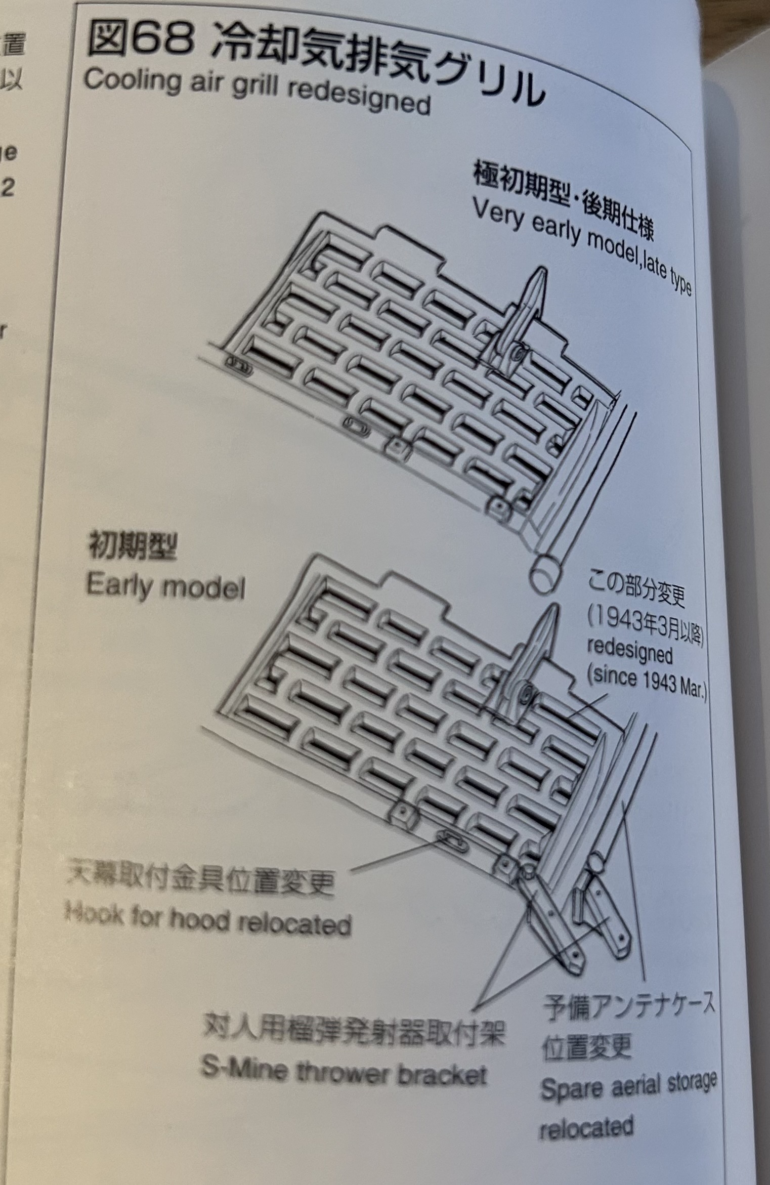

The grills changed a bit over time.
Here is the progression according to The Modeler’s Guide to the Tiger Tank. (Try finding a copy on eBay. Good basic book for working on the Tiger.)
A: The initial engine deck grates were designed as mirror images of each other with a slight variation on the left hand grate.
B: In January 1943, the right hand grate was slightly altered as shown.
C: To simplify production, as of April 1943, the grate casting on the right was reworked to match the one on the left.

Casting those grates is more difficult than it looks. I've done them in a smaller scale. In aluminium it's next to impossible as a simple gravity pour at least not without a ginormous gating and vent network; a little better in bronze and I'd imagine slightly better in grey iron. The interrupted bars of the original, if one wants to replicate that makes it even worse from a metal flow perspective. Then there's the logistics of pulling a pattern (or match plate) from the sand, if you're an old fashioned traditionalist like me. Investment casting would be the best way to go but costly. They can be done I'd imagine with a CNC or 3D print process but the look and feel of a casting isn't there. Those small holes on the ends make it worse.
I'd say that 2023 part looks pretty good to me. Not having a kit I can't check but from what you've shown it looks like a grey (cast) iron part; pretty cool
I'd say. Hadn't known the Armortek elves had done that. Kudos.

Yes, definitely cast and I do like the look of them. I was just curious about the patterns, as I couldn't find any easy reference material online. Not a lot of overhead photos of the engine decks. The few things I could find showed that pattern with the smaller cutouts on the end. I was looking this up so I could determine where I needed to cut these grates to create those interrupted bars.
