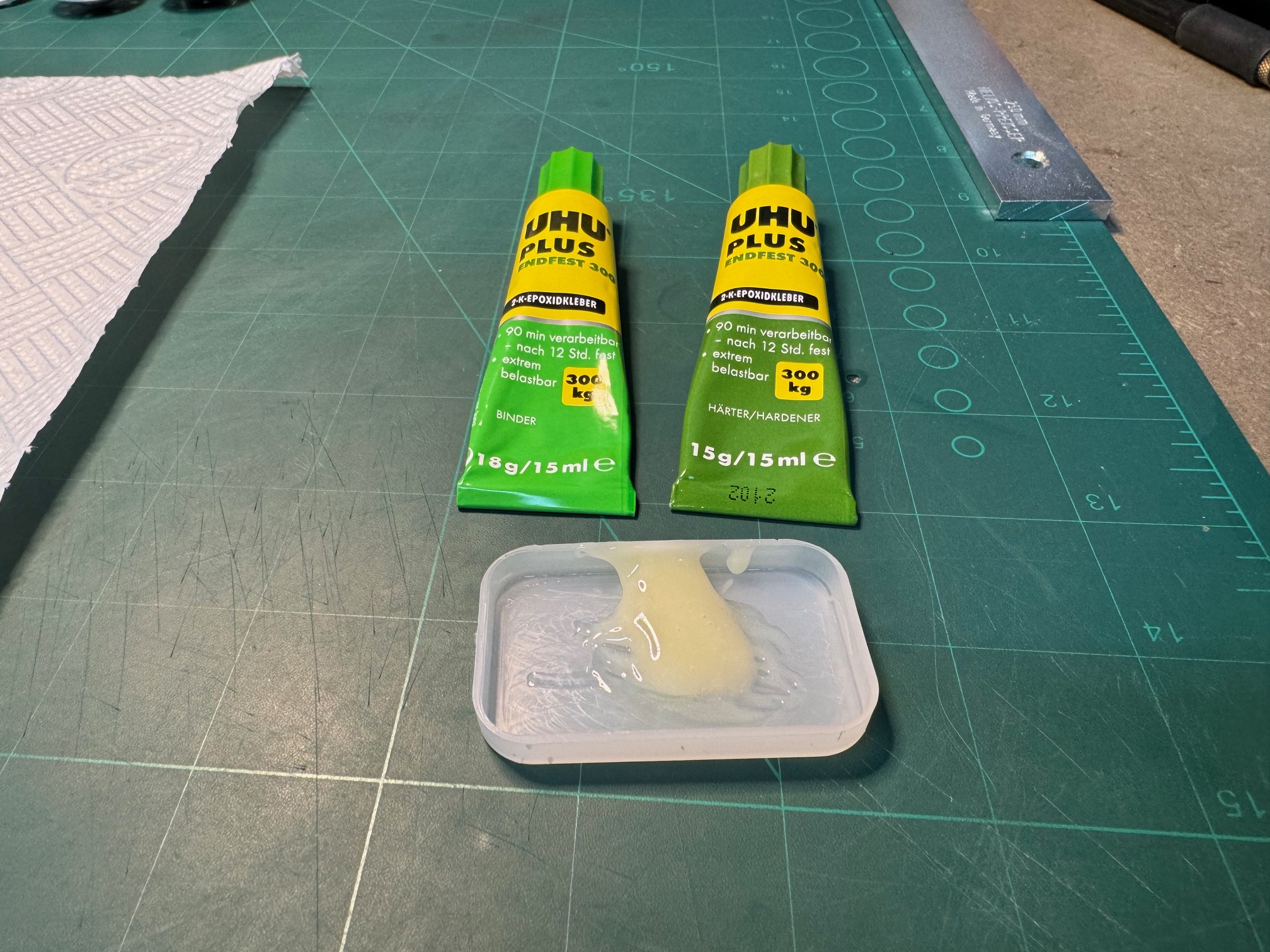

I have just used the alternative slow cure 2 part epoxy on the tyres of my Panther G.
No mess and plenty of time for adjustment.

Malcolm.Plumb
Posts: 243
Has liked: 454 times
Been liked: 920 times
Re: Rubber wheels
Post by Malcolm.Plumb »
Hi Bryan
UHU plus Endfast 300 is the epoxy that I have used.
https://www.uhu-profishop.de/klebeberat ... klebstoffe
Seems to be easily available over where I am but not sure about the US.
