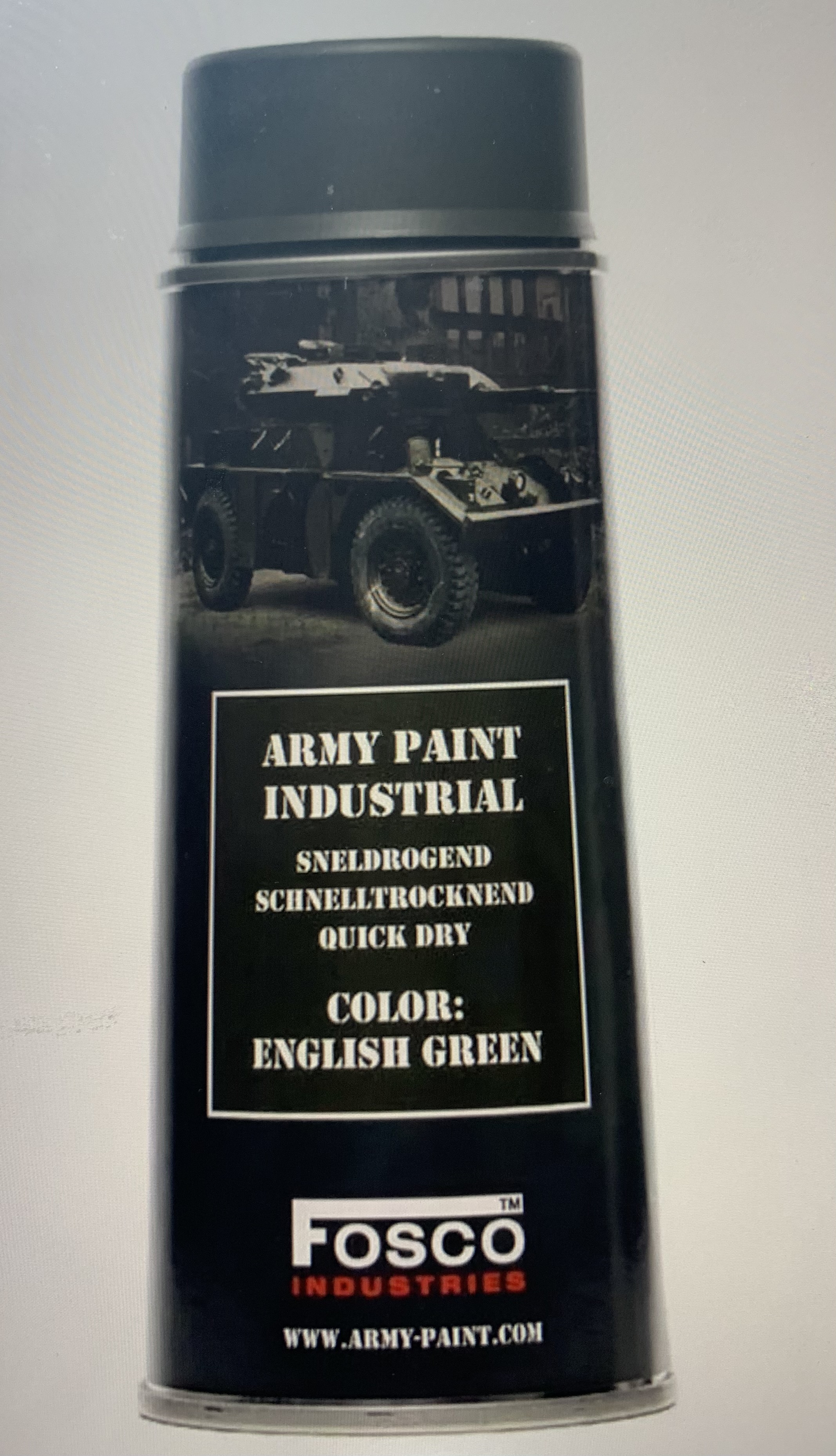

Hello hello Churchill builders.
Having completed my Tiger 1 late variant build I’m now about embark on my new kit of the Churchill Mk3.
Have any of you settled upon the correct shade of green to paint your Tanks? I read that the British Army used a different variety or even varieties of Olive drab. I see that Epic Militaria sell a colour called English green. Would this be close enough?
As you can see I’m finding it difficult to find a supply of a definitive shade so I’m turning to you all to see what conclusions you came to! Cheers & what Ho!

Hi,
I use English green on both my Churchill tanks, probably not quite right but I like it.

Thanks David.
I was thinking that might be the route to take.
I mistakenly used Humbrol paint on my Tiger 1 build which cost me a small fortune in small spray cans of 150ml each. At least these cans come in bigger sizes for the same cost per can!

Hi Gary.
Thanks for the in-depth information.
I’m probably going to go with English green as it’s cheaply priced and available. As time goes by I’ll tweak the finish to suit but for now it’ll do until I decide upon a finished look.
Cheers.
Chris.
