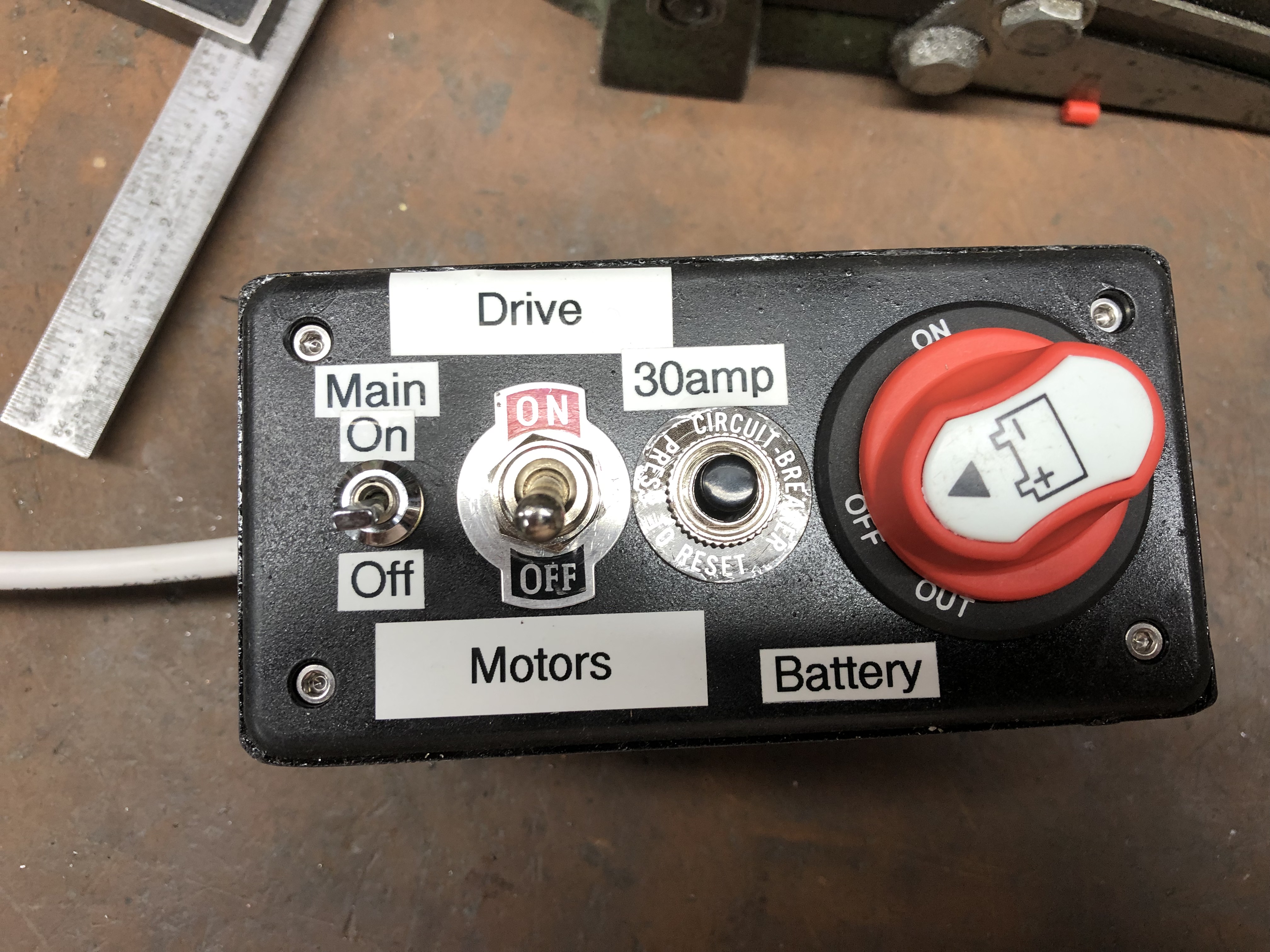

When I built my Lee I made a 'control box' between the battery , a 20Ah LiFePo4 pack in my case and the Armortek electronics.
The box has:
Other builders with say a circuit breaker with a greater capacity is required for heavier models and I can't argue that.
For my King Tiger presently in the work I plan a similar control and I'll likely use a greater capacity circuit breaker.
I've found the ability to disable the main drive motors handy when testing the rc system functionaility so I don't have to worry
about bumping the throttle. Yes I'm clumsy at times.
The box has:
- cut off switch
- 30amp circuit breaker
- drive motors cutoff switch- to enable testing of other functions with out the drive
- relocated Armortek main switch

Cool box Jerry - Great idea. Would prevent runaway tanks when power applied! Could save some "hurt" later on.

Jerry,
Really like your control box. Very nicely done. I wanted to do something like that in the M26, but just could not find any room to consolidate everything in one place that was easy to access through a hatch. I understand that the German tanks have a lot more room in them.
-Ray
-Ray
