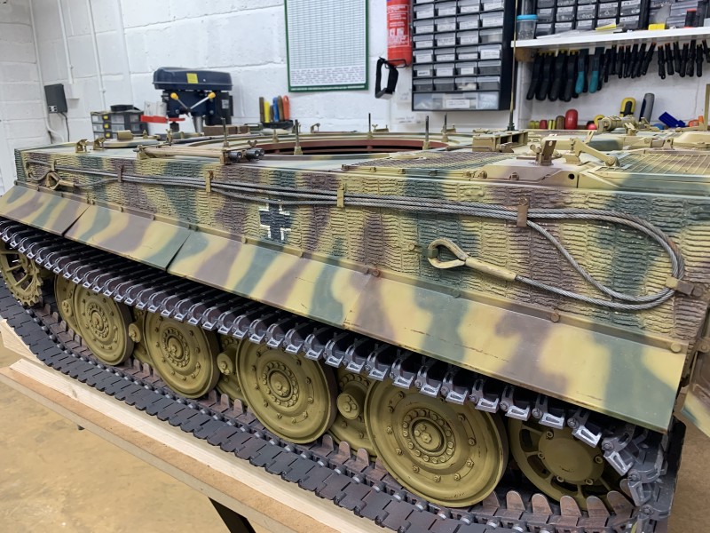

Hi Mark
For my late Tiger I used a blow torch on the cables which removed all the shine and 'aged' them. I did then add some dirt and light rust dragged on with a cloth. I believe other have used the blow torch method as well.
Gary

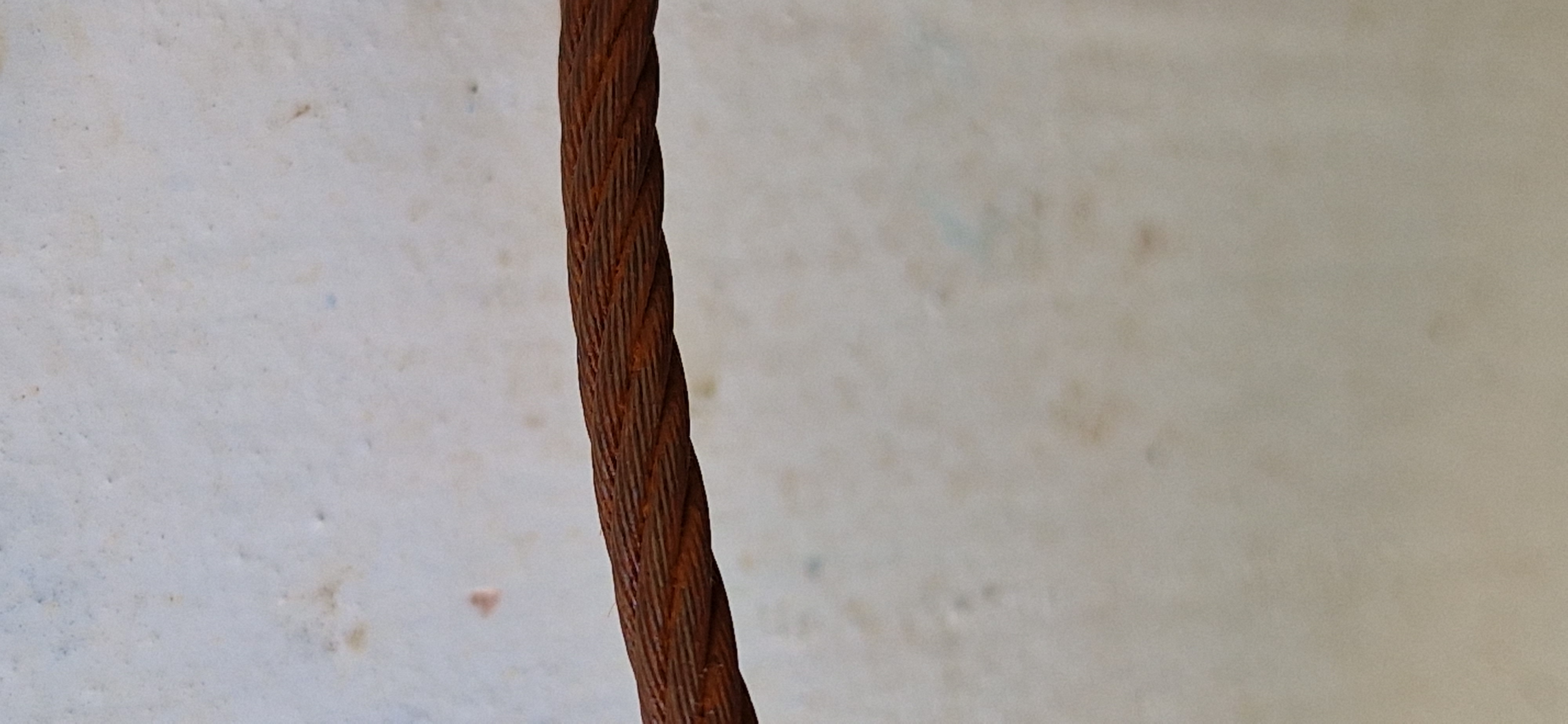

Hello
I use normal vinegar 60 euro cent a Liter, put them 2 weeks In a bucket and 1 day in the rain.
With Regards William
