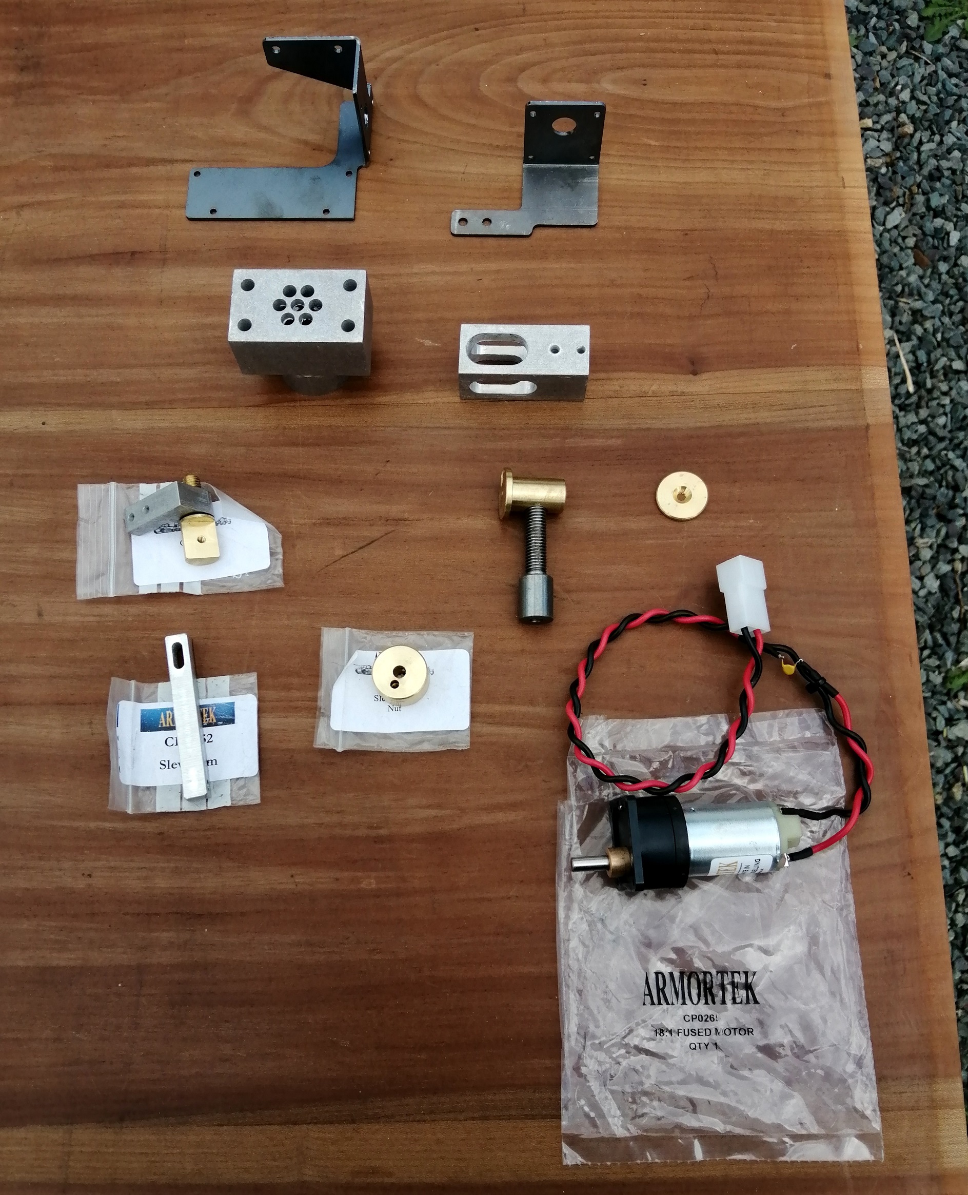

After much searching of the spares store, Monique had managed to find all the parts needed for elevation and slew and the small package arrived in Normandy 3 working days later – despite the Easter weekend being in the middle. So many thanks To Monique and the team for getting the order despatched ahead of the Easter break and to UPS for their normal super efficient service!
Of course, with the tank no longer on the bench, I was having to work on hands and knees on the floor to do the aforementioned repairs/ modifications which was no fun at all. Not possessing an elevating platform (one is now on order!), the prospect of working on the gun system did not fill me with the joys of Spring. Additionally, with the model fully assembled, access to the gun mount was going to be restrictive to say the least so I removed the whole unit and made a plywood mock up of the glacis so one could work on it at the bench.

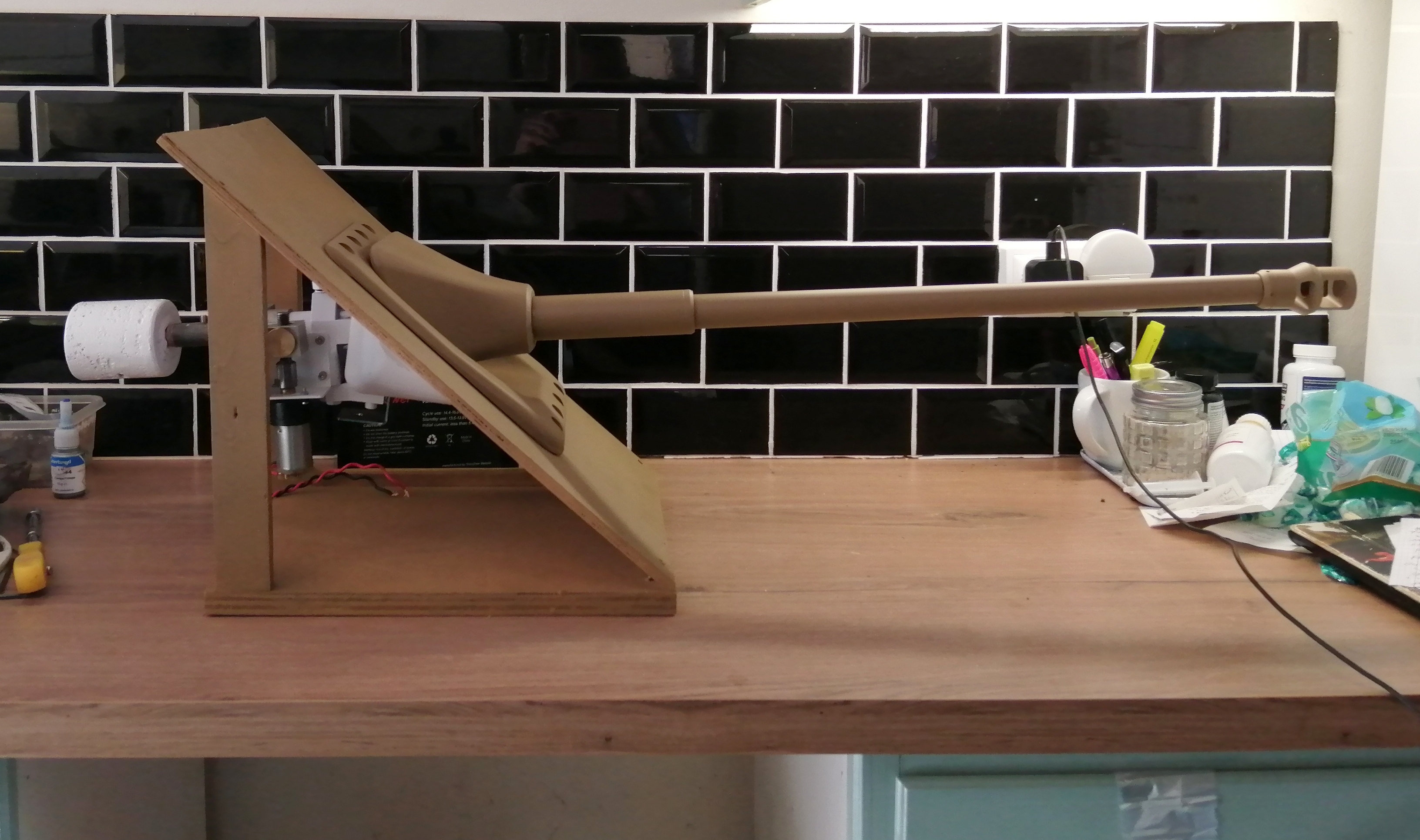

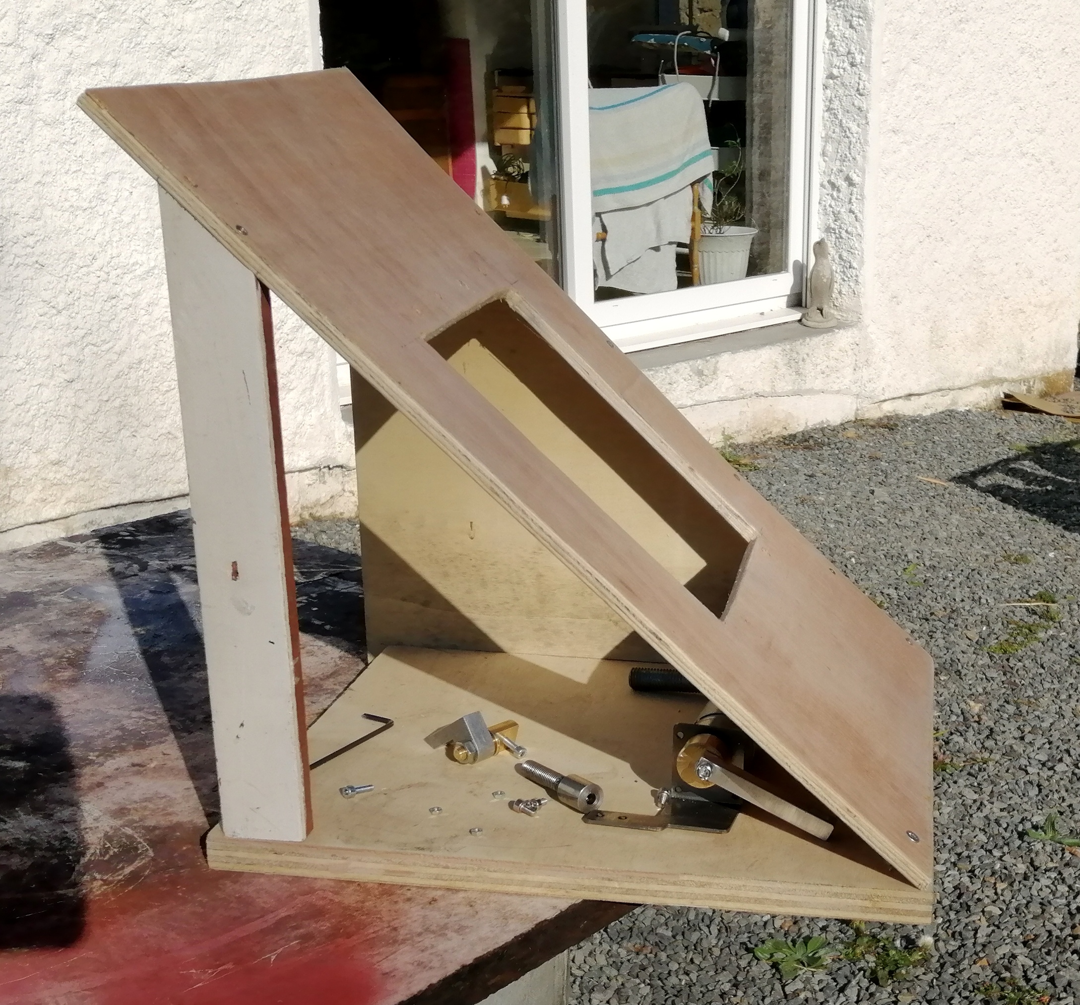

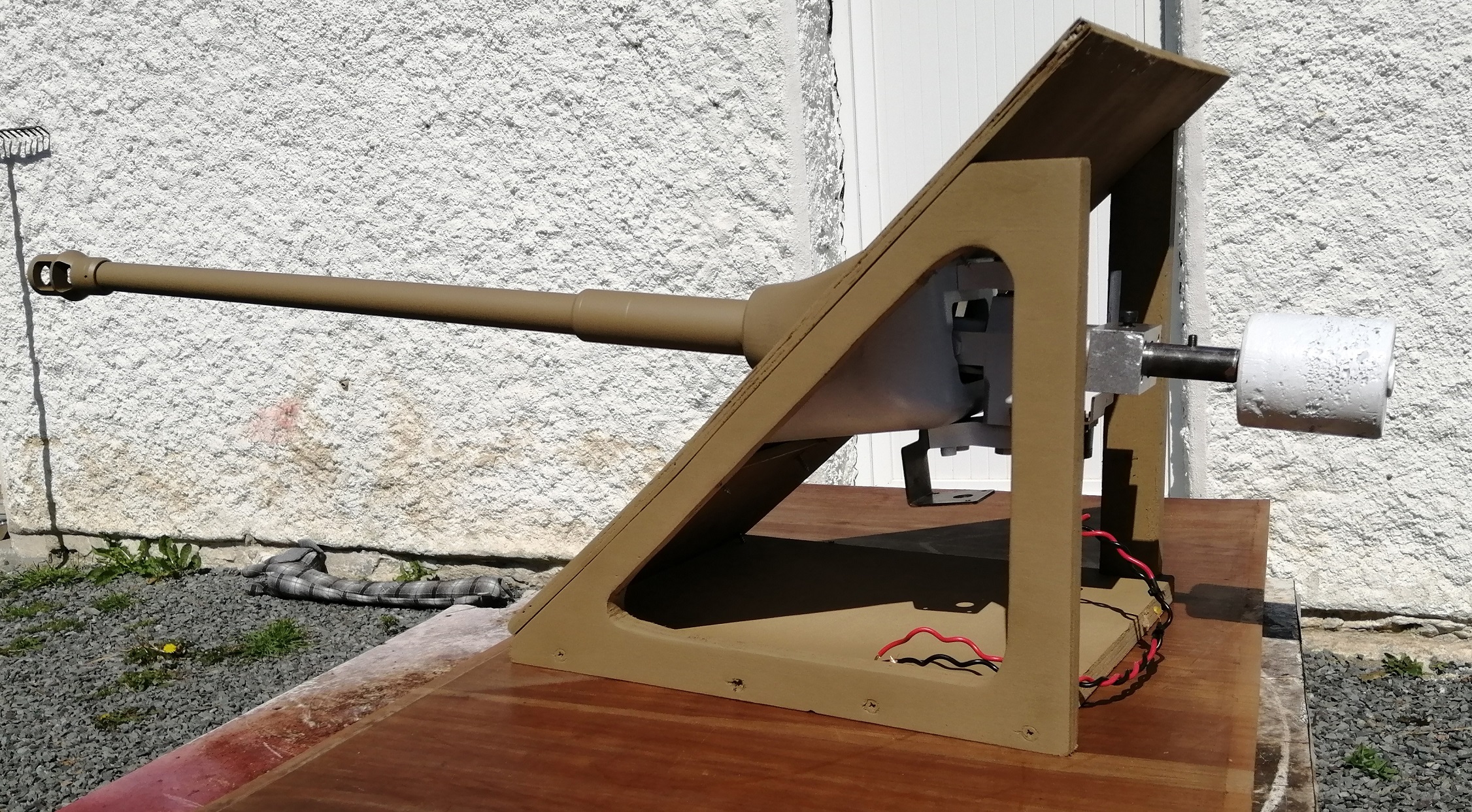

It didn't take long to fit the 12 components in a dry run before painting – I had only purchased the one geared motor for elevation as it was my intention to use a 35 Kg pull digital servo for the slewing. Seeing as it is only 10 degrees one way and 12 the other, the servo option seemed the most sensible. However, I had always been worried about the huge mass of the barrel and Saukopf and firmly believed that a counterbalance would be needed.

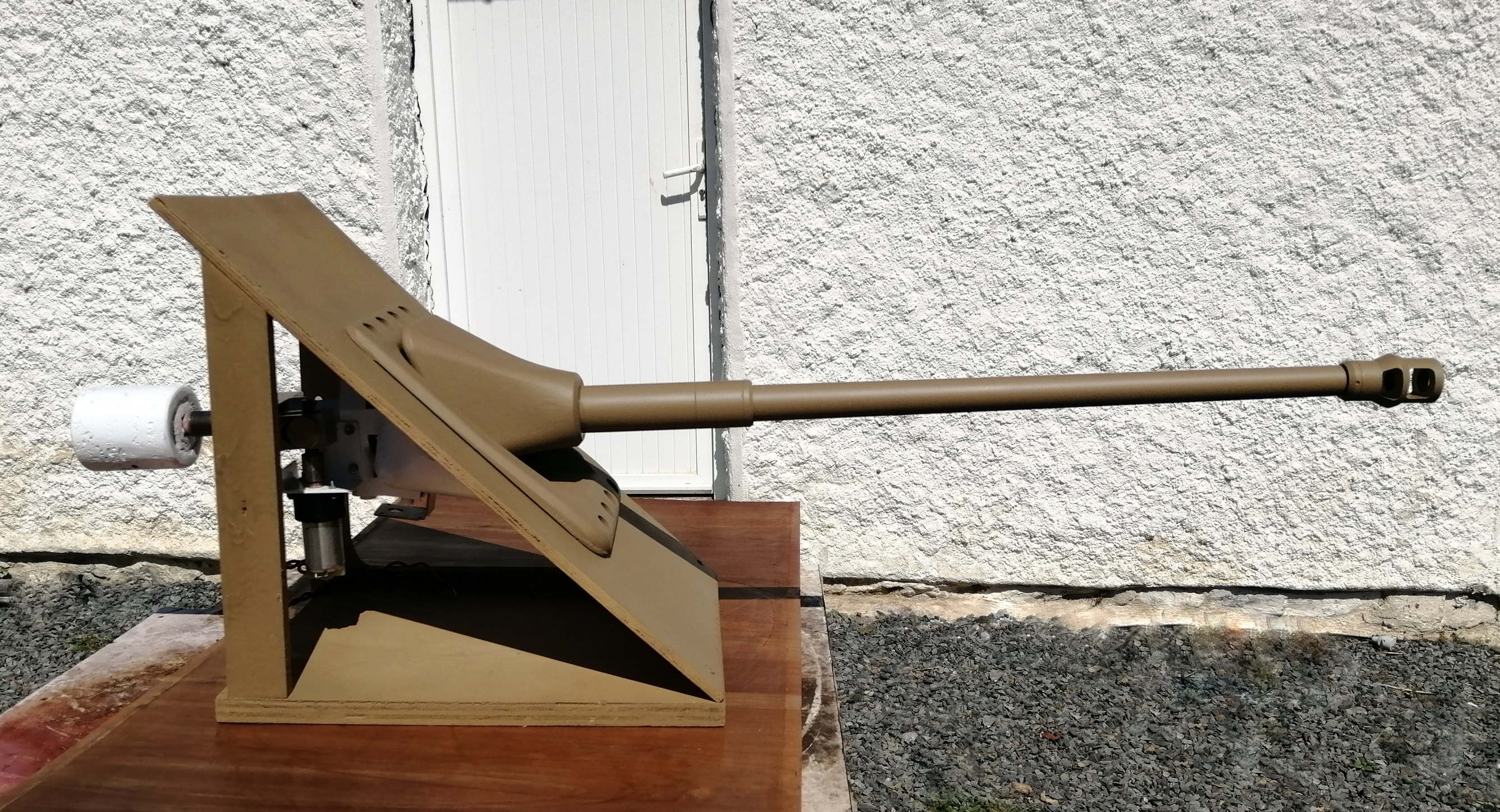

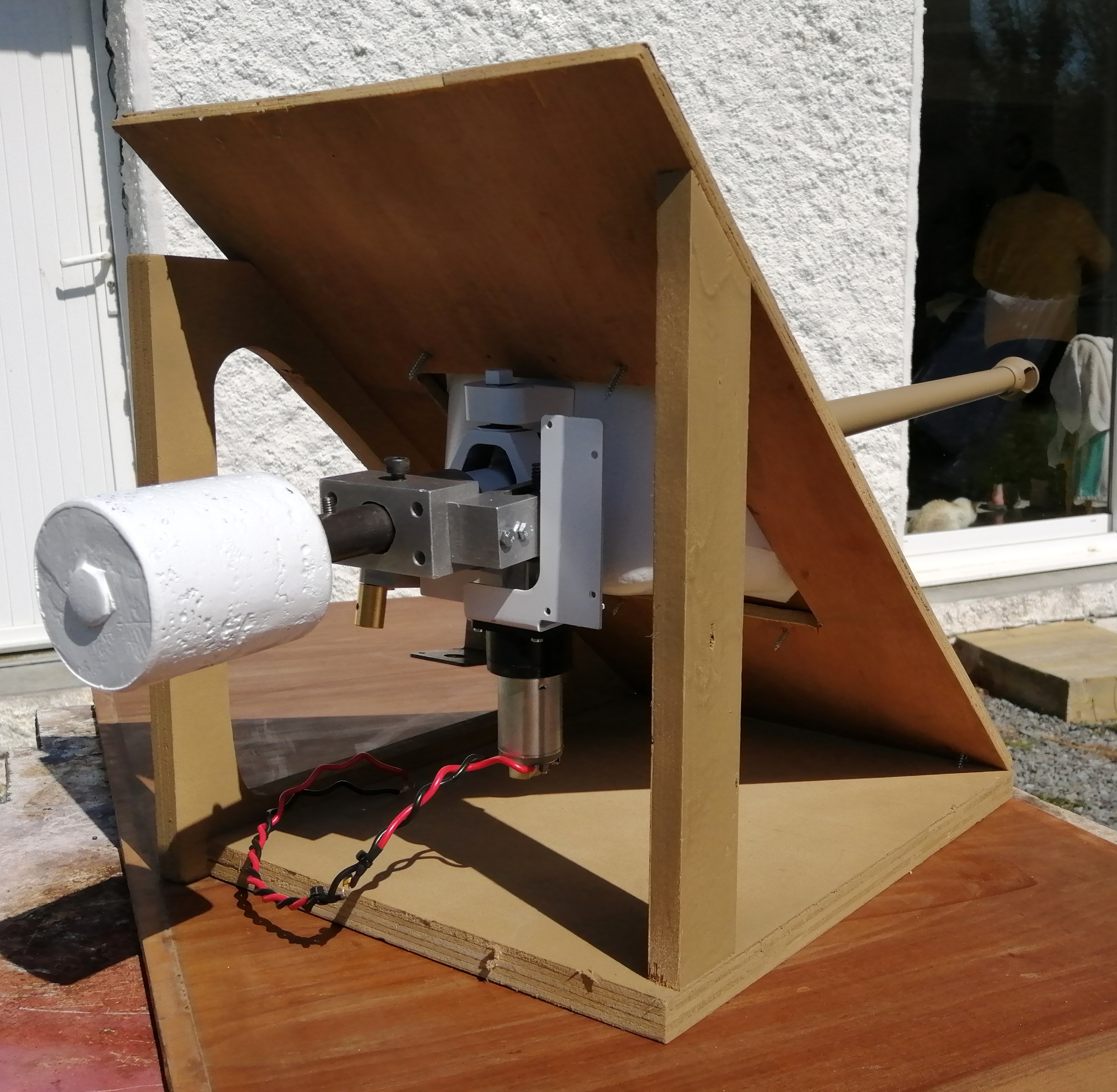

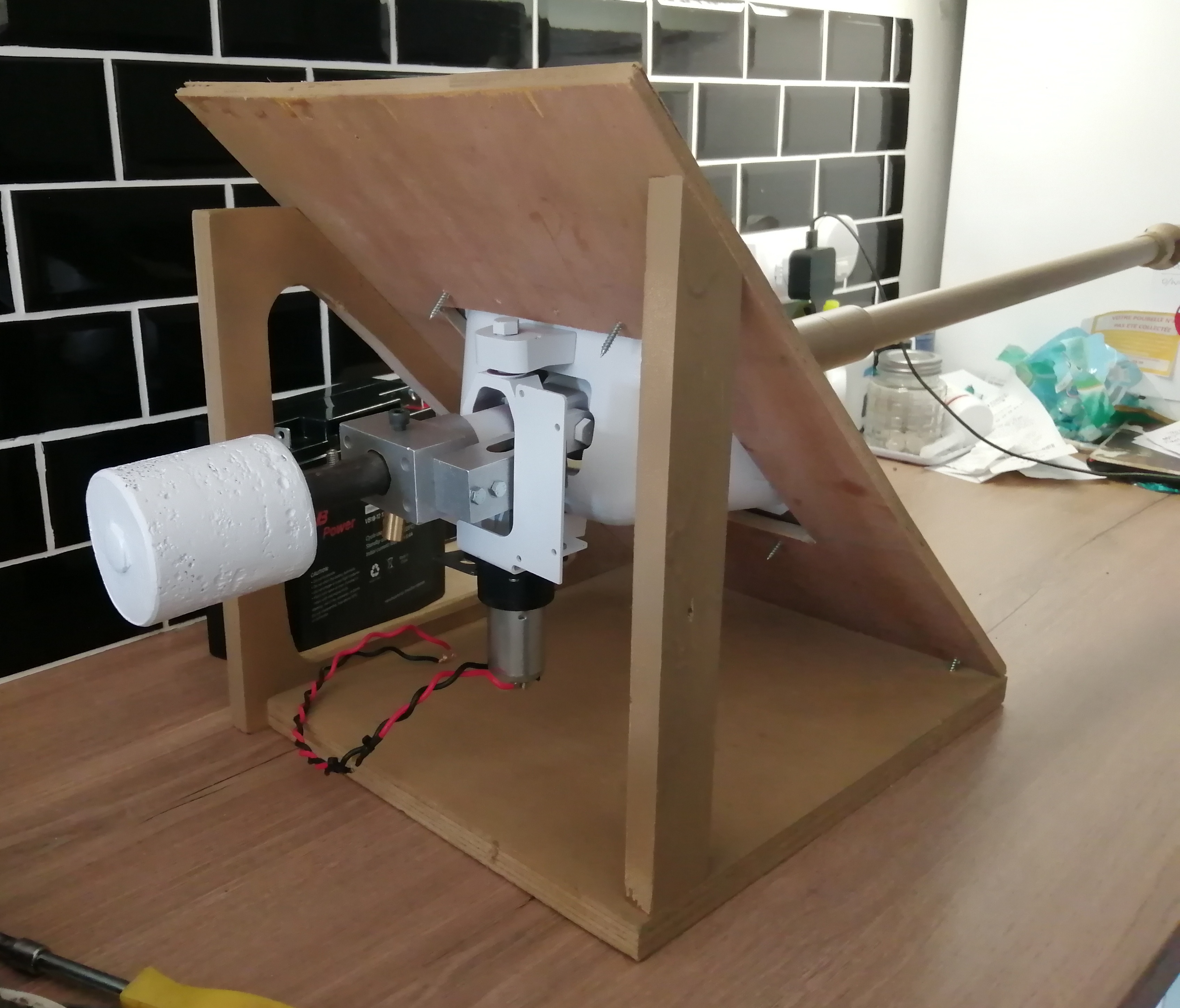

Applying first 12 then 24 volts to the little elevation motor and it just would not budge – unless I took the weight of the gun by hand. So, a quick calculation using my schooldays equation of balance moments and the equalising weight needed was apparent. Just under 5 kilos!! The tank was heavy enough already so recalculating with a weight further from the pivot point reduced it to 2.8 kilos with a 40mm extension to the breech block.
My gun barrel was mounted on a 14 mm bore steel tube so this was extended by 4 cm then scrap lead plumbing pipe was cut to the required weight, hung off the end of this stub with duct tape and there it was, a barrel in equilibrium with only the slightest effort required to lift or lower. Testing with the geared motor and it worked perfectly with no strain on motor, leadscrew or threaded brass pivot. So now to tidy it up.
I took an aluminium beer can (German lager of course!), cut off the lid, placed it in a steel cat food tin to prevent toppling and distortion when the molten lead was poured, then smelted the scrap bits of pipe, scraped off the dross and poured into the makeshift mould. I then immediately plunged a 14mm diameter Kettenkrad track pin into the lead to provide a “cast in” spigot to fit inside the barrel tube extension. I had this pin left over from one of the 3 Kettenkrads I have restored in my time so a genuine WW2 vehicle part being recycled for use on 1/6 scale armour!
When cold, the beer can was peeled back, the nice shiny lead scurfed to provide a “key” then primed and painted white. The breech extension was drilled and tapped M6 for a grub screw, the spigot slid into place, nipped tight with said grub screw and yup, she worked a treat – even with the 24 v motor running on 12. A bit slow but motion nonetheless!
