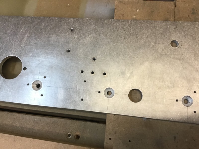

First step has been to mark out for the torsion bar covers. It’s  easier to do this before the hull is assembled
One of the covers just placed in position, these will be fixed in position after the hull is assembled. It’s worth noting that not all covers face in the same direction.

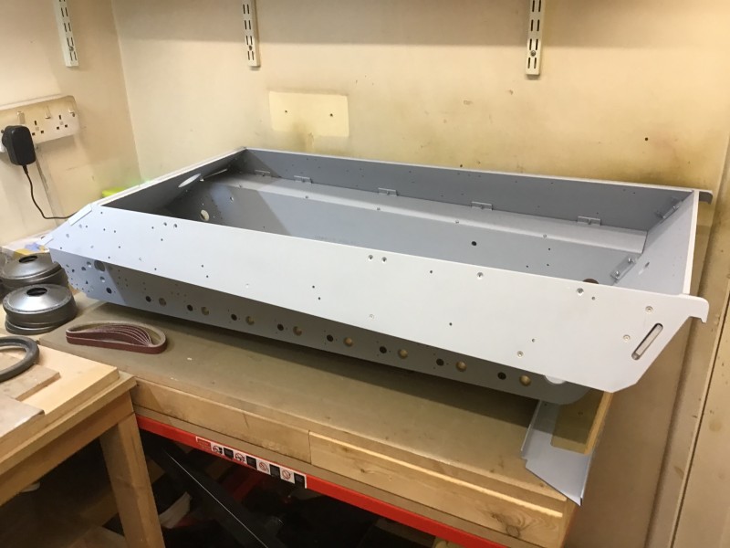

I have primed and loosely assembled the hull to do an initial fit check. Everything went together without any trouble and this is a sign of Armortek’s continued product improvement process. There are still a couple of items that need addressing before i do a final bolt together but these items are fairly minor (some of the interlocks need the corners squaring up and the plate joints need chamfering to accept the weld seams).
Just tacked together for the moment
I am also waiting for some parts for the rear plate which will be easier to fit with the plate removed, another reason to leave things loose at the moment.

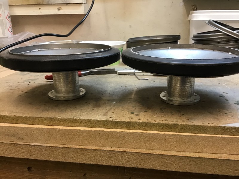

While I wait for the rear plate parts I have decided to have a go at the wheels. These new pressed steel wheels are very nice but do have a major visual problem. The rim of the wheel protrudes well beyond the edge of the tire which is wrong. This is only really an issue on the outer 8 wheel assemblies as they are the ones most visible.
The fix for this is quite easy if a little messy (no lathe work required)
I have assembled each wheel so that it can be held in a vice with a tire fitted and the used a power file to carefully remove the excess material, any marks on the tire can be hidden by reversing it at final assembly.
Before and after
Before and after
The wheel set up in the vice with the trusty power file about to do its work
