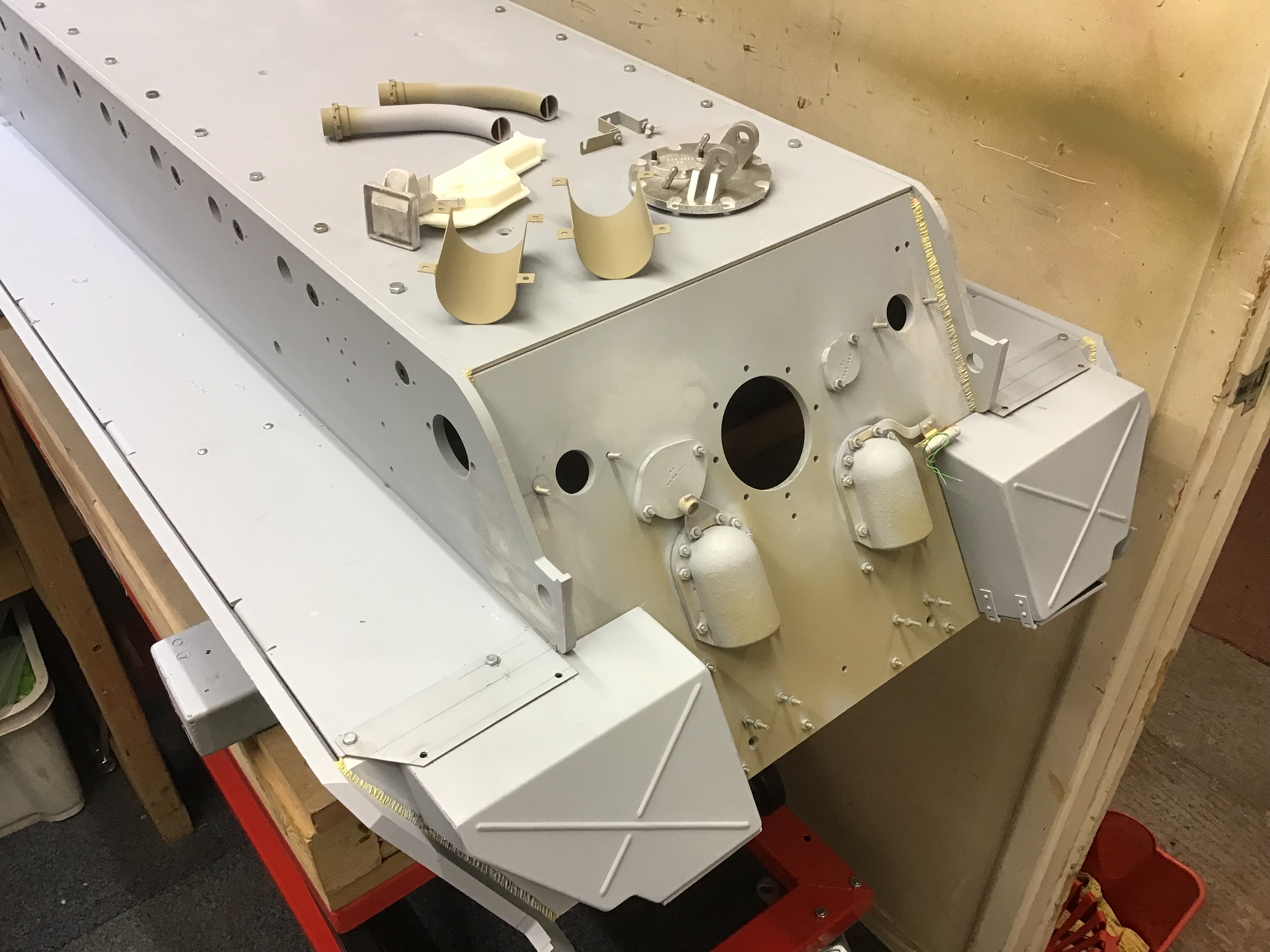

Hi Steve
Also had the same idea along with Ed with the cover plates - just finished mine yesterday.
I like how they look.
As you say they are not all fitted in the same direction but you will find that two can not be orientated as they should.
One due to the fowling on the front gear case and the other to one of the main bump stops.
Not really a problem though.

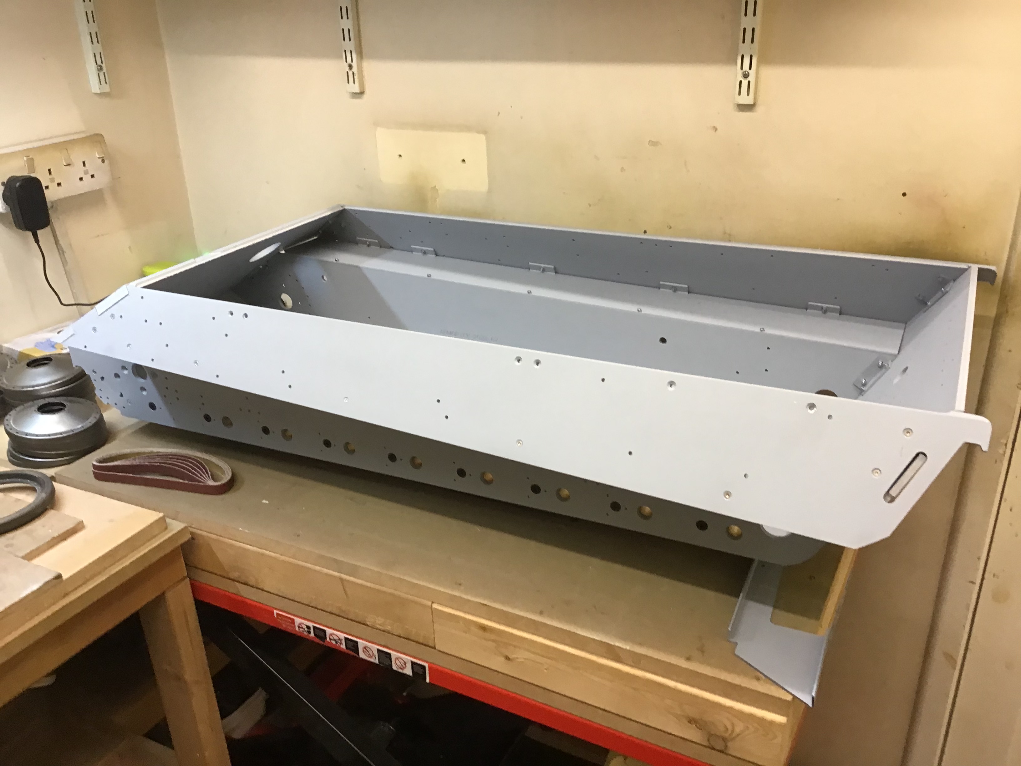

A little update on Chris,s Panther.
I have primed and loosely assembled the hull to do an initial fit check. Everything went together without any trouble and this is a sign of Armortek’s continued product improvement process. There are still a couple of items that need addressing before i do a final bolt together but these items are fairly minor (some of the interlocks need the corners squaring up and the plate joints need chamfering to accept the weld seams).
I am also waiting for some parts for the rear plate which will be easier to fit with the plate removed, another reason to leave things loose at the moment.

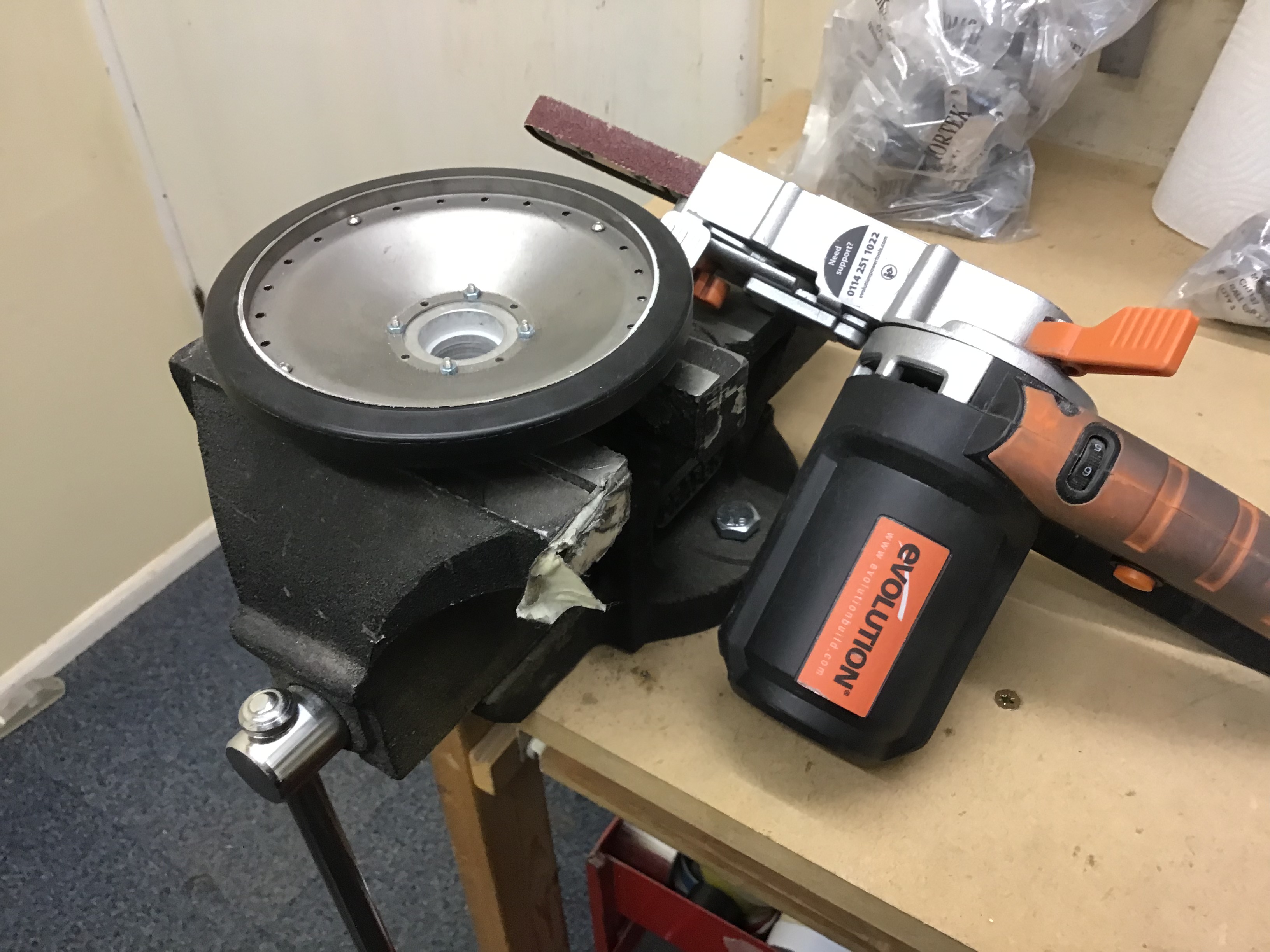

While I wait for the rear plate parts I have decided to have a go at the wheels. These new pressed steel wheels are very nice but do have a major visual problem. The rim of the wheel protrudes well beyond the edge of the tire which is wrong. This is only really an issue on the outer 8 wheel assemblies as they are the ones most visible.
The fix for this is quite easy if a little messy (no lathe work required)
I have assembled each wheel so that it can be held in a vice with a tire fitted and the used a power file to carefully remove the excess material, any marks on the tire can be hidden by reversing it at final assembly.
Good to see another Panther building post and good advice of resolving protruded metal rim part! nice! it may seem to require careful and a bit of skillful control of filing to prevent too much filing of excessive rim part. looking forward to another building post!

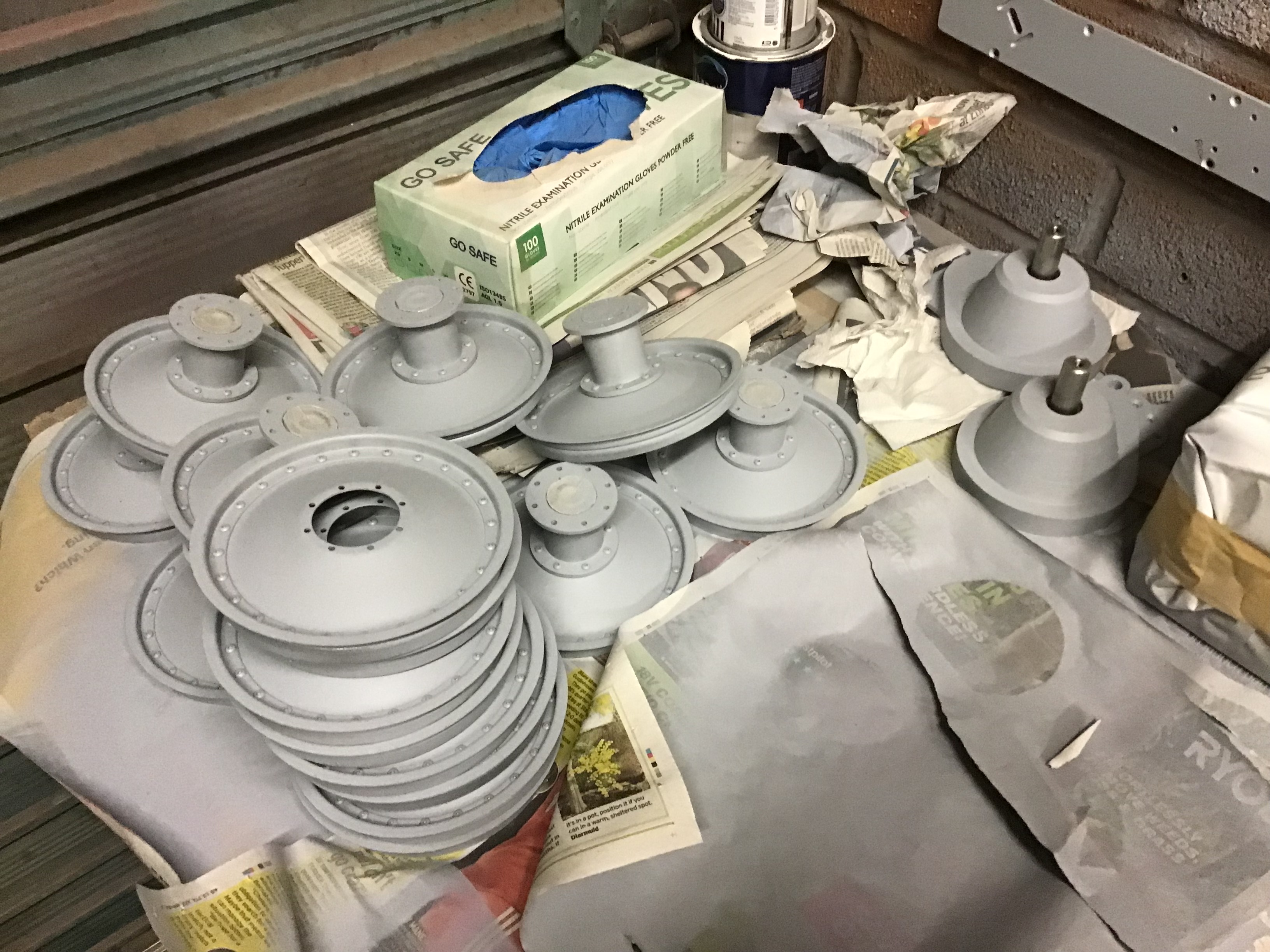

Two weeks in and I still haven’t completed the wheels, when done I don’t want to see another Panther wheel for a very long time

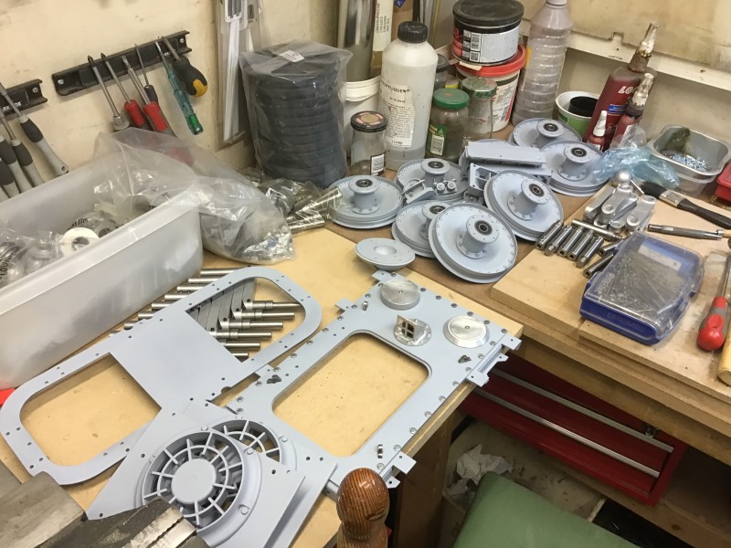

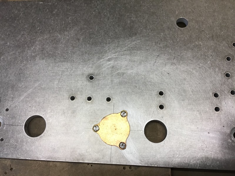

A few more Panther update pictures.
I am not going overboard with the posts as the Panther is already well covered, I will just add where there has been changes to the standard kit.
