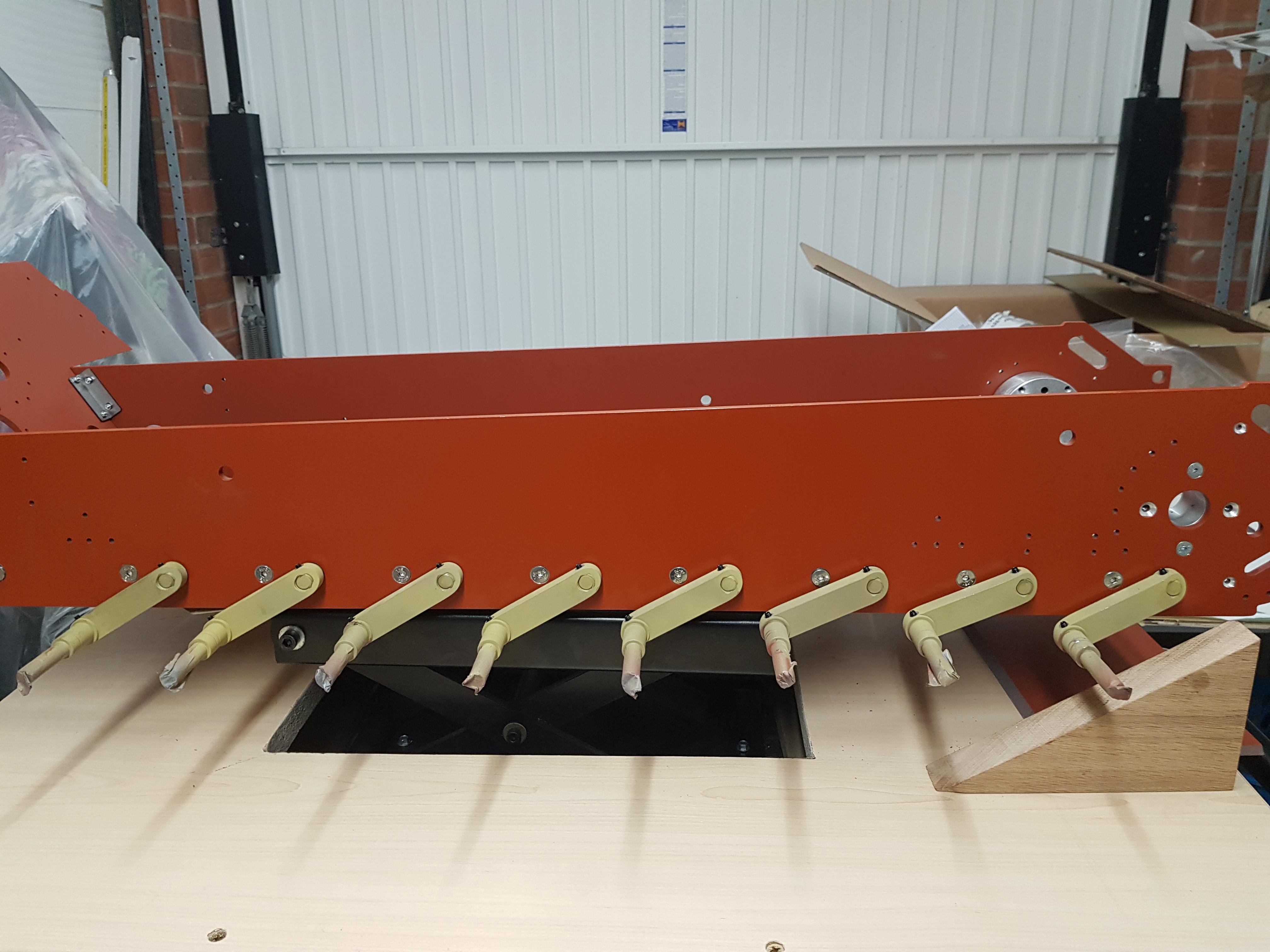

Can I ask you to cast your eyes over the attached image and confirm that I have set the angle of the torsion bars/ axel too shallow ! Grrrrrrr
It looks it to me...what do you think?
As usual ...help ! :oops:
Si

Simon Compton wrote:
Sun Apr 30, 2023 11:42 am
Si
If it's 30 degrees, then is is ok.
I also made a wedge, (from cardboard), and then propped the base up with material until the wedge
made the correct angle for the swing arms.
I had a space of 23 mm between the table and the bottom.
Ed
Simon Compton
Posts: 37
Joined: Fri Feb 10, 2023 12:56 pm
Has liked: 7 times
Been liked: 79 times
Re: Panther #42
Post by Simon Compton »
Cheers Ed
I had made a cardboard template to start with then a joiner at work made me the wood wedges which are bang on 30 degrees, its just when looking at other peoples posted images mine looked as though the angle was wrong ( sort of the axels aren't pointing down at an acute enough angle if you know what I mean )
I was worrying that when the wheels are on and it settles on its weight it will just hit the bump stops and give me a load of grief so I just though I would get it right now.
Thanks for getting back to me.
Si
Ed Groenenberg
Posts: 168
Has liked: 96 times
Been liked: 639 times
Re: Panther #42
Post by Ed Groenenberg »
No problem.
This is how I did mine.

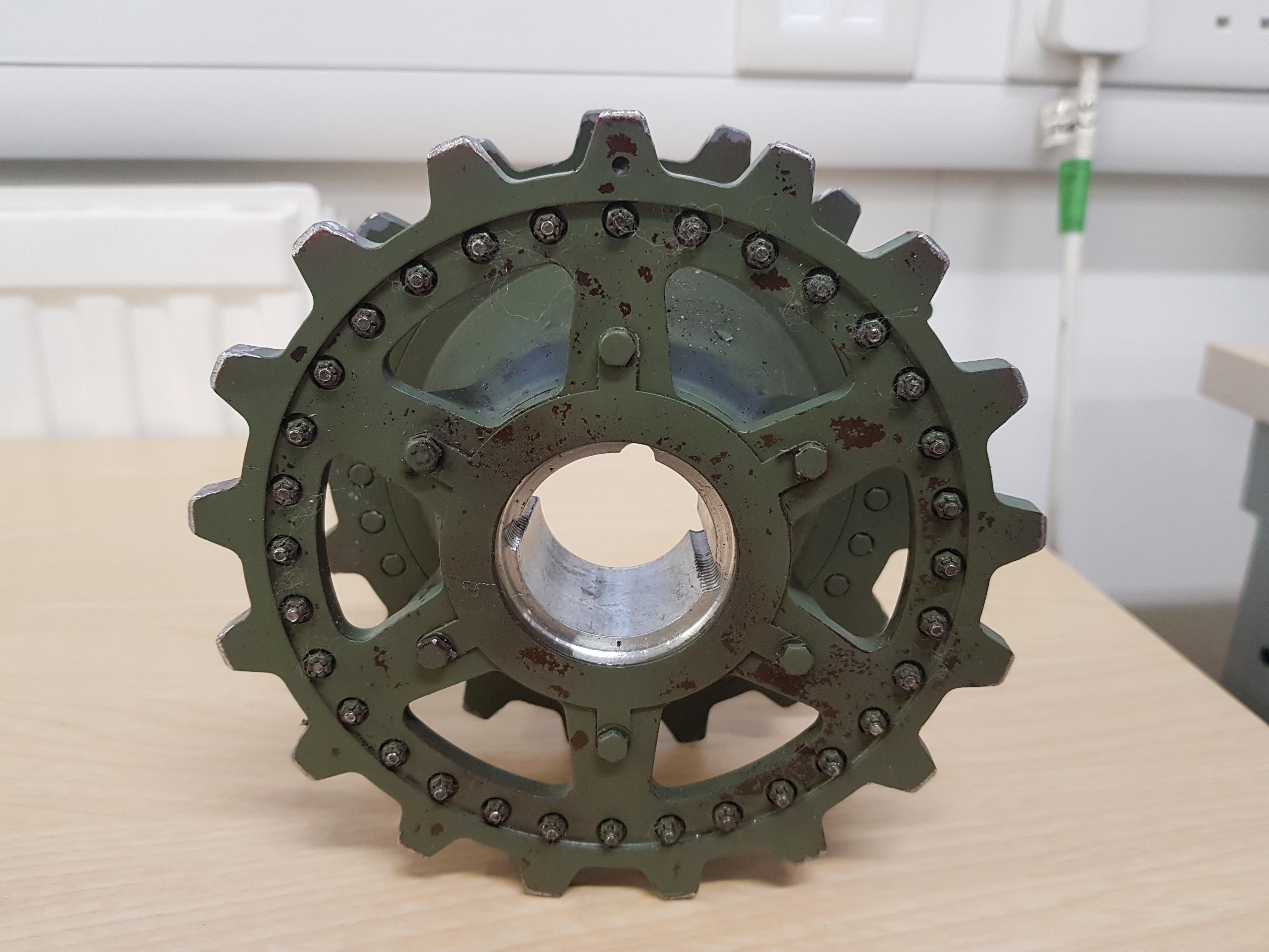

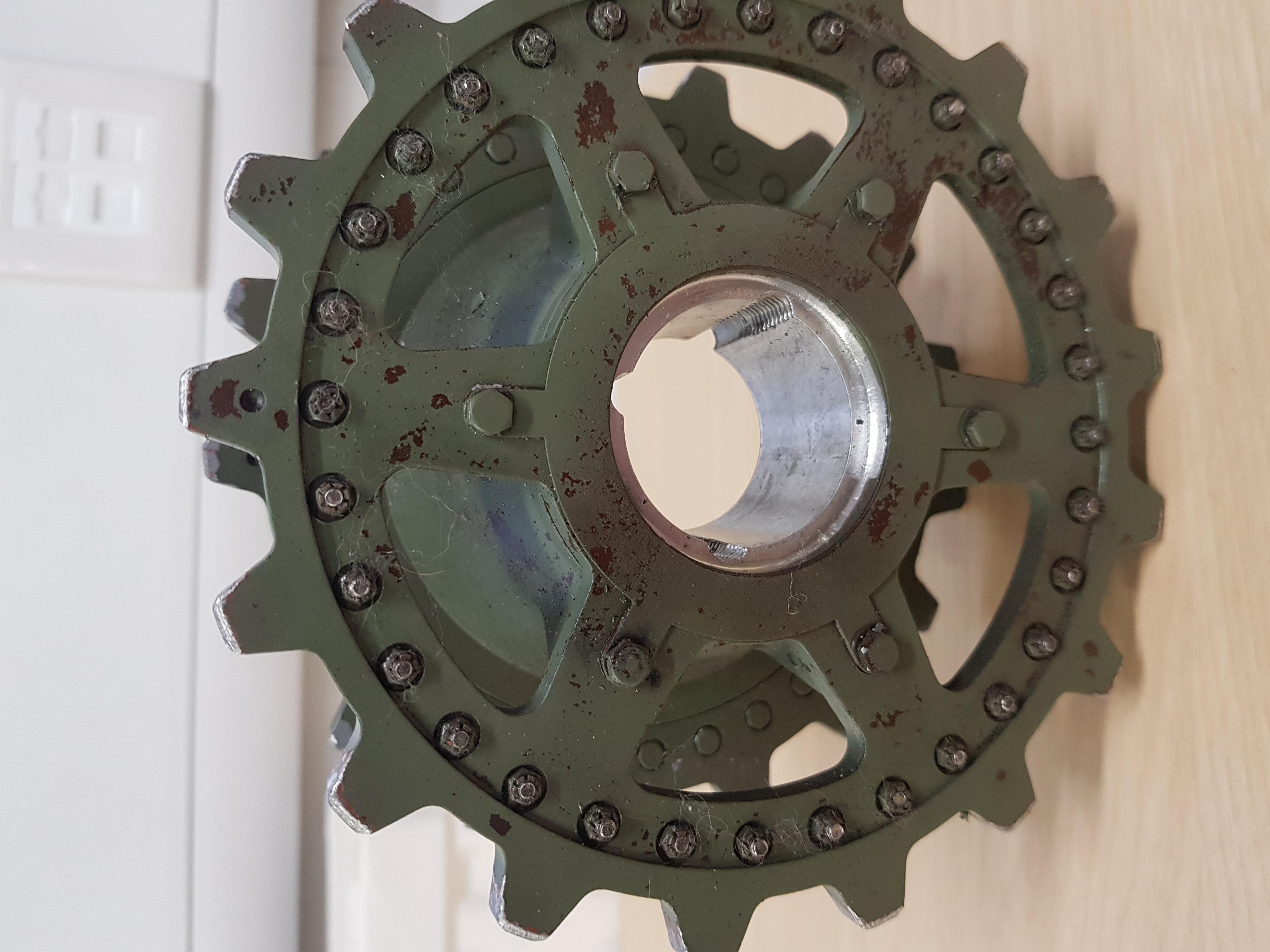

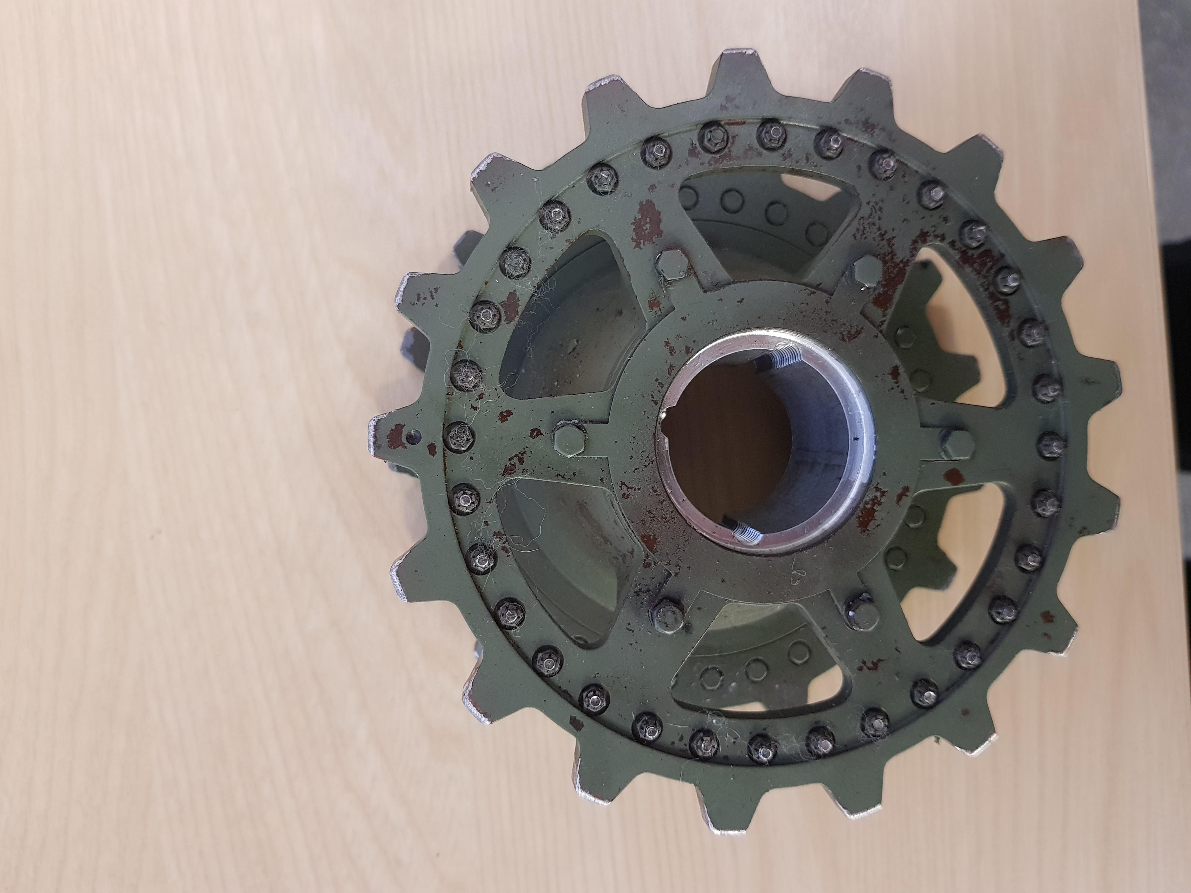

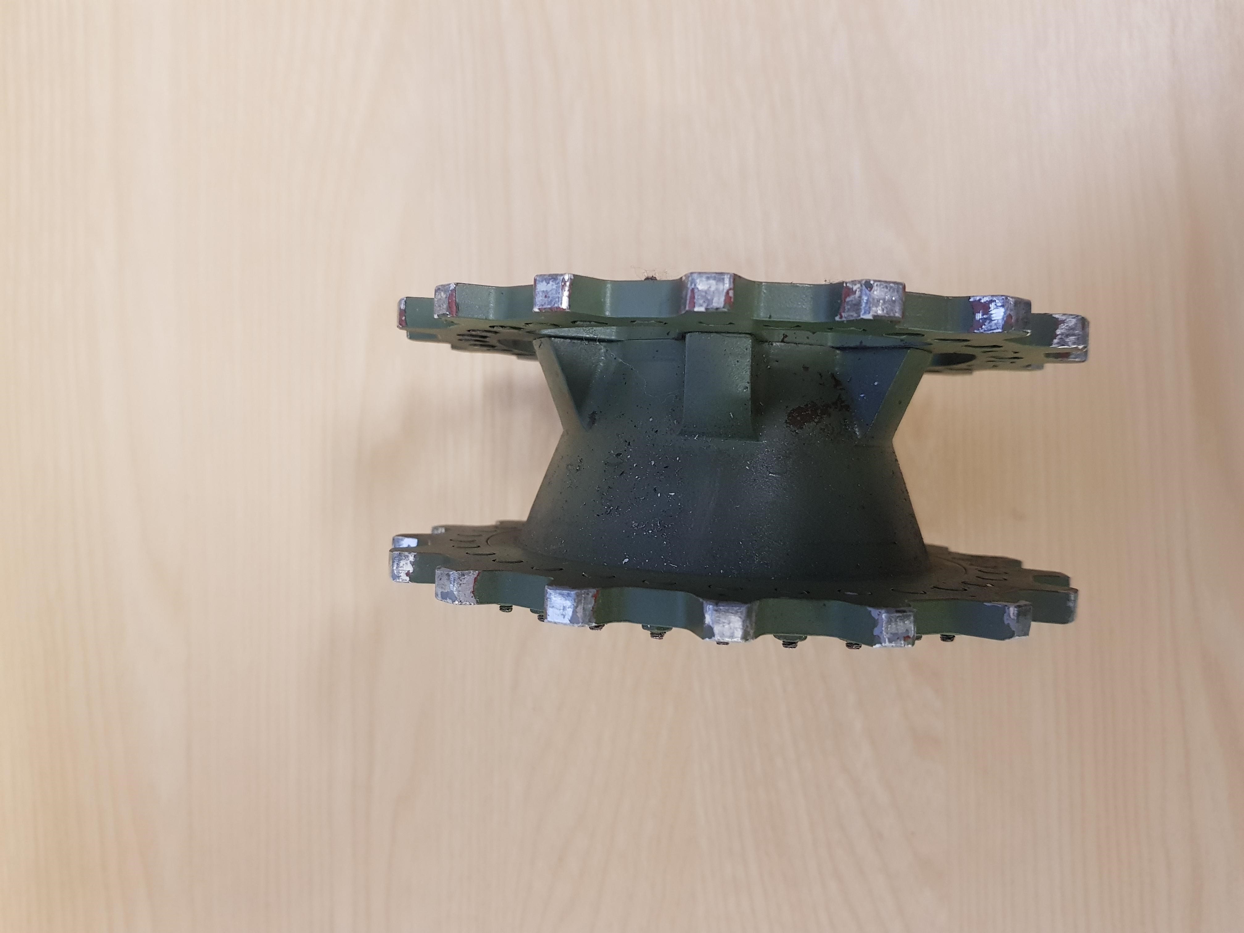

Is there a "WRONG" way of assembling the front sprockets ...because if there is I think that I may have found it !
My front sprockets with the timing marks aligned...or they appear to be to me.. still have the teeth that are slightly out and a test has proved that they will not roll through the tracks ?
What in goodness have I done wrong ? Is there quite a number of ways of building the sprockets to get the timing marks perfect?
Either side of the sprocket teeth are slightly out and wont run through the tracks.
Any advise on building the sprockets would be extremely welcome as I am really stumped.
Hope someone has a solution or has experienced this, what the hell have I done ? ...Good Grief
Cheers Si
Thought I would post up a couple of images....Help :roll:
