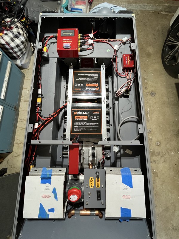

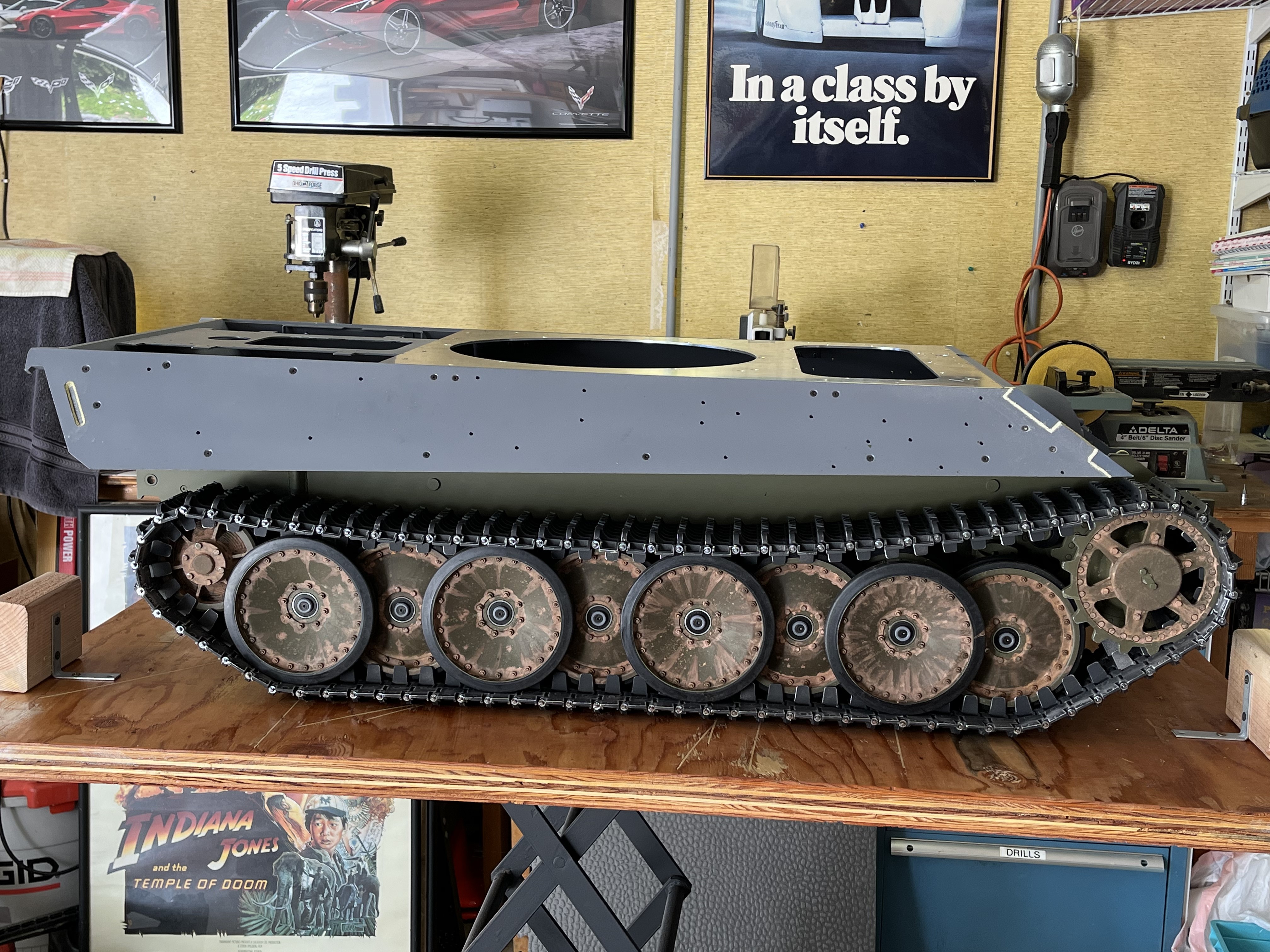

Since I reached a milestone today, so I'd thought I'd share it with this wonderful forum. My name is Mark and I live in Carlsbad, Ca. This is my first Armortek project, my experience comes from 1/5 scale on road racing and 1:20.3 narrow guage railroading. I was overwhelmed when I received my Panther shipment, and thought I had bit off more than I can chew. But with a lot of patience and about 350 hours of work the Panther moved under its own power today.
Thank you all who contribute to this forum, it is a treasure-trove of knowledge that has been invaluable in getting me this far. I'm not much for social networking, but with all the Panther G updates lately I thought I would add mine.
In case you are wondering about the Olive Drab coloring on my Panther, I am attempting to model "Cuckoo", so we''ll see how it goes. I have done a little weathering, as with most of my railroad scratch builds, I paint and weather as I build.

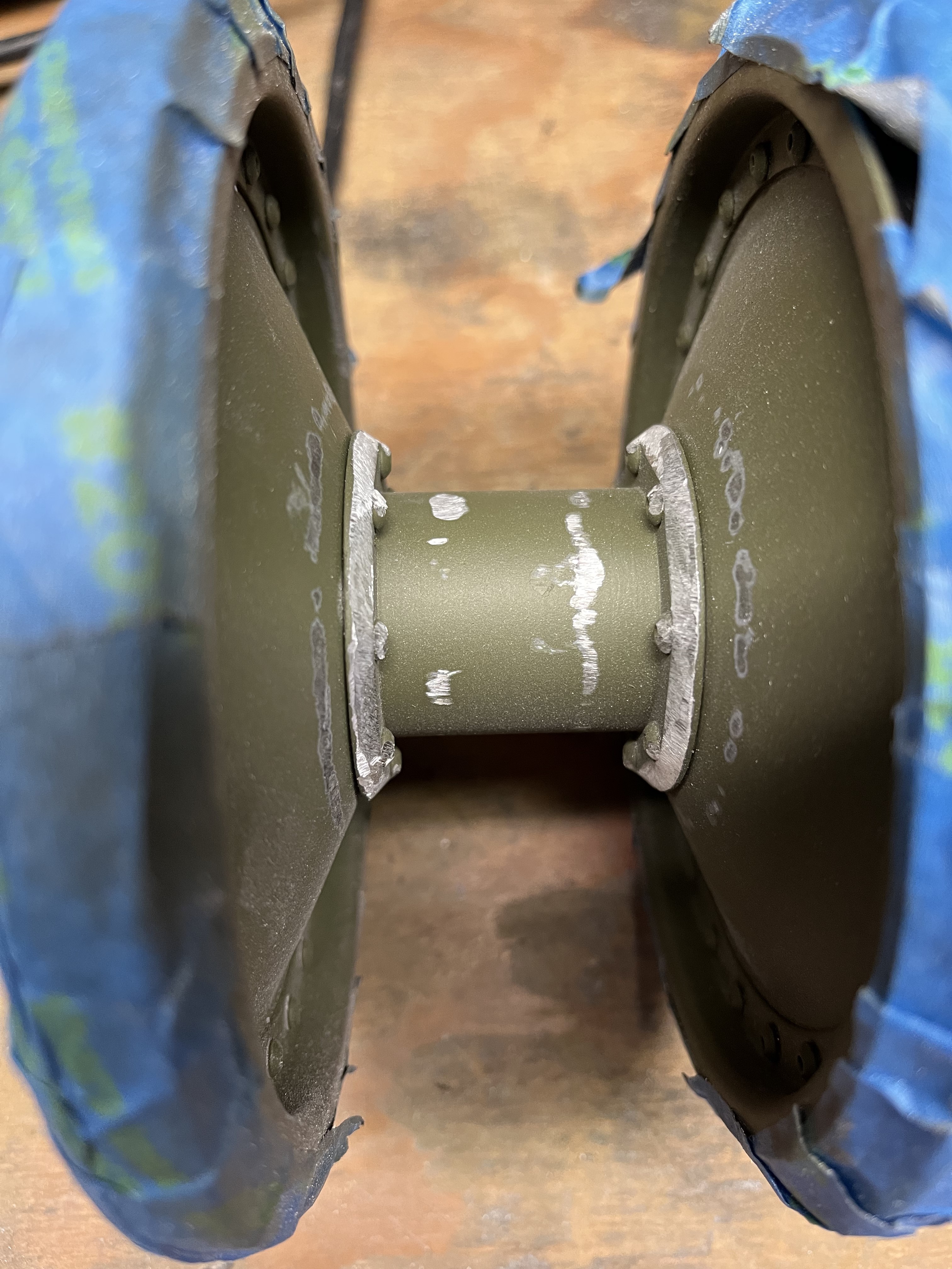

Thank you, I dealt with the road wheels by pushing the tires out to the outer edge to look scale, and ground the shoulders of the wheel hubs where I thought the next wheel would foul on them as the suspension moved. The inner wheels seemed a bit too wide for my liking and some would touch the next wheel if they were moving in opposite directions. Unfortunately I had already assembled everything when I noticed the possible fouling issue. So I ground the shoulders of the hubs and repainted. Not the optimal solution, If I would have noticed it earlier I would have machined them, but I was just trying to move on. On the initial run over small obstacles I didn't see any wheel fouling. Live and learn...

Mark Weiss wrote: ↑Tue Apr 04, 2023 4:57 pmThank you, I dealt with the road wheels by pushing the tires out to the outer edge to look scale, and ground the shoulders of the wheel hubs where I thought the next wheel would foul on them as the suspension moved. The inner wheels seemed a bit too wide for my liking and some would touch the next wheel if they were moving in opposite directions. Unfortunately I had already assembled everything when I noticed the possible fouling issue. So I ground the shoulders of the hubs and repainted. Not the optimal solution, If I would have noticed it earlier I would have machined them, but I was just trying to move on. On the initial run over small obstacles I didn't see any wheel fouling. Live and learn...
download/file.php?mode=view&id=55569
I had the same issue when I built my Panther, the inner wheels were rubbing on the outers and spinning obviously the other way. I resolved it with spacers/washers on the outer sets to move just a tad and eliminate the rub. Runs perfect now and has about 3 hours time with no issues.
Agree with Phil it has now become my best runner compared to there other ones I have.

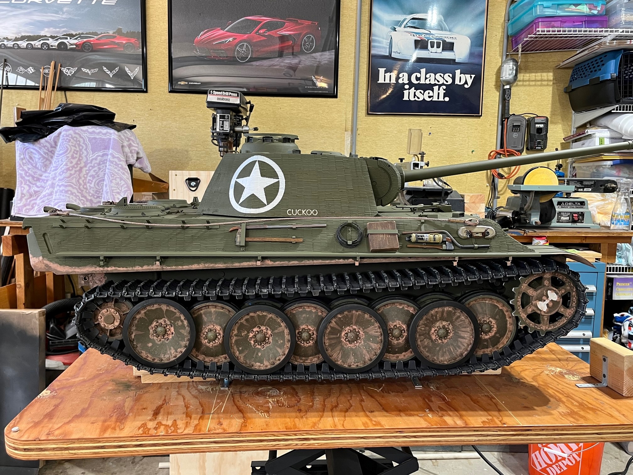

I haven't posted any updates to #20, but I thought I would as I was just working on the weathering, but health concerns will interrupt me for awhile. I tried my hand at modeling Cuckoo as best I could trying to replicate some of her traits from the photos we have available. So no extra tracks on the right side, missing equipment, etc. She runs flawlessly, and I look forward to finishing her weathering and taking her out to play after I recover. I have to have my second open heart surgery in three years tomorrow, so when the weather cools off I and I feel better I will hopefully post a video of her out and about.

That looks excellent - Panther is my fav. Really nice. I like your plastic channel for the wiring - very tidy.
Best of luck with the procedure - I hope all goes well and your back on your wheels soon.

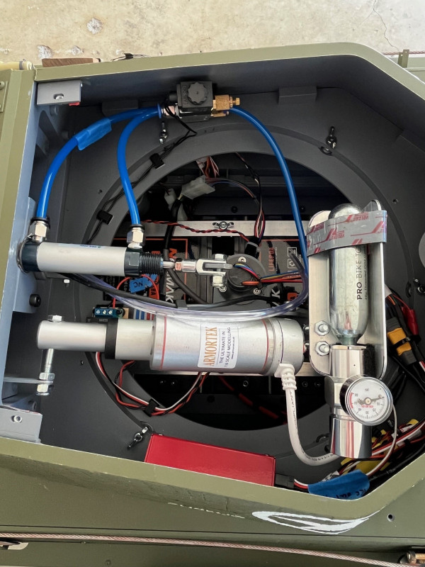

I wanted to try and enhance the recoil, as I felt it was underwhelming. This is what I came up with using Paul Sparkes as my inspiration. I'm pretty happy with the results. I used a 25mm cylinder and it triggers off the TX as I couldn't seem to get the the recoil module or the sound module to cooperate with the relay controlling the solenoid. My next trick will hopefully to add smoke...
