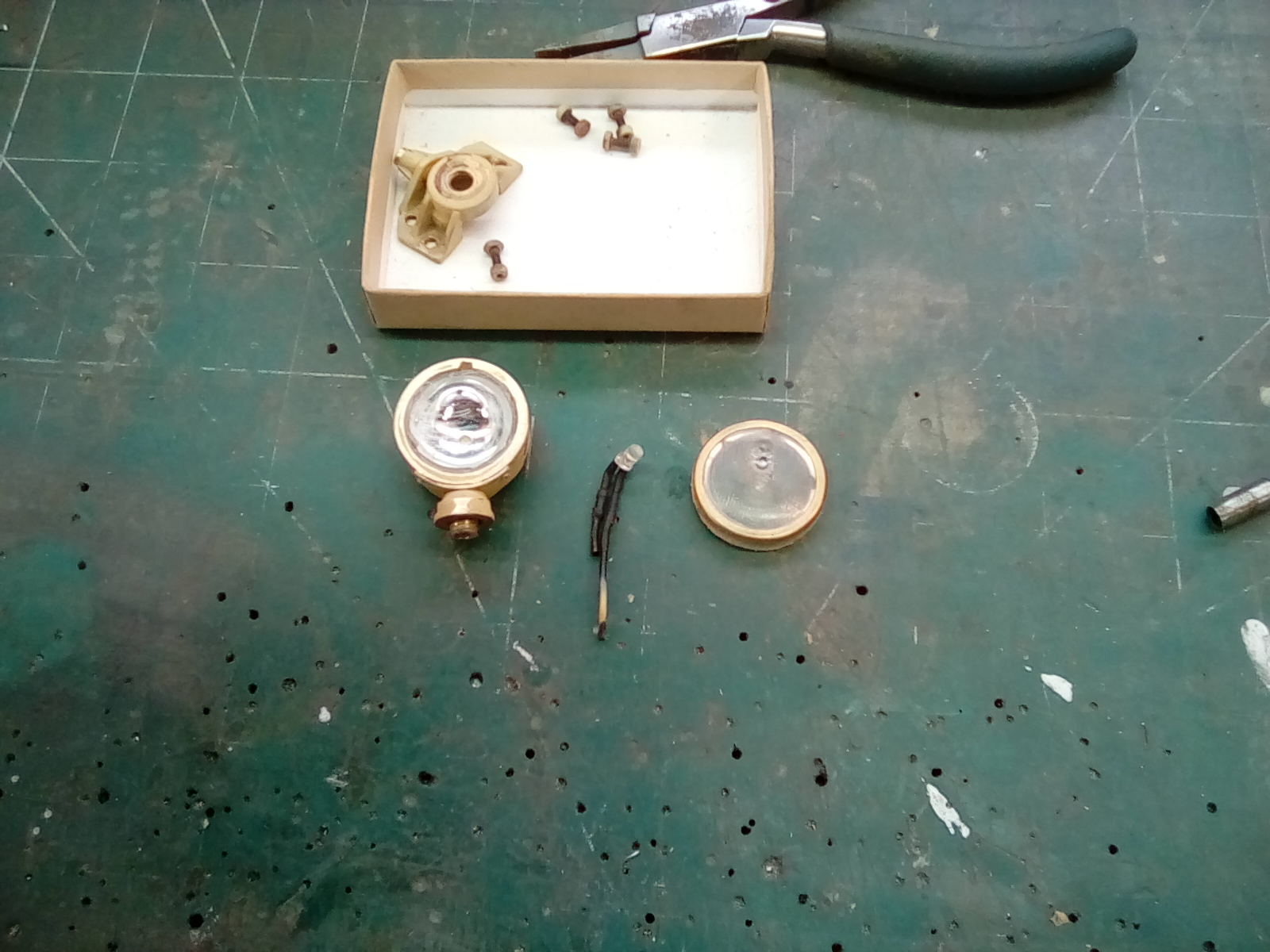

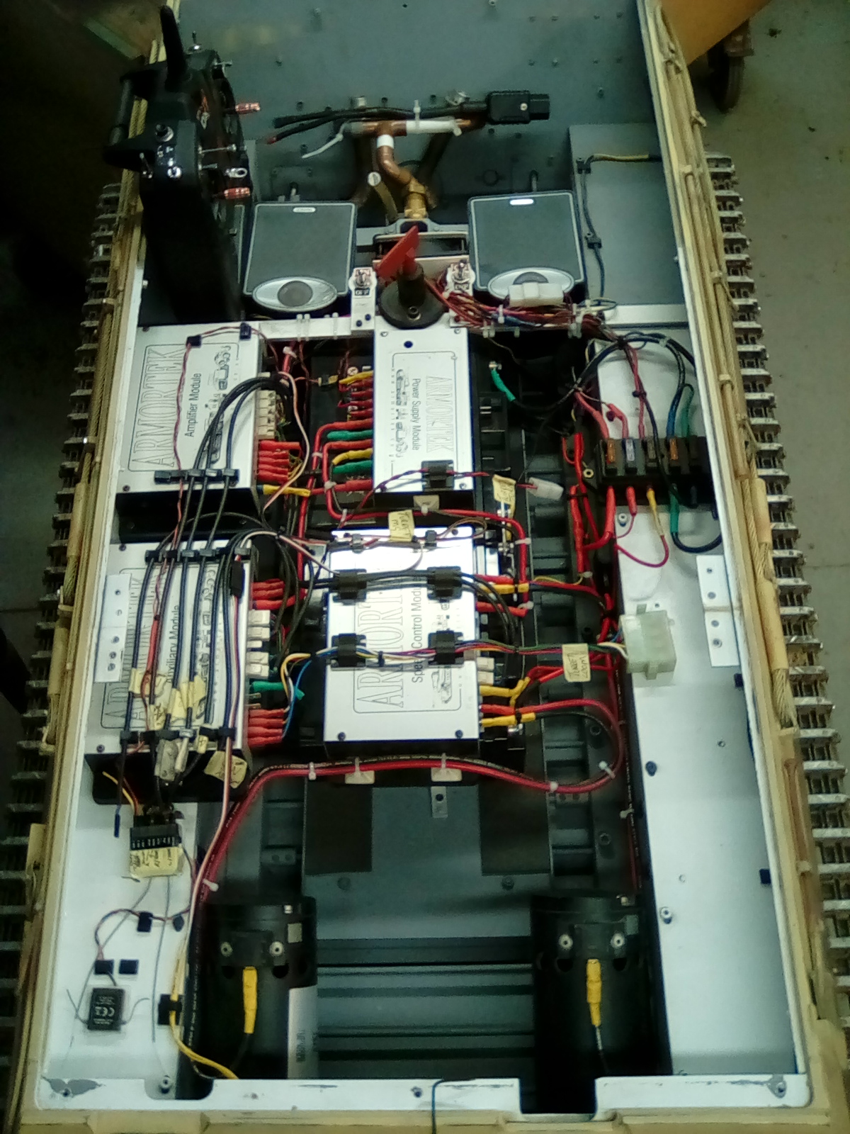

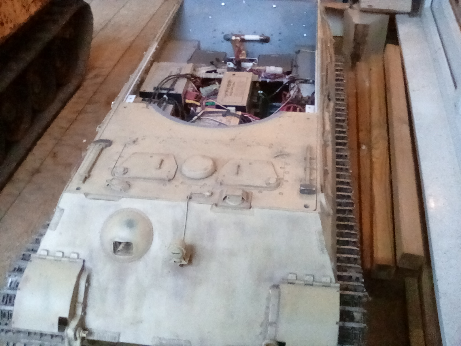

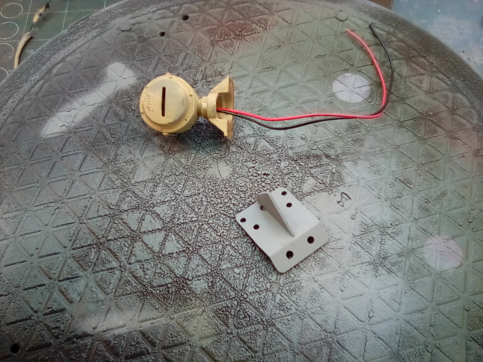

Well she needs a new radio system so one is on order, the driving light had been damaged in transit, this had crushed the led wires. Also she needs a good tidy up to include a few more self adhesive cable ties to keep the wiring nice and secure.

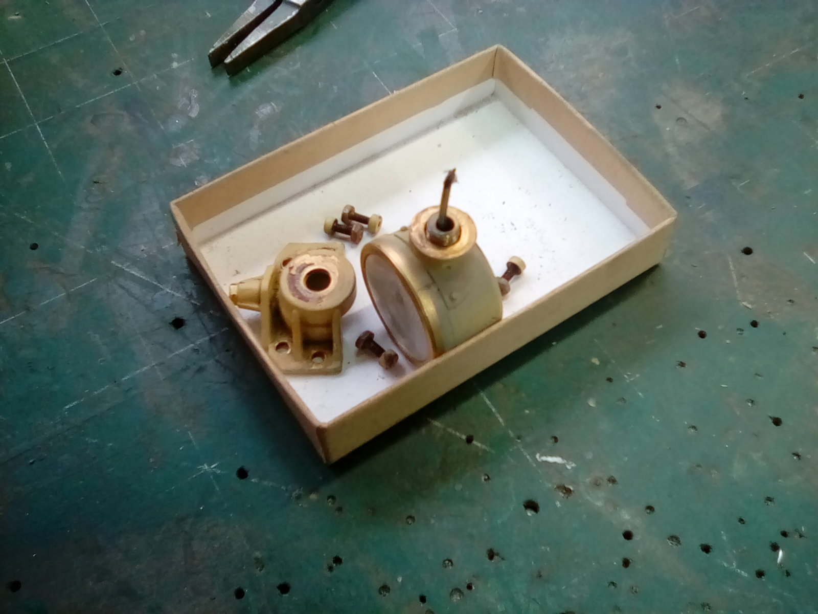

Bent
Bent

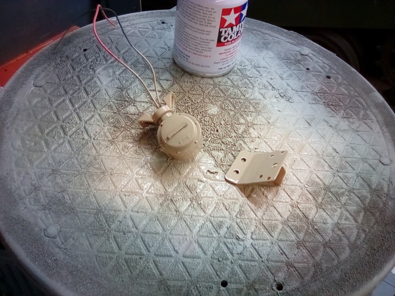

Once upon a time this lamp had a filament bulb fitted which melted the defuser
Headlight bracket now straight and painted

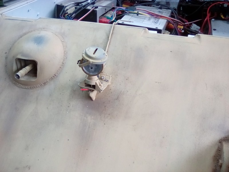

New 24 v led fitted
New 24 v led fitted
All ready to be fitted

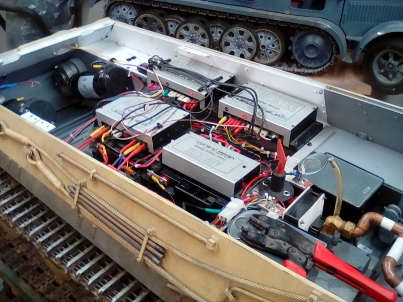

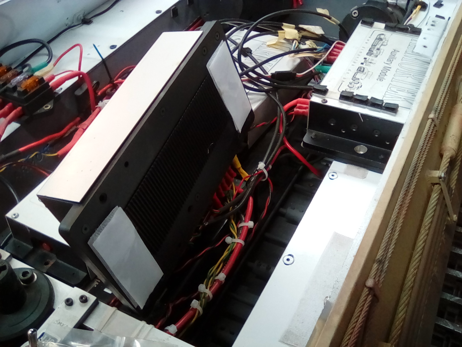

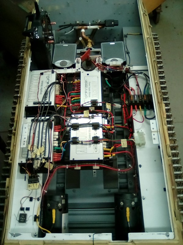

All vacuumed out, it always amazes me how much FOD accumulates in the hull, and the metallic pieces are just waiting to short something out and cost you dear!

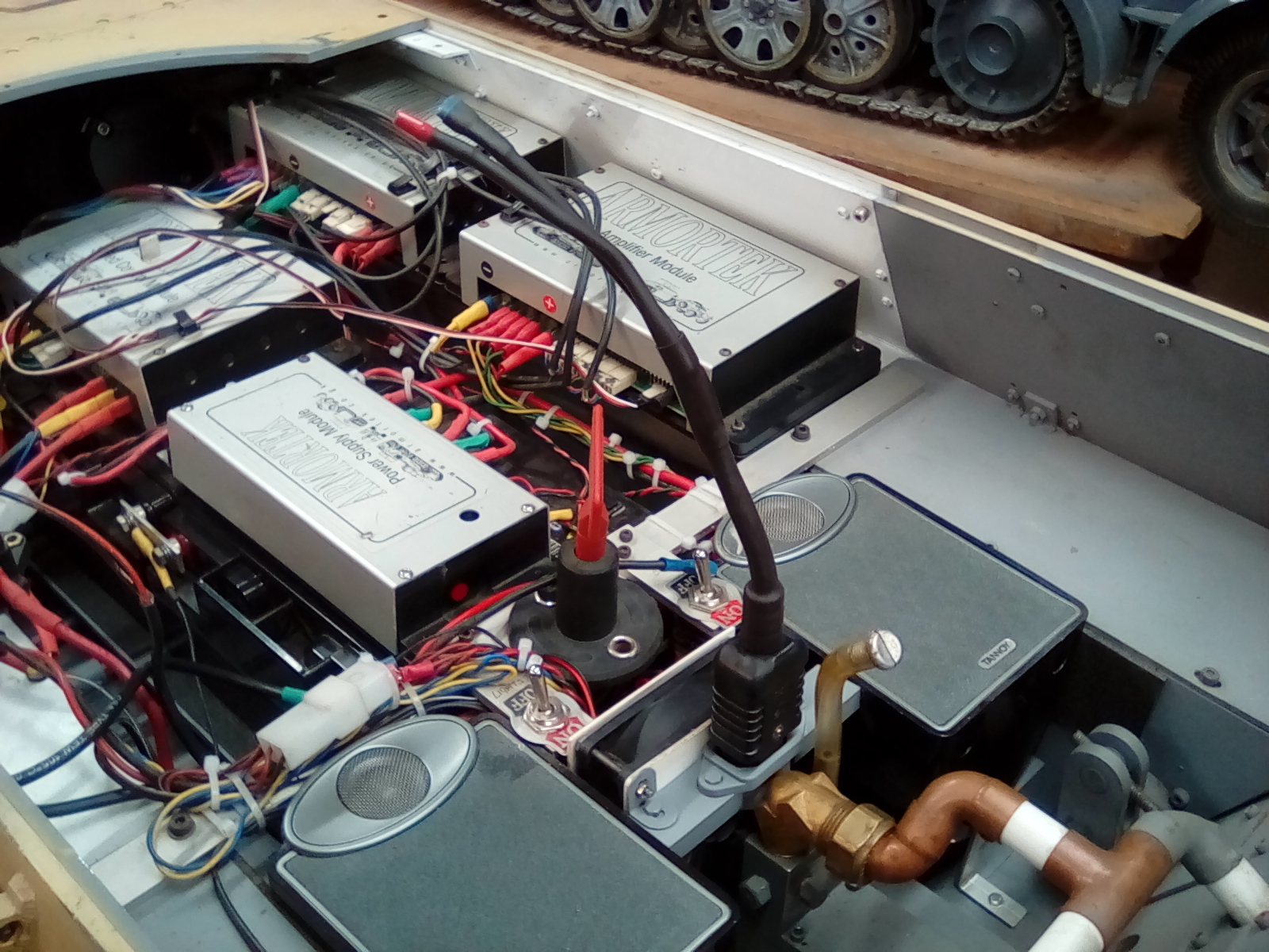

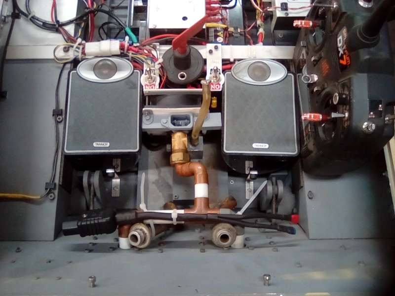

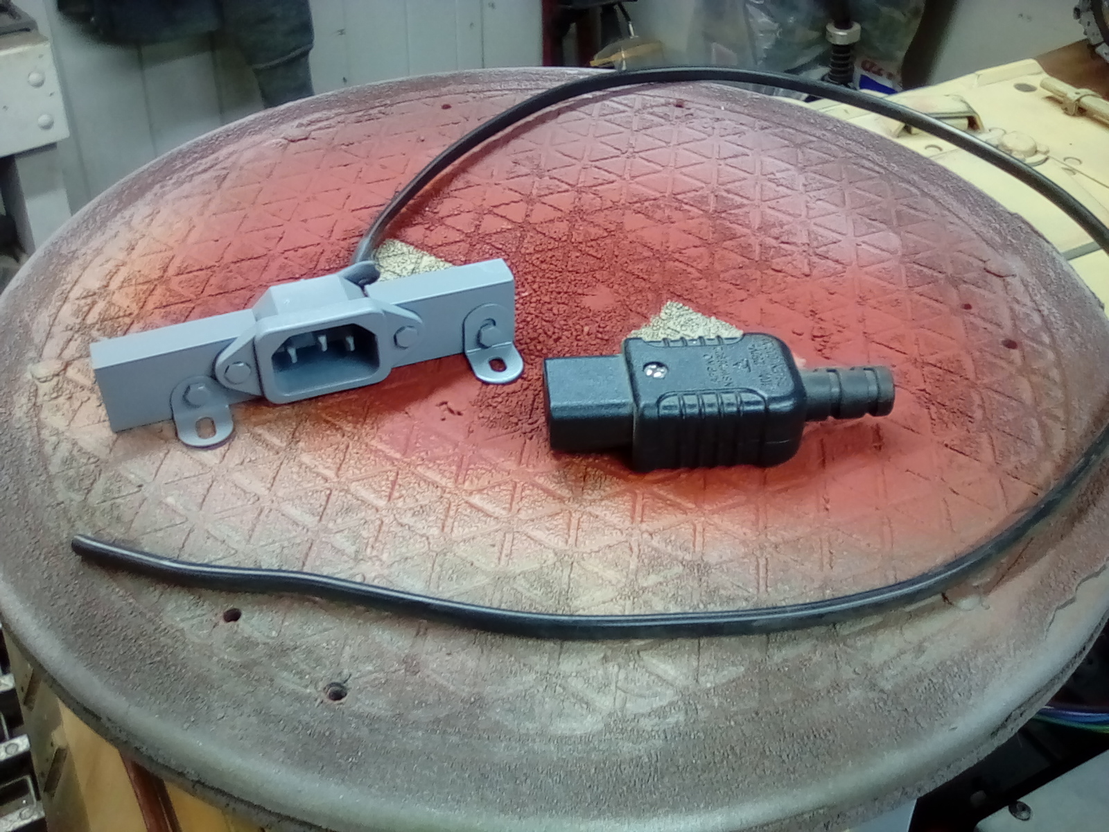

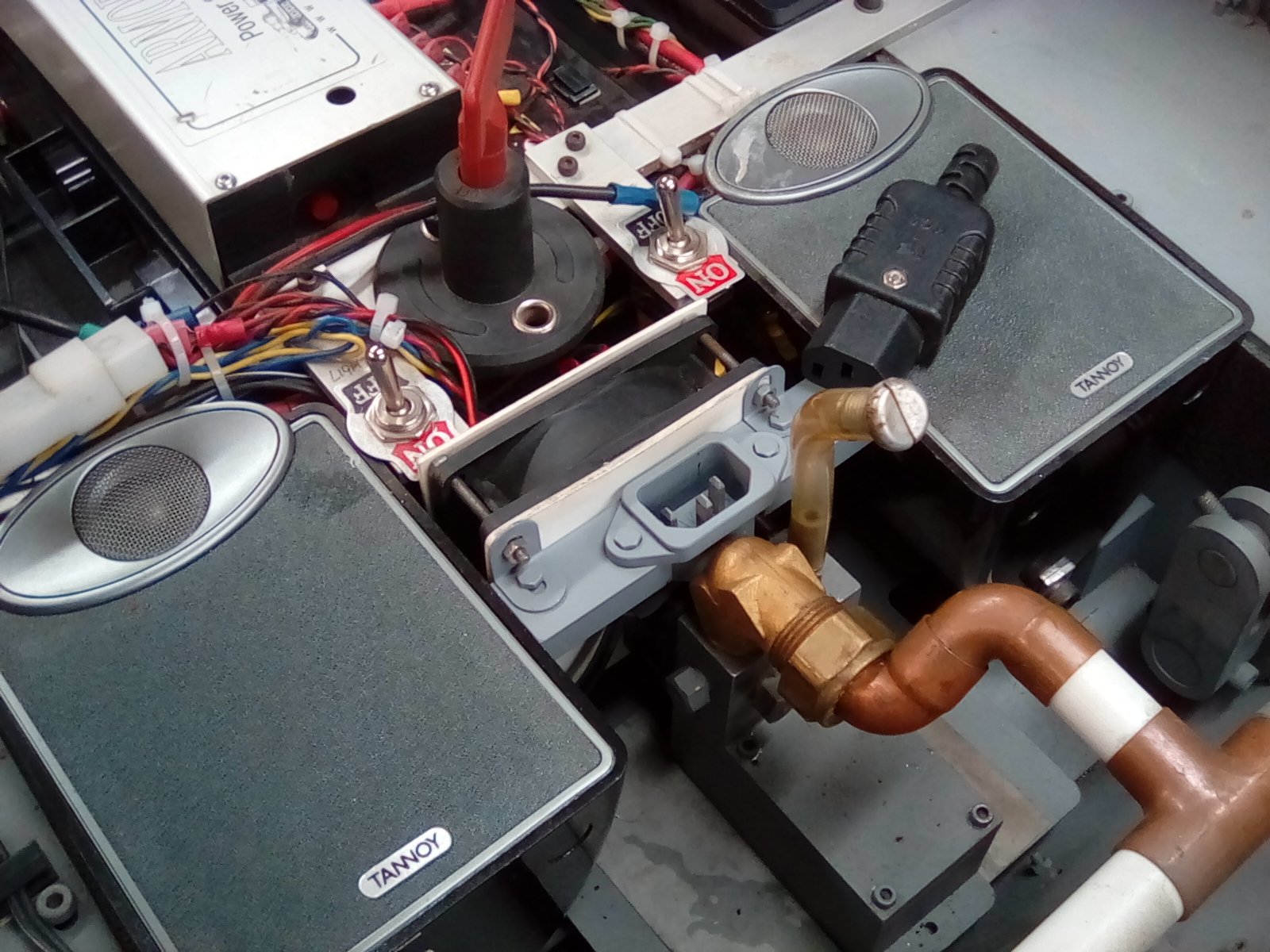

24v charging socket
24v charging socket

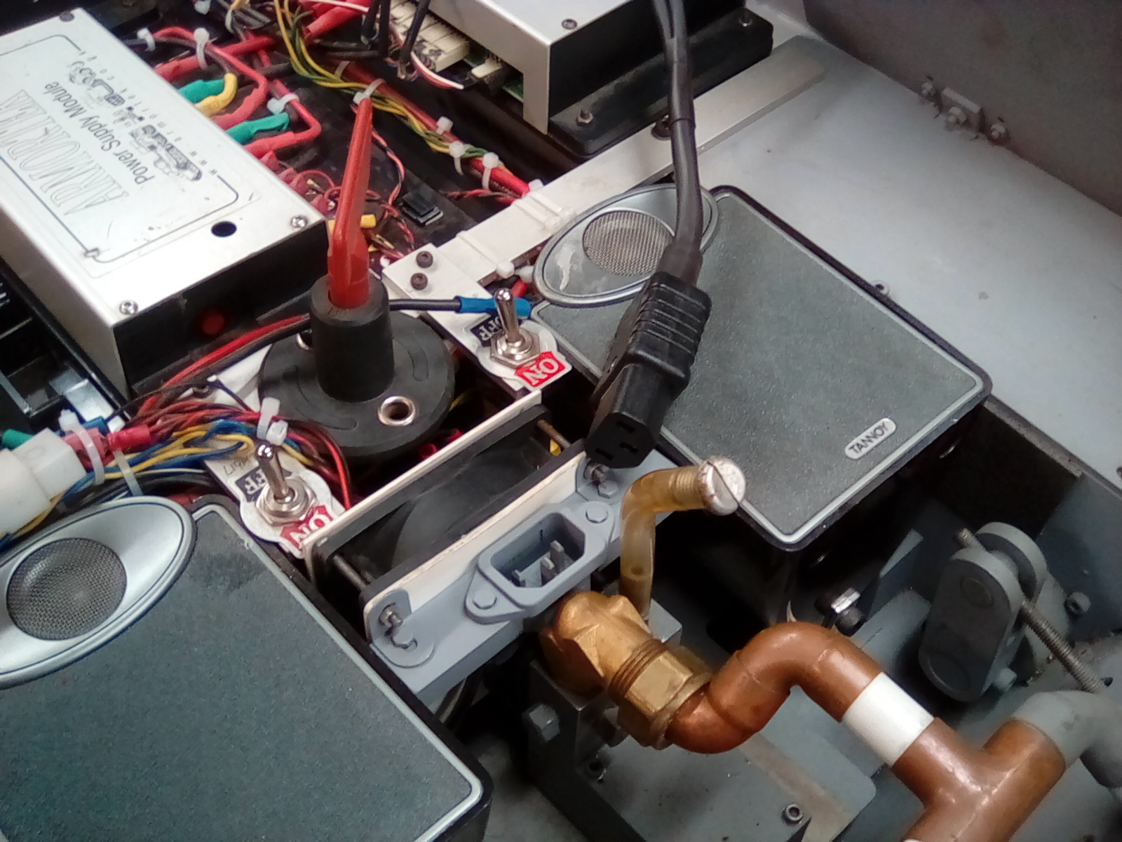

That's more convenient.
Just use crimp connectors Bryan fed from your 24v charger but be aware that socket will be permanent live!
Posts: 5132
Has liked: 1485 times
Been liked: 1695 times
Re: Tiger 2 in for some diagnostics
I loathe seeing IEC connectors used in these tanks. One day someone is going to buy one second hand and plug a mains lead into it :evil:
Yeah but they would only do it once Adrian, and they would have to be a complete dick especially if it's labelled as 24v only!

Isn't it very strange to mount such a connector for other purposes than mains connection? :shock: Initially I thought that this is the connection for an integrated charging device...... :?

24 ? Oh, I thought it said 240 ...

okay, but then you should use banana jacks for the mains connection in future to differentiate them from each other.... :twisted:

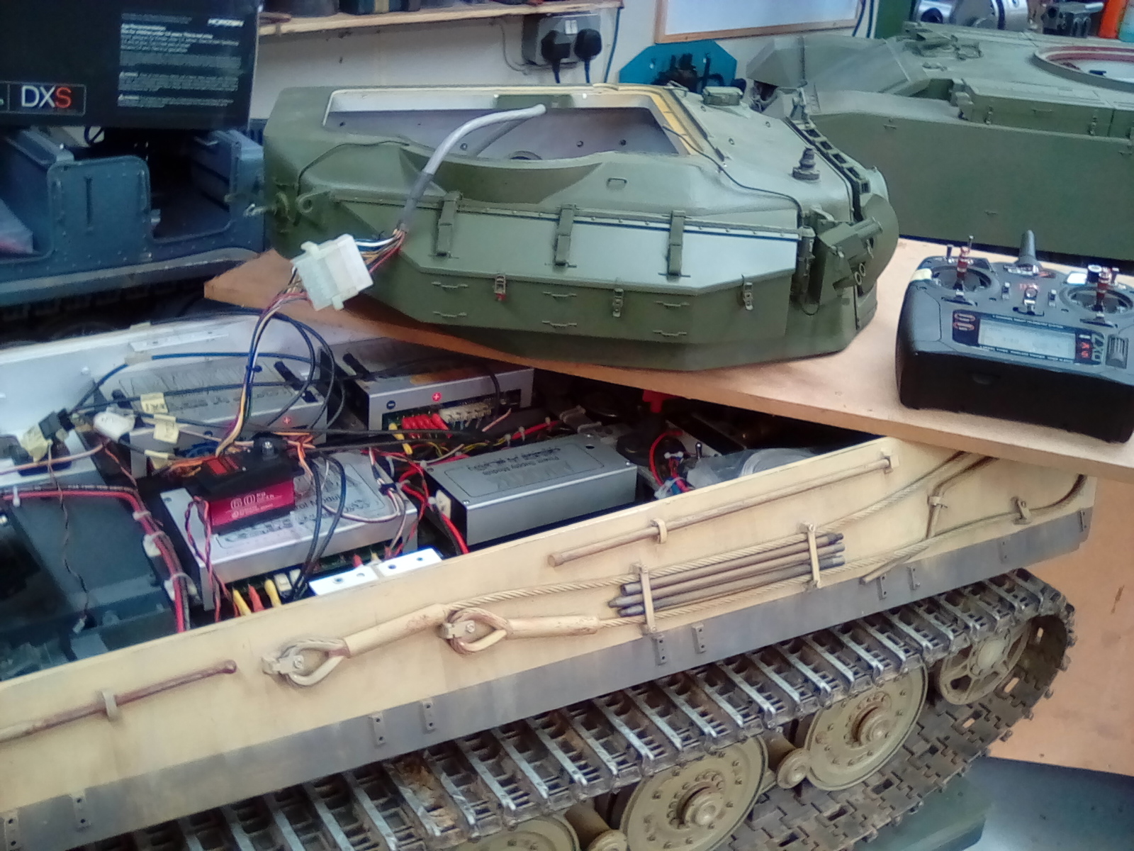

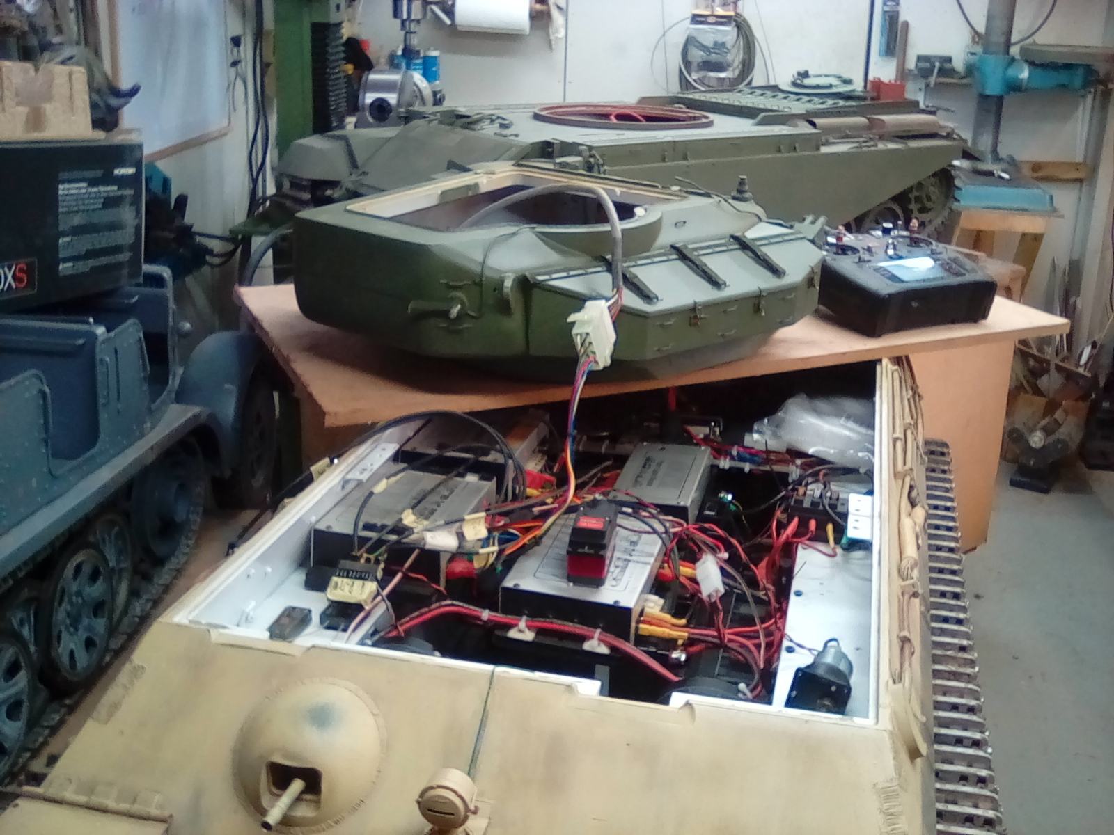

As I don't have the KT turret to check the gun elevation and depression.

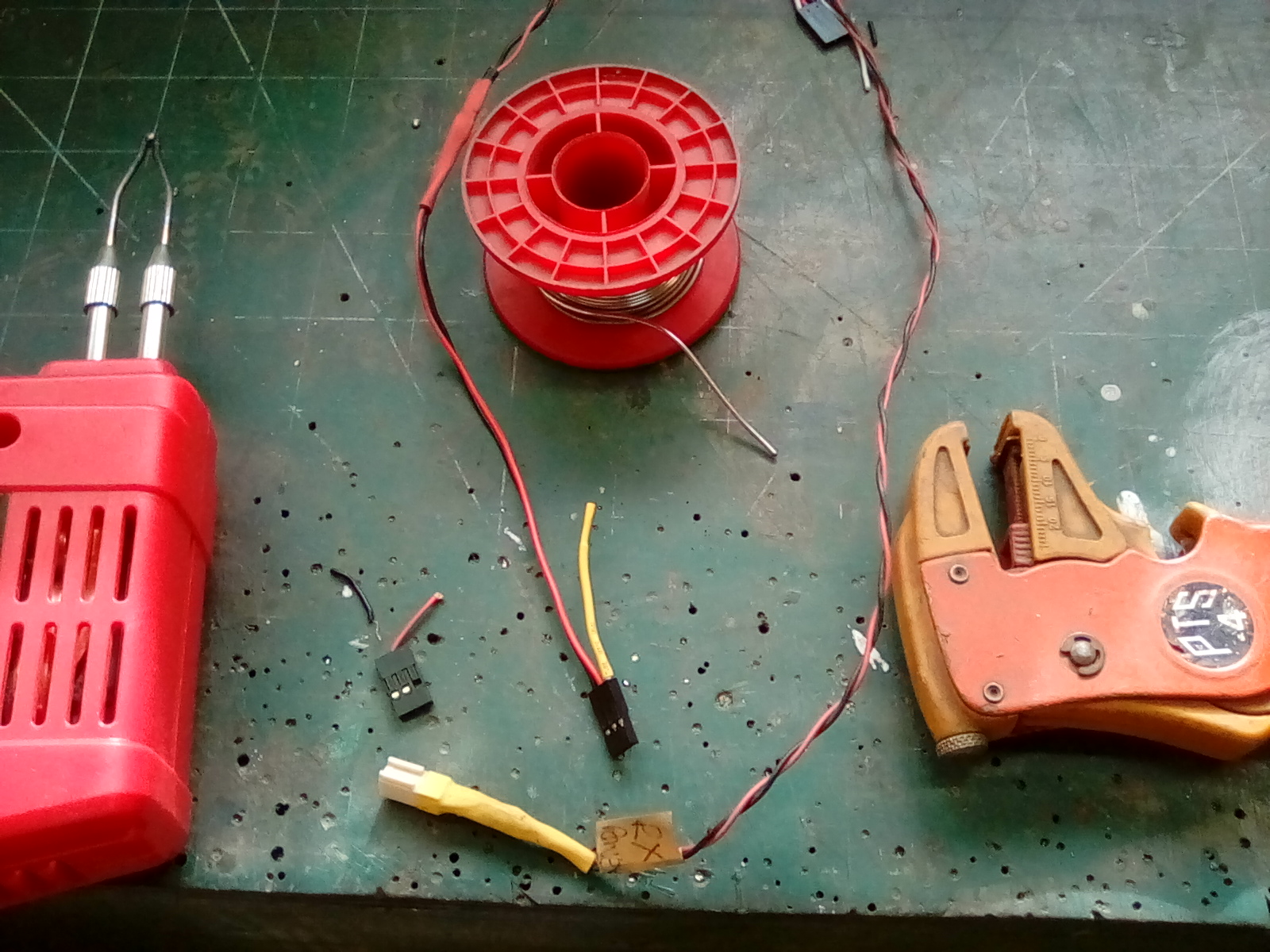

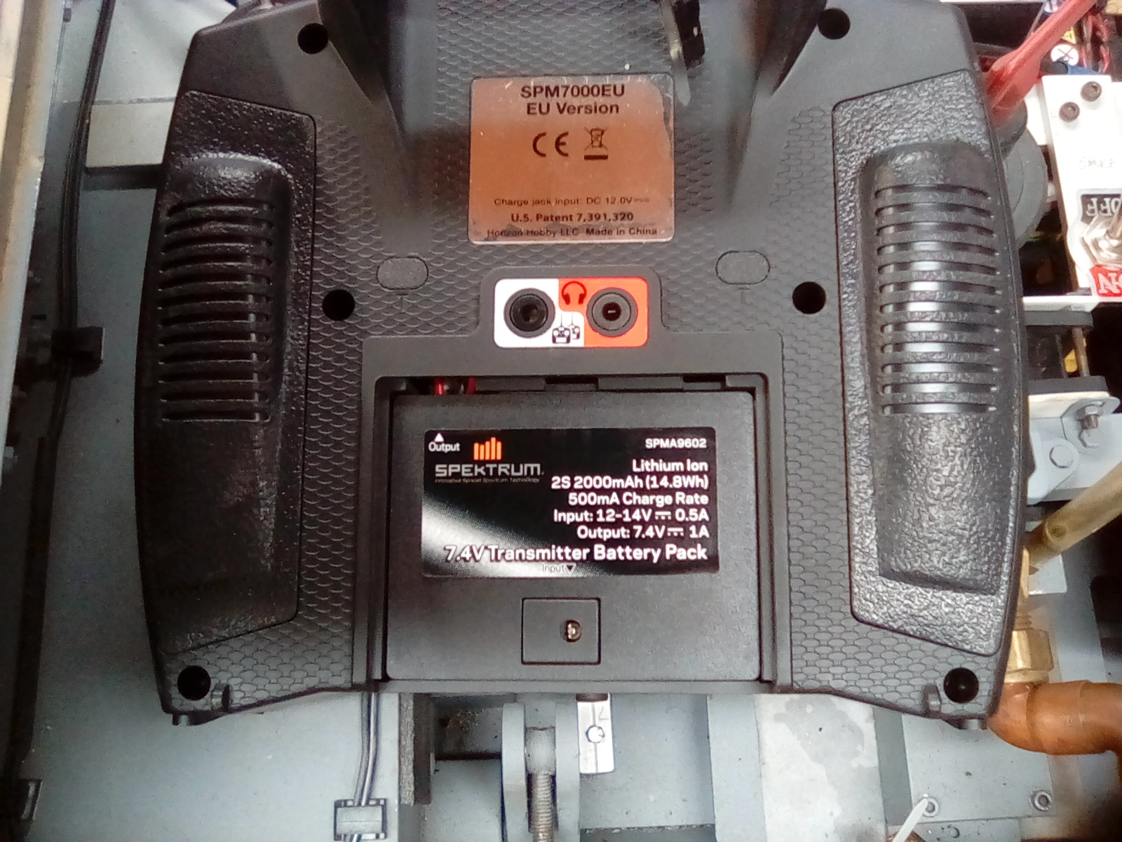

I found this fault with the rx power supply plug by chance, so made another lead up
