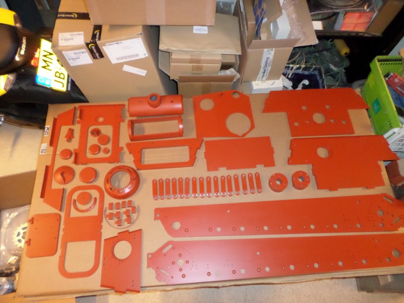

Today was a good day, it was priming time. The floor is riddled with empty spay cans.....(well, only 5 up till now).
Every aluminum part was cleaned with scorching pads, and then cleaned with Acetone.
A good coat of etich primer was applied, followed by a good coat of red oxyde primer.
Paint work during the day.
This job took most of they day, running between the Garage and the 'paint booth'.
In between I did assemble the base with the bars and installed the 2st torsion bars with pivot blocks.
I started using the button head bolts as specified with the manual, but basically every 2nd one got unusuable,
as the bit did eat away the sides. (Yes is was a quality bit, not a cheap 1ct one).
Out with the button head ones, in went the (temporary) cap head ones.
They get replaced with countersunk ones in due course.
And the pic below is an overview of all the parts primed today.
Today's painting job.

Using the dishwasher for pre-cleaning the parts should hardly be a problem, I used 2 regular tablets (i.s.o one).
and run the full cycle at 70 degrees C. One weird effect, one of the drive casings got a sort of golden glow / hue
on it, the other did not. It must some sort of chemical reaction, although I have no idea why only one part had
this effect and not other parts (out of the 20).

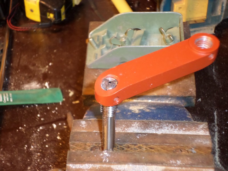

Today only a little bit of work was done, only priming a few small parts and using a 12mm tap to run through the swing arms.
Yesterday I tried to build the road wheel swing arms, but this did not go very smoothly. After only a turn or 2 the axle would
not go further, unless some force was applied. I think Brain Ostlind already made a comment about this problem.
So I got a 12mm tap at the local hardware store and used it to run trough the existing threads. Some went pretty easy,
some needed a bit of handling, but threaded holes now accept the axles and torsion bar ends without much friction.
