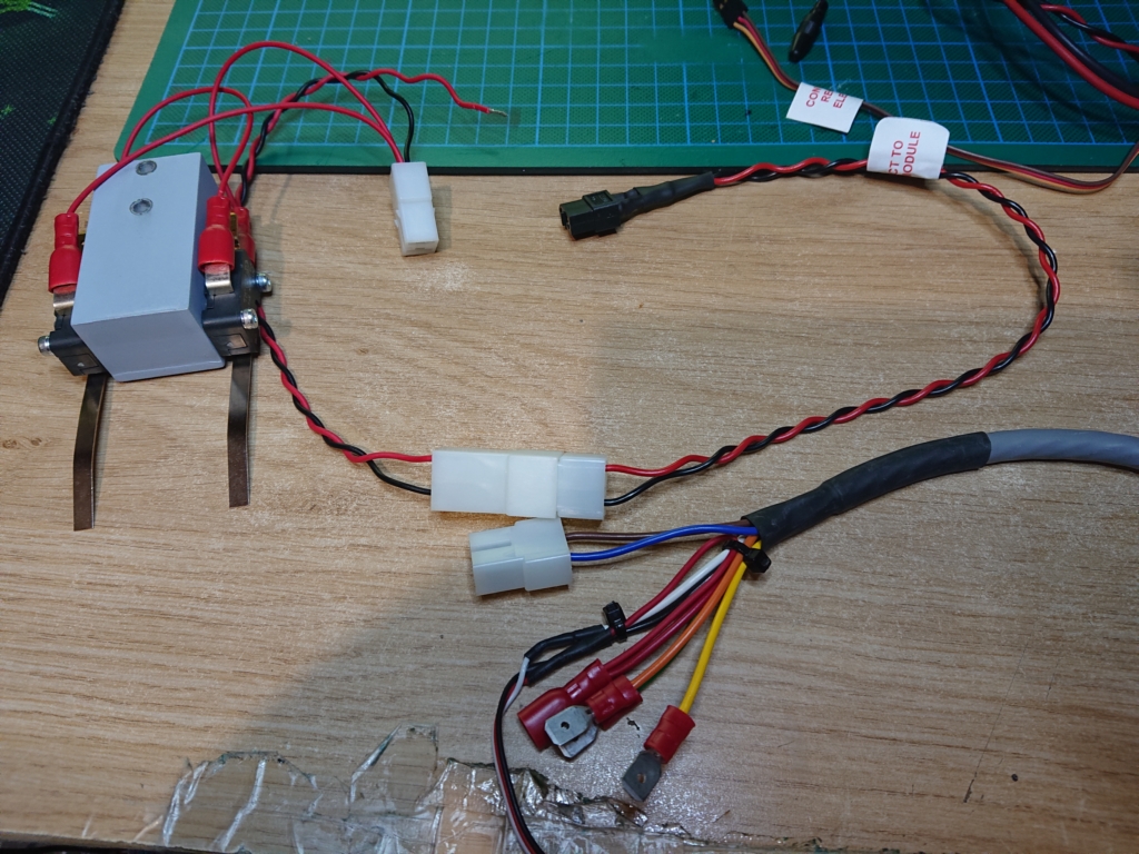

An issue while i was preparing/ checking the elevation for my comet (switching from old to new electronics) and also a question on what to plug where ?

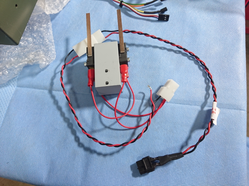

- on the harness for the elevation limitation switches, a wire has gone free ?
seems it was not crimped with the connection in the plug , so it might have been with one of the connections on the limitation switch.. but where ?
Then, the black plug is supposed to be connected to power moduel, but there is nothing on the power module for elevation ?
should it be plugged in the spare or is it a plug used in other tank model ?
and what is the use of the white plug, as elevation motor is supposed to be already powered by the motor control B red box ? (brown/blue wire plug)
unfortunately, there is nothing about the limitation switch wiring on the documentation
thanks in advance

hurray, finally got the trick !
Thanks to Chris(Fry) who gave me the info on the loose wire a long time ago, and to Adrian (Harris) , who gave me the info on the new way of working of the red boxes for elevation..
no more end switches with that version of electronics !
Didier
