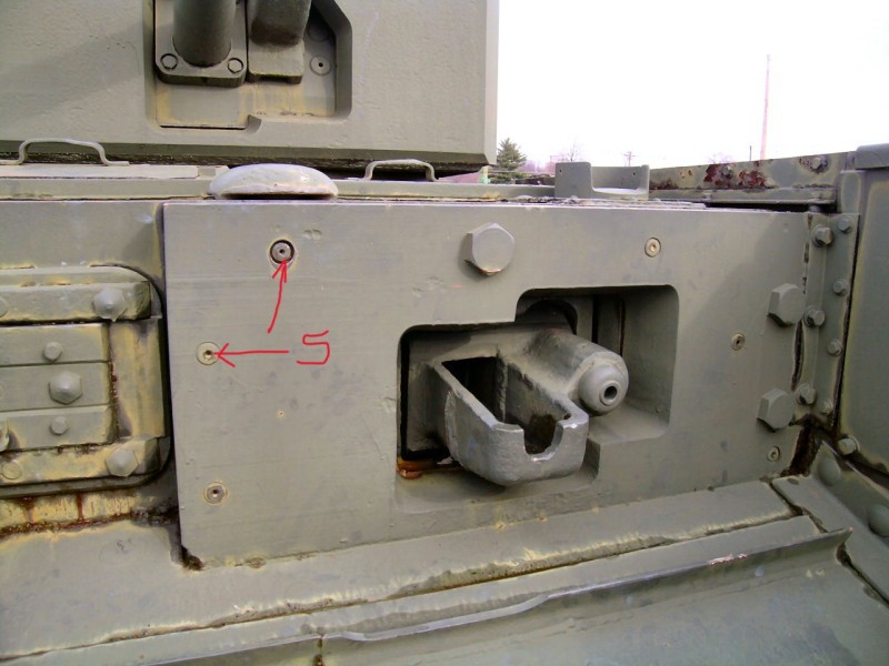

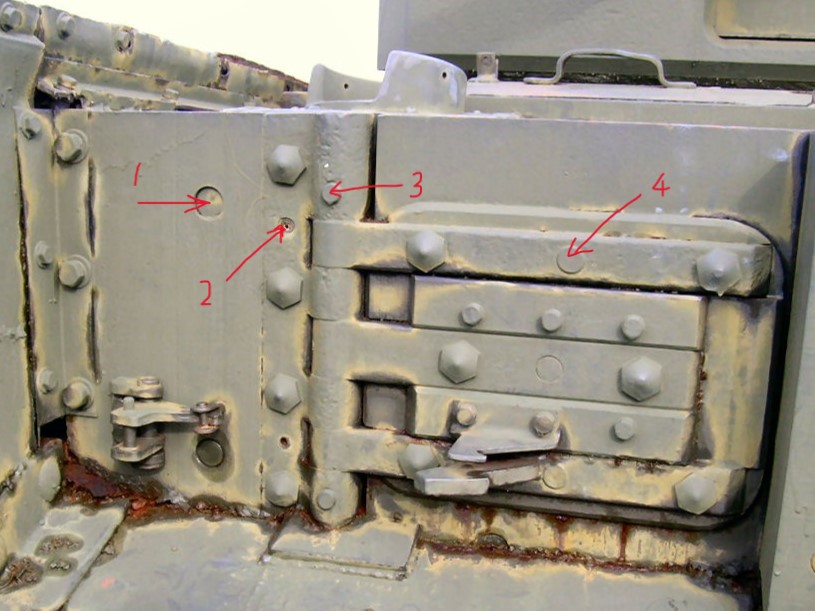

I have started the build on my Churchill Mk3 which is likely to be a slow burn. At this point in time I seem to have more questions than answers regarding the modifications I would like to make. I am leaning towards a Mk3 AVRE after the Tank Museum supplied me with some drawings of the Canadian Mine Roller and an 8 ton derrick. The pack also contained drawings of the Petard mortar, Applique armour and the side brackets.
There are some basic starting points that I have not been able to find the answer to yet, I think that someone on the forum would probably know so here goes...
I know the early Churchills had grey primer which was quickly phased out for red oxide. Would the Churchill Mk3 AVREs have had red oxide primer either before or during the upgrade program in 1943-44 ?
In the photos below what were the fittings numbered 1-5 for, and what type of fasteners are they? I like the idea of building the 8 ton derrick trailer with the generator but have not been able to confirm if they were ever used by Mk3 AVREs from the Normandy landings onwards. If anyone could confirm this or perhaps have photos it would be a great help. Thanks in advance
Gary

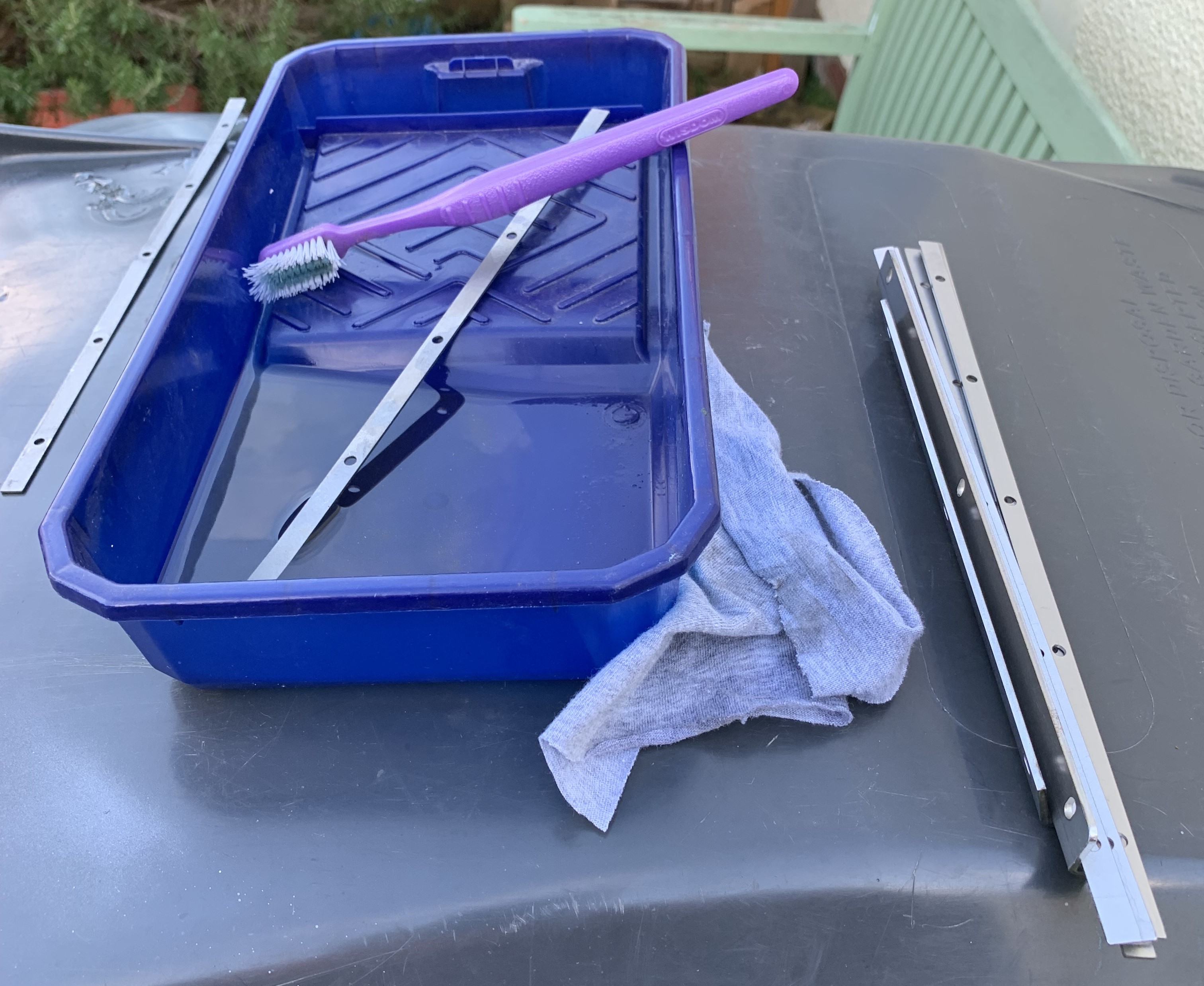

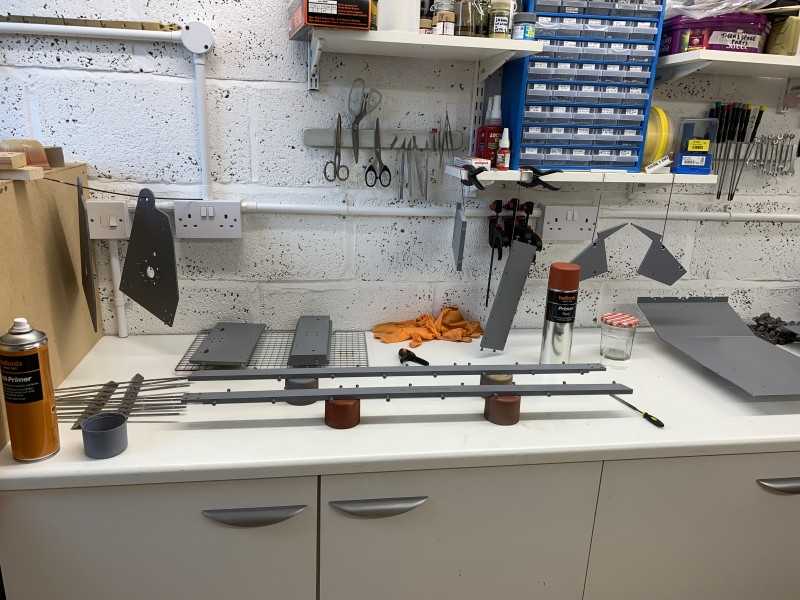

I have started work on the Churchill hull components. The usual degreasing using Upol, then deburring prior to etch priming.
Gary

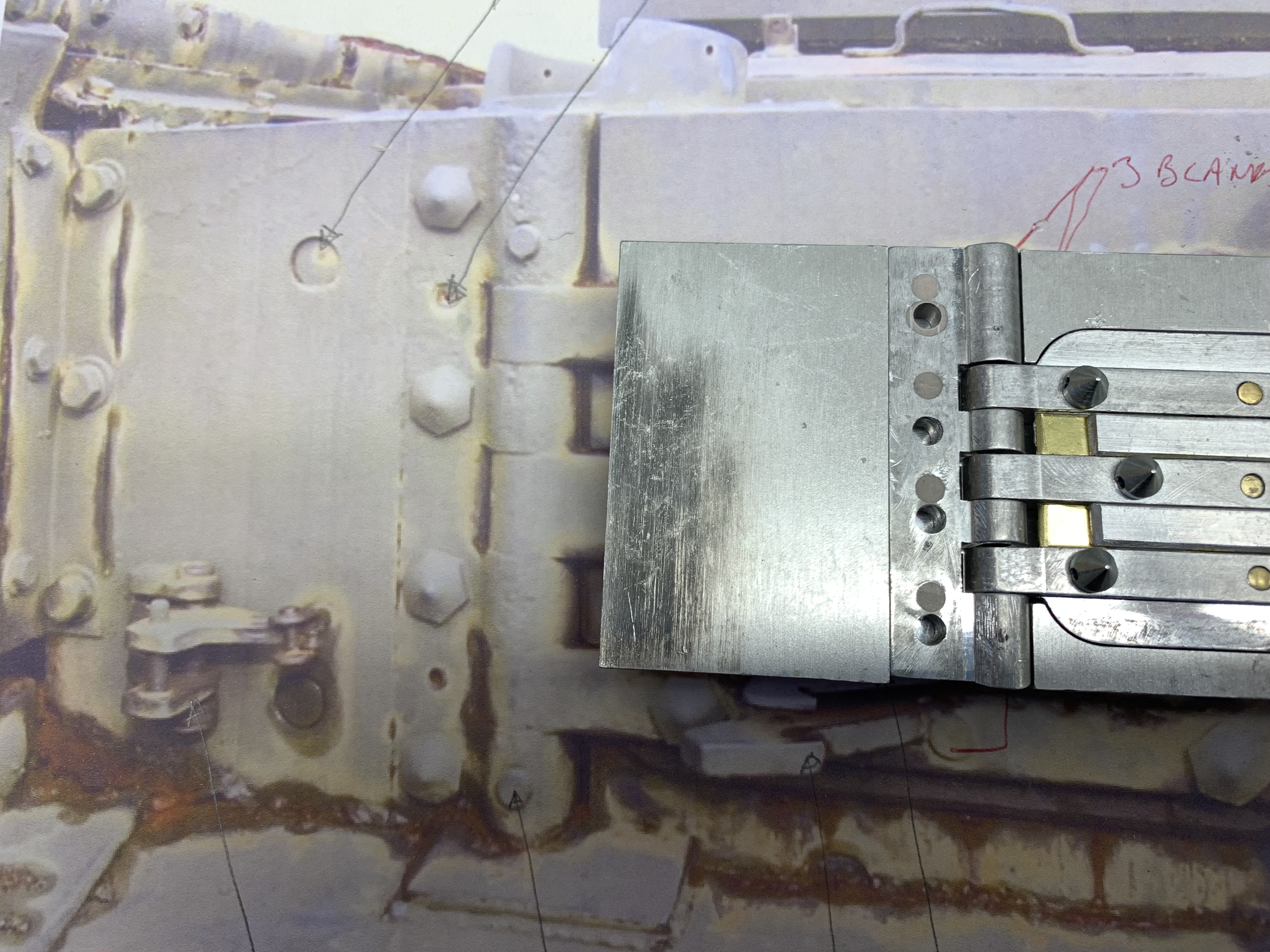

While I am still researching what tank to base mine on I have started to add detail to some parts, namely the drivers visor and the glacis plate.
I will also be adding some 10ba/11ba hex heads and the latching brackets to the visor and further details to the Glacis plate such as the brackets at each end. The detailing is the most enjoyable part of the build for me and as the research is taking longer than expected I find it quite relaxing
I am 95% sure my build will be an AVRE Mk 3 with applique armour, brackets and a Petard mortar. I really want to add a significant extra such as a Canadian indestructible roller, 8 ton derrick, folding bridge etc. This is the part of the research that is taking a while as I want the AVRE Mk3 and attached equipment to be in the period from D-day until end of 1944 and I have gone down a few dead ends as more info came to light.
Gary

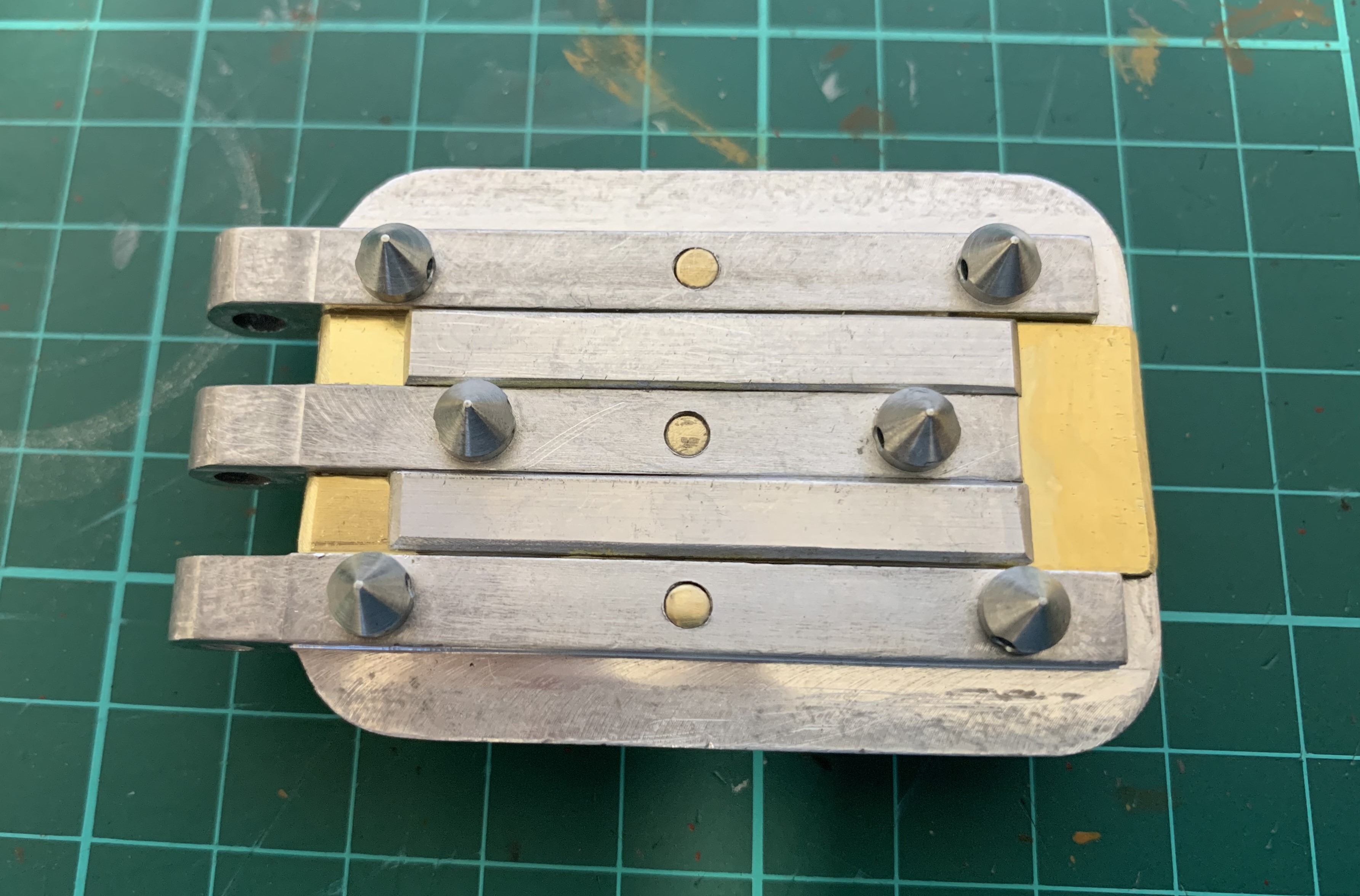

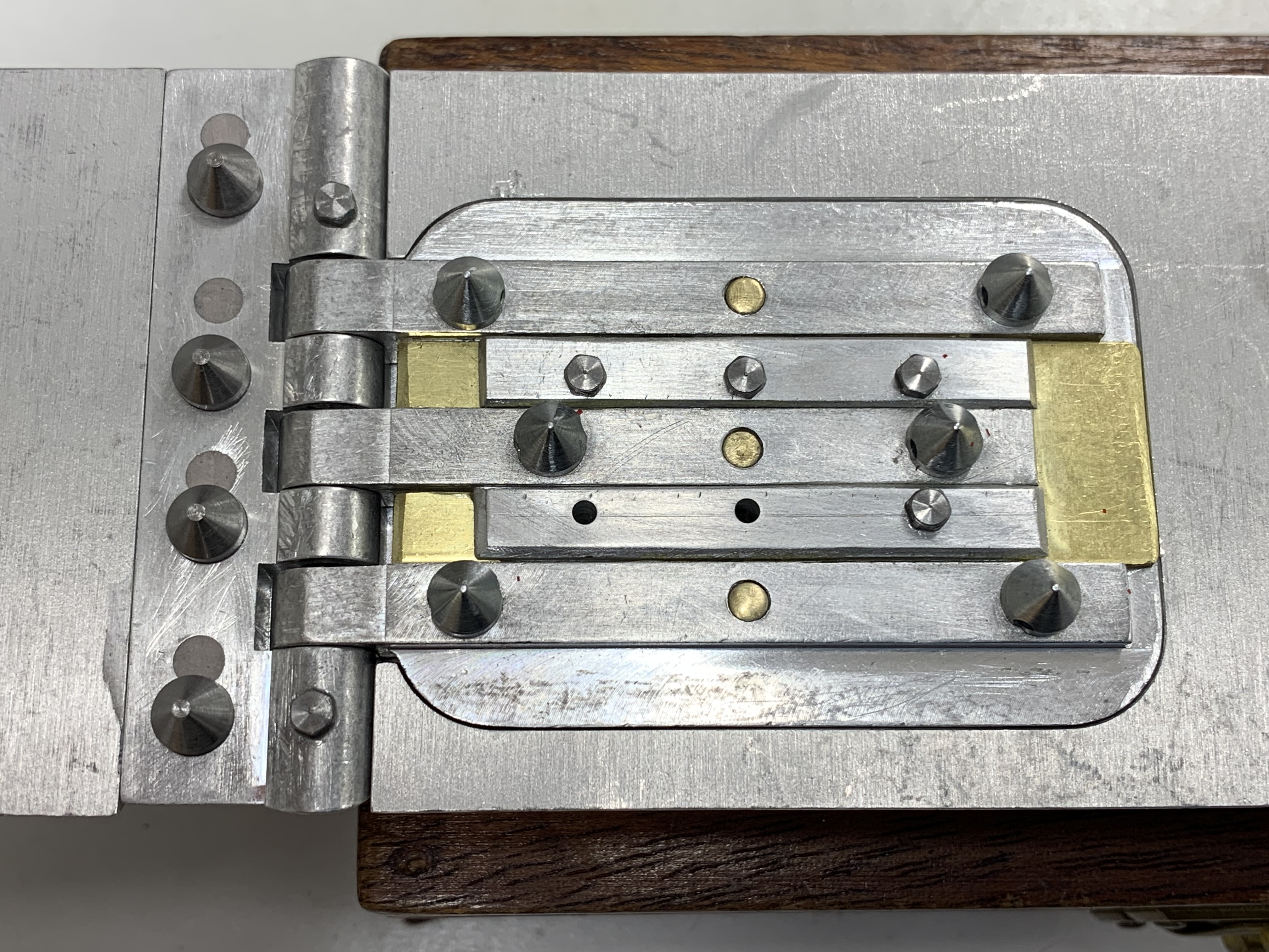

I decided to add further relief detail to the drivers visor. It needed the centre hatch relief to make it more realistic. This required removing the two aluminium strips, cutting and shaping a brass panel and epoxy gluing them all back together. To remove the aluminium strips which had been epoxied in place I used my Dremel blow torch, then carefully slid a blade under them and they popped off.
I have ordered various BA and metric hex bolts including 1mm, 1.6mm, 10BA and 12BA to use as detailing and hopefully they will arrive fairly soon.
Gary
Gary

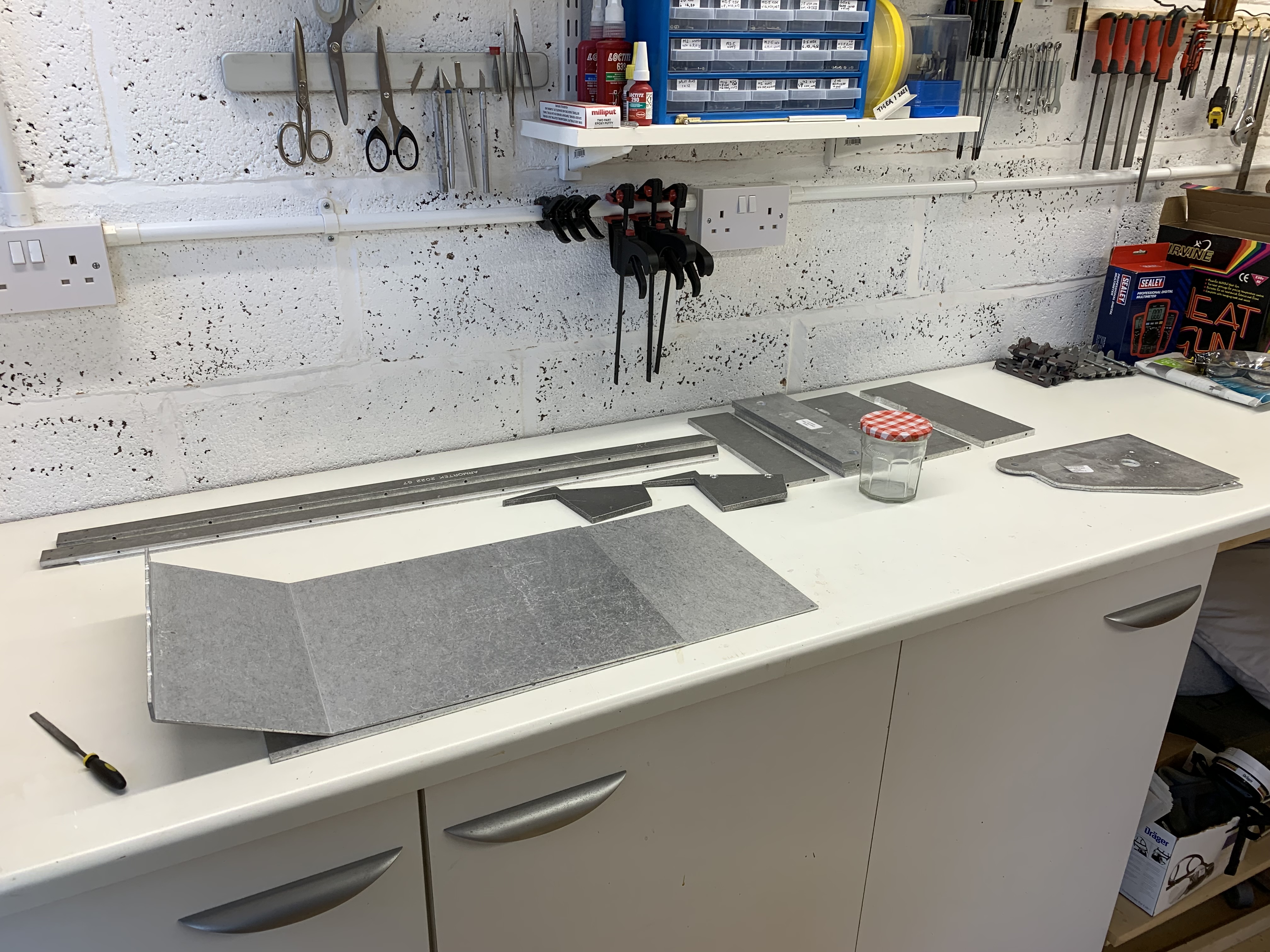

While I wait for the Tank Museum documents to arrive I have continued detailing the glacis plate and visor. It was noticeable that the visor could not be opened past 90 degrees due to two of the cone head bolts clashing. When checking against a photo of a Mk3 the bolts are in the wrong positions so I set about altering them. A note of caution, due to the chamfer at the bottom of the glacis plate the lower bolt cannot be drilled all the way through. I suspect this is the reason Armortek placed them the way they are on the kit.
I have used 10BA hex bolts that are epoxied in place on the visor and will be making the latching system hence the two spare holes. I am really pleased with the amount of detail that can be added to the kit but suspect I will be ordering a shed load of small bolts, etc.
Gary
Gary

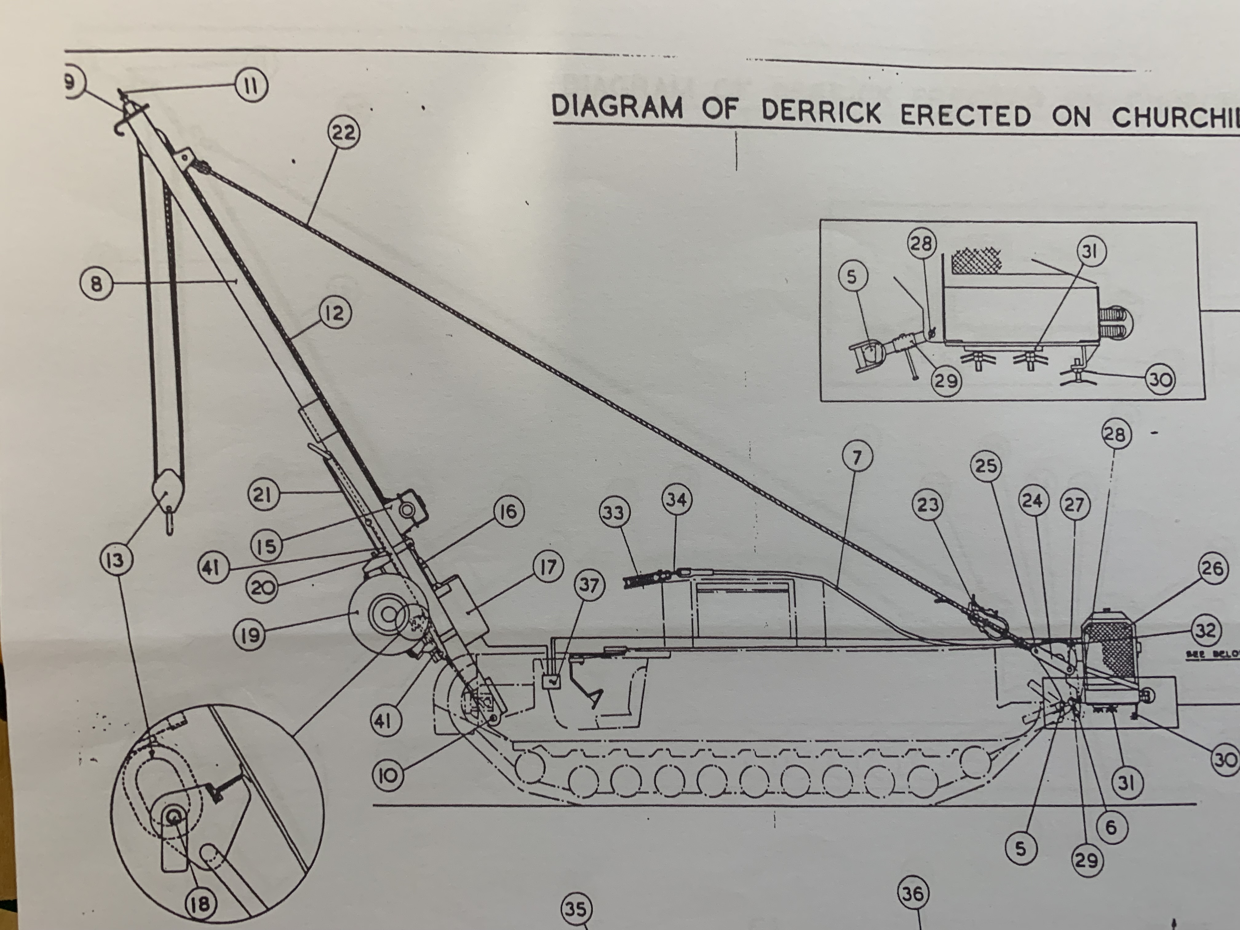

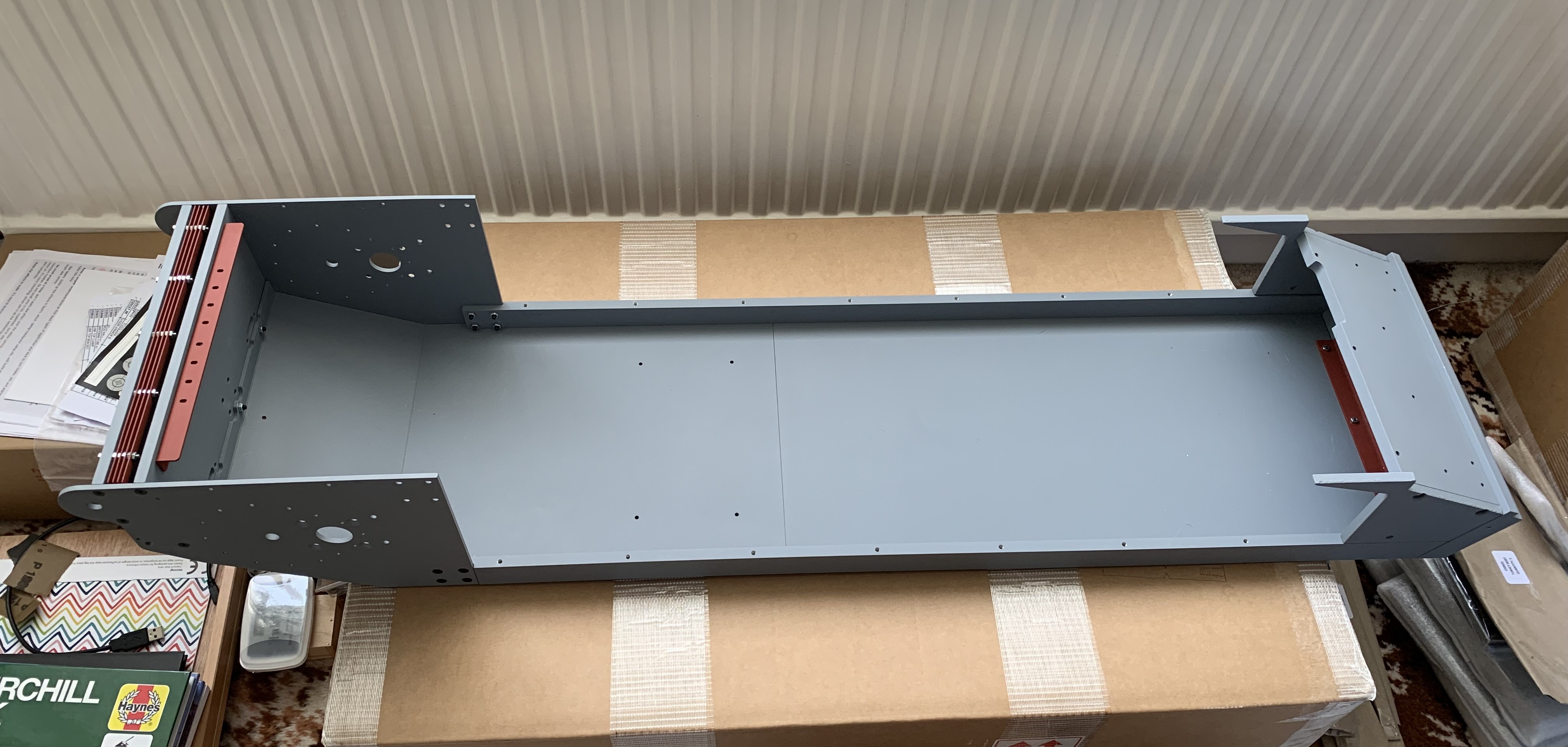

I have started to assemble the hull to see what changes I need to make for the connection points of the 8 ton derrick trailer. I have received the documents from the Tank Museum which contains diagrams, photos and a full description of how the derrick was attached and used.
I was worried that the derrick was not used on the Mk 3 AVRE during the last 18 months of the war. Luckily the document gives some background which I will add here as it may be of interest to those building a Churchill AVRE with fascine carrier and bundle.
8 TON DERRICK
The 8 ton derrick was based on an electric mobile crane made by Henry J Coles and used a Ford V8 30hp industrial engine. The length is 27' 5" (8.38m), the width is 7' 6" (2.28m) and the height is 7' (2.13m). The trailer with stowage weighed 3 tons 1.75cwt. When attached to the front of the Churchill the derrick and wheels weighed 2 tons 3.5cwt.
The generator would be attached to the rear of the tank using the two existing eyes, the tank would then move into to position to have the derrick attached at the front. The tanks own towing cable was used to assist in raising the derrick which could go to a maximum of 60 degrees. The load was dependent on the angle of the derrick. The tank could be moved with the derrick in place using 1st and 2nd gears.
The derrick and trailer were designed to provide a mobile crane unit particularly suitable for loading fascines onto the fascine cradle on AVRE's. The derrick could be used by a crew of four men and used on any Churchill AVRE Mk2 to Mk7. It could be assembled in under 30 minutes.

In the meantime I have a lot of hull parts to degrease and etch prime
Gary
8 TON DERRICK
