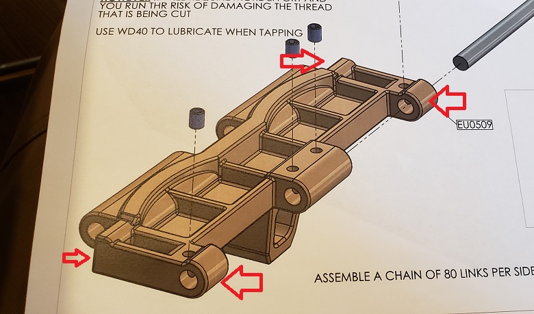

The stiff link could be the sole problem. I would take those links out and file them so they are not stiff when assembled. I had to file many links a tad so they were smooth running. Sometimes the track pin hole is not perfectly centered or perpendicular to the link and the links will bind when assembled. This will definitely cause a jump. Also there is very little clearance of the sprocket teeth to the holes in the links - the sprocket must be carefully aligned to the rest of the track, wheels.

My tracks are smooth as silk, but took some time to assemble. The track pin hole varies in location a small bit and can cause binding links. Also the links are from a 2 part mold so have some flash in the location shown below (at red arrows). I filed a little material from these locations on sticking links and this eliminated the binding.

Sorry gents, Yes I got the issue resolved by pulling some stiff pins and reworking a couple of tight holes for a much better alignment for the pin into the link. I did have to replace 1 sprocket that got chewed a little too much. A new issue is stripping out the socket on the 3mm track screws. Gone through 4 of the wrenches.
