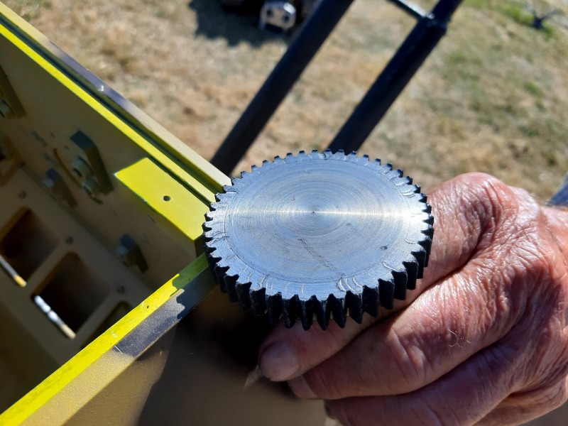

Getting towards the end of the day and the left hand track on the Elefant wouldn't go backwards. Forwards was no problem, but it made driving quite tricky as any attempt at reversing just resulted in a right track turn.
Having removed the motor and proven that it was a mechanical problem, I isolated it to the left hand sprocket.
Removed the sprocket and found that the drive gear shaft was really stiff forwards and blocked backwards.
Removed the gear casing and found that:
1) The drive gear wasn't glued into the bearings, so it could rub on the hull side. This meant there was at least 5mm of play in the sprocket.
2) The drive gear had worn a lip around the edge of the teeth

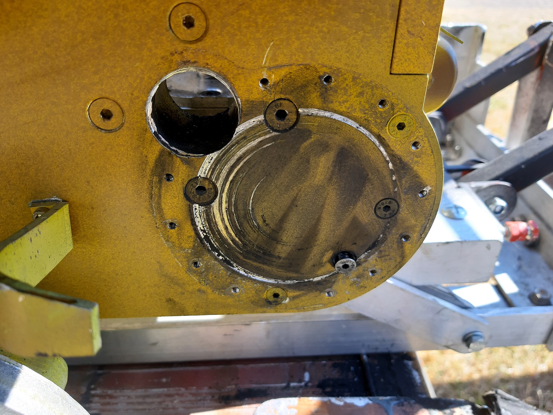

3) This lip had just caught the top of one of the countersunk hull bolts, and unscrewed it
4) Once it had unscrewed a little way, it had started to catch on the drive gear, and was acting as a pawl, hence the lack of motion backwards. See the witness marks in the drive gear where the bolt head had dug in.
Quick and dirty fix was for Denny to file the gear smooth again:
I then discarded the damaged screw and rebuilt the drive casing and sprocket so it could be driven back into the van.

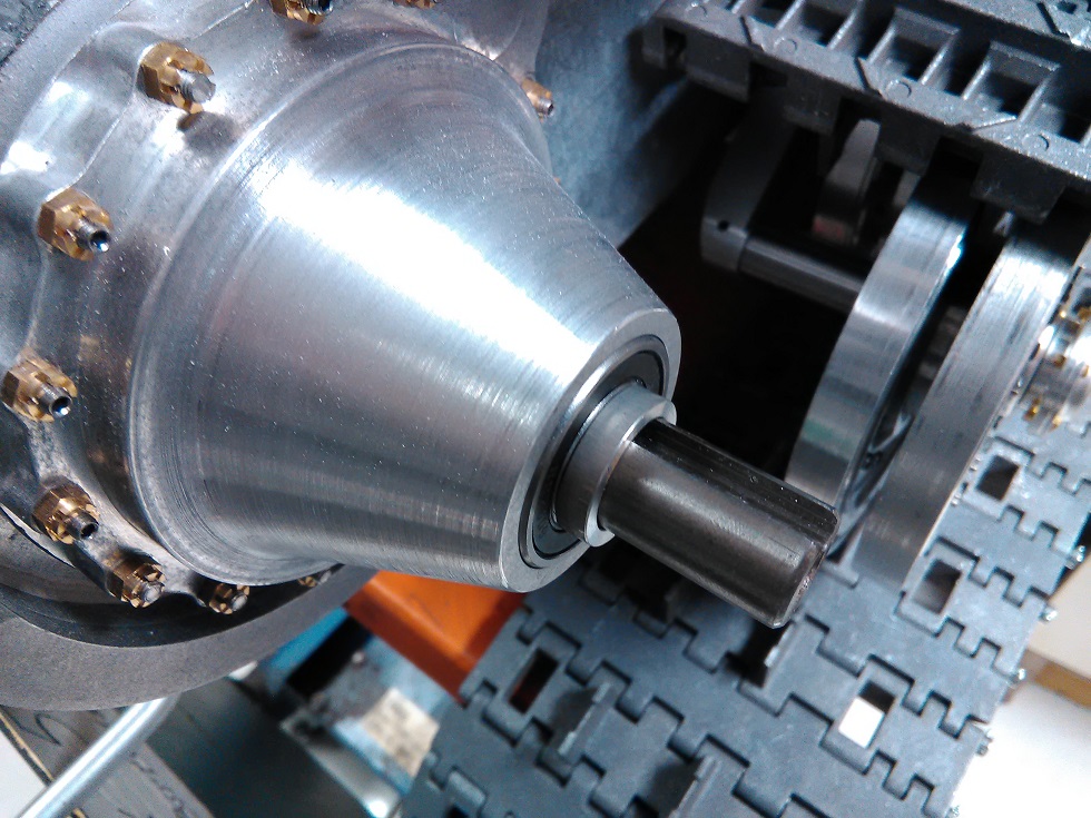

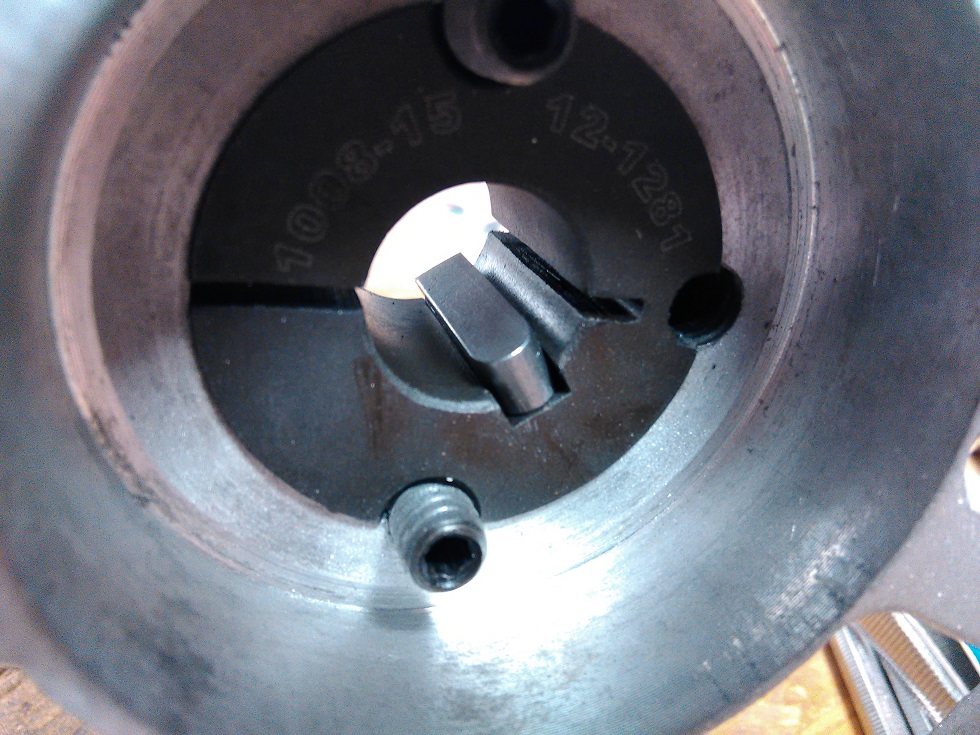

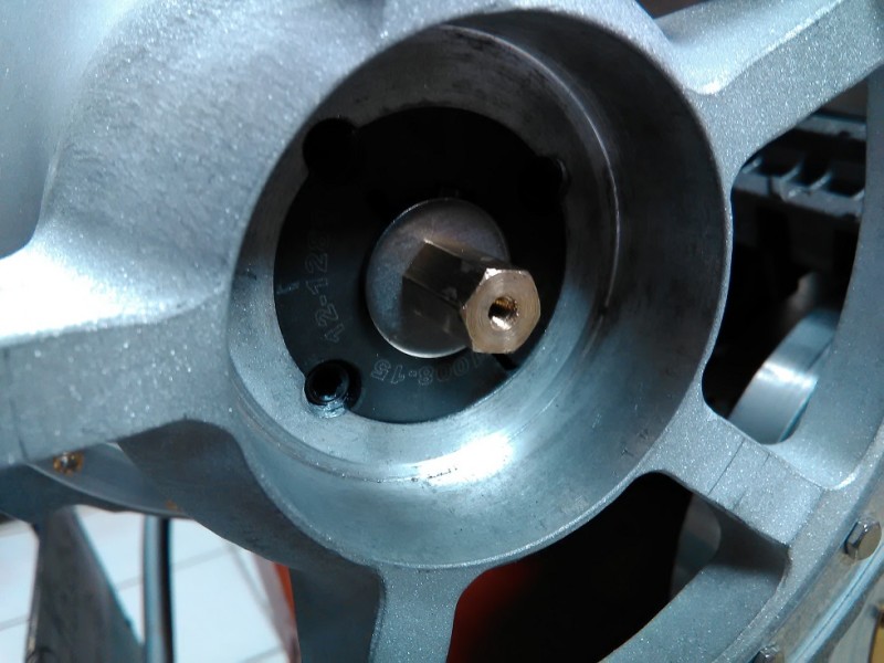

Hello folks,
driving my KT since years without any issue. Just thought to show what has been my approach to fix any axial freeplay.
The taperlocks have far enough power to hold the sprocket in place so I lined up the tracks and wheels and evaluated the spacer size.
Important to shorten the " Nutenstein " to the lenght of the taperlock bush. Any Grease should be of course the standard.
In one go I made the centrefix for the hubcaps
Maybe something of interest for other builds ?
cheers from Cologne,
Uwe
