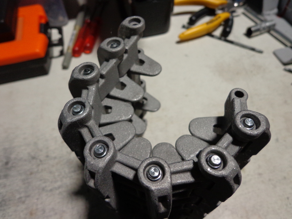

I have managed to found a very good quality foundry that have produce some very nice track links and so I have added more links to the Tiger 1 early and King Tiger links that I am currently having made, and yes unfortunately I only have German vehicles at this point so I am only doing links to suit.
Panzer III
I have an early P3 that has been throwing the right track for some time and after some investigation it would seem that my track links have a problem. When I lay the track out flat and perform the “how much slack do I have” bend test I was very surprised to see that the tracks curved considerably in one direction but only just off straight in the other. My estimation is that the pin holes in the links are not parallel, has anyone else observed this on their tracks?
So best fix new links, and since I have this new foundry why not...

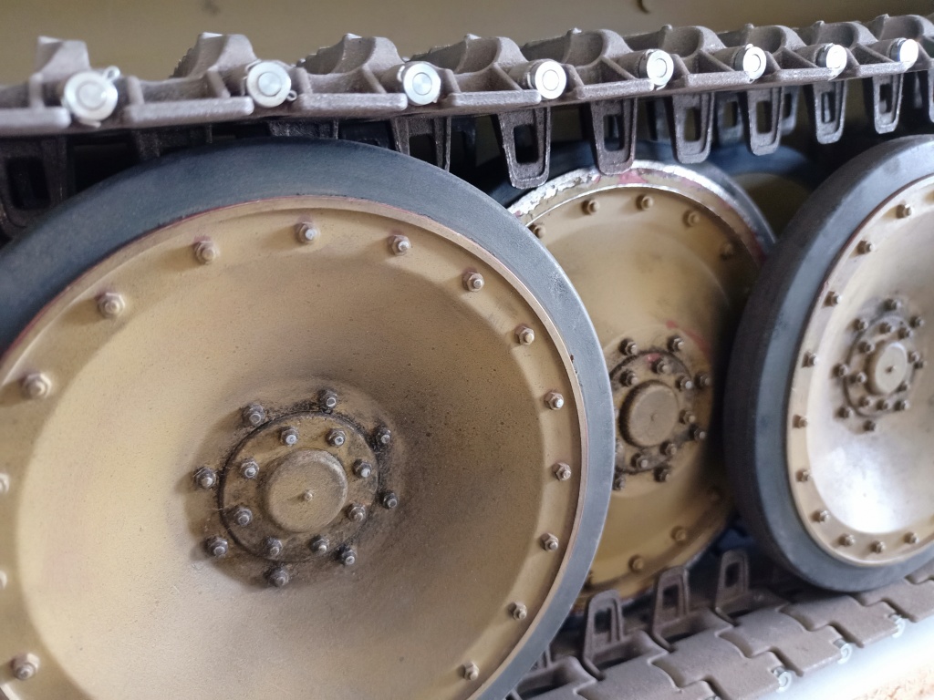

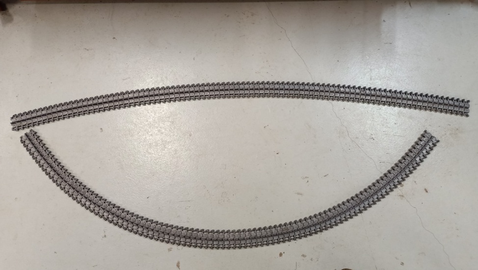

The Panzer III samples have arrived and I must say I am impressed they look better in the flesh than in the photos, but that could just be my old eyes.
The original link is what I based these on, I didn’t think they would be able to get the right look but I think it is just right not a new link look I know but with a little mud?
Liam

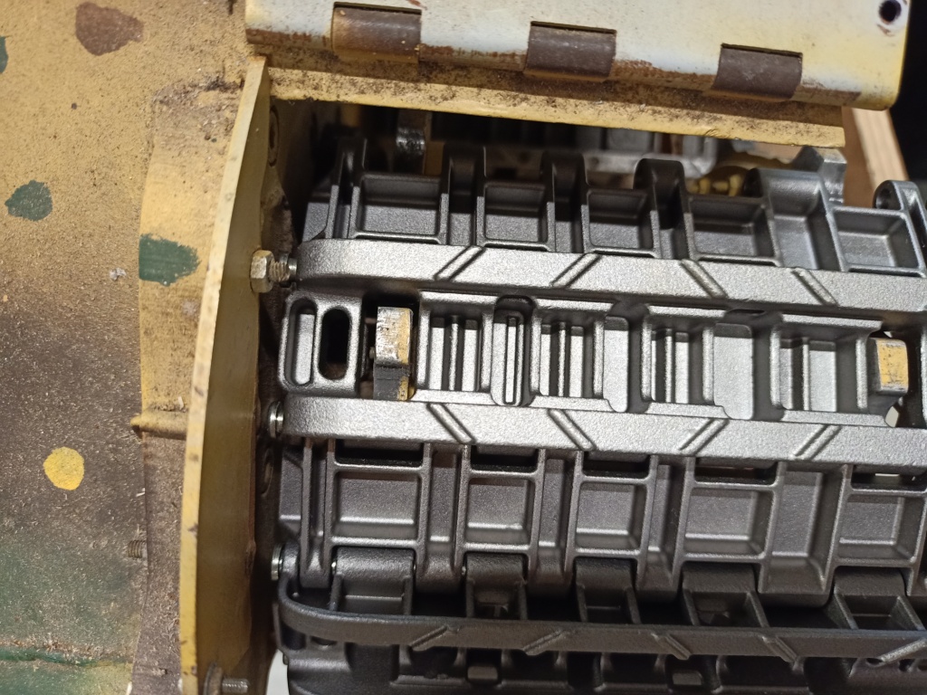

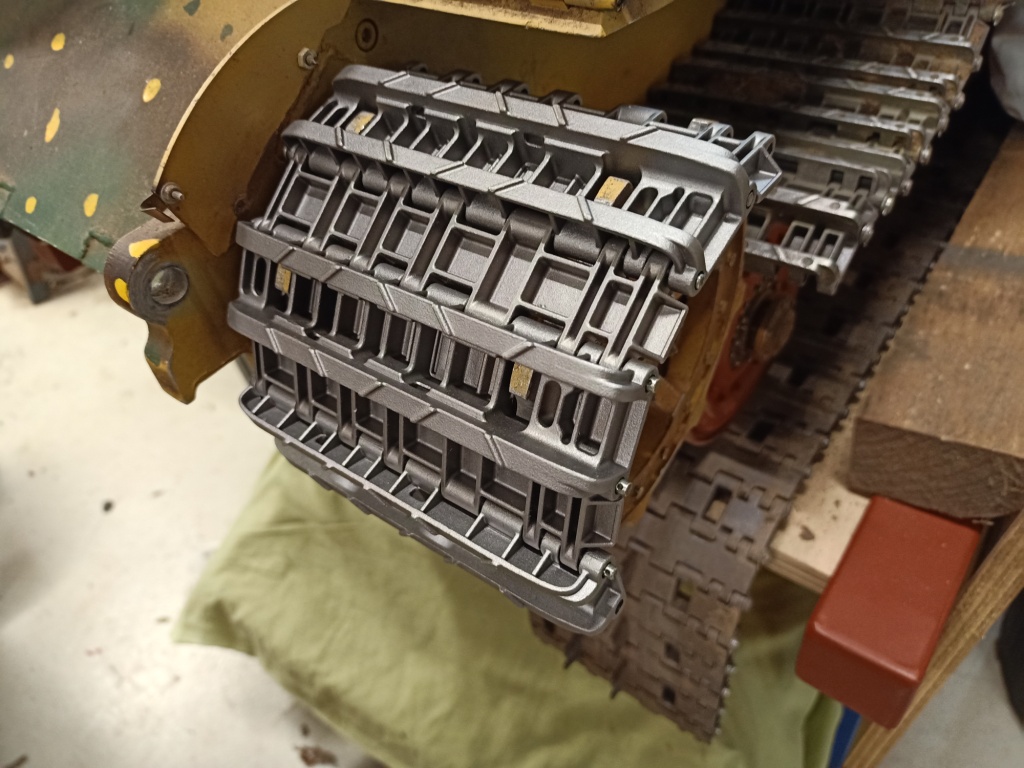

Apologies to those that I have been late (or missed) replying to, things are very busy down here, but I have finally finished the testing of the track links. Unfortunately I spent more time on the charger than driving, thinking some of them new fangled batteries might be needed, the upshot was a lot of very satisfying driving in the mud and the dry and I am very happy with my new supplier as the links ran faultlessly.
King Tiger showed a little wear on the aluminium drive sprockets mainly on the areas that the B link runs on but it is not a problem just very loud track noise which I think is prototypical? I will be making steel drive sprockets in the new year that match the links but I believe the aluminium sprockets will last the life of the tank.
The little Panzer III has never run so good, admittedly I did do a full service on the suspension but I believe the tracks made the suspension work as it should. I am very happy with the outcome and think that the links do make a difference to the look of a driving tank.

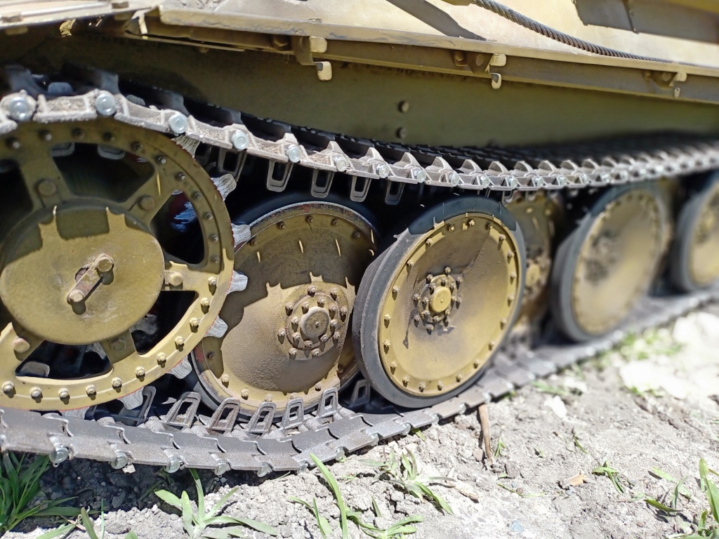

I finally have some time to update the progress of the Panther track links, it has taken a lot longer than expected but the results are worth the wait. As my Panther is still some time off being finished I had to use a friend’s Jagd and a few weekends back we managed to run up a few more hours drive time and I am very happy with the links fit and drive. What was very surprising was to find that at the end of the day when I removed the tracks I found a small rock between the guide horns with no damage to the tracks or tank, the benefits of running loose tracks?
The links can be ordered with split/cotter pins or press fit roll pins?
Anyone interested please send through you address details and I can quote including freight.
