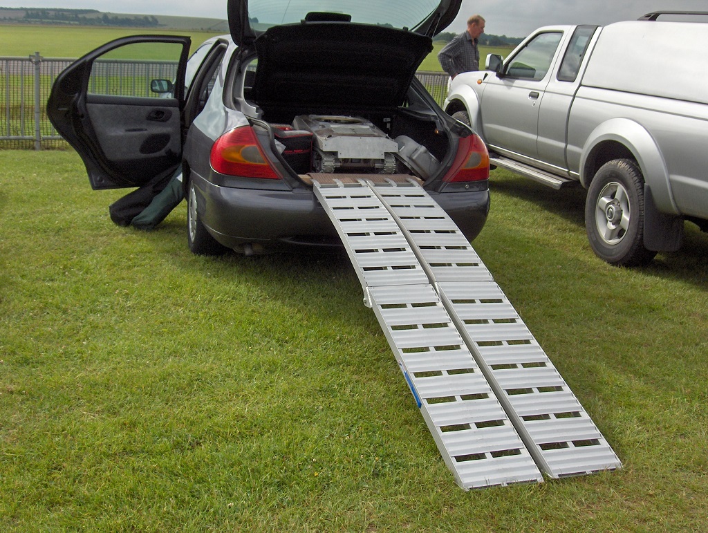

I've posted this before but it works and several people in our group use these or similar.
For the van I've bought a shorter fold in half sideways ramp which will fit across the back and act as a chock.
The loading height is lower so it didn't need the length of the ones above. I use them now to load into the car,
or to drive up onto work tables for repairs etc.
I've glued 3mm rubber matting to it with carpet spray adhesive and it seems to work OK. Only just recently had a piece of the rubber torn off.
Everything from the JagdTiger to the T-34 climbs it OK, unless the tracks have been polished by running on grass.
Except the M3 Grant. Which couldn't climb a mole hill
Look for ATV ramps rather than wheelchair ramps, as they tend to be smooth, whereas the ATV ones have ribs or patterns to allow the tyres to grip.

Gerhards extra extention into the car is a worth while extra.
Taking the pressure off the flimsy bumper. Also prevents the model at "tipping point" trying to push one ramp outwards with disastrous results all round. I have something similar but less sophisticated.
I'll "foot" the ramps at floor level to prevent any ramp movement on smooth surfaces.
Single stick control leaves a hand free to steady the model, helpful as I'm a rubbish driver.
It's all about time, don't rush it.

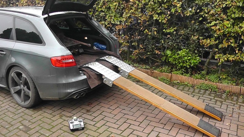

I'll put a picture in a few days time. But their really ugly.
2x Scaffold planks, covered with industrial office carpet tiles, each one has a sliding piece of 6mm channel which can positioned and locked on the ends, a flat extension bridges the bumper and heavy duty door hinges allow a flat 6mm plate to flip over the car rear bulkhead into the boot space. Heavy too.
Sounds better than they are, trust me,
but they do the job.
Gerhard's are far sweeter.

Found! one set of ugly ramps. Checked for wood worm before use.
