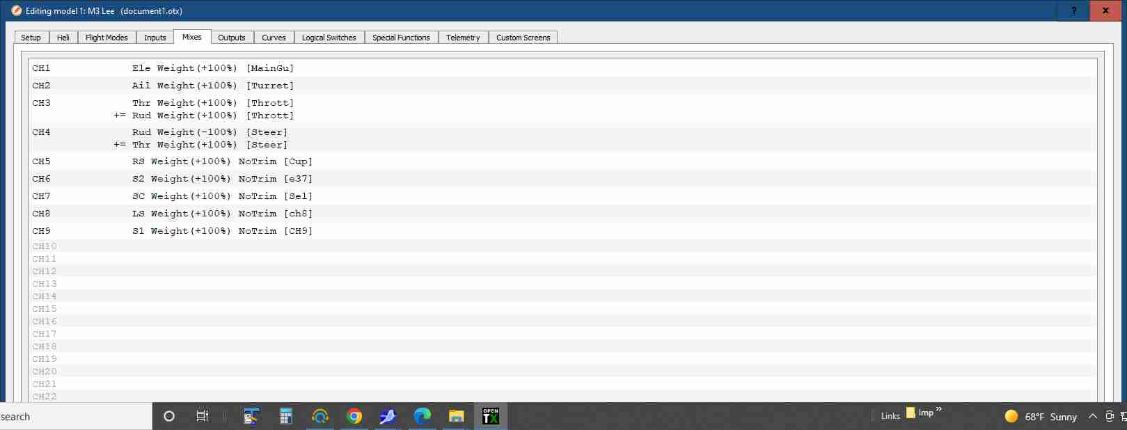

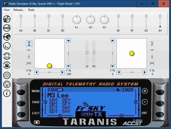

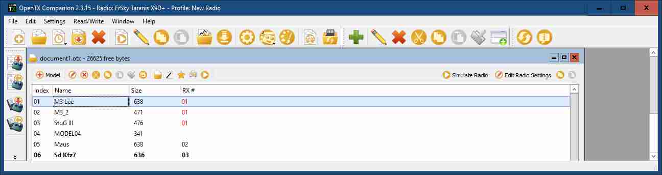

As a previous poster said I'd advocate OpenTx, I use OpenTx on a Taranis (X9D) but I also use OpenTx Companion
so that I can more easily change the configuration and test it. So far my mix needs for these models has been very simple
however I have OpenTx on other systems used for my more complex models and the mixes can get creative - made all the more
handy by using the PC interface of Companion.
And it's free!
