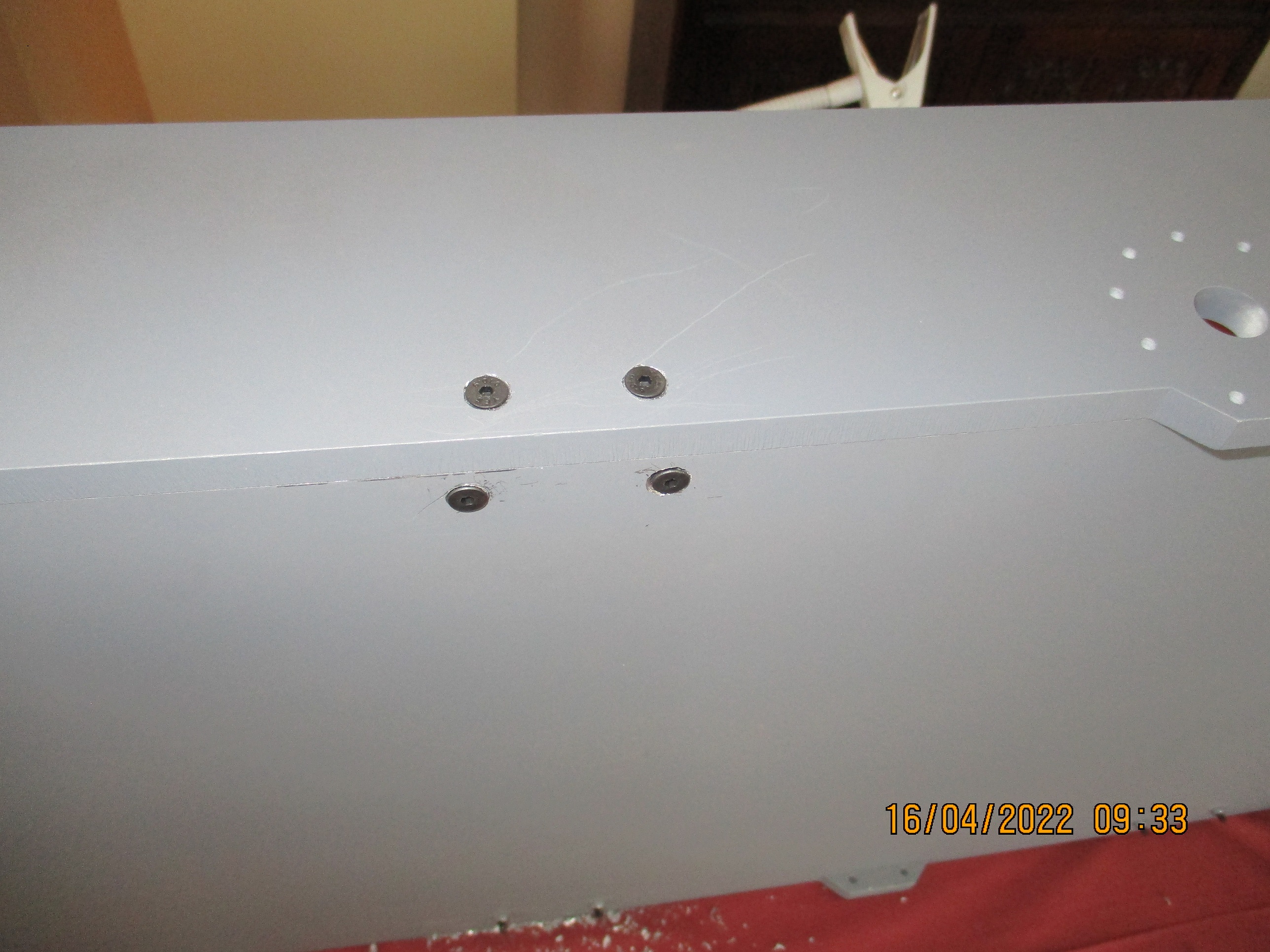

Thank you for your advice Adrian and good morning everyone, nice day with a cold wind....gradually etching forward. Already this is one heavy model. Having taken lumps out of my hands, on previous builds...I decided to follow other modellers and countersink these hull fixings. The sharp bolt ends, are exactly that...sharp....oh, and have a lovely Easter....Mick

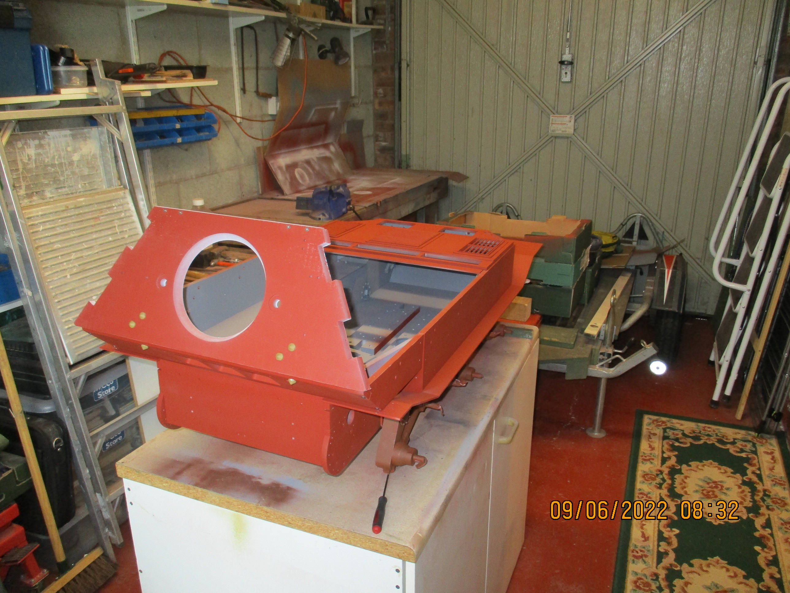

Good morning everyone, and thank you Adrian. Skimmed away the protrusions. Moved the old girl into the garage, mainly because of the weight. Carting the hull backwards and forwards is a bind. The weather here has improved so it's comfortable, I can also paint without moving the hull. The previous Forum Elefant builds are extremely helpful....Mick

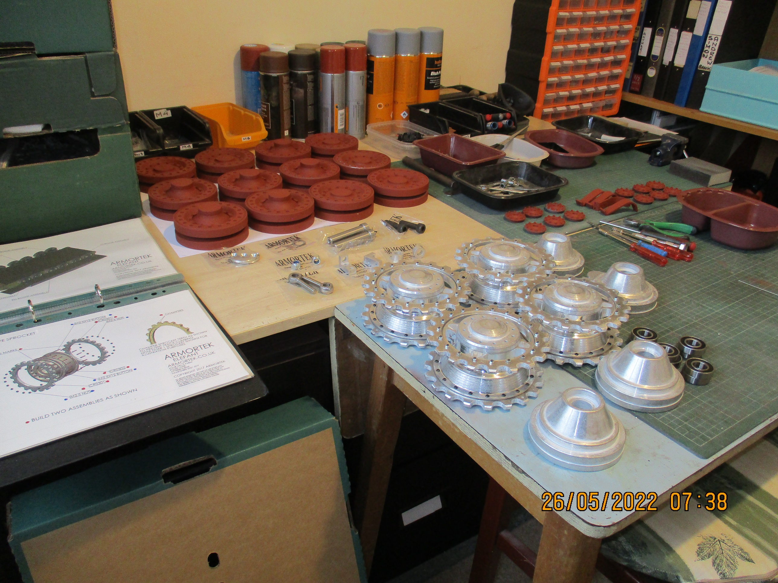

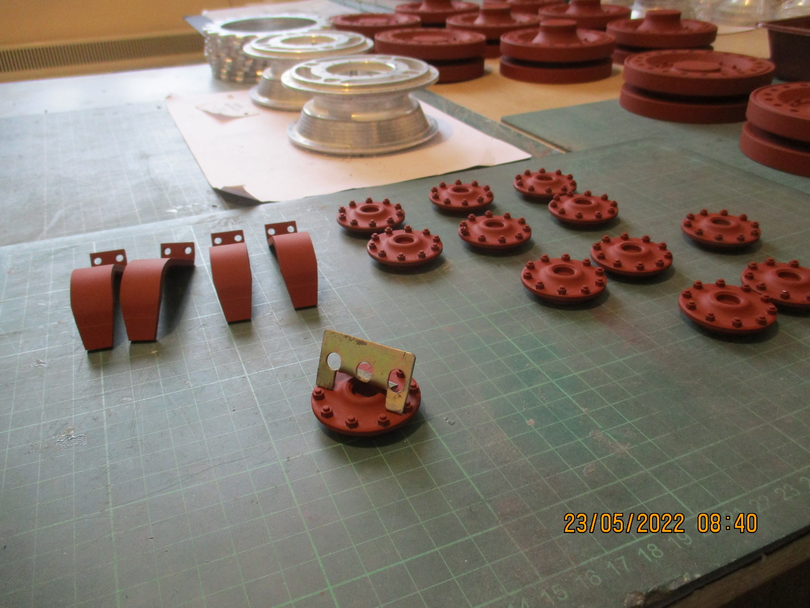

Good morning everyone, just to show I have not been slacking etc, etc,. Took me awhile to notice that the suspension arms are not all facing the same way....Steady progress is being made, a very comfortable build, although heavy.
I am hoping to have a part build ready, along with the Panther to display at the WW2 1940s Weekend Show in Welshpool, end of September. The organiser's have allocated a whole floor area in the Town Hall for WW2 models. It is mainly represented by large scale dioramas, and re-enactors.
I have been setback somewhat having carefully put all my modelling tools in storage, not intending to build another model....there you go...taken an age to find a spanner.
Never mind, all is well.....Mick
