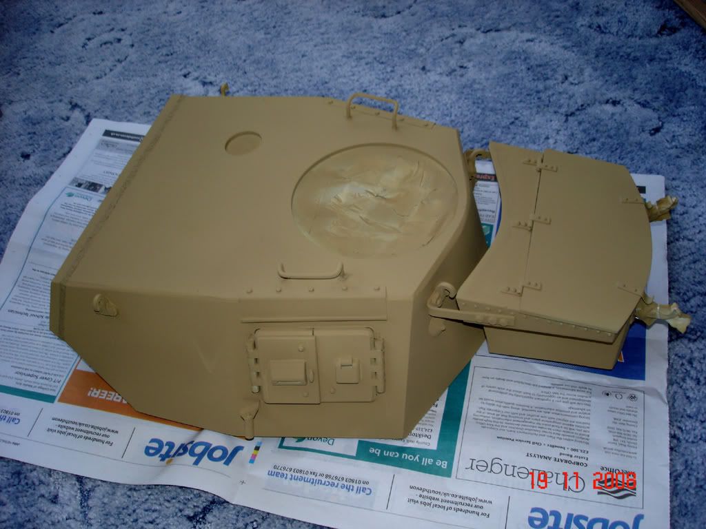

Hi All
Started the painting process, do you think the turret is the right colour, its Humbol Matt 90 which seemed to be closest to this at the time to,
http://airbrushes.com/product_info.php? ... ts_id=2285
Graham
- Posts: 249
- Joined: Mon Jul 16, 2007 11:15 am
- Location: BRIXHAM
- Has liked: 4 times
- Been liked: 16 times

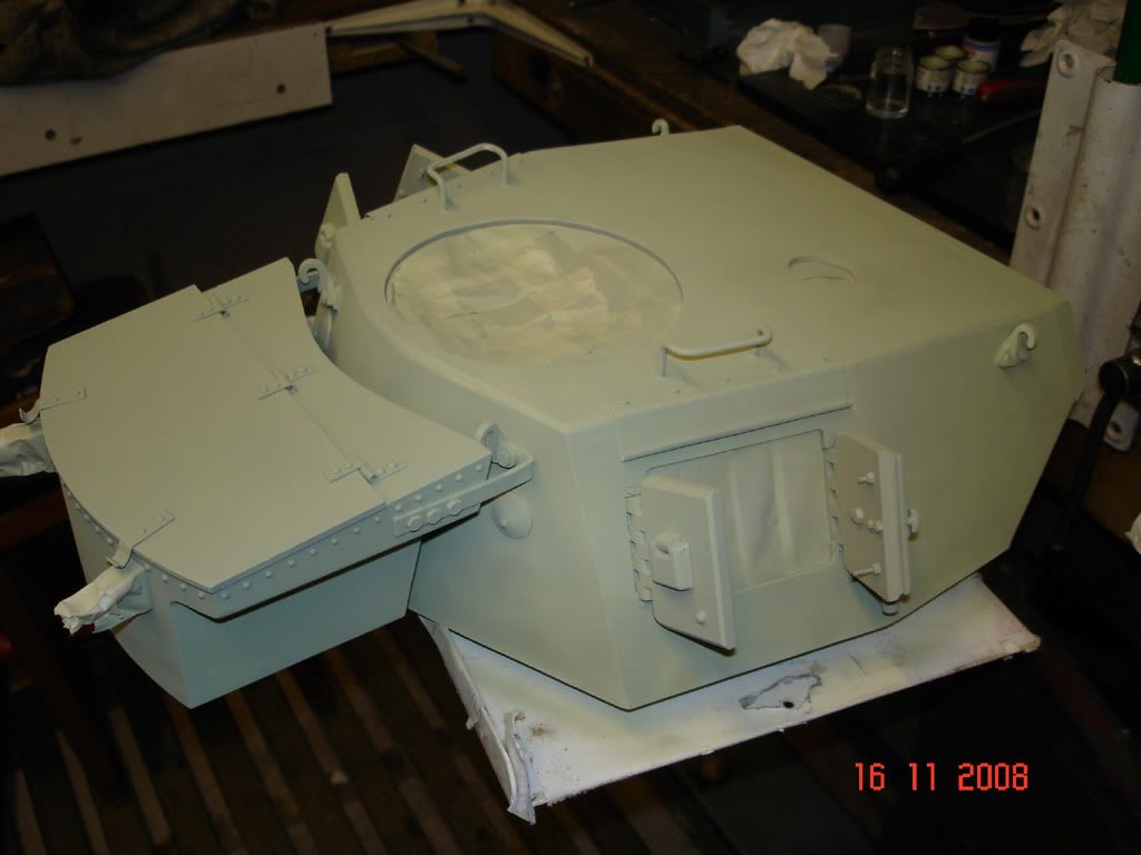

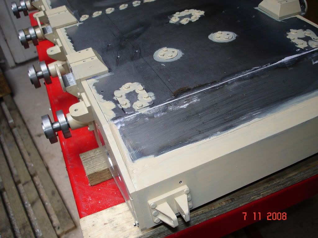

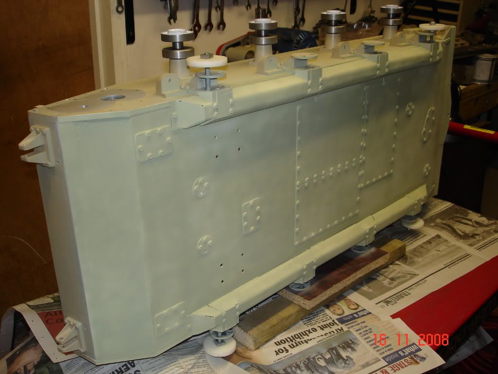

paint
A bit more info
The aluminium/brass was primed with Blackfryers galvanised primer, the steel with Rustins red oxide all by brush. The 2nd and 3rd pictures are only in Blackfryers as I had not put the steel primer on yet. The first and last pictures are air brush sprayed with Humbrol matt 90.
Graham

PAINT
Antony
No particular theatre, just enjoyed making the tank from scratch.
Dale
I was thinking (bad for me) what about a thin coat of clear varnish or do I have to spray another coat of Humbrol 93 mixed with a similar colour gloss?
Dale
Graham
- Posts: 1460
- Been liked: 525 times
Graham how far have you gone . Have you only painted the turret or the whole tank . If the 93 was not put on to thick .. I would mix up a new batch with about 5 % HUMBROL gloss mixed into the paint thinned with about 20% turps , do a test spray first... Remember this is the base coat .... Any como on the the top of this , will be sprayed on very very lightly like Tim is doing on his Panther .. You need the base coat to have a slight sheen , not to glossie once again look at the sheen on Tims Panther .. Dale
