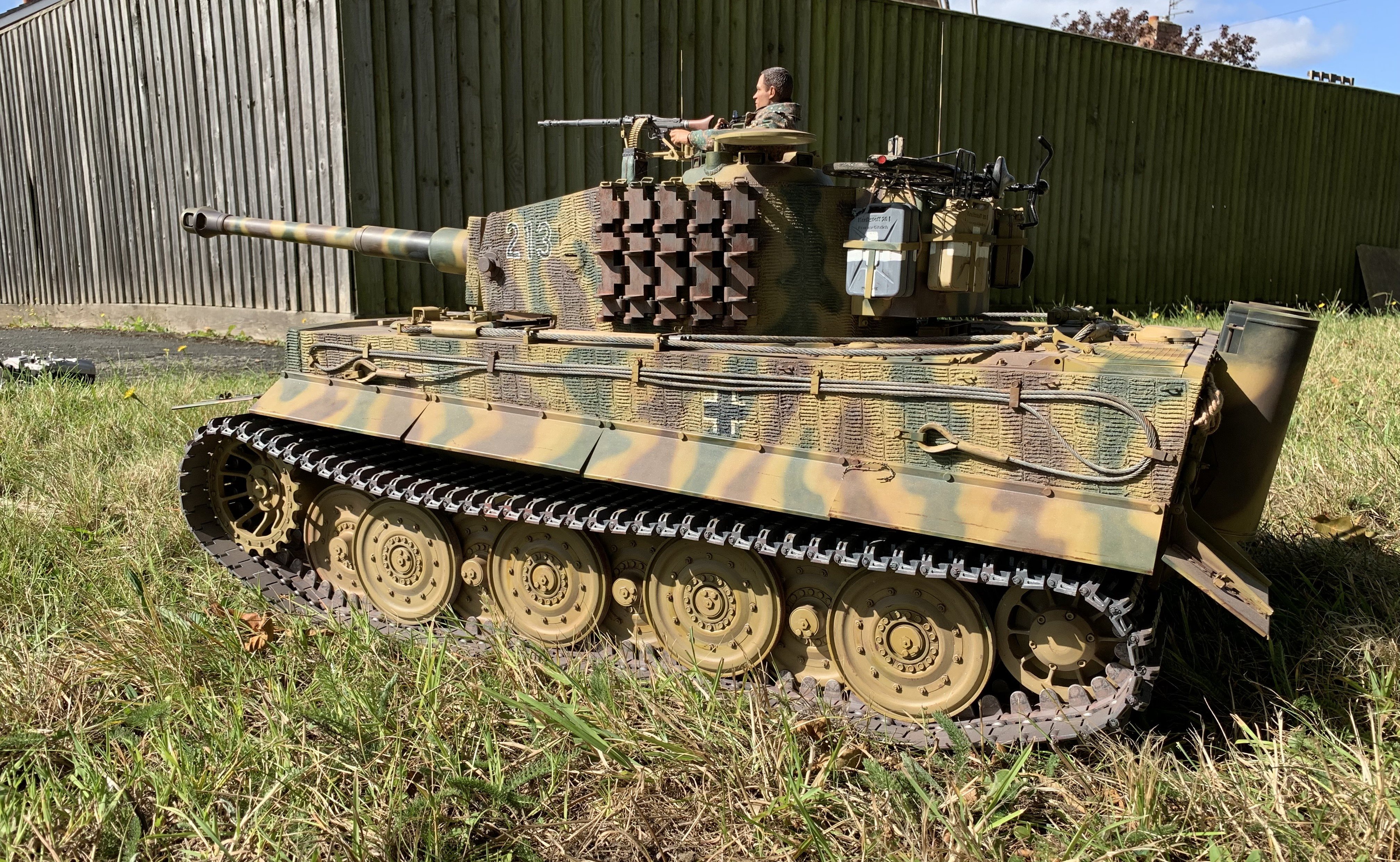

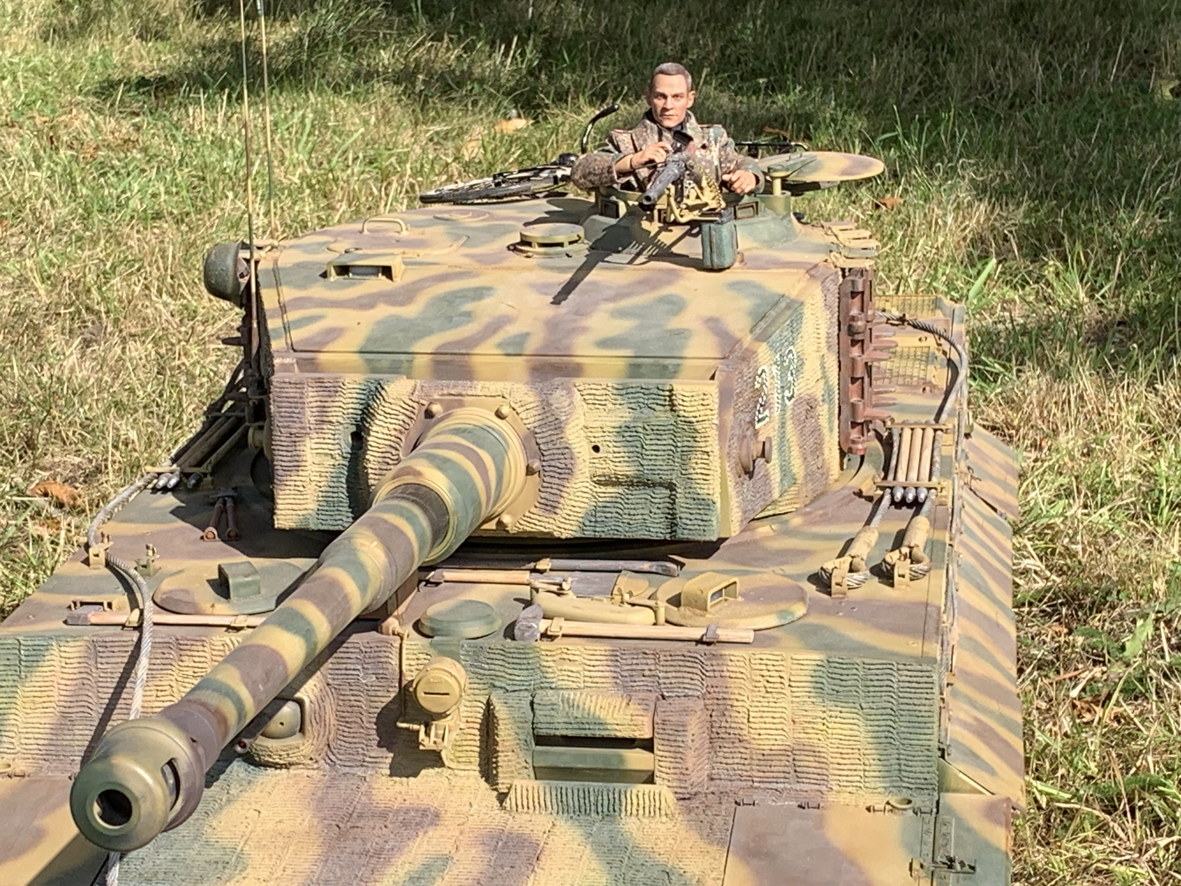

Re: Tiger 1 2021 no. 13

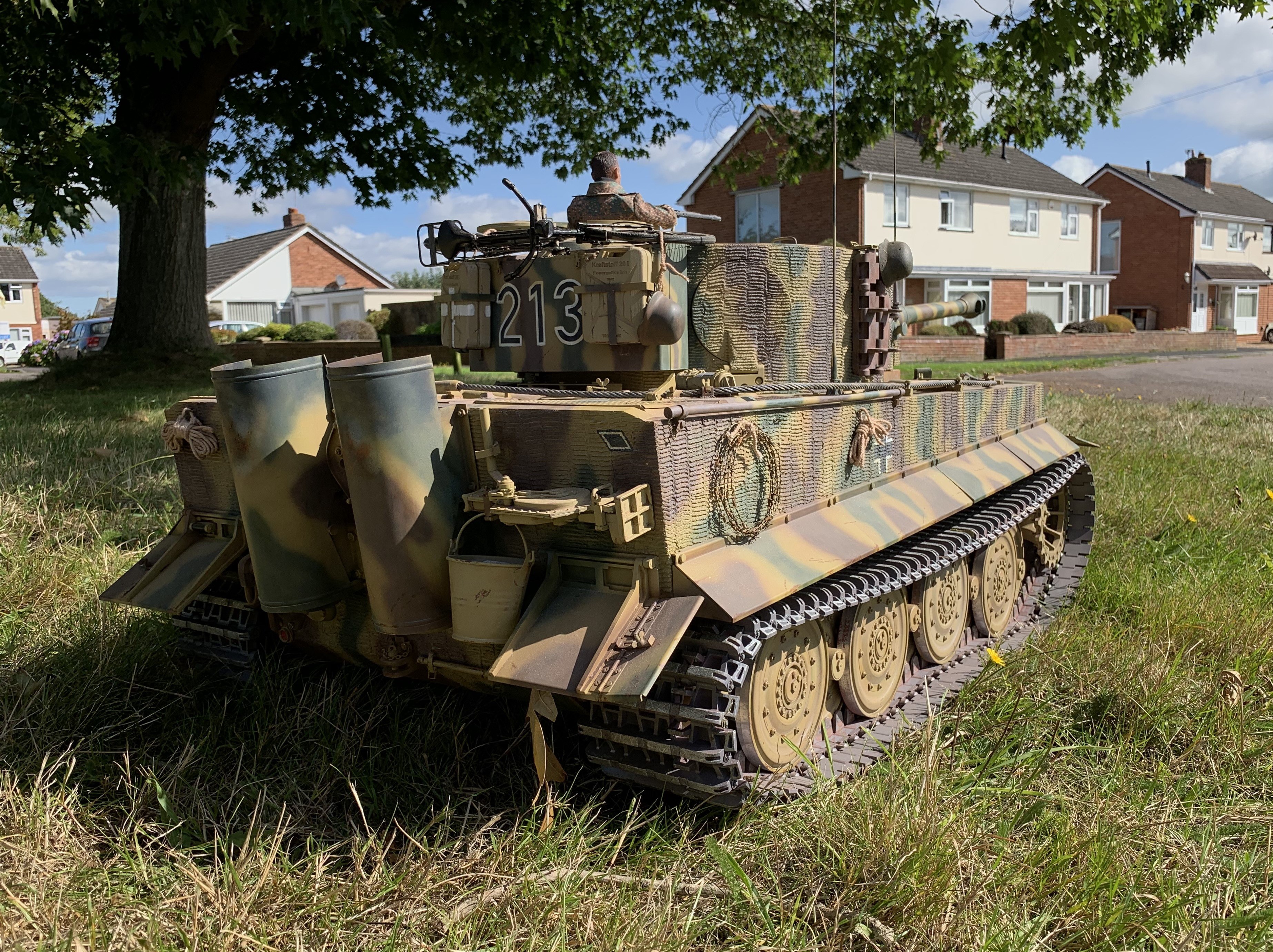

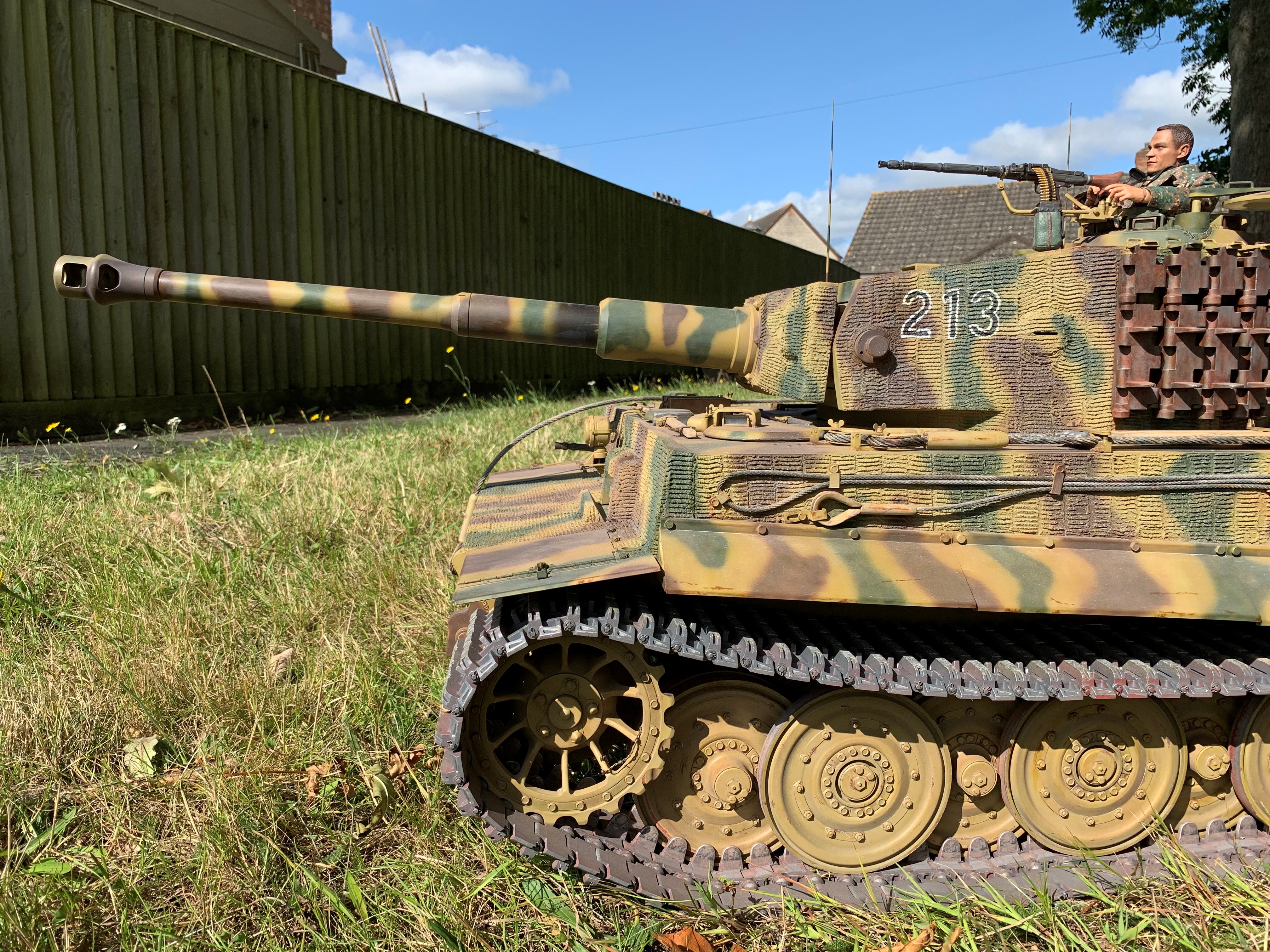

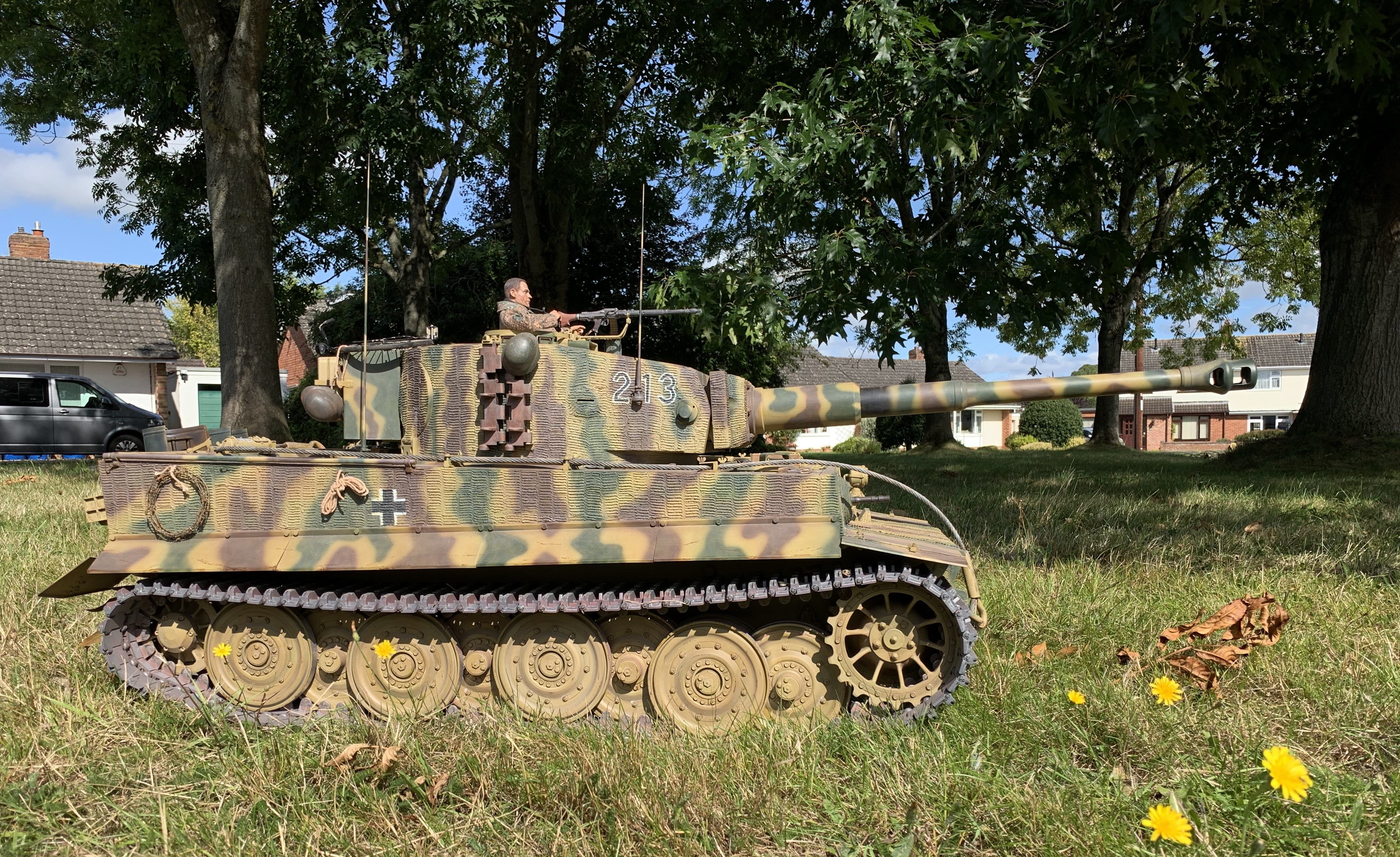

Hi all

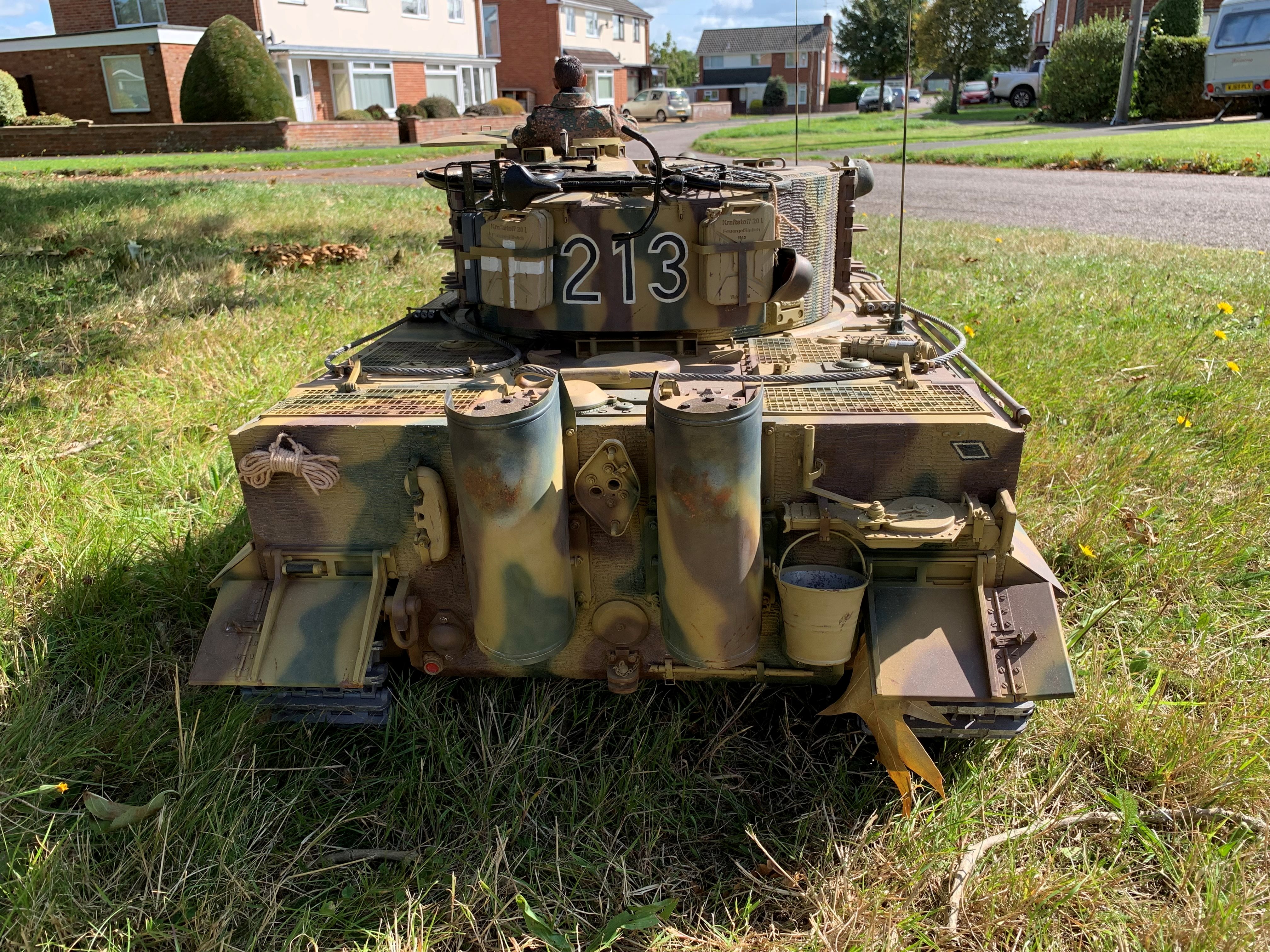

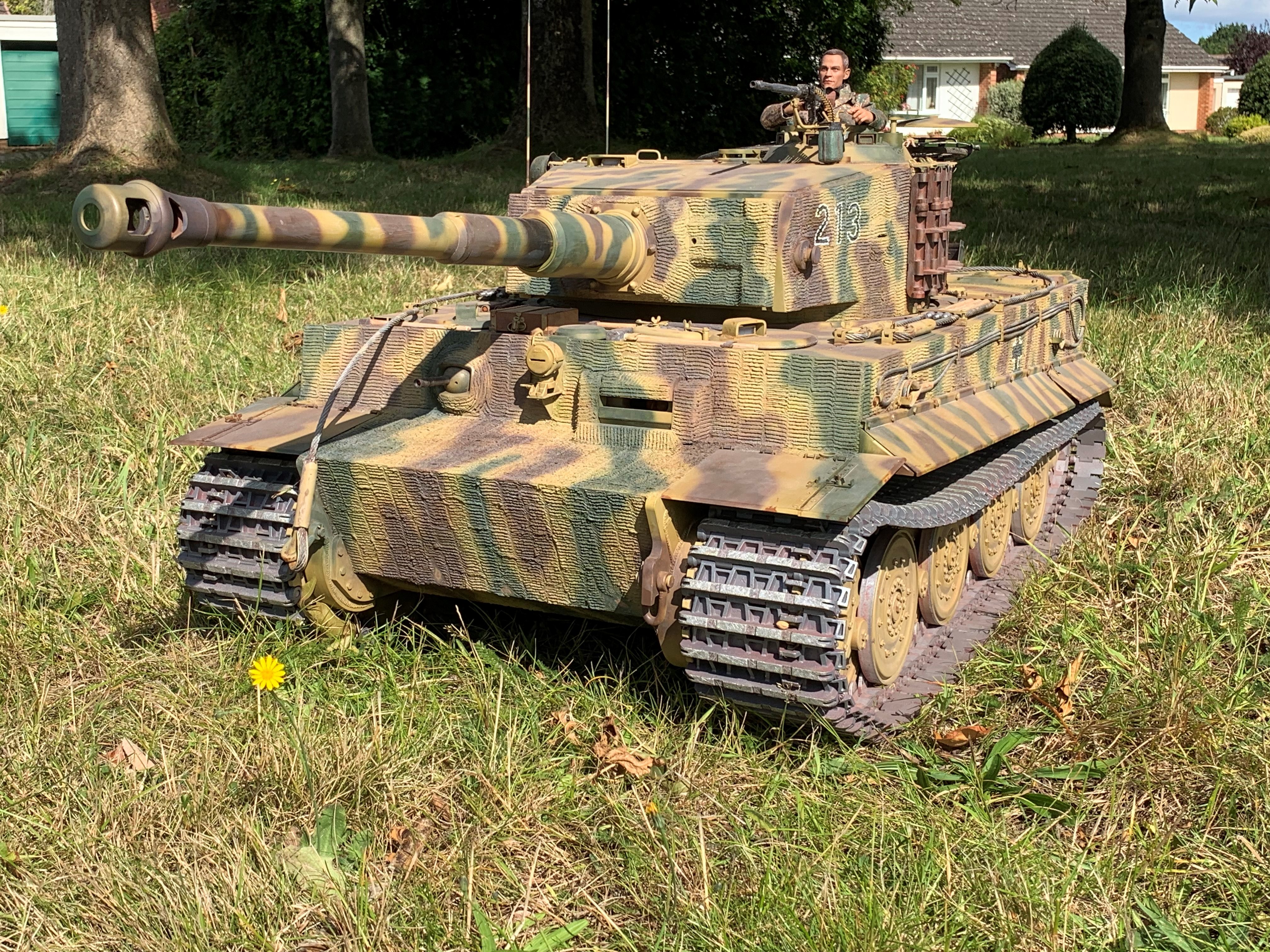

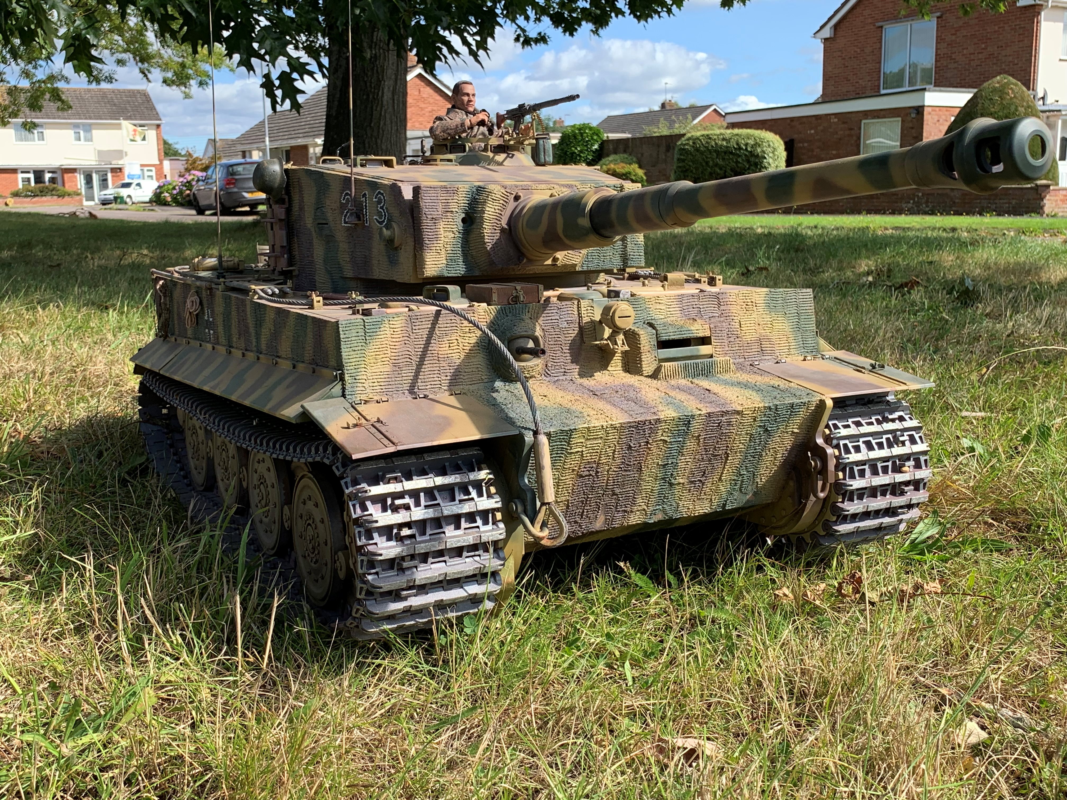

As promised here are some photos of my Tiger 1.
Gary
Gary

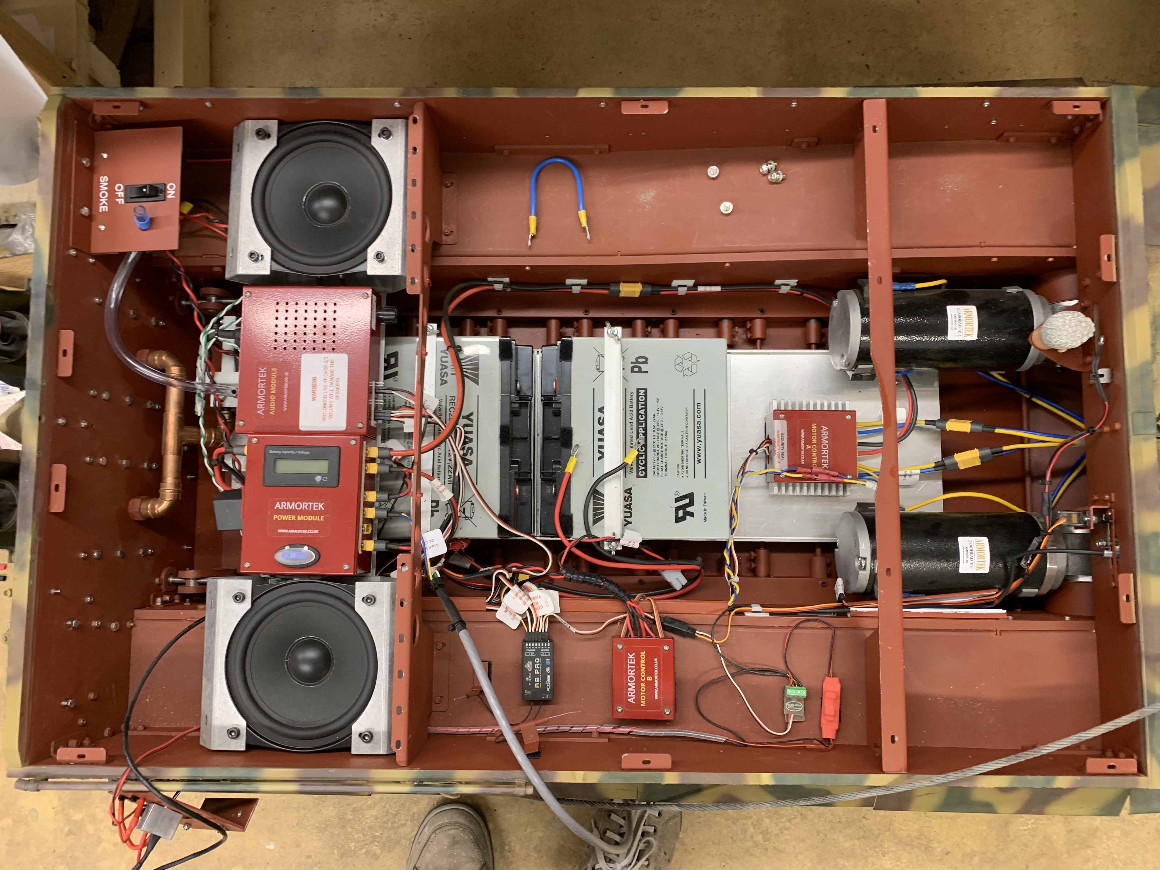

Hi all

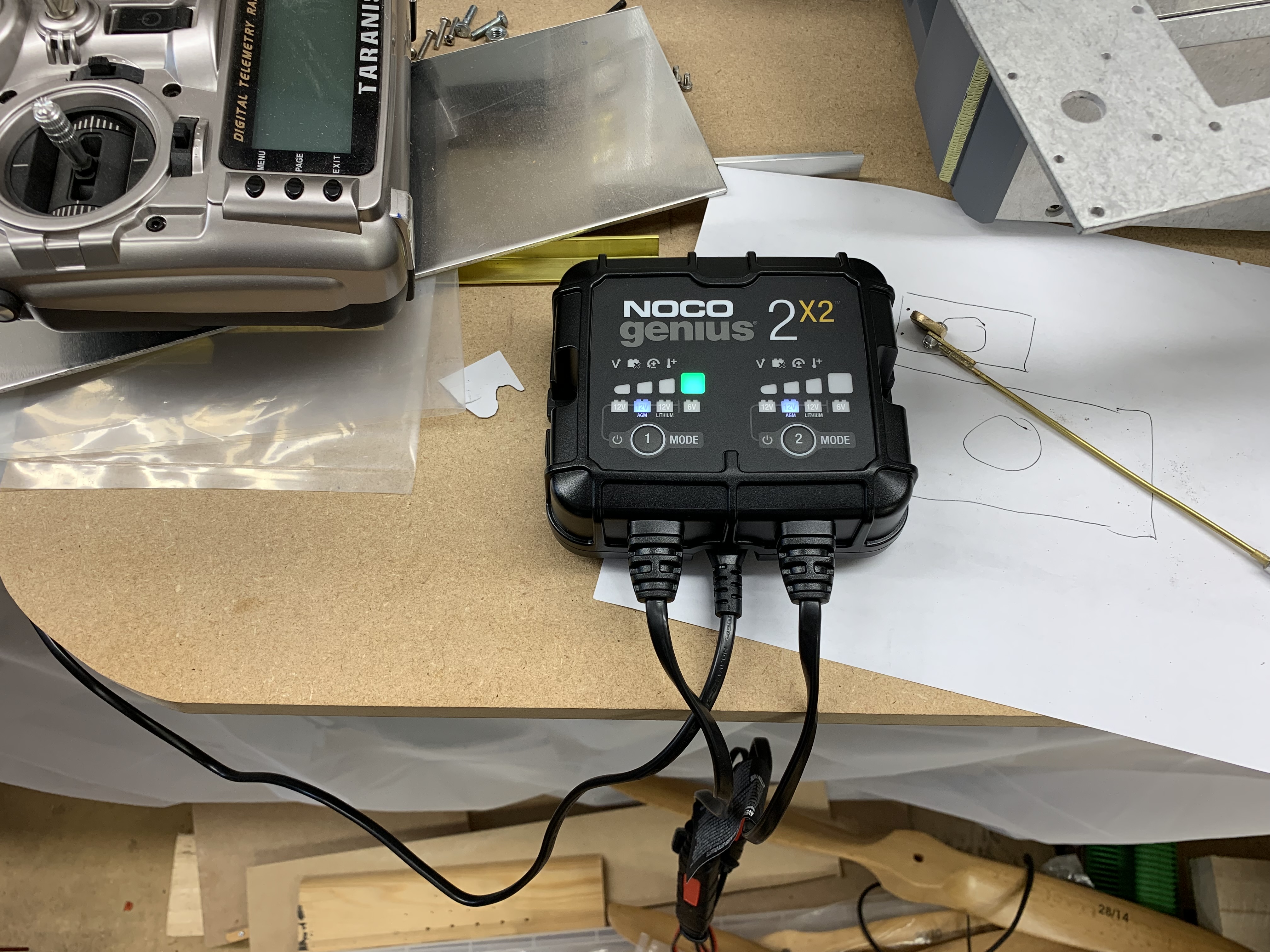

While planning the wiring for the Churchill I thought I would take the opportunity to rewire the Tiger battery charging circuits and lighting circuit. I originally had 5mm banana plugs and sockets which made for a neat installation but I hadn't allowed for charging both batteries at the same time and the lighting power supply was from the sockets. Having recently bought the NOCO 4x2 dual charger I decided to modify the wiring using 17A cables from each battery with XT60 connectors as the charge sockets. I also modified the chargers leads to use the same connectors.
The NOCO provides two 2A supplies from one unit, they are electrically isolated from each other so there is no need for a switch between the batteries.
I also have a CTEK 5A charger and will add another for the odd occasion I need rapid charging. Again the CTEK is isolated so two can be used at the same time.
I am still trying to decide whether to install a couple of leisure batteries, DC chargers and a 230V inverter in my van, it is quite expensive at over £1000 but would help out as I want to take the Tiger to shows and it would mean I could do two days instead of just one. The other alternative is a petrol generator with two 230v sockets at around £400 but I am not sure if these are allowed at some of the venues.
I am also toying with the idea of making a simple trailer for the Tiger which can hold two of the 12V 22A AGM batteries complete with XT60 leads which would allow me to connect them in parallel to the existing tank battery charge leads. This would allow me to move the tank in the event of me running out of power away from the van.
I will use the same set up in the Churchill, possibly with the charge lead connectors behind the pannier hatches.
I have added some photos to show my set up in the Tiger for those newbies who are getting the early Tiger 1.
Gary

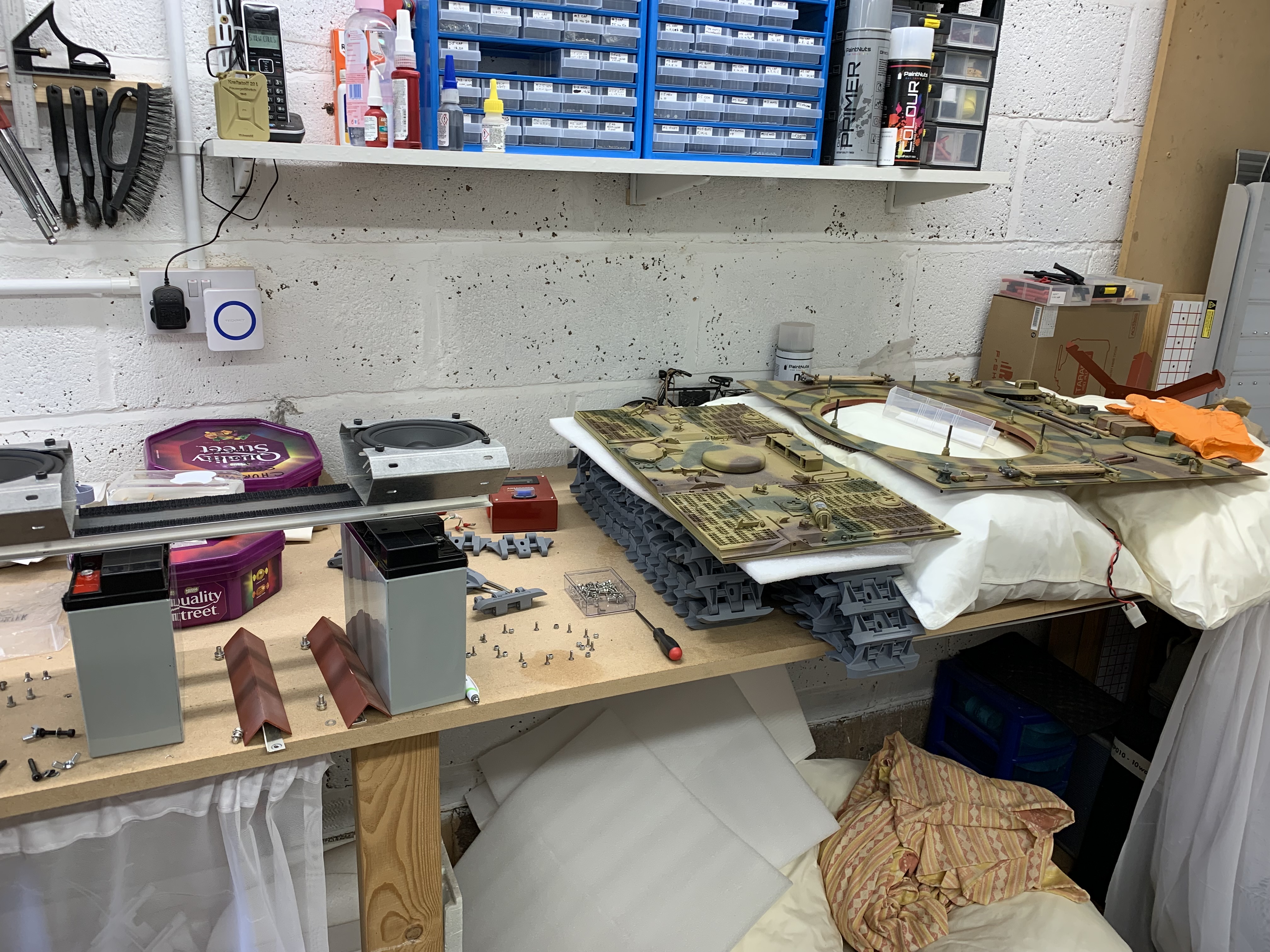

Good morning
It's time for Tiger to have a bit of maintenance, especially after the baby oil was blown out of the filler tube and gave the inside hull a nice smooth finish .
I will remove all the modules and battery holder so that I can check the axle locking bolts and suspension travel. Upol degreaser should take care of the baby oil and I will probably change the smoke unit for the newer type as it takes up less room and is more realistic. I will also add the FrSky FAS100 ADV current sensor I got some time ago, thanks Adrian for showing me it on your Sturmtiger.
Gary
Gary

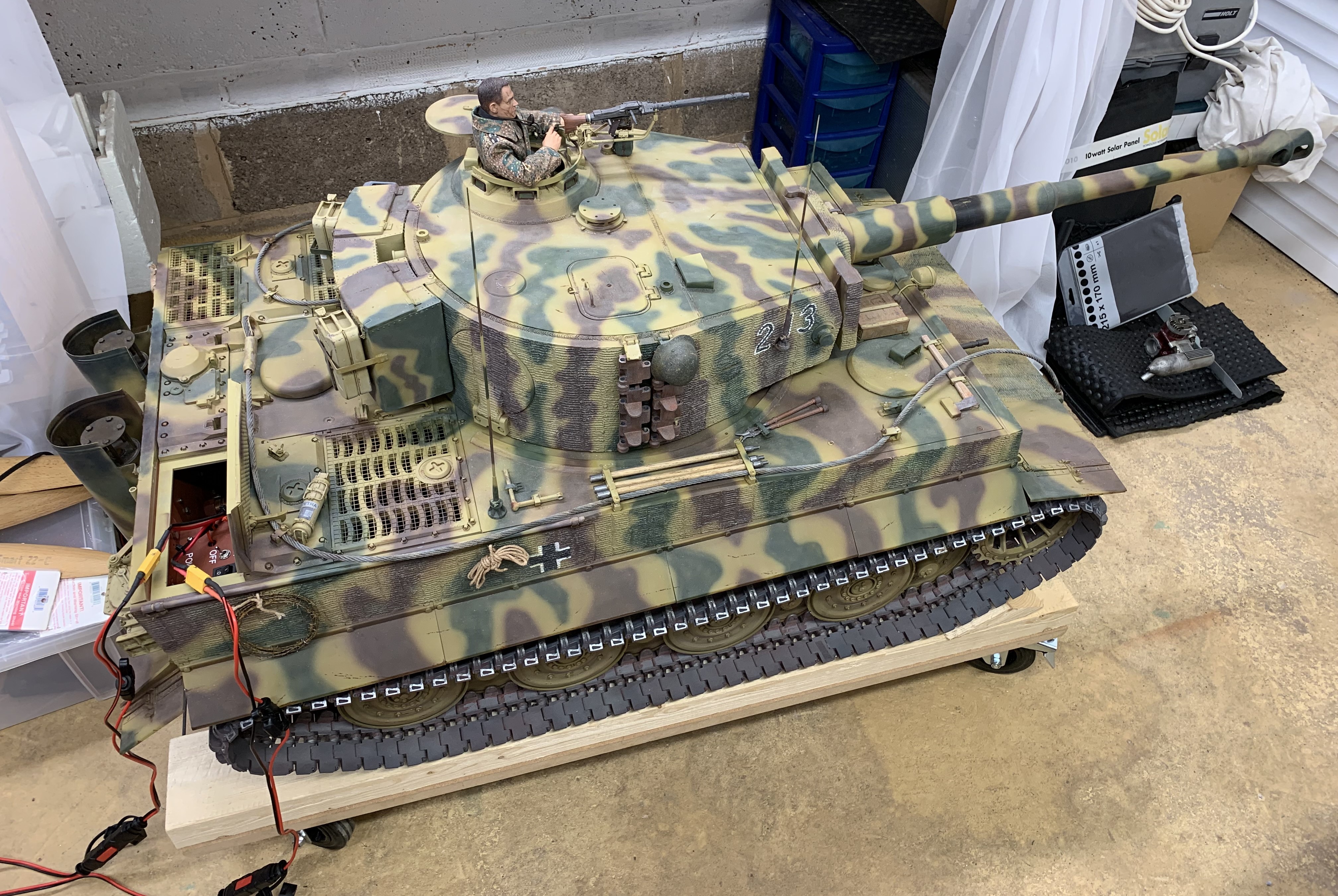

Good morning all

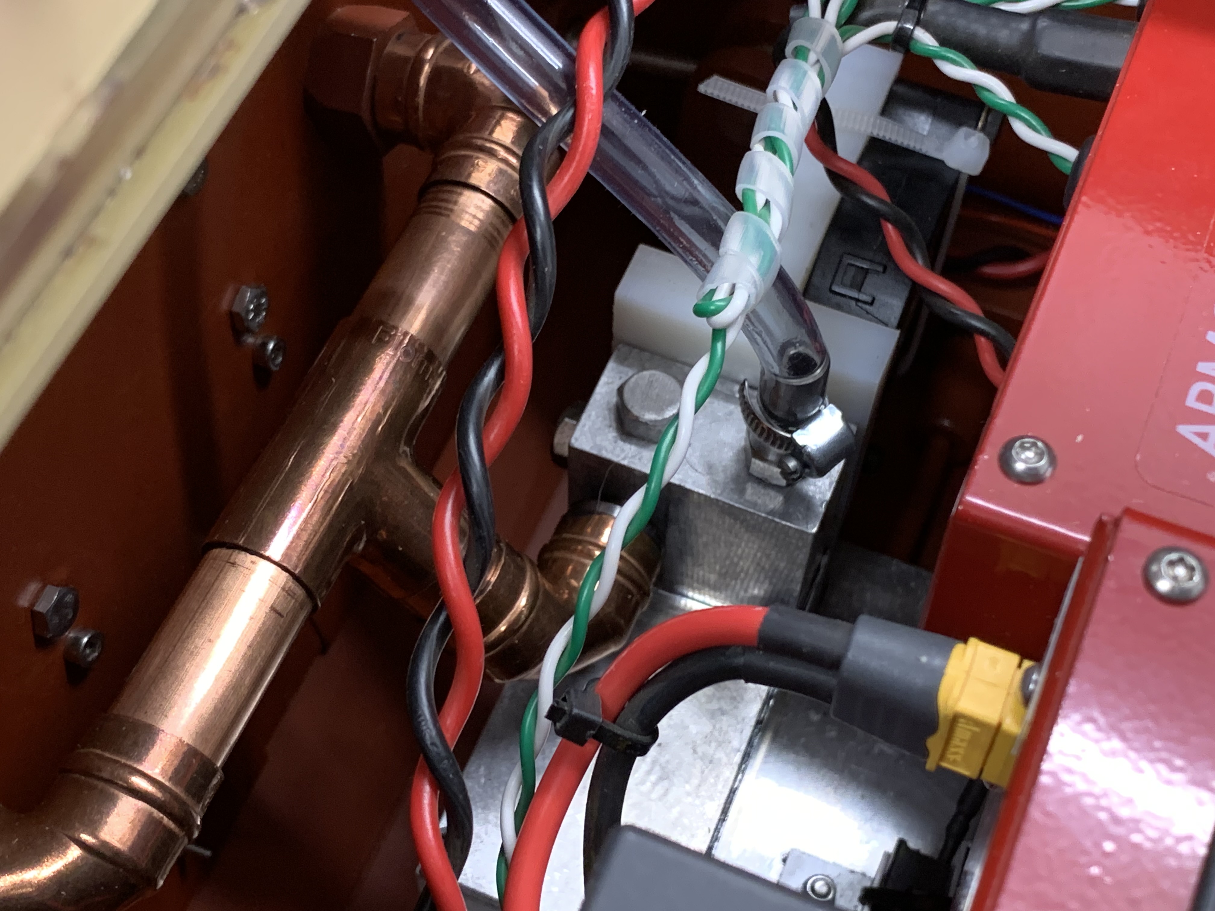

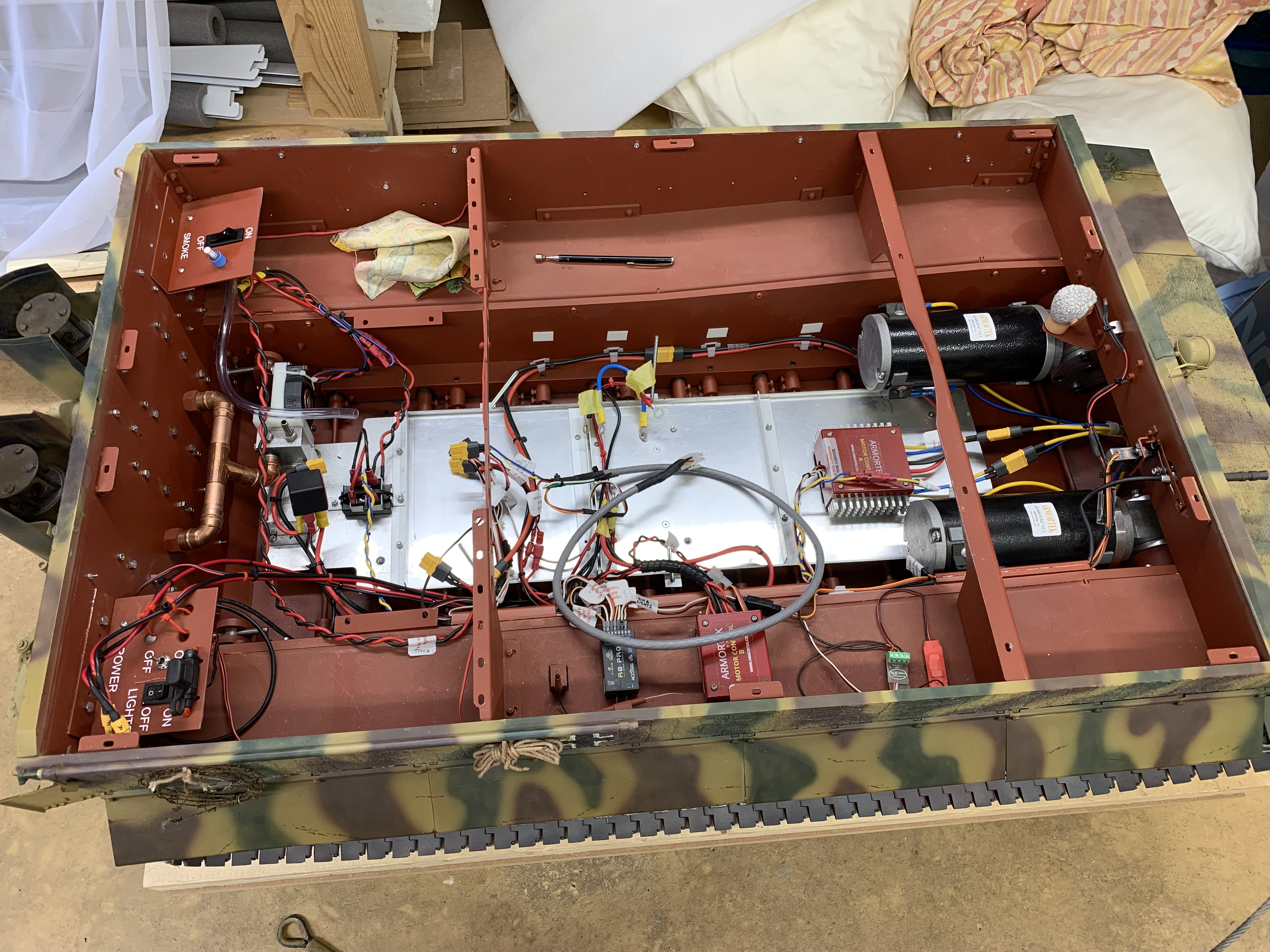

I finally started on the Tiger maintenance for the year, hopefully I will get some dry weather to sort out the drive issue which I think is caused by me accidently altering the settings
I removed the batteries, smoker and floor pan, all of which needed the baby oil removing from them. I had forgotten to put the smoke filler tube bung in when doing filming last year. I also found the clear tube to the smoker metal connection was loose although it was very tight when I originally put it together. I think the heat caused it to harden and become loose. I have now used a motorcycle hose clip to secure it. The smoker was stripped down and degreased before being reassembled using the black silicone I got with the Churchill smoke units. The copper fittings also got a coating of silicone for the joints. I will probably get the new style smoke unit and change the old one out.
I have added the FrSky FAS100ADV current sensor between the batteries and the relay switch which required the larger XT90 size connectors to be soldered in line. Thanks Adrian for confirming the correct position to install the sensor
I am happy to say all the suspension bolts I had used with the torsion bars were still nice and secure which I think justified the decision to use then instead of the grub screws as the suspension took quite a pounding during the three days of filming. The baby oil had caused quite a mess and took Upol degreaser to remove it ( the crew are upset as they liked the smooth feeling) and Upol doesn't damage the paint.
As I write this I have just realised I didn't secure the smoker element properly which has a habit of working loose . The new units have a metal fitting that makes sure it doesn't move. This will entail removing the turret and decks again to get at it, I just use a small cable tie which worked ok last time.
I now need to go through the programming to find out what went wrong as the left turns are definitely out of kilter. It also struggles to turn on grass so maybe I need to try adding an exponential curve for the drive settings , I drove Adrian's Sturm Tiger last year and it was very smooth and incredibly easy to turn on grass which is what I need to aim for. If I can get it sorted I will use the same programming for the Churchill.
P.S
I managed to add the cable tie without removing the decks so that was a quick win
Gary
