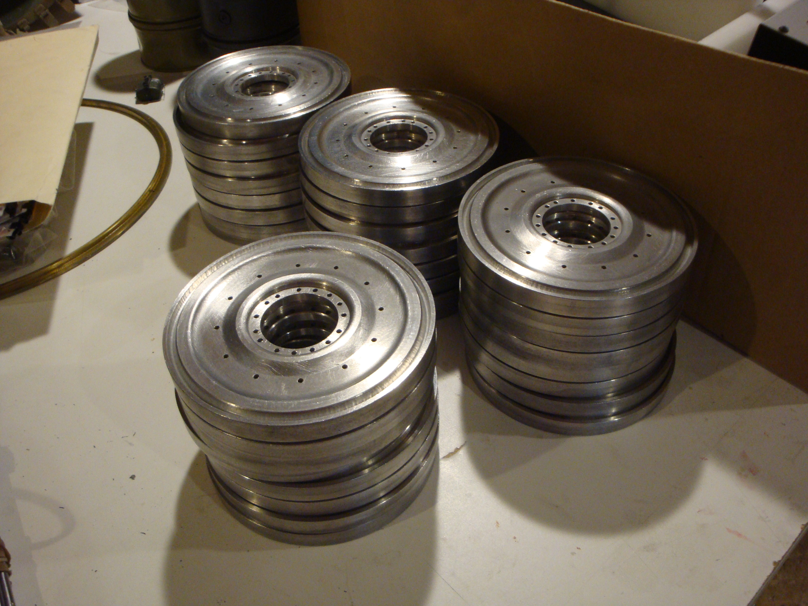

The first step was to strip all the paint on every parts which I accomplished this summer, with the exception of the turret and few other parts.
first timer to post on the forum.
My hobby focuses mainly on building large scale RC warbirds, but after receiving an offer to purchase this tank from a local guy I saw an opportunity to diversify.
I got the tank fully built, it was stored in a garage and homed some local rodents. Be in Colorado and having low humidity, the tank remained in pretty good shape. After installing new batteries and setting up a Hitec Aurora9, I was able to drive it around the house and take it to some of the Airplane events I attended. To my surprise, it got very popular with the crowd, especially the kids. This year, I decided to start the restore and took it apart.
Following is so far what I have accomplished, I welcome comments and suggestions as I am no expert with the Armortek kits.

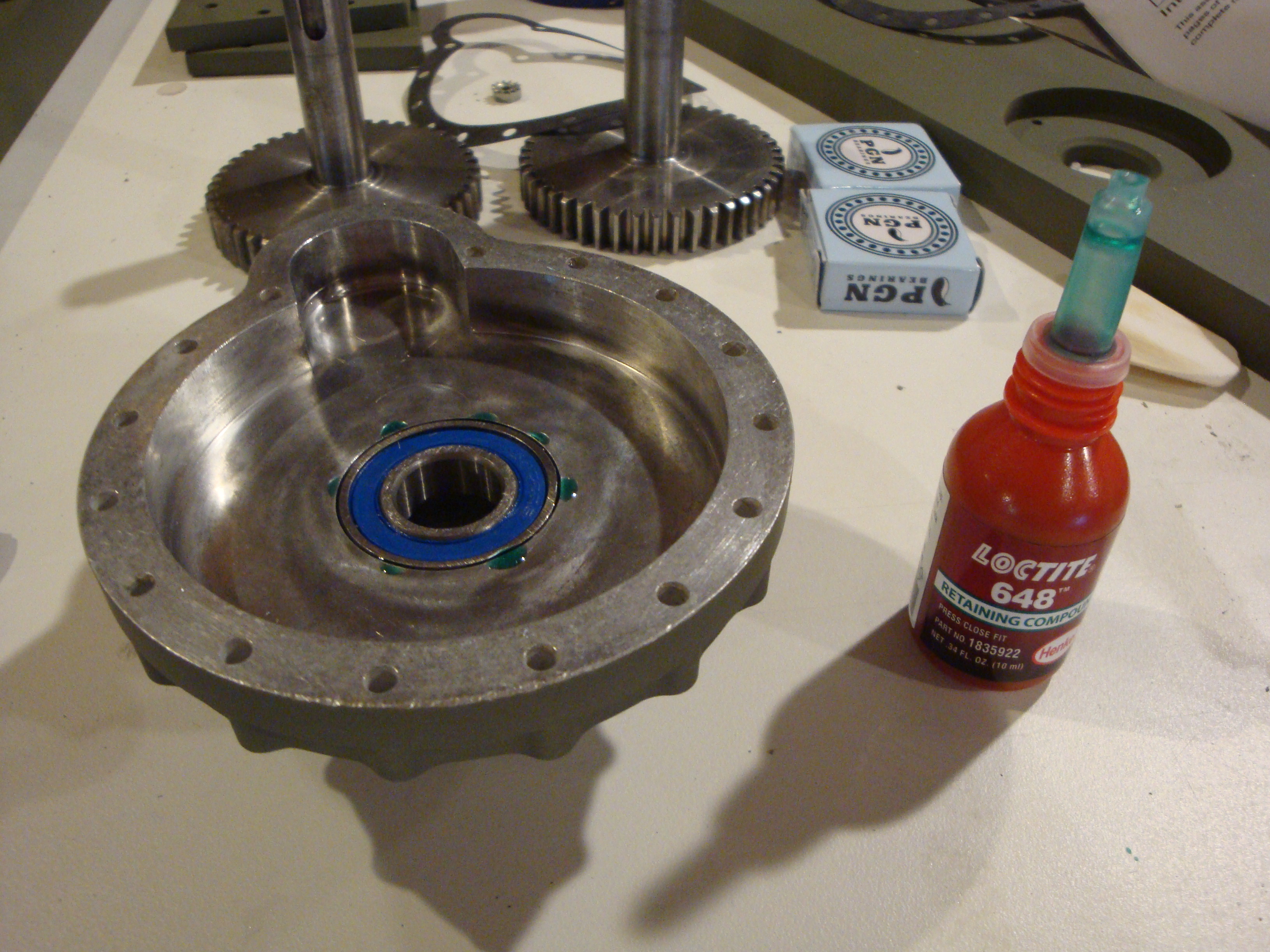

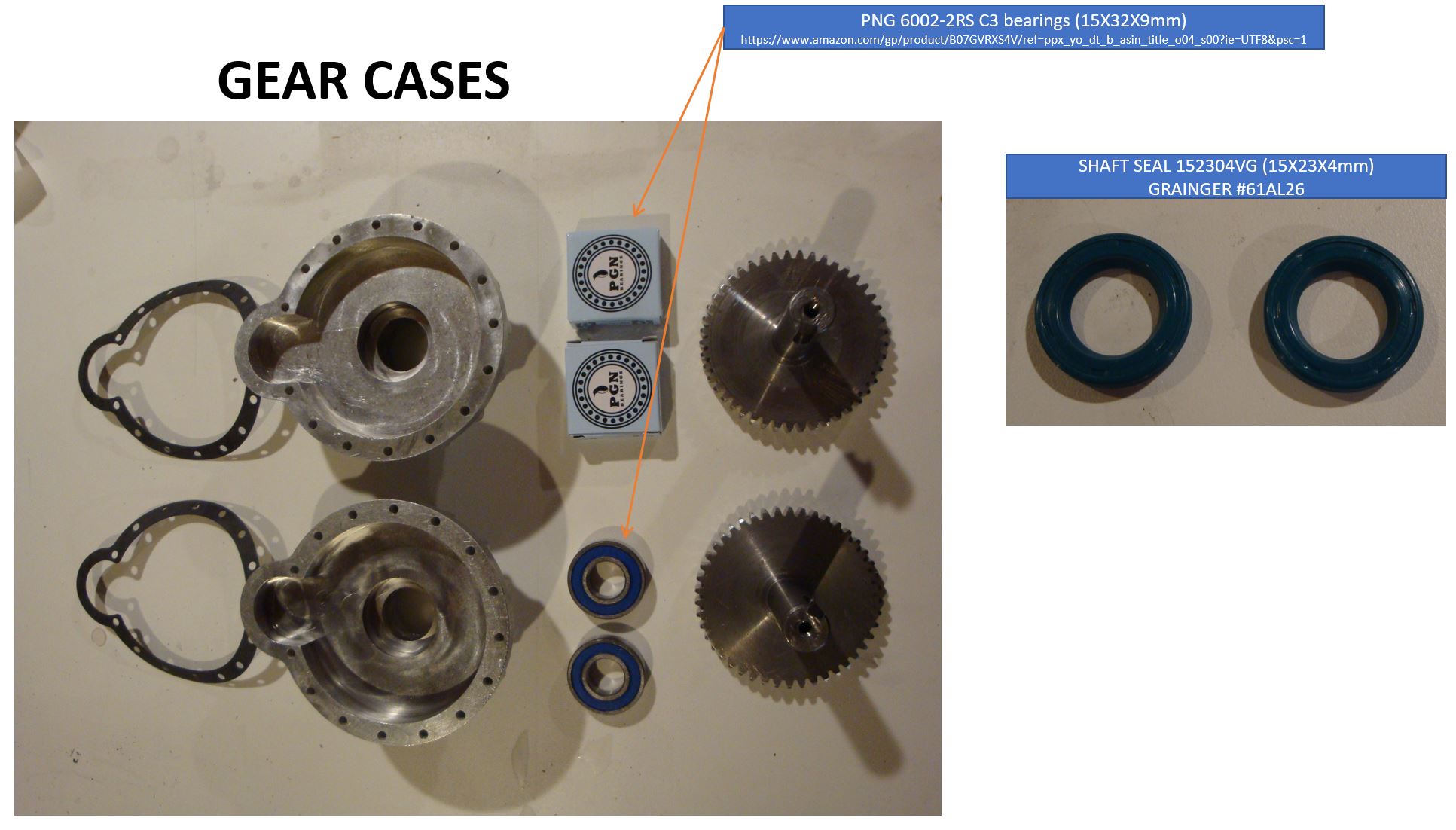

With most of the bearings been rough, I started to replace them with gear case first. New shaft seals were purchased as well, I designed the gear gaskets in Solidwork and used a laser cutter.

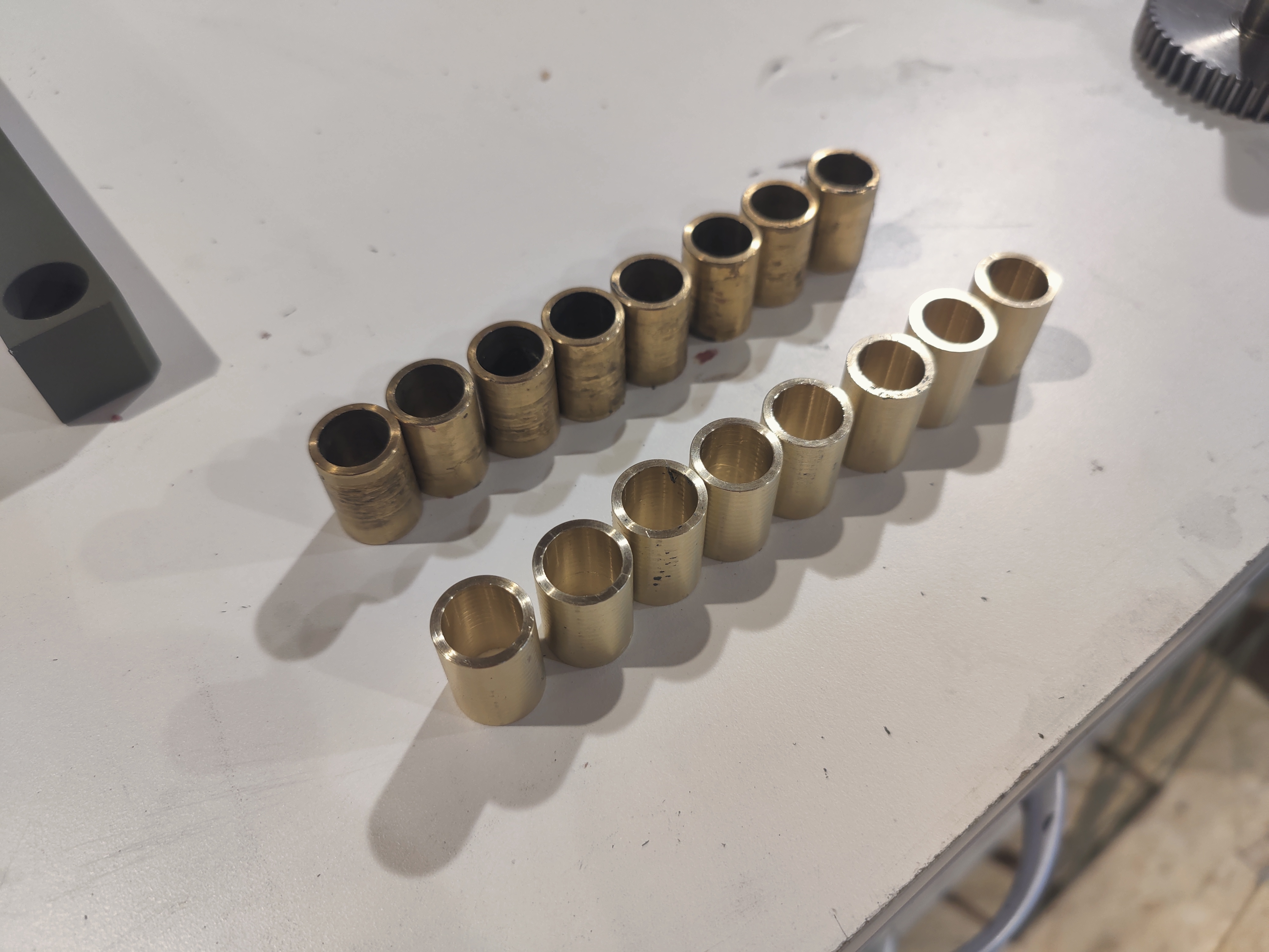

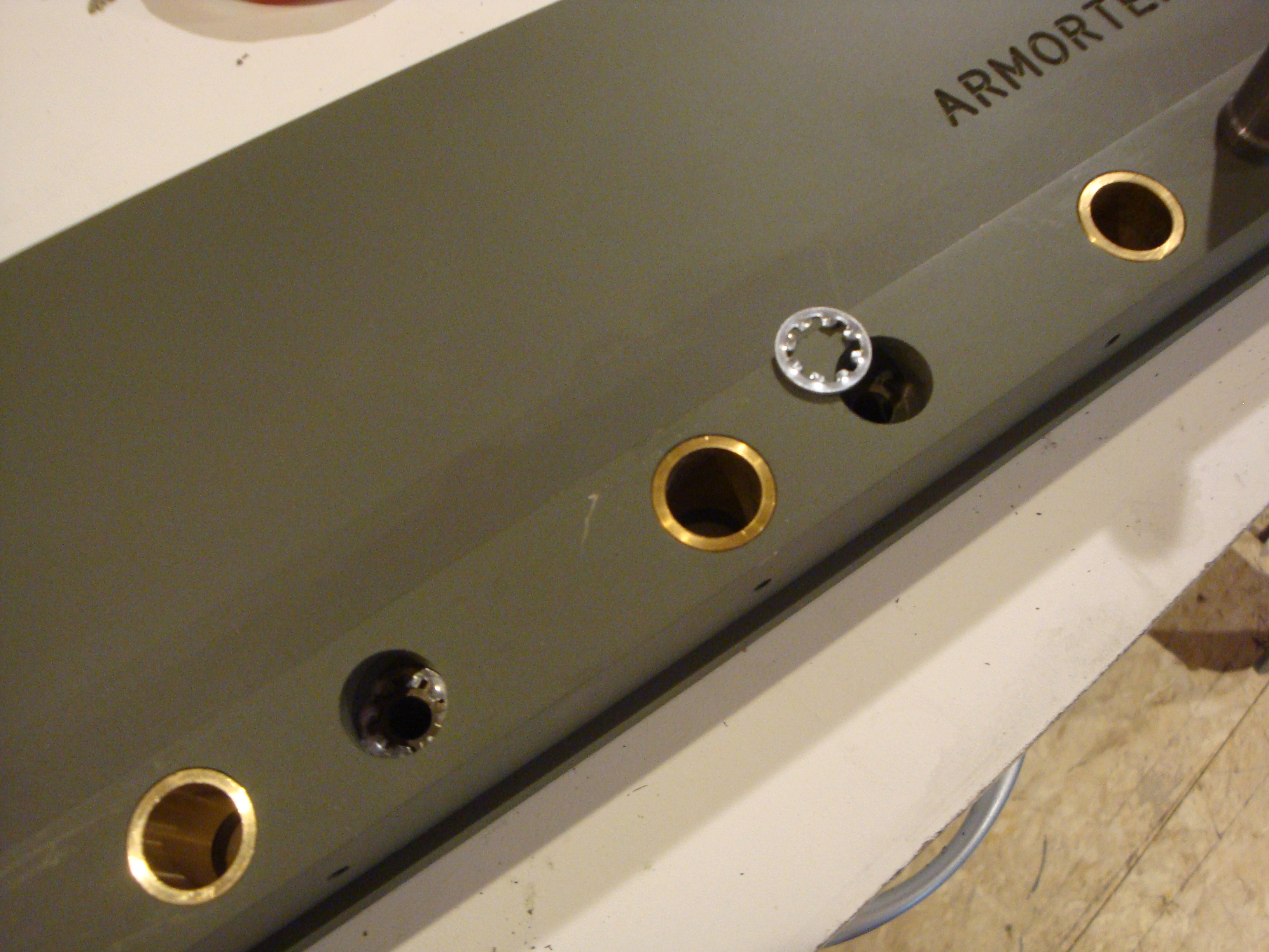

With half of the brass bushings worn out, I machined new ones as replacement.

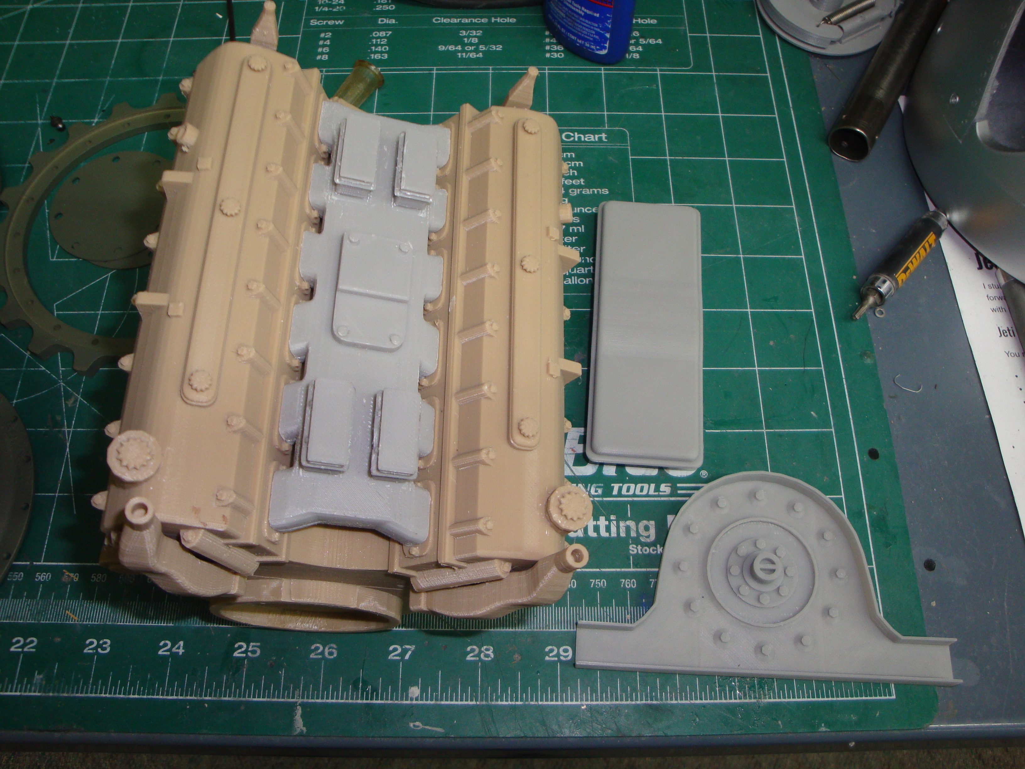

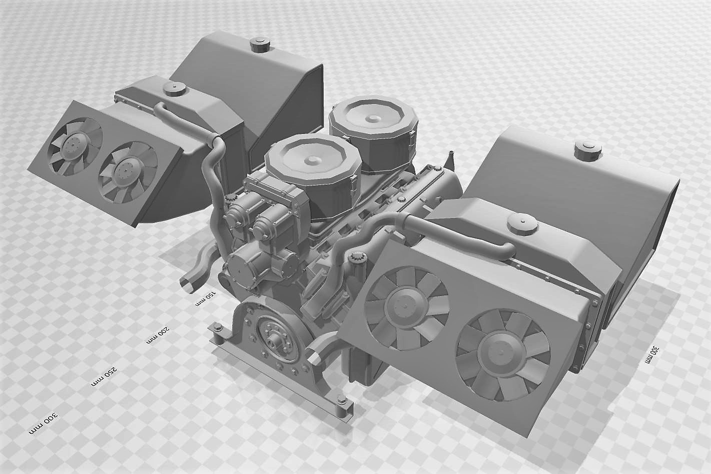

I selected to detail the engine bay and purchase a 3D model of the Maybach engine. I had to rescale it on the 3D printer to get the right size as the original file was more like a 1/16 scale. I'll get more in detail with the engine and installation as I get there.

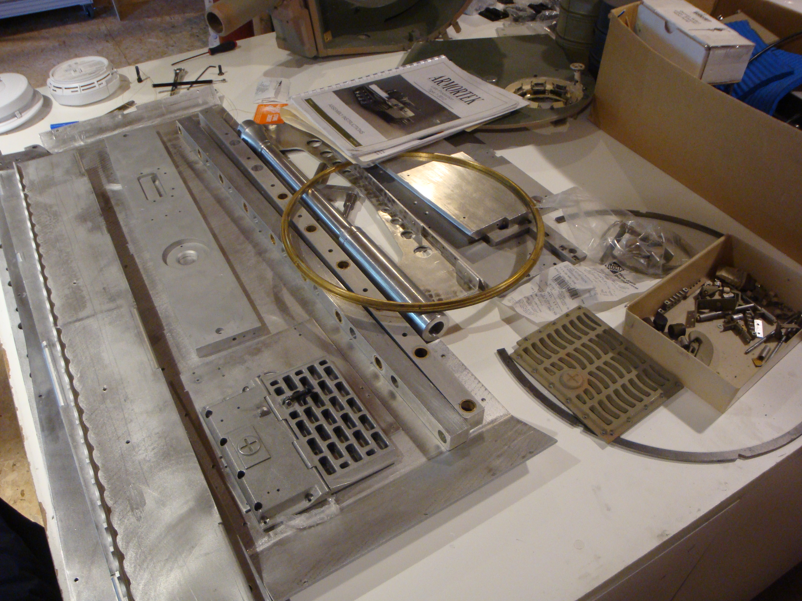

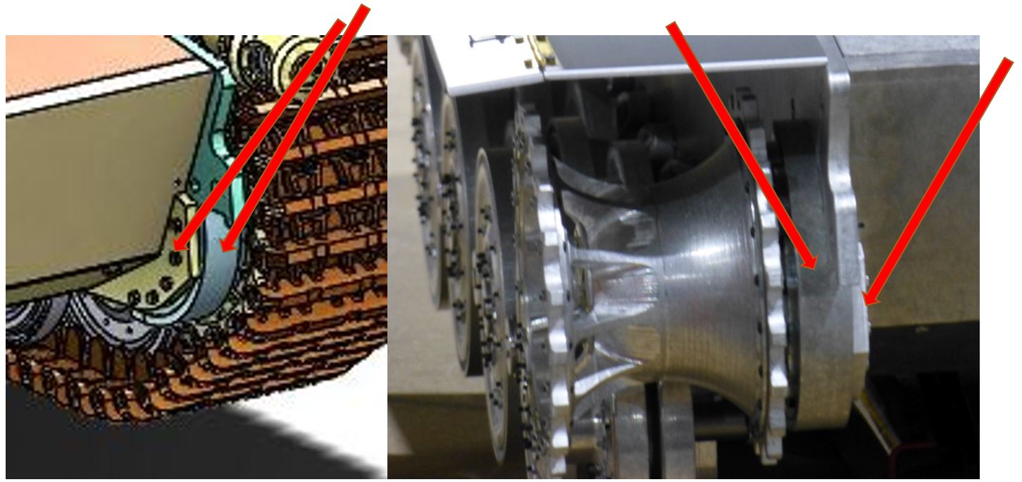

I have do have a question
On the following picture I pointed to the parts which were missing on the tank. Were those installed on the late Tiger tank?

Hi Bruno,Bruno Mary wrote: ↑Sun Oct 24, 2021 11:16 pmI have do have a question
Yes, the two parts were included and installed in all versions of Tiger 1 kit. Double check all parts included and good luck.

Looks like the original owner didn't not install them or just didn't have them. I started to design those in SolidWorks but could use some dimensions/pictures. I contacted Armortek to possibly purchase the sets but they were not sure the newer version would fit the 2012 tiger series.
Thank you,
Bruno

Nice 3D model!
When you print the fans, pls note that they are supposed to be identical, not mirrored. The RH side is correct.
The final drive armor is supposed to extend into the sprocket wheel. A friend of mine (Stefan Konitzer - you may find his build thread from 2008 here on the forum) turned a ring to shape, cut it in half and fitted the halves to the respective sides. You might wonder if the tight gap between the armor and wheel would keep debris out of it or would make things jam there, but it has worked well for him. His model is still a very good runner. If you compare to drawings of the real thing, pls be aware that the Armortek track sits a few mm too far out from the hull, calling for a suitable compromise with regard to the armor rings.

Thank you for the info Christoffer.
I'll make sure to visit Stefan build thread.
I haven't printed the section with the fans yet, I'll modify the files to replicated the right side fans.
So far, I just have the engine block, the advantage of the model (engine) is all the parts can be broken down so to only print the selected ones.

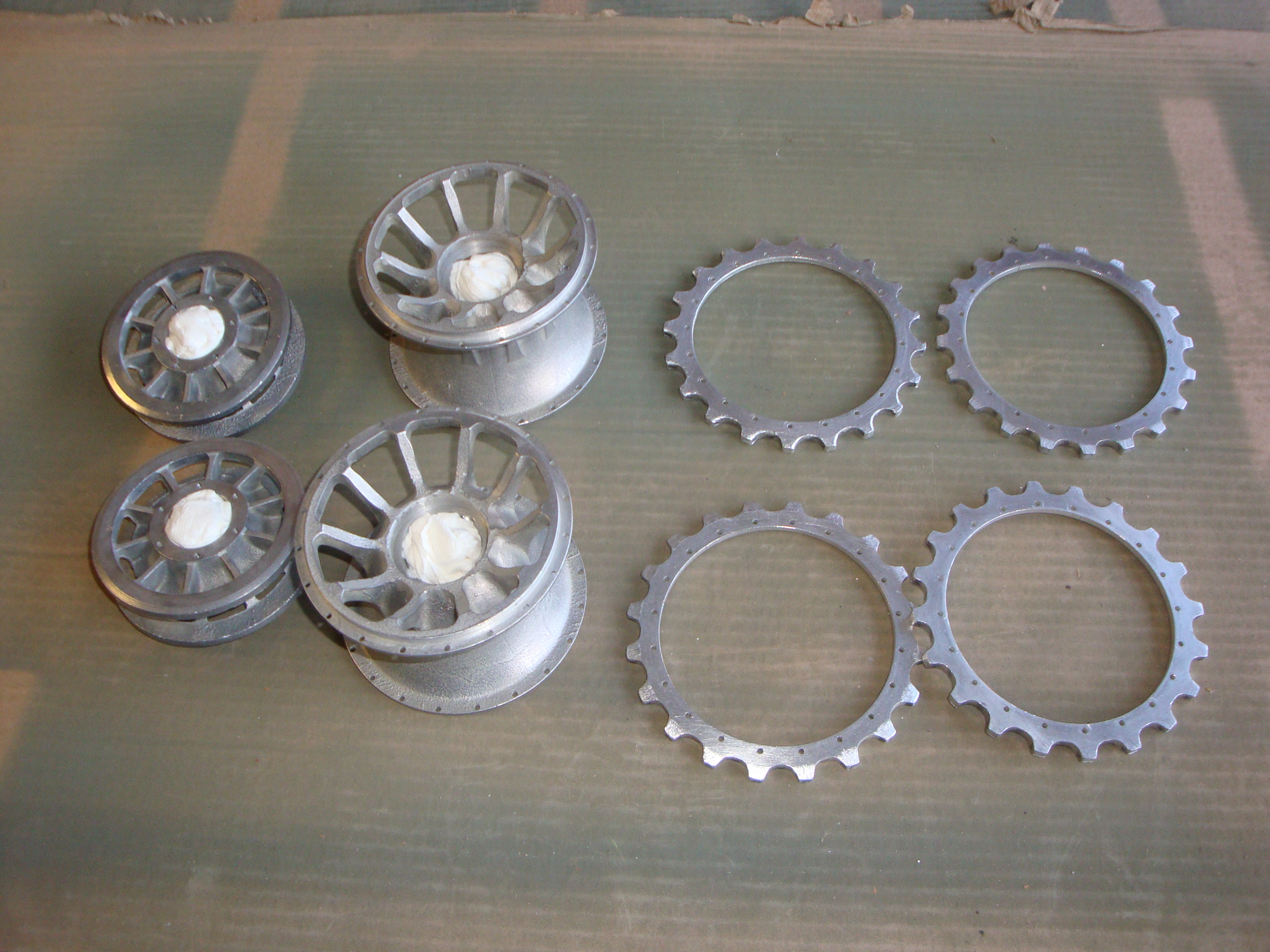

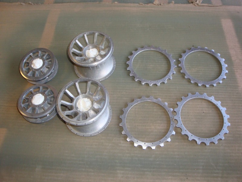

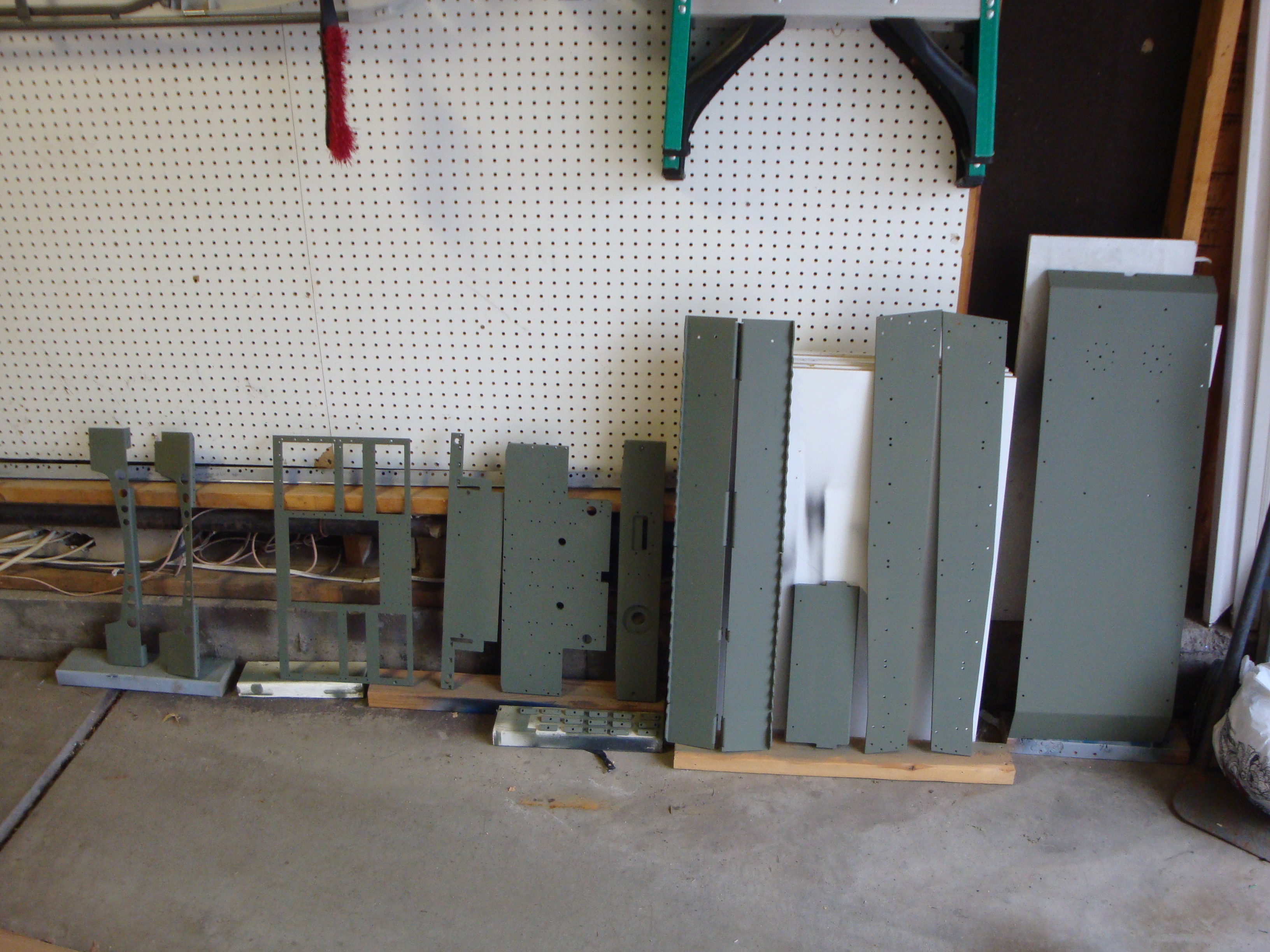

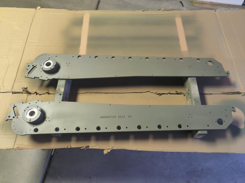

During the past couple weeks, I also coated some of the parts with etching primer (Duplicolor).

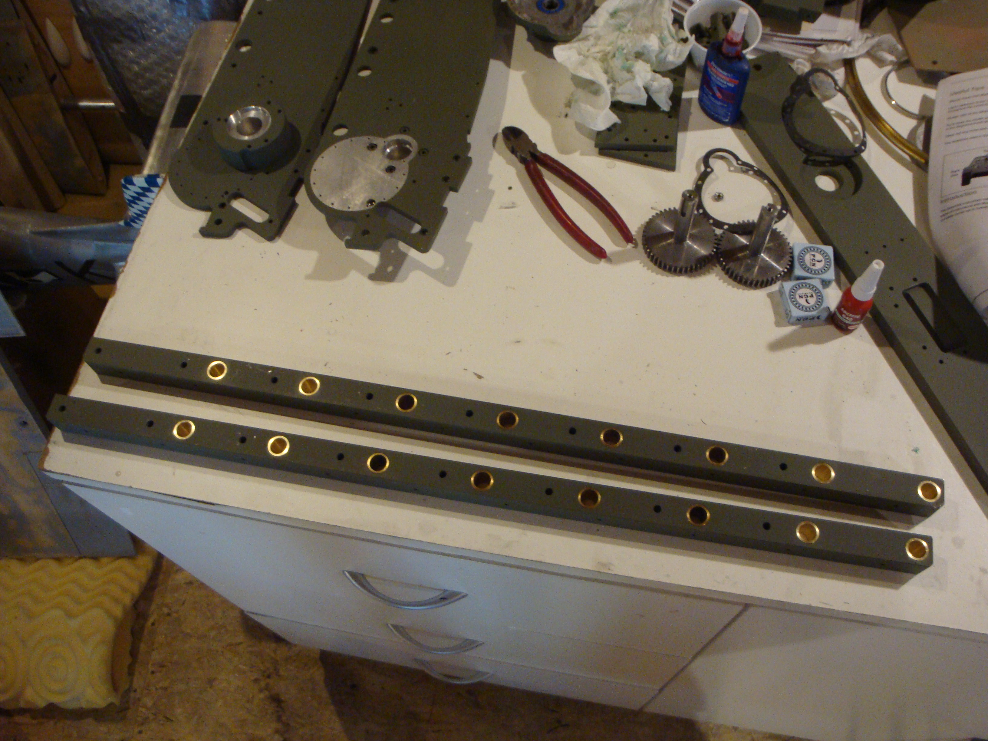

Got also the axle bushings fitted in the suspension bars.

Re: LATE TIGER I, #56 2012 SERIES restoration

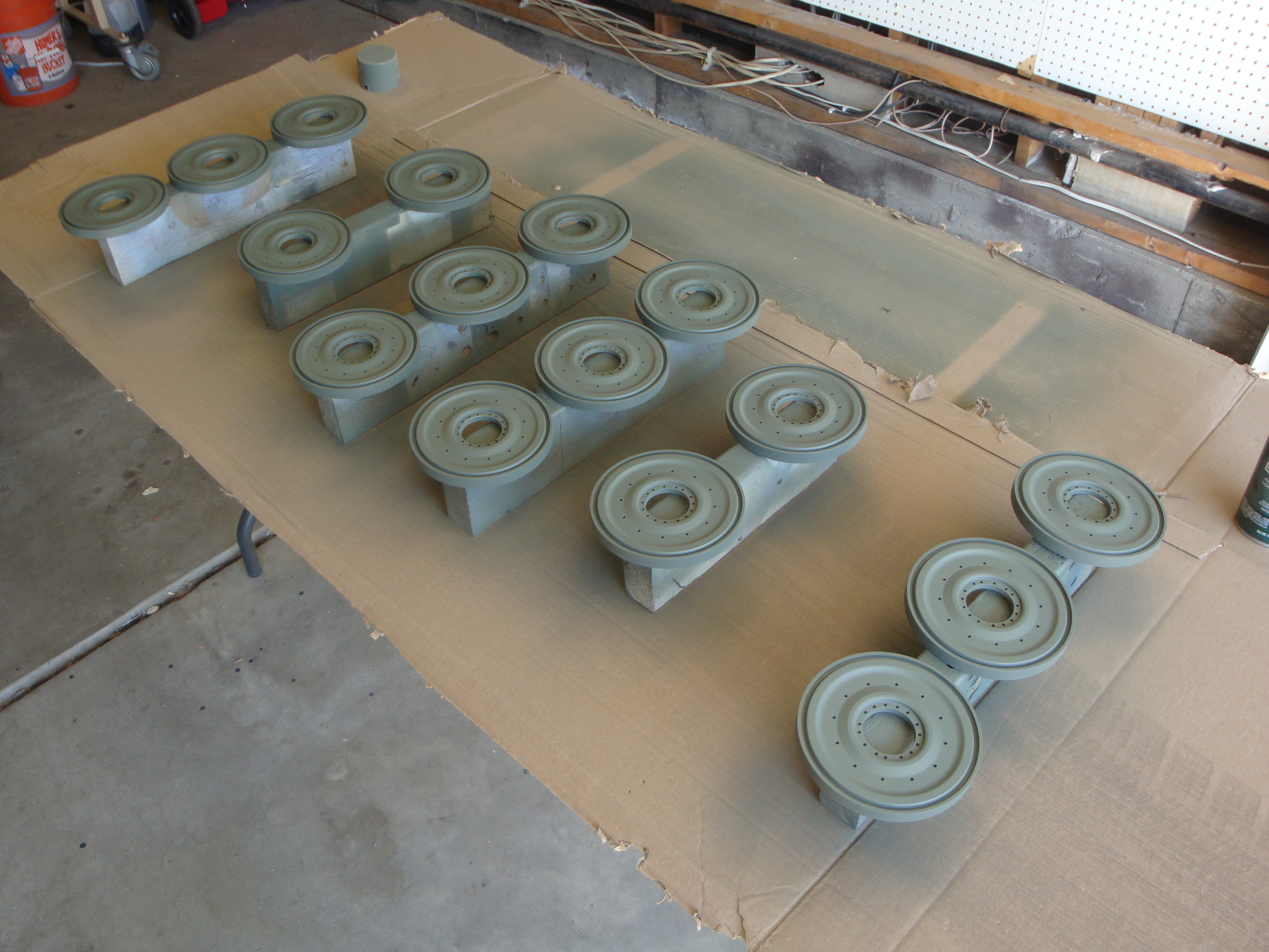

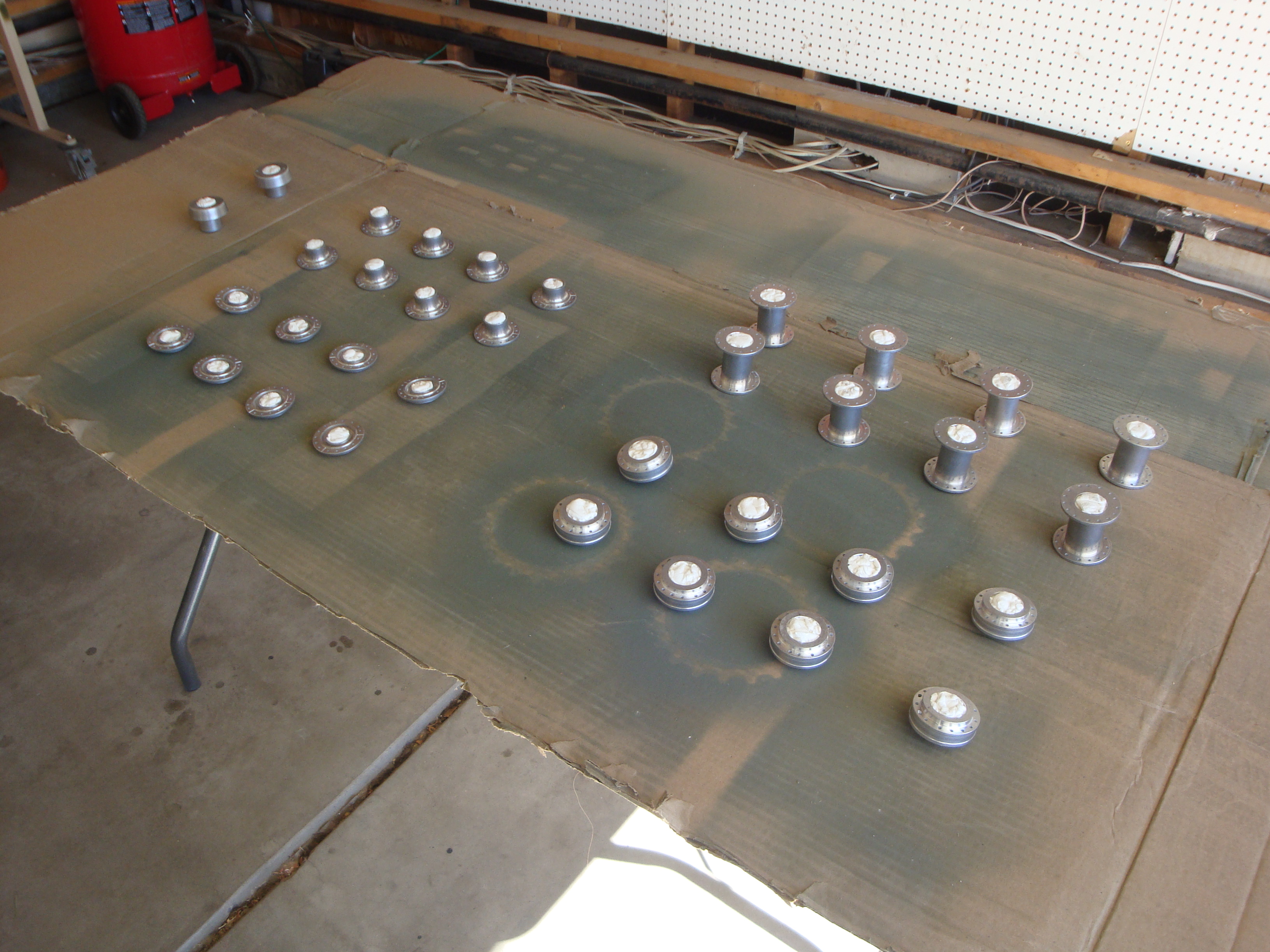

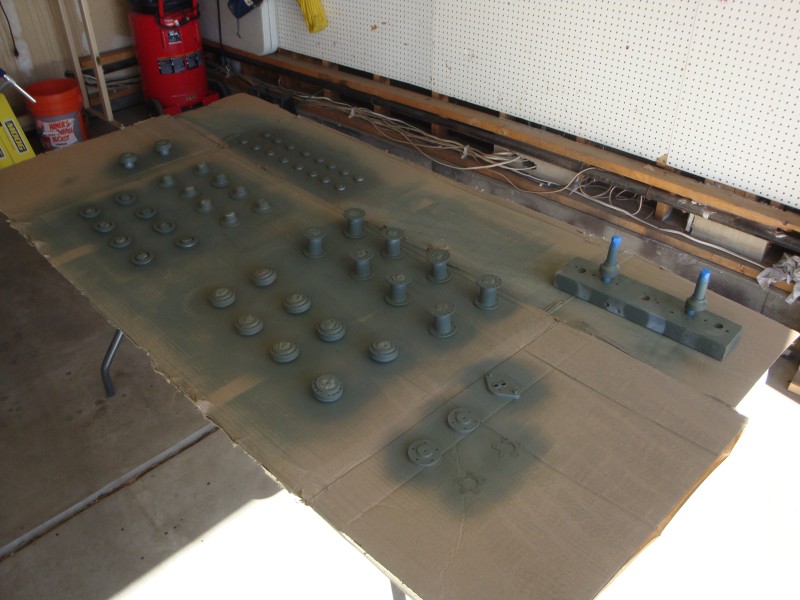

Nice weather here in Colorado, went to get some more Duplicolor etching primer and proceed with spraying all the hubs and some other parts.
