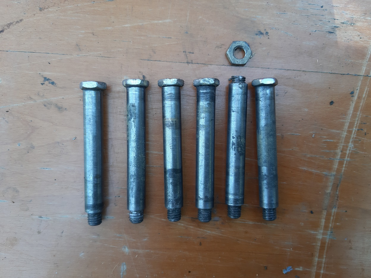

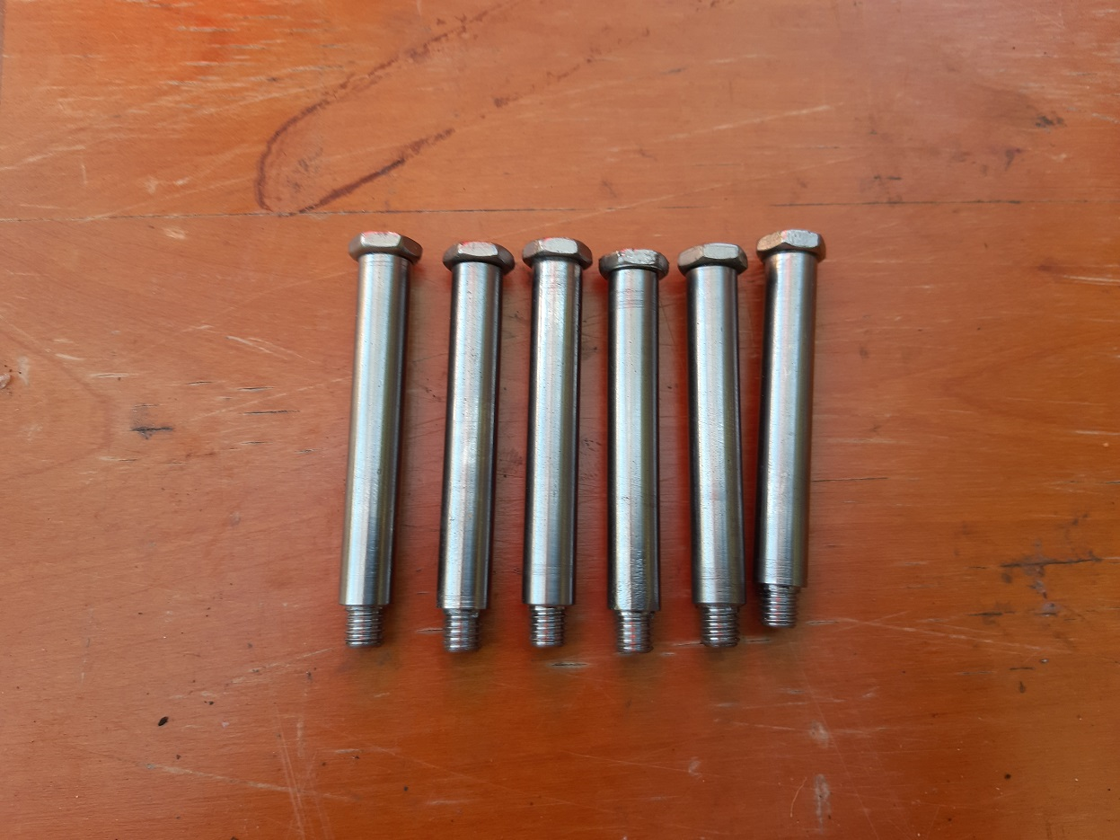

I managed to clean up the axles yesterday morning and they seem to have come up well.
There is still some slight scarring at the ends, where they were rotating in the suspension arms, but there didn't appear to be any corrosion.
I also ran an M6 die along the threads to clean them up, and to repair the one damaged whilst it was being hammered out of the wheel :roll:
I've cleaned up the wheels as well and hope to get them all back together today. I cleaned the bores of the brass bushes with a wire bottle brush and only one bush came loose, so I'll glue that back in.

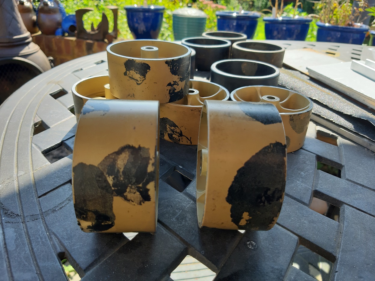

The tyres had been glued on with patches of glue.
I think that the tyres could flex, like a caterpillar walking, and slowly peel themselves off the glue.
I've reattached them by placing them on the wheel, inserting the nozzle of the glue bottle between the wheel and the tyre and running it all the way round, then turning over and doing the other side. Hopefully that will keep them in place.

One problem re the tyres coming off is that they are glued on over paint.
The glue sticks to the paint, not the metal wheel. You will be much better off removing the paint first.
