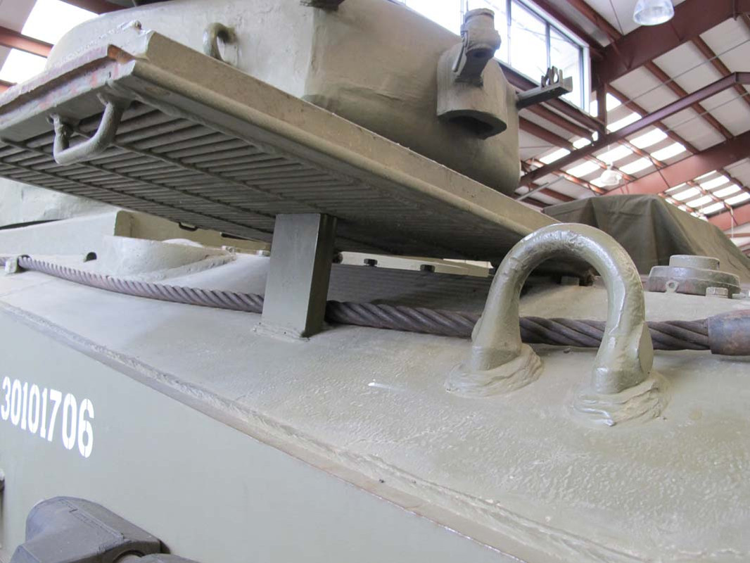

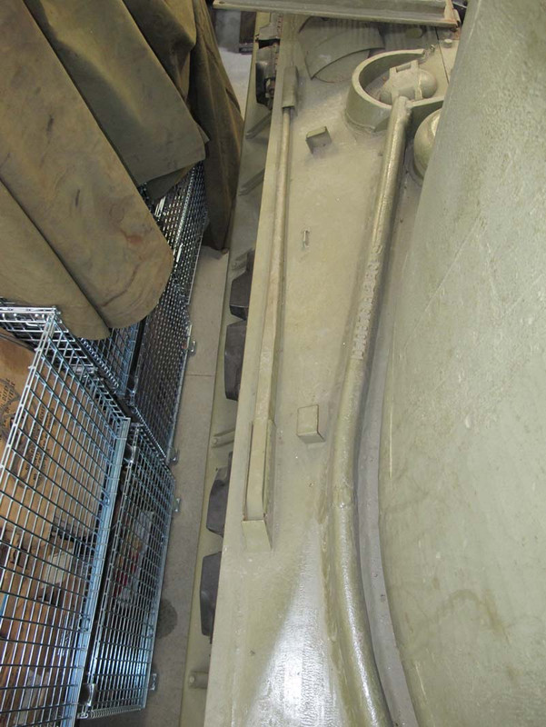

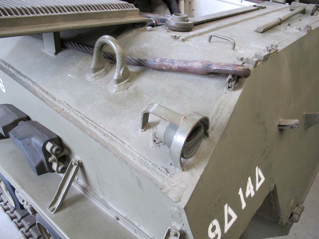

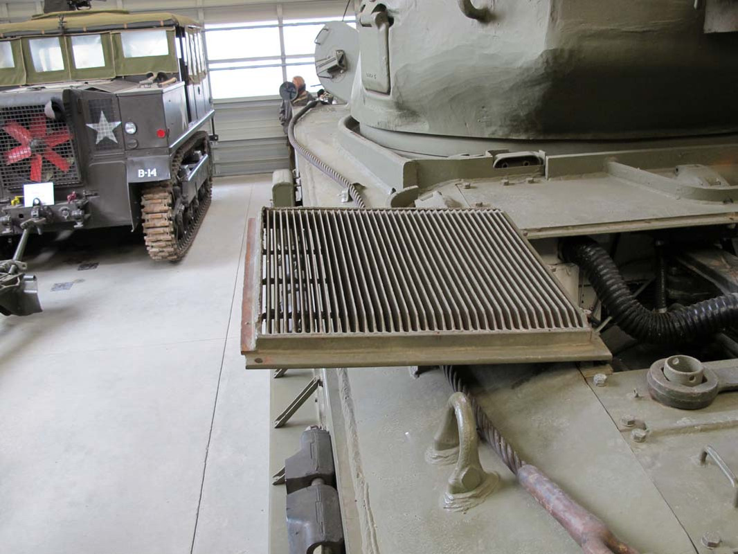

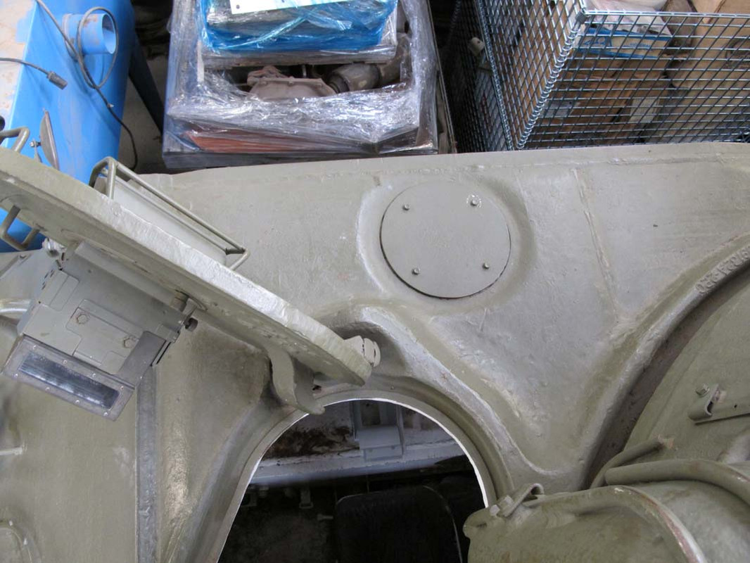

Tom
These may help? The upper deck is welded all around the edge - except the rear removable engine access plate. The image with the tail lamp shows this - no welding across rear plate (where folding shelf is mounted) for the engine access cover.

Thanks Bob. That is the info I needed. I was pretty sure the sides were welded but I wasn't sure about the front and back.
