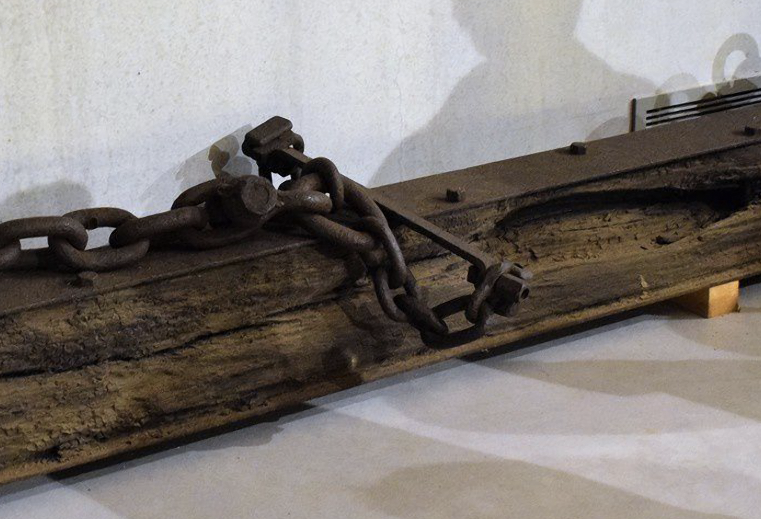

- Abou-Ben-Adam mark IV beam (Philippe Gorcynski collection)

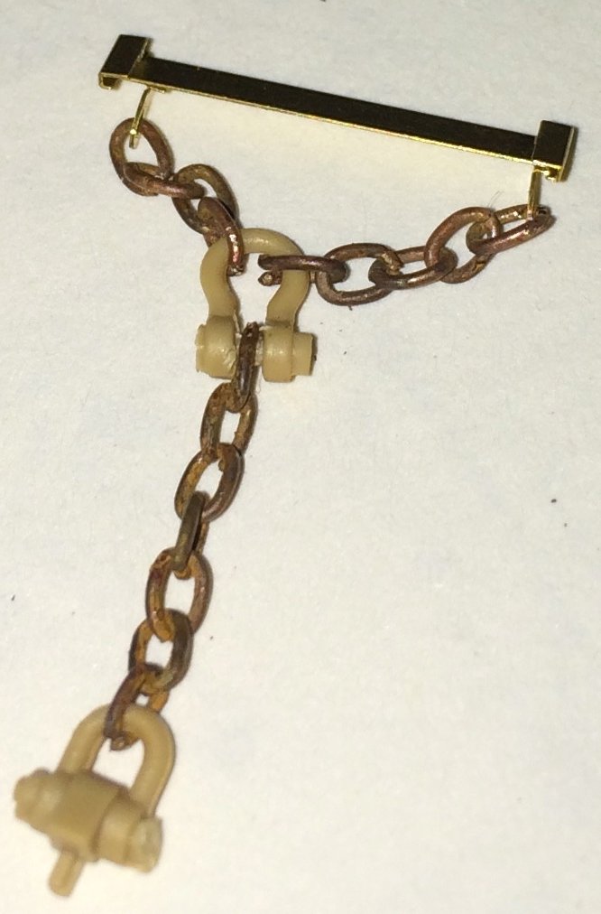

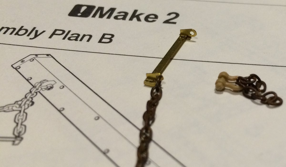

- some pics from a building review of the TAKOM 1/35 kit

- Unditing-beam.jpg (129.29 KiB) Viewed 7565 times
- large_000000.jpg (86.55 KiB) Viewed 7572 times

I had also used the example of the Takom model and the Mark IV as a guide, but didn't really get any further.

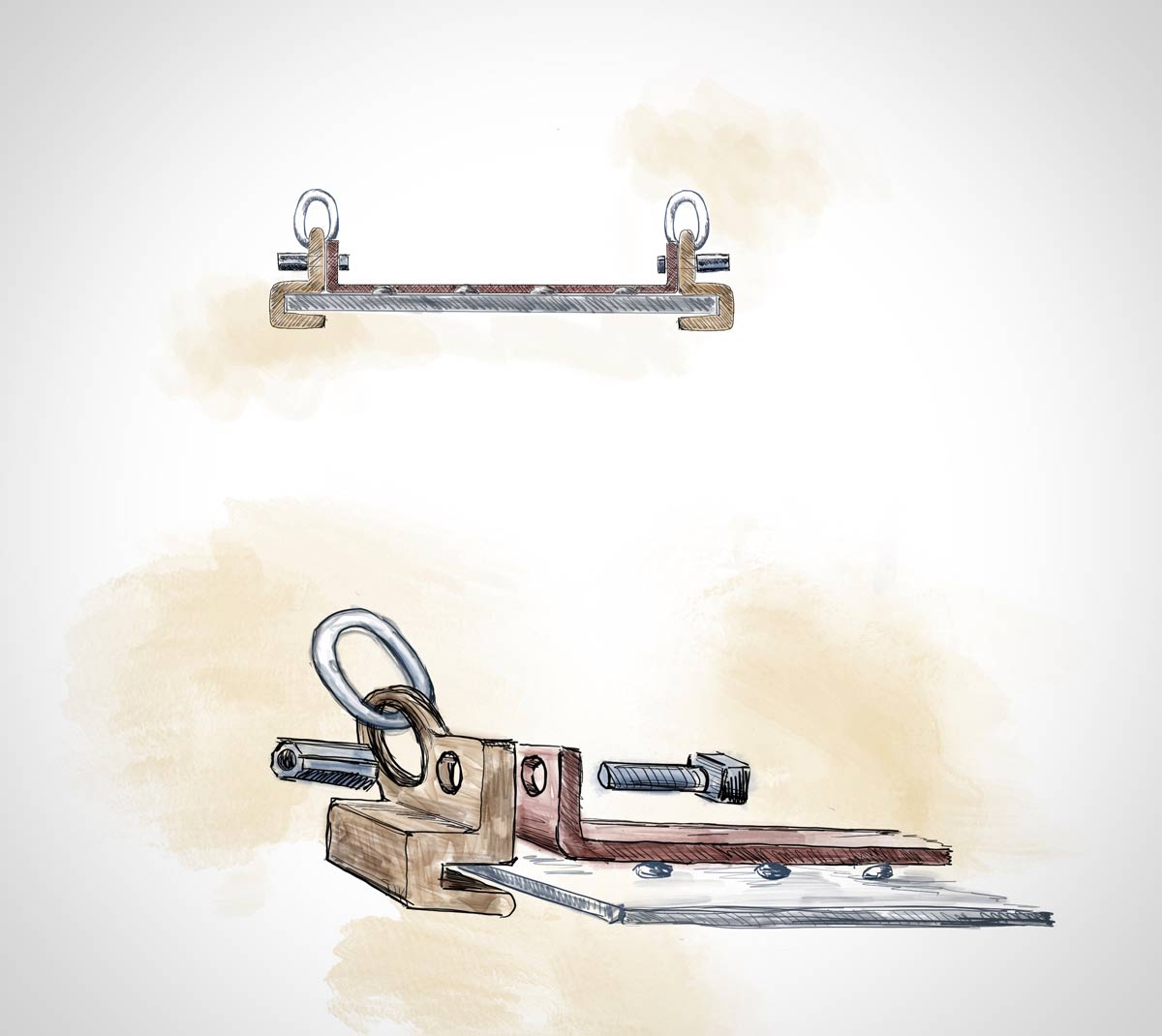

With a small update of what I have discovered so far I would like to bring the discussion forward again.
The unditching beam could have been attached to the tracks in the manner sketched.
Only two long nuts would be needed for this.
This could also have been done quickly under fire.

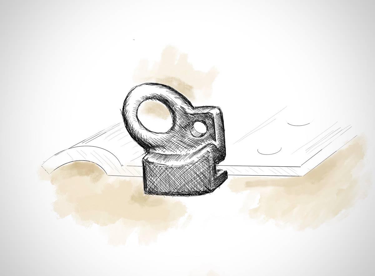

The most interesting component is the probably forged clamp at the end of the unditching beam's chains, which is attached at the side to the track plates.
All tensile forces converge here and it must be very resistant.
If anyone can provide any other helpful hints like pictures, food for thought or measurements that would be great. Maybe such a strange piece of metal has already been found and is lying around unnoticed.
Oliver
