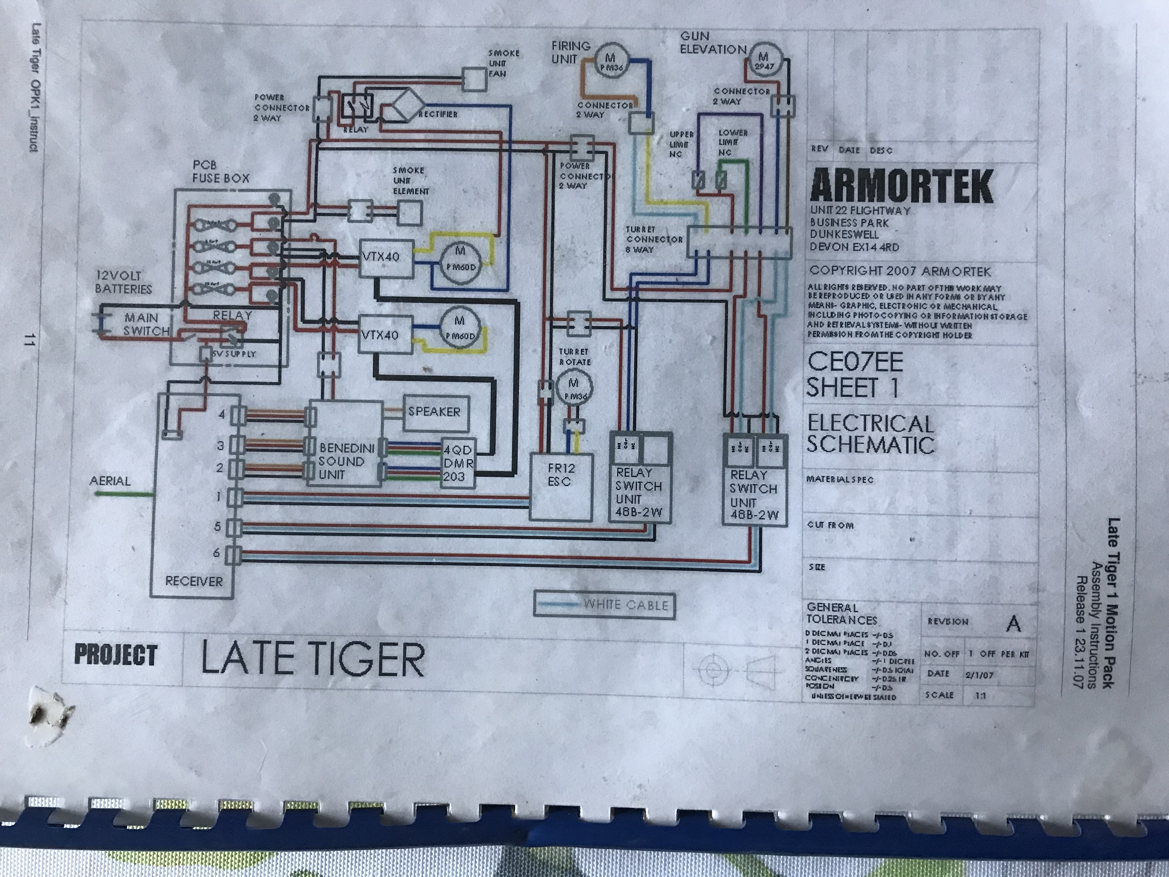

I have a late Tiger 1 with a Benedini Sound unit. I am installing a Raspberry Pico to incorporate a recoil function and a paintball pistol for launching powder balls.
So the attached schematic that I found shows that the signal I was looking for was an option that I don't have, Channel (5). So now I'm going to have to count off channel 4 and trigger when the 4 pulses for the cannon are entered.
Have you seen others doing the same?

That's a very old schematic, where the firing unit is the blank firer Phil Woollard has just posted about.
The Benedini already produces a logic signal when the main gun sound is used, so you would just need to look for this signal to go low and use that to trigger your system. On the TBS5 it's on the pins next to the sound output. On the TBS Mini it's the second to last pins at the opposite end to the audio output.
I've used both the counting pulses system in an MG splitter box and it's fairly simple to do, though you do have to cater for the speed at which the toggle switch is operated.

So if I understand you correctly: Output 6 on the sound card is High and goes Low on the fire command?
Sorry for the questions but I'm coding on a breadboard away from the model.
- Posts: 5134
- Has liked: 1495 times
- Been liked: 1699 times
Re: Sound Pack Fire signal
Yes. One will react to the MG sound and the other will be the main gun.
