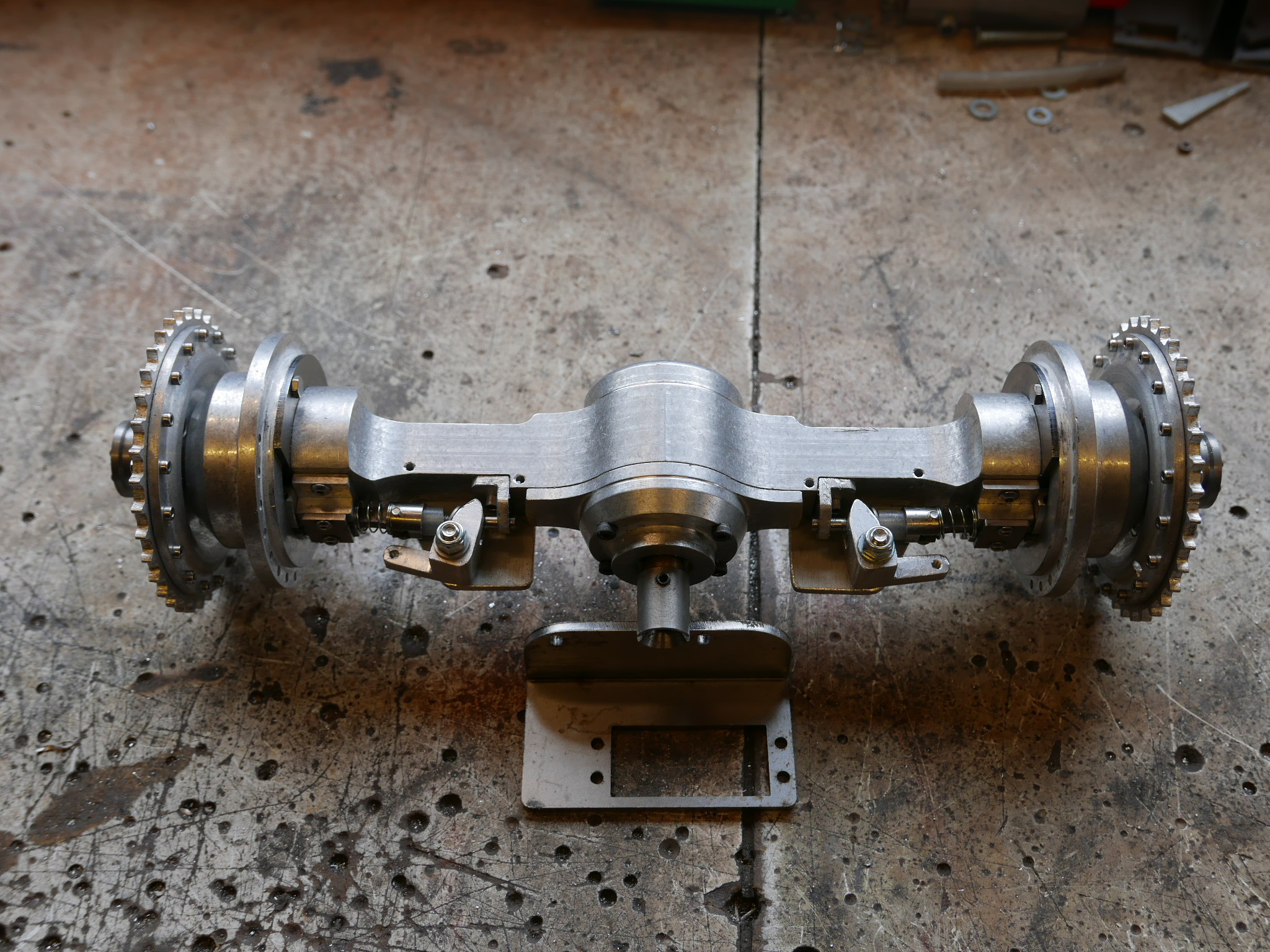

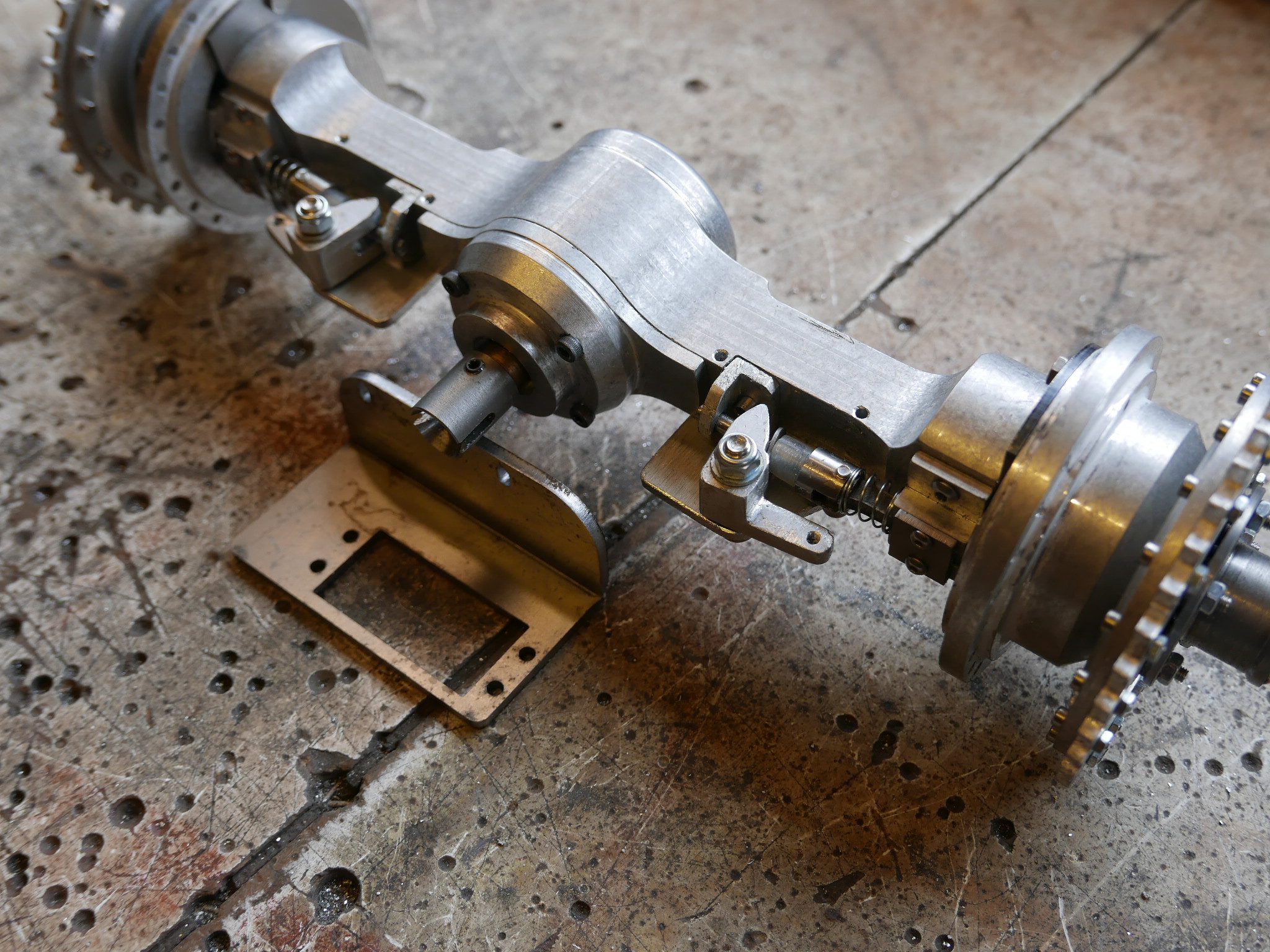

More news on UC no. 64, the ambulance. Having partially installed the motion kit I discovered that without a more sophisticated transmitter than my Spektrum DXe I was going to run into problems with the servos stalling as they tried to move the brake mechanisms past their mechanical limits. So a new plan was evolved.
I have added some extra linkage hardware to the pushrods which feature rubber buffers to give me some compliance. This means that the servos can travel to their limits without stalling, once the brake block is in hard contact with the disk the rubber compresses to take up the extra servo travel. I changed to compression springs to push the shoes back off and this revealed a flaw in the mechanism. The shoe was getting hung up on the edge of the button head screws and was not releasing until the motor was stopped. To fix this I put a light chamfer on the relevant faces of the brake shoes. after a bit of tuning of pivot locations, throws, angles, rubber hardness etc I came up with a solution that works well with the motor running on the bench. I need to put the tracks back on and try it in anger.
The photos show the new mechanism assembled to the axle. Since the photos the rubber buffer has been swapped from silicone tubing to hard rubber tubing and I moved the pivots (yet again) but the basic mechanism should be self-evident. The servo pulls the operating arm which pushes the shoe against the disc, the spring retracts things when you centre the steering. There is just enough room for the arm to clear the mechanism on opposite lock but I plan to make a modification to the servo connection to sort this out and make adjustment easier.
I'm suspicious that I'm now getting enough brake pressure to make the button cap screws in the discs unnecessary but I'm going to do some test driving first - one step at a time!

Like it. Looks good.
What are the chances of adding a transverse drive rod to control the other brake from the single servo?
I saw a chap on YouTube cut a model race car brake pad from a grinder slitting disk. I thought super idea to make a thin grippy pad to attach to the brake disk.. Though I've no idea how long the brake pad would last against it

When I raced 1/8th scale IC cars the brakes we used were a brake pad material with 2 steel plates either side of the disc operated by a cam and considering we were doing up to 70 mph I never had to replaced the disc or the pads. I would like to do something similar but there's not a lot of room. I wonder how much pressure would be required to push a steel shoe up against brake pad material on the disc which if it could be done would make a gradual braking system instead of a snatch.

A single servo with rod is a nice idea. It could live in the central engine housing. If the rod was allowed to slide through the servo connection until it came up against an adjustable stop you could precisely adjust the point at which either brake came on independently.John Clarke wrote: ↑Tue Mar 16, 2021 10:06 amLike it. Looks good.![]()
I saw a chap on YouTube cut a model race car brake pad from a grinder slitting disk. I thought super idea to make a thin grippy pad to attach to the brake disk.. Though I've no idea how long the brake pad would last against it![]()
Thanks for the positive feedback, I feel encouraged...

I finally tested my brake setup over the last couple of days. The first test was a failure, the tracks were too loose. I took 2 links out either side (I'm now about 8 links less than the number specified in the build documentation!) and on the second try everything worked a treat. The main issue is that the differential is still very stiff and the poor old motor struggles at low speeds. The brake operation seems to be pretty smooth and I didn't see any instances of the brake not releasing in the admittedly short test drive. I'm really tempted to try the brakes with the screws removed from the discs (if I can bear the thought of taking the back axle off again, all those little screws...!).
Next step is to get the differential bedded in a bit better or go to plan B which is to swap in a geared diff from a 1/8th scale RC model which I think would suit the braked steering much better. From my RC experiences the ball bearing based diff is more of a limited slip thing so kind of works against differential braking.

Peter - instead of changing to ball diffs (which will probably not be able to handle the torque - or if they can, will require frequent maintenance) either run the diff on a power tool to loosen it up or change the viscosity of the grease in the diff.
