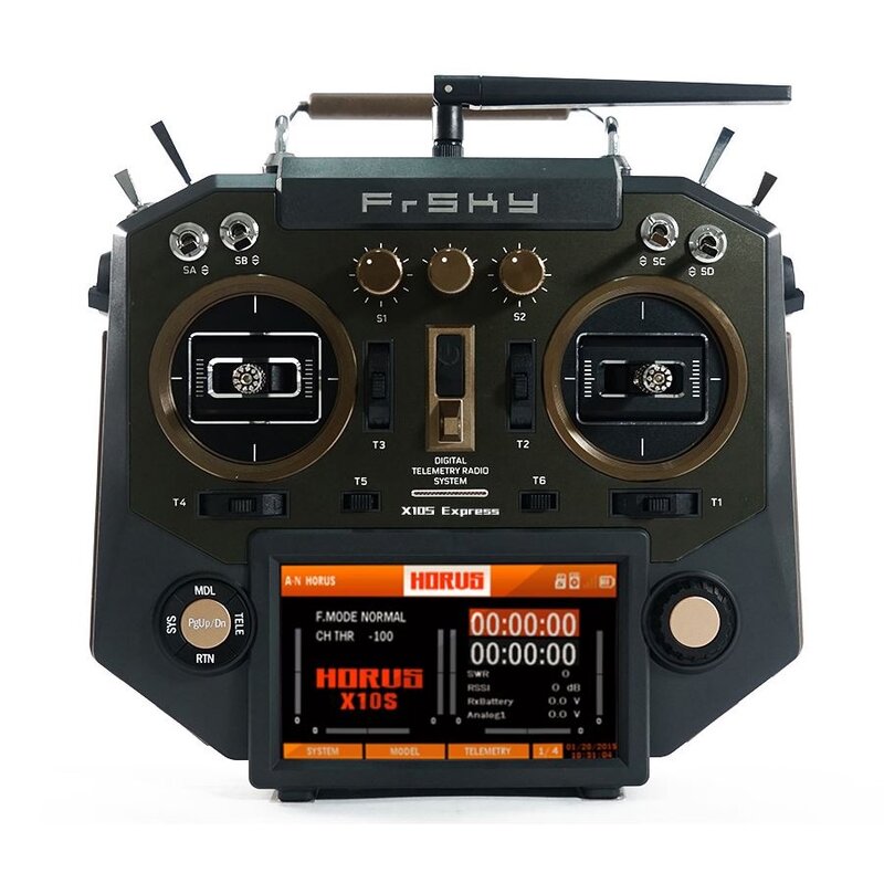

Way to go Adrian. Looks great. I'm convinced about software defined radios but I suspect a lot of us will be put off, as I was initially, by the apparent complexity of OpenTx. Just as I thought I'd mastered it, I decided on a new radio for flying and have just bought the FrSky Horus X10S Express. It's had very good reviews. Joshua Bardwell reckons it's the best radio available at the moment after the next model up, the Horus X12S flopped. The Horus X10S Express comes with FrSky's own OS. It provides almost all the functionality of OpenTx (except at the moment LUA Scripts) but is a menu driven OS which is far more intuitive than OpenTx. FrOS has all the logic structure of OpenTx but is much better packaged. So maybe, just maybe, it's more accessible to anyone who doesn't want to sit with the OpenTX manual of an evening. I'll report back once I've had some experience with it.

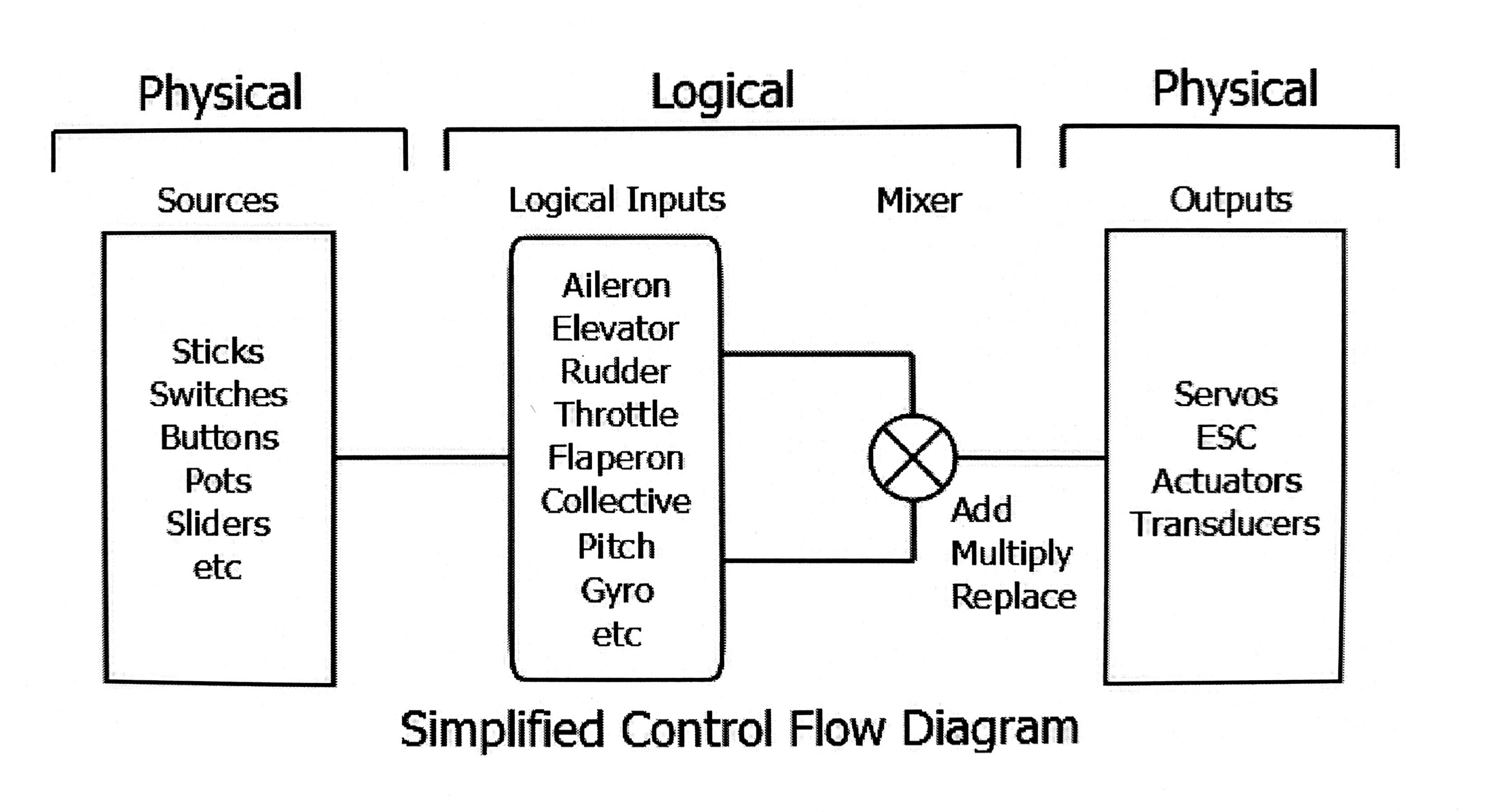

Gian Marco - how difficult is it to programme them? We're all different. I can only give you my experience. I found OpenTx daunting like any new software. The key to being comfortable with it is to understand the logic. Once you grasp how it is structured, the actual programming is logical and relatively easy.
This is the key to understanding OpenTx:
There is a very good simulator, called OpenTx Companion, which allows you to see if your programming does what you want it to without risking the model. When you're happy, you transfer the setup to the radio and should then be confident it'll all work as advertised. The only bit which Companion can't really simulate would be the Bendini Sound Card but the signal outputs from the radio will be and everything should then work fine. The best way to learn software is to play with it and the Companion allows you to do that without any consequence.
There is plenty of reference material. The OpenTx website has an excellent "university", an online resource, a combination of manual and teaching aid.
There is a good commercial manual available and plenty of videos, although I've not yet found any relating to tanks. You would have to take the relevant bits from the RC aircraft and drone communities and adapt.
I suppose a Knowledge Base topic and YouTube video would do the trick but it's a lot of work, as ever.
Once you get used to OpenTx, it's really powerful and you start to see how you might do things which would otherwise be impossible. It that sense, it's fun, once you get over the pain of learning.
