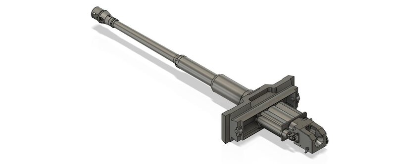

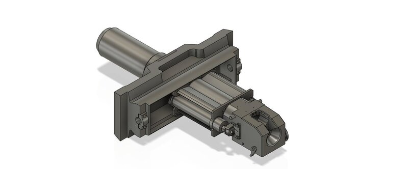

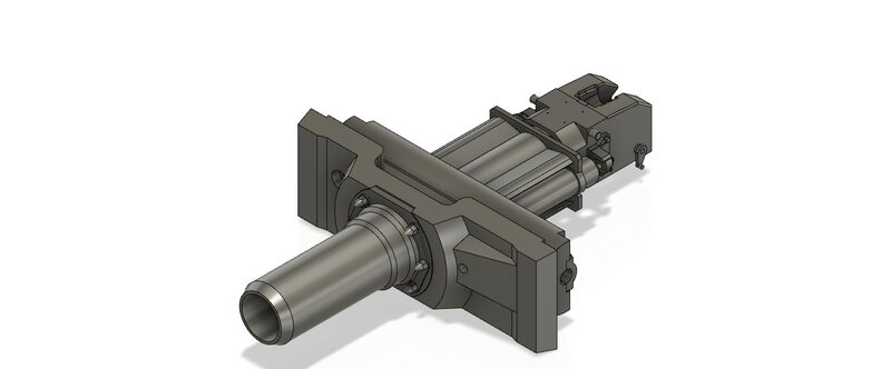

I have disabled the link to the 3D web viewer and instead I am posting a few images.

Beautiful CAD model Vince. Your skills have come a long way! That gun looks great.
