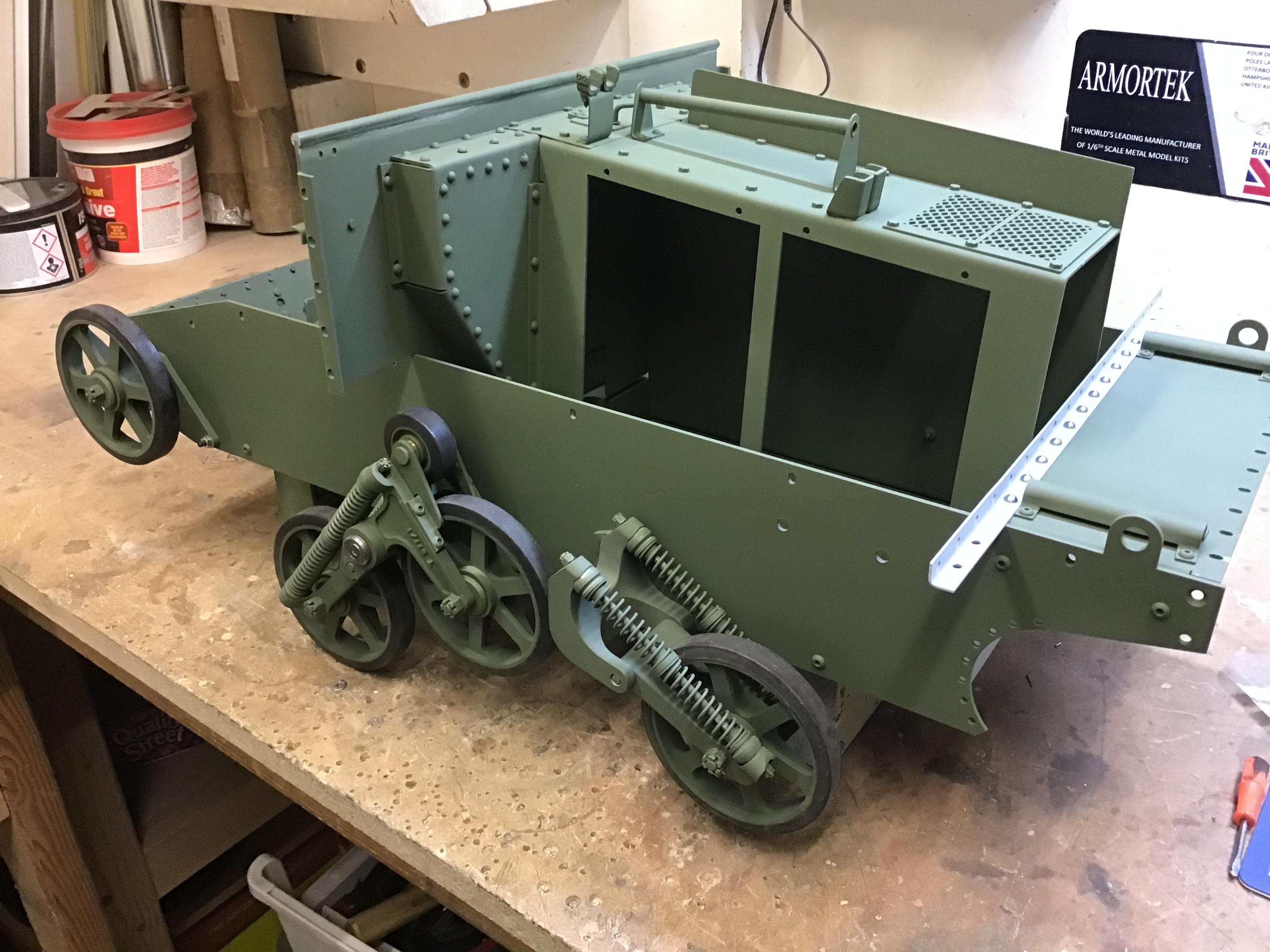

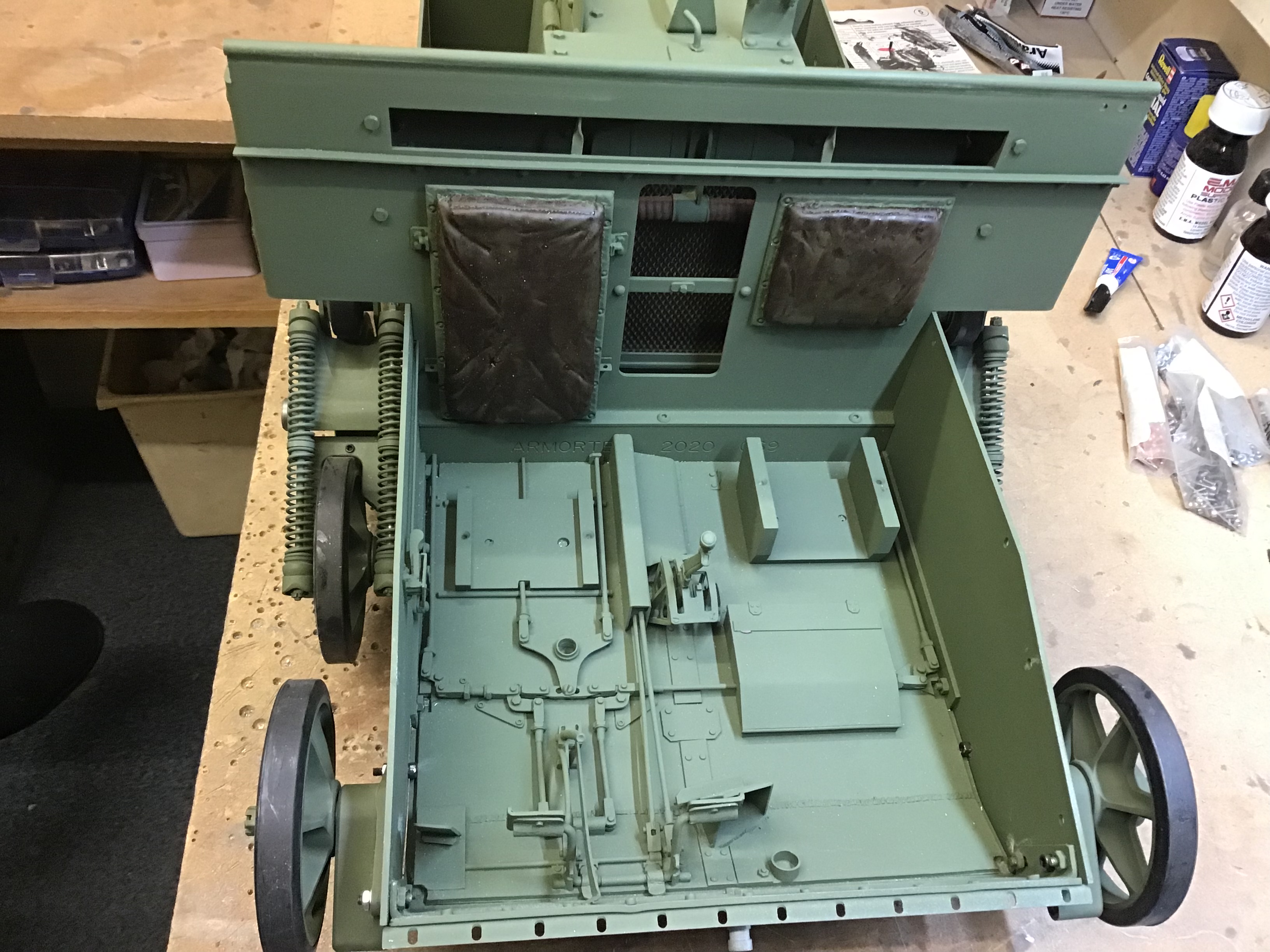

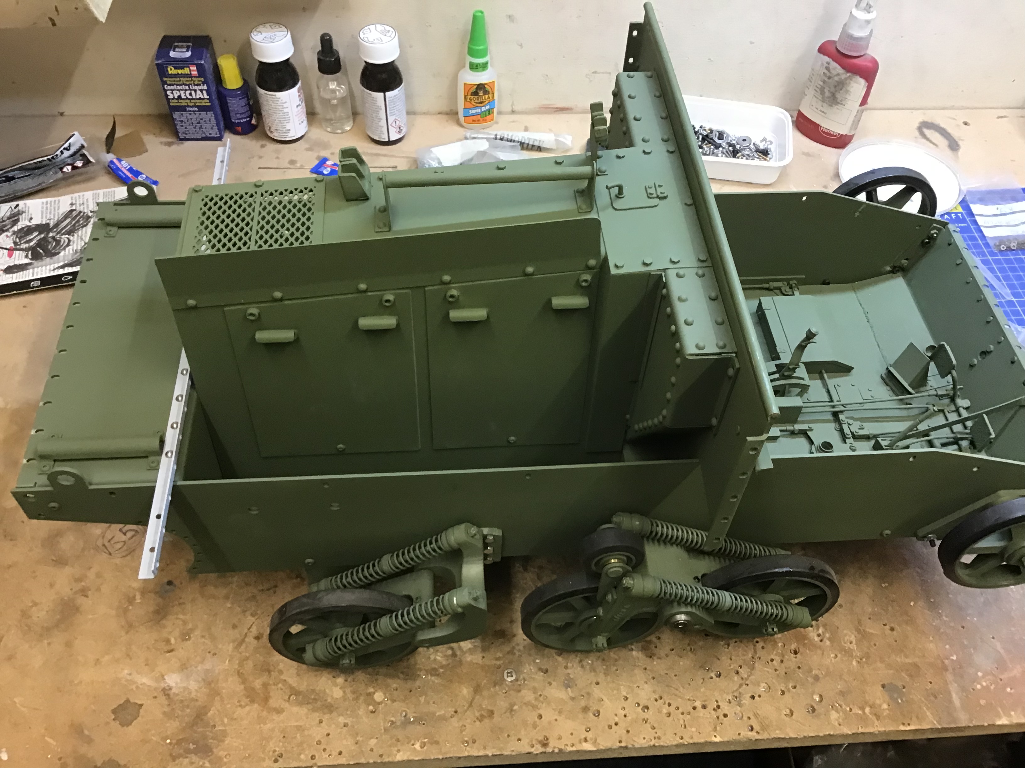

A few update photos of my carrier.
Coming along nicely, just need to finalise what gear ratio to use before adding the motors.
Big thanks to Dave Dibbs for the update kit

As neat as a professional Brazilian, as always!

Looking good. just make sure you don't mix up ER107 and ER105 as the one is slightly shorter than the other.
Dennis.
Dennis.
