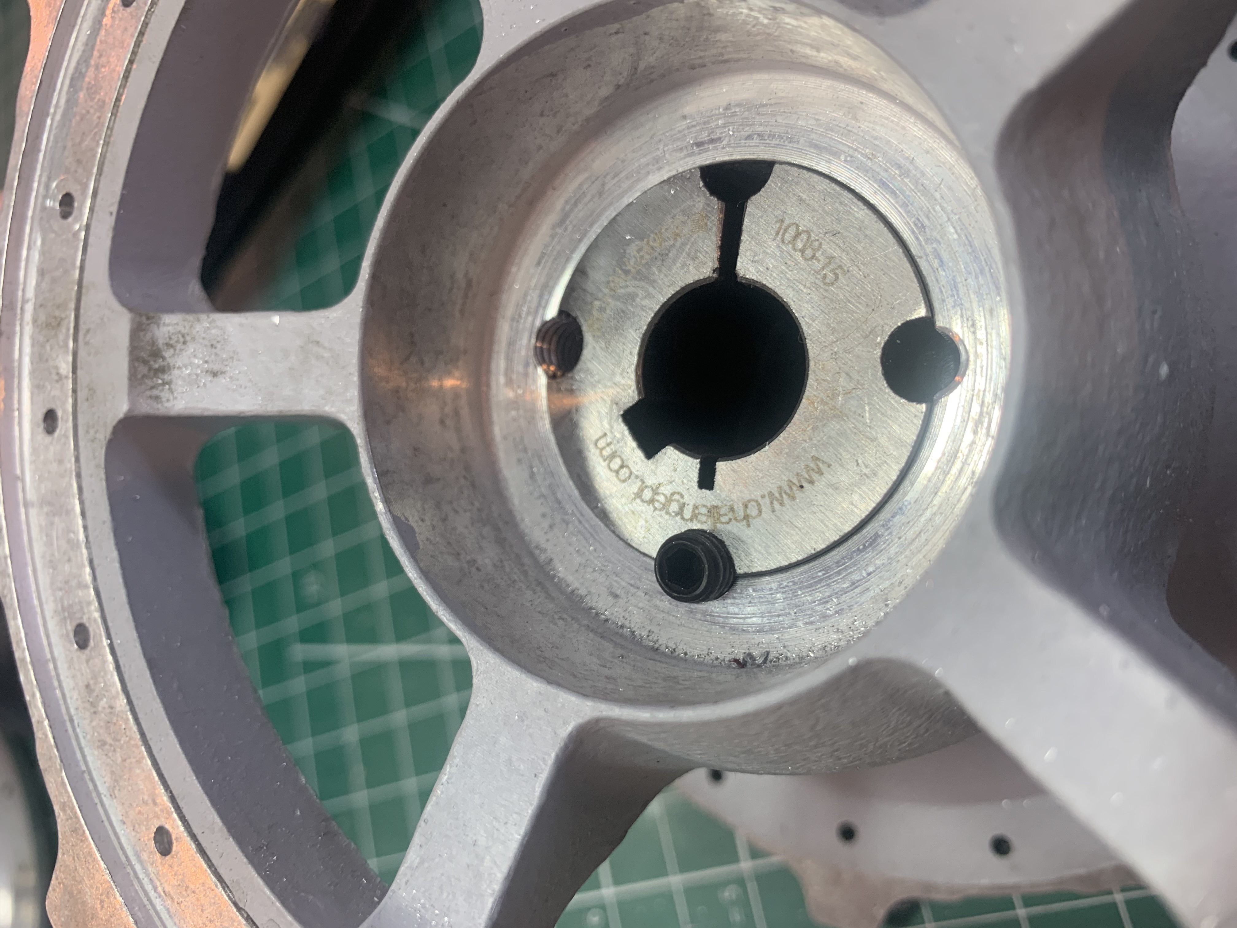

Hello Everyone
A heads up for when installing taper drive bushings. On my sprockets the push off hole is not big enough to get the grub screw into for bushing separation & removal. I enlarged my hub bore with die grinder, Not sure if other 2019 kit sprockets would be the same but it would be pretty messy trying to separate hub taper without push off screw. Or trying to bore the hole out in place.
