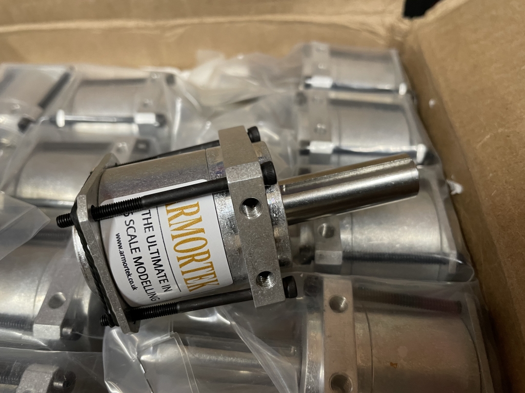

Shipping of the motion packs should start early Feb - custom gear boxes arrives, now just waiting on some laser cut motor mounts .....

I am in the process of setting up the servos for braking operation and I think that when the servos are centered the arm needs to be put on so that the screw is near the end of the raceway so that the brake arm is applied straight away and then adjust the amount of servo travel to match. The reason for this is when I assembled it one side would stop ok but the other side would not.
I also had to enlarge the hole that the drive shaft from the motor goes through as the boss on the diff was rubbing on the metal even though everything was lined up correctly.
Dennis.
