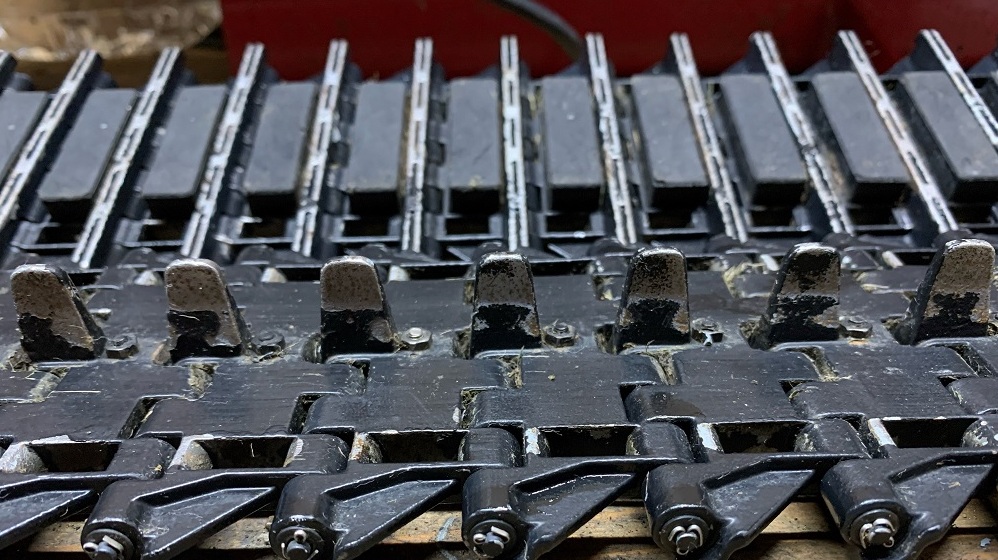

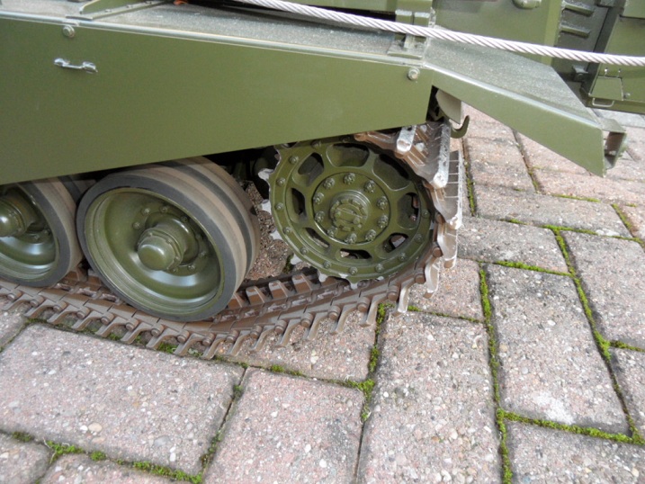

Post by Charles A Stewart »
Hope this helps.
I ran the chassis last, in late September on wet grass and soft ground the tracks accumulating lots of mud.
Afterwards I washed the mud off and left to dry, there was a patina of surface rust the next day, I have since gone over the tracks with a wire bush in a drill which has cleaned them up nicely, to me that is. After which I gave a good dollop of WD40.
The photos were taken today, the tracks have been stored since being cleaned.
Have the best Christmas you can and hope for a better new year.
Charles

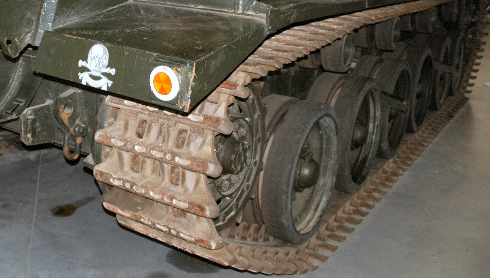

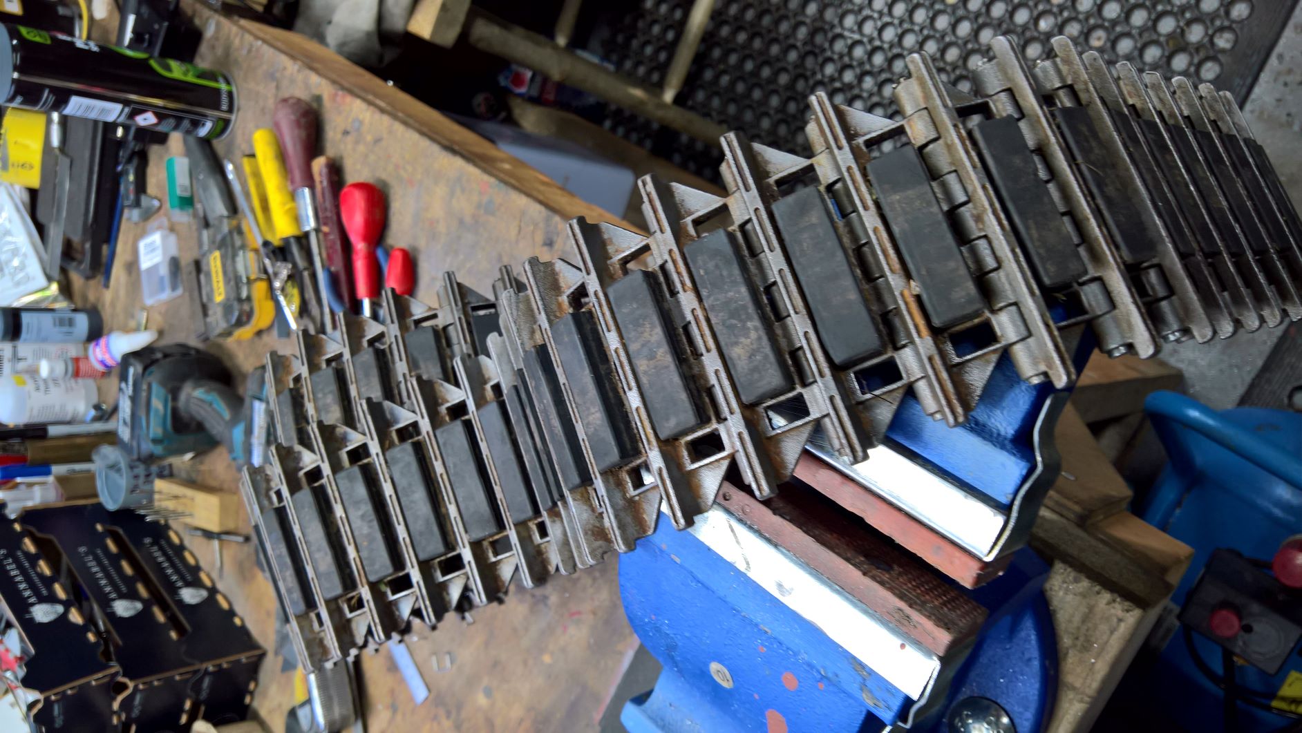

Yes but, no but, yes he said with a wiriery smile, pictures don't lie unless you've got photo shop, these tracks here are a few shades of grey, not new I grant you, they started out black and finished grey with a tinge oxidization or is red ish orange dust :lol:
Hummm what a Great looking tank below, (with 256 shades of grey ish tracks).
My favorite Chieftain Picture,,it really is the dogs.......chiseled pads and all eeeeek

Gorgeous looking tracks new, fit for a parade, but use them, (Sorry to remind you Richard :D )
Pads removed and the tracks seem polished up by the dust and dirt
Grey with a tinge oxidization or is red ish orange dust, case for the prosecution rested :wink:
