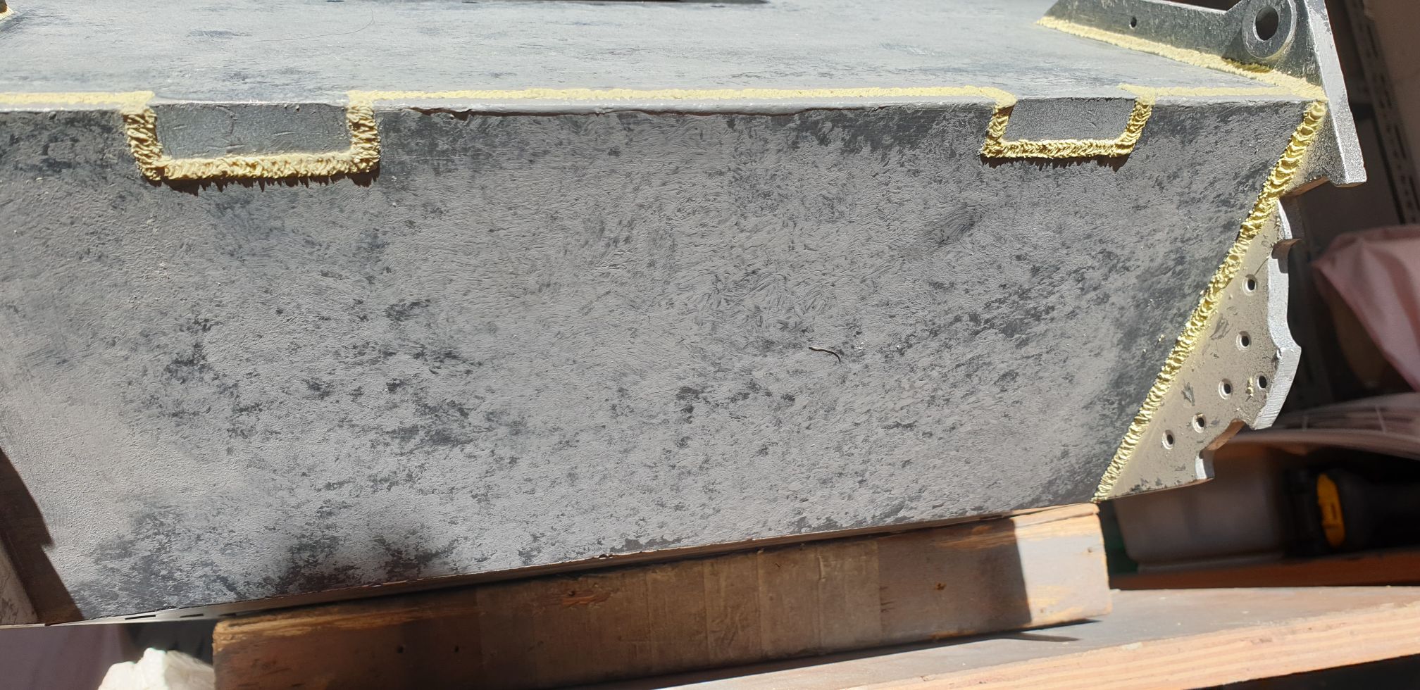

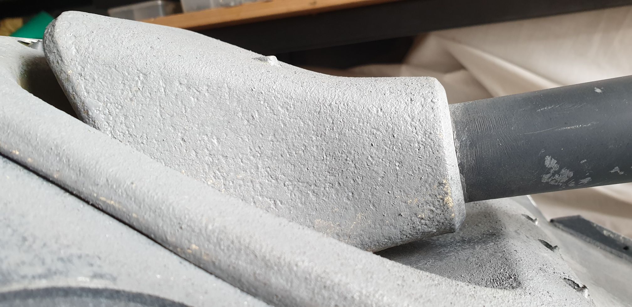

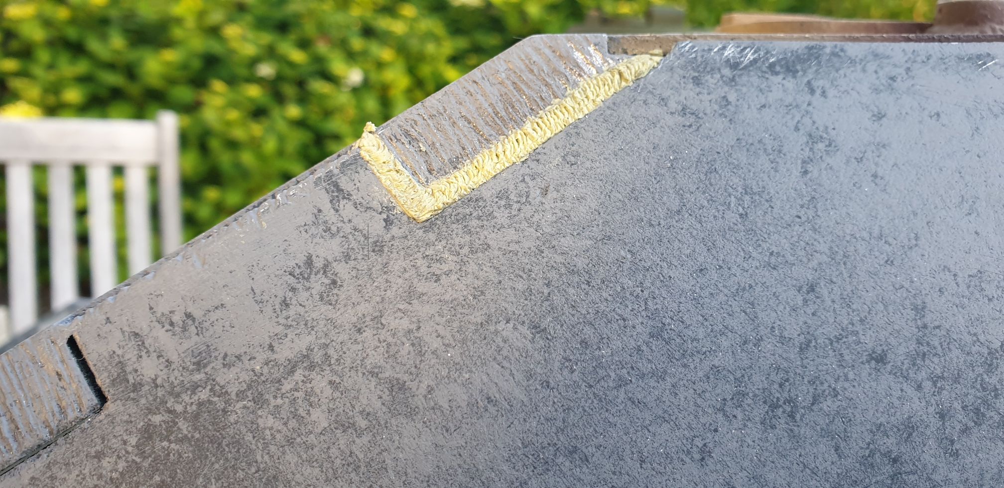

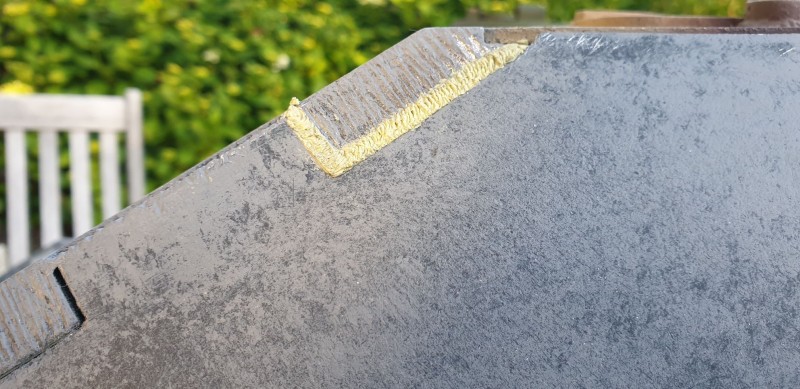

Re: Jagdpanther no 13

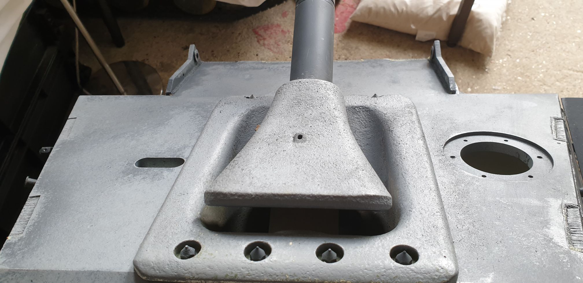

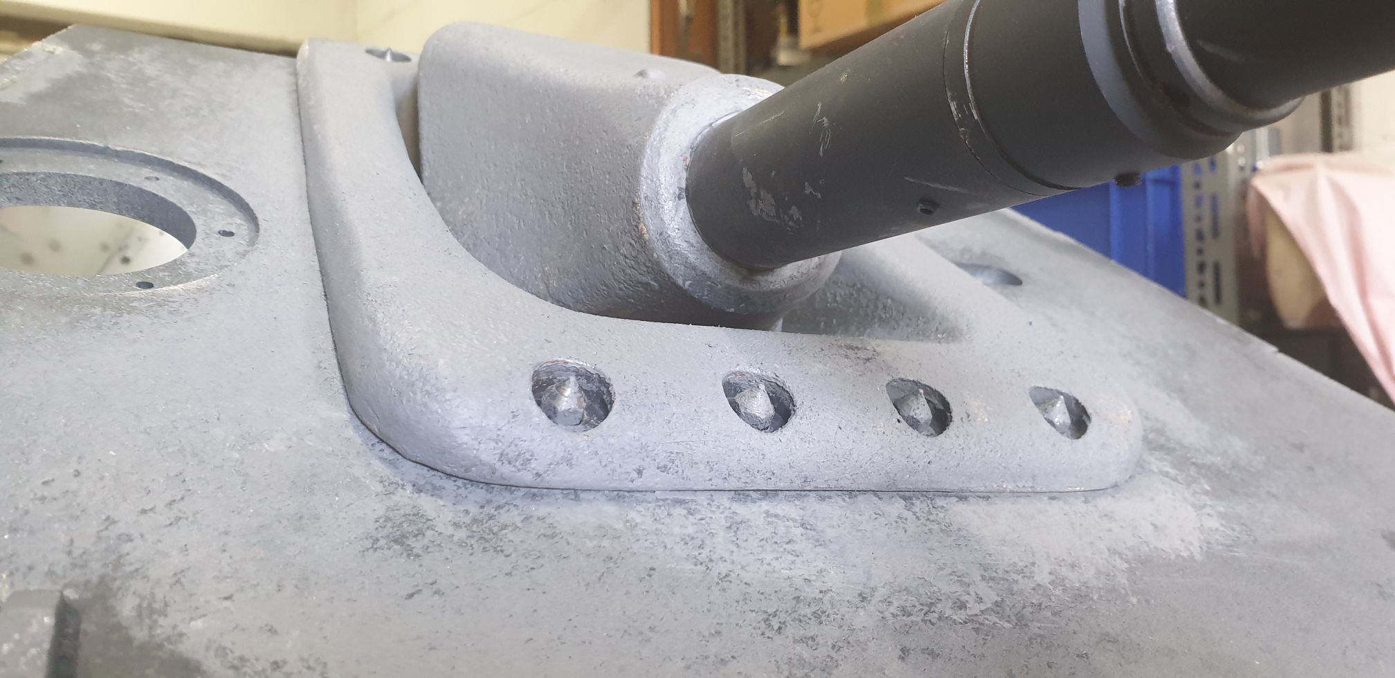

Thanks Simon - some more progress, flame cuts and fake welds in progress.
Regards David

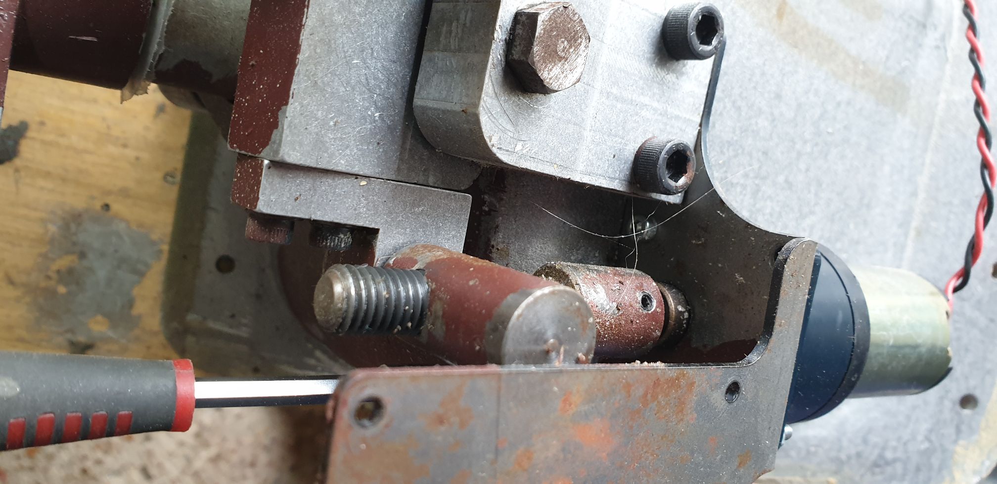

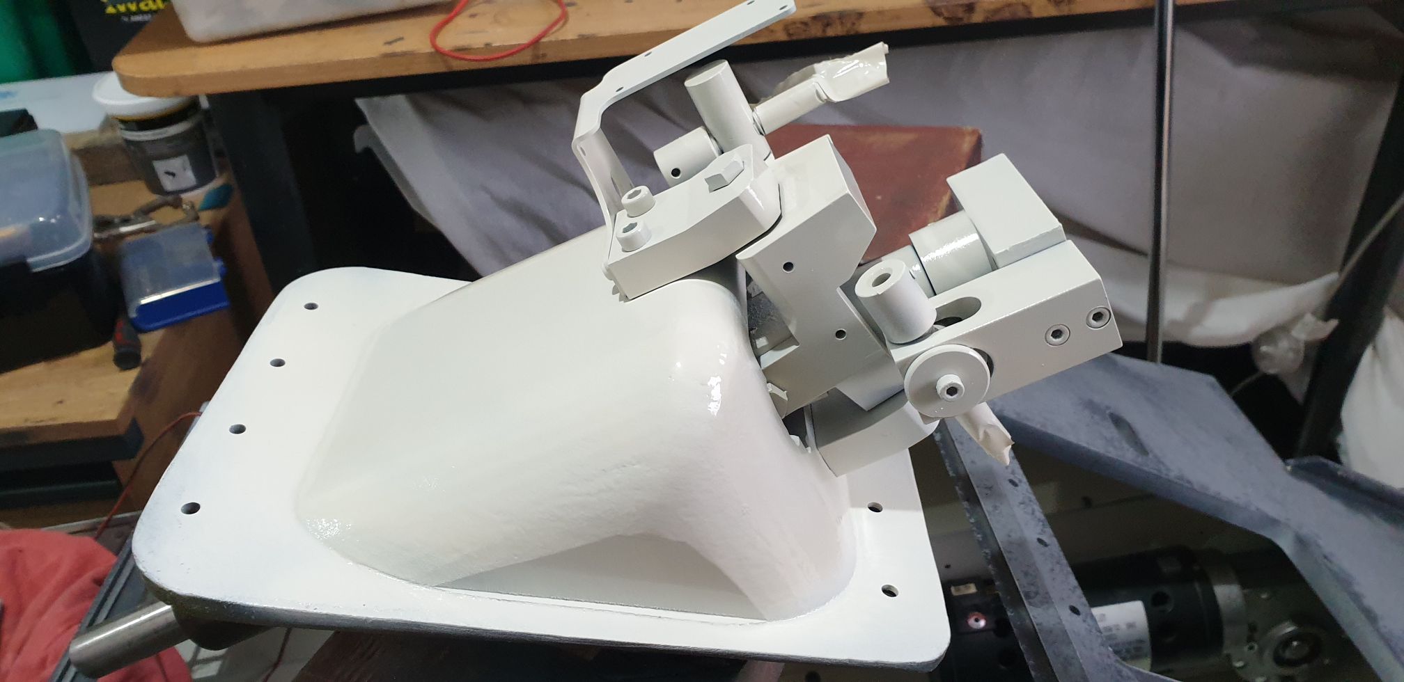

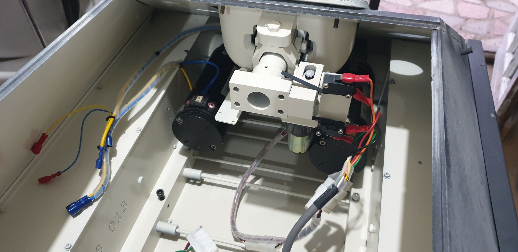

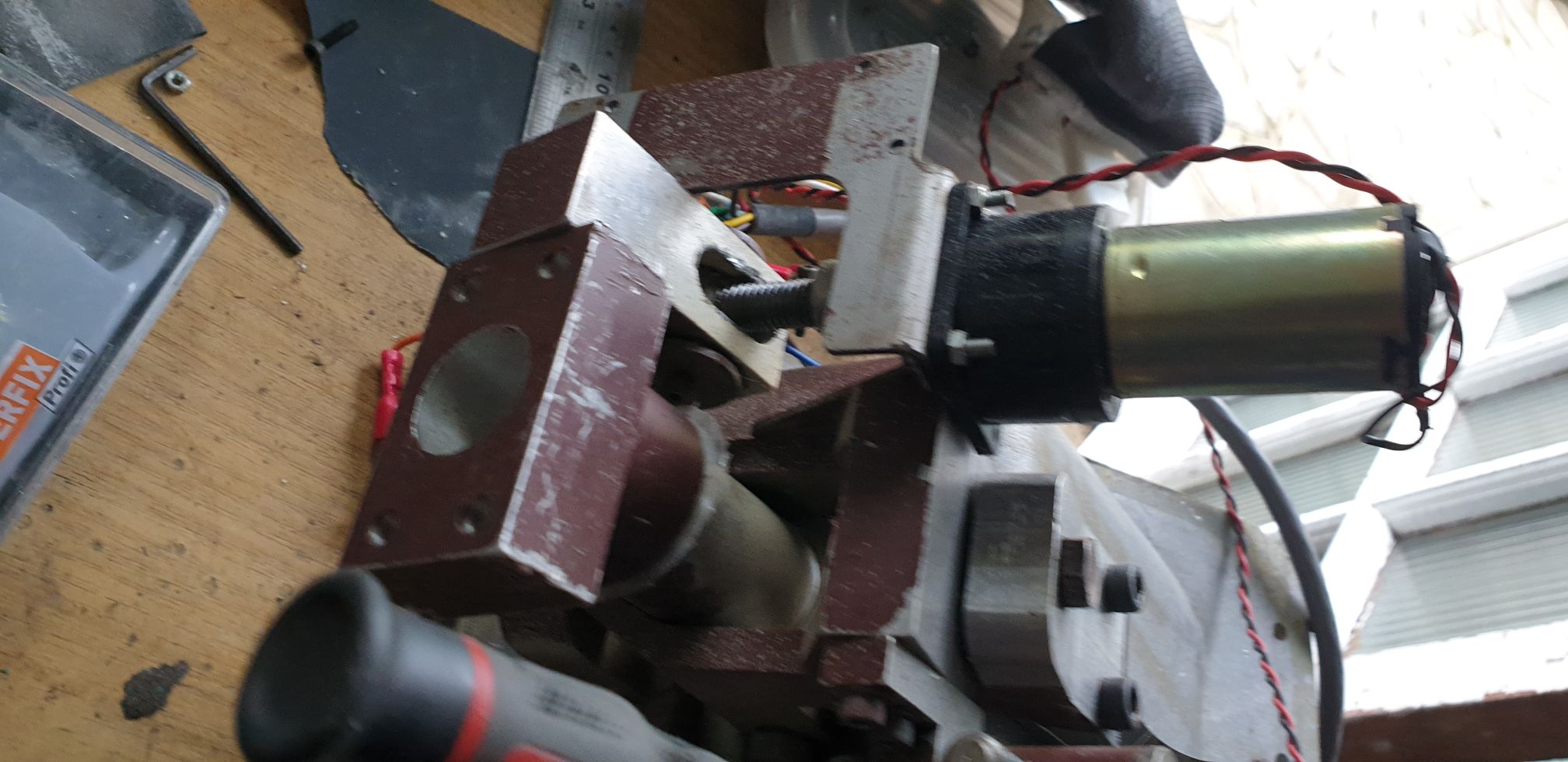

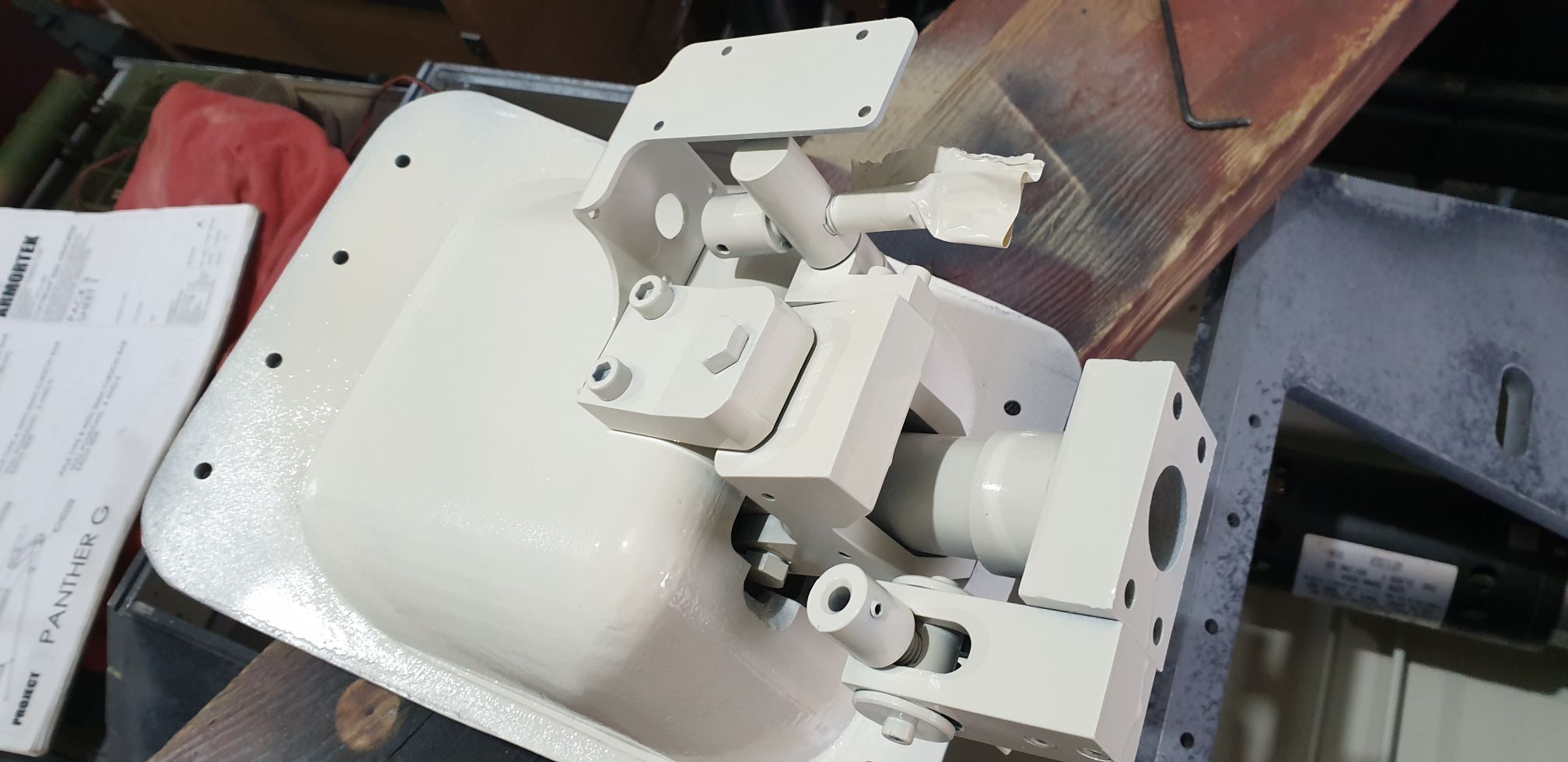

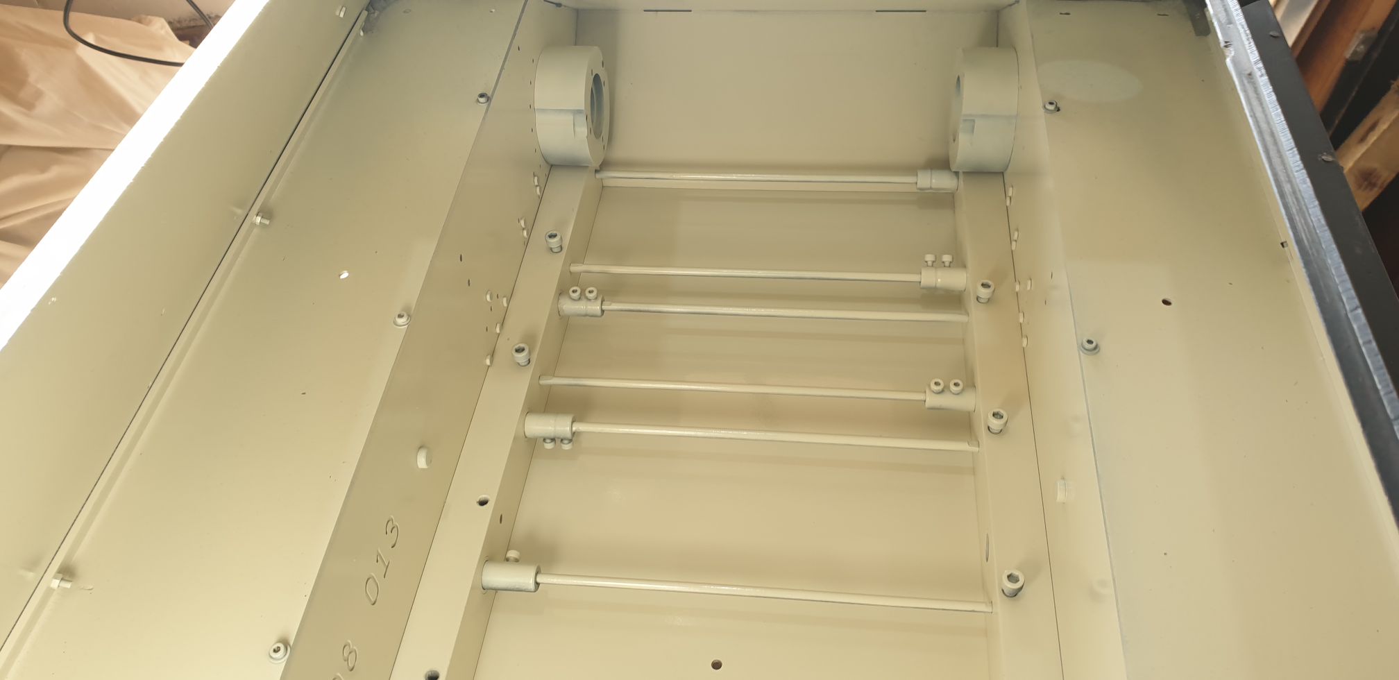

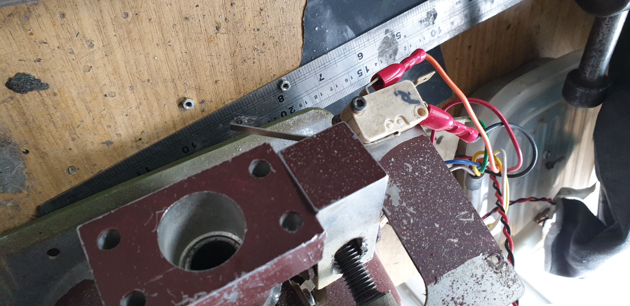

Stripped the elevation and lateral movement mechanism back to components, cleaned and etch primed then final paint applied
David, that was just one sentence, but I am sure it was a lot of work!
The result is truly beautiful!
That looks better Dave, These old girls come back to life with a little TLC, Regards simon.

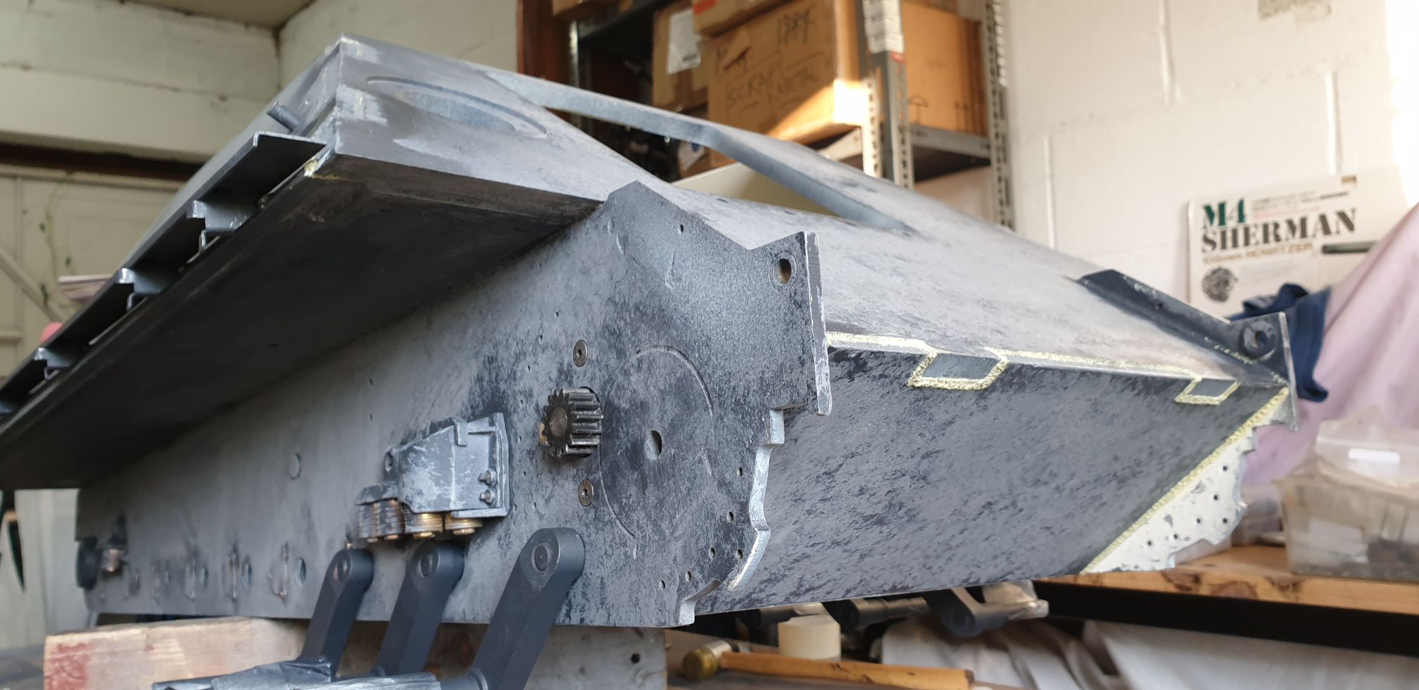

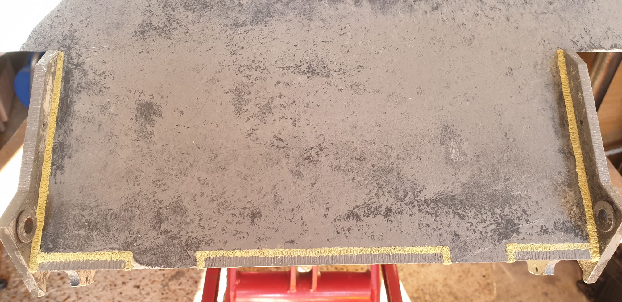

Hi,

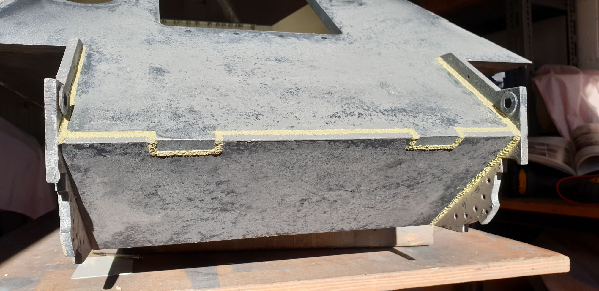

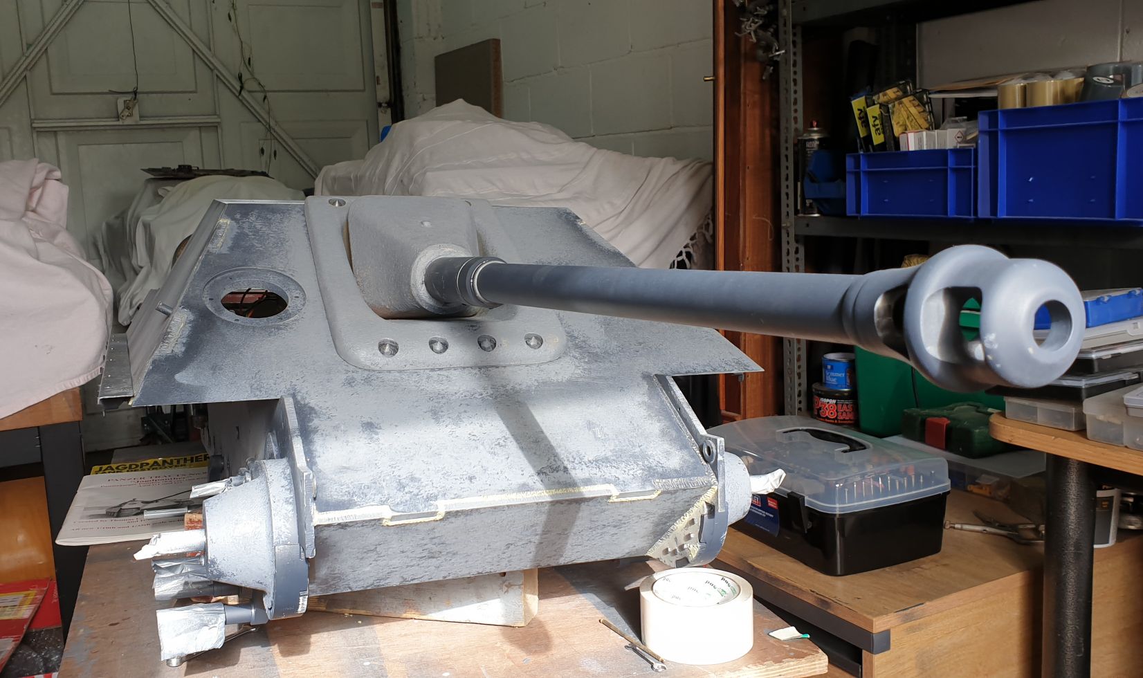

Gear cases attached and gear loctited to bearings, this should prevent the gear contacting with the hull side.
Gear case armor pinned and loctited.
Mantlet secured into position, adjustment required to centre the large securing cone bolts on bottom row. Lifting lug added Cheers

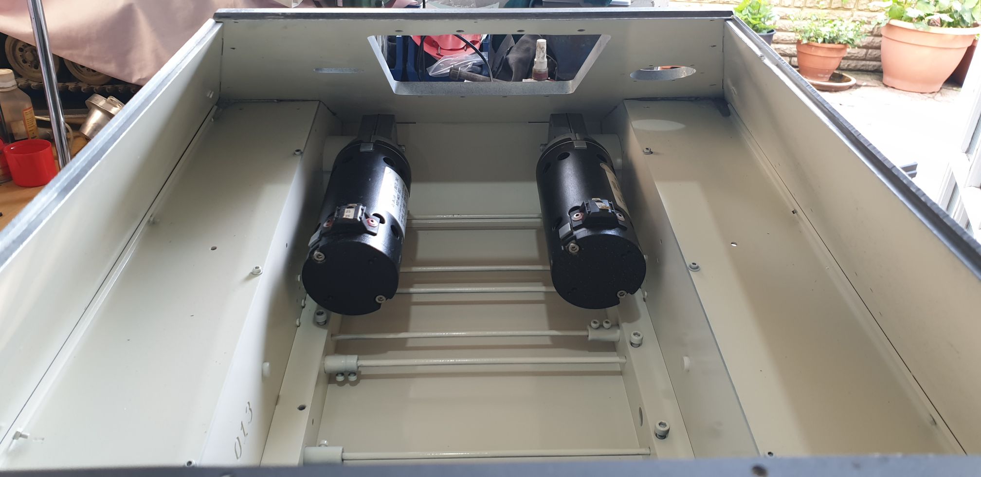

Hi,
Anyone got any experiance with the perfect angle to set the jagdpanther suspension, my model has an angle range from 38 to around 50 already ground
I've had a panther in the past that was set to around 35 degree, this was to low as the tracks hit the underside of the pannier when going over small obstacles
Advice from Mark in 2007
"It also seems that the Panthers tend to be rear end heavy. consideration should be given to setting the front four suspension arms to 35 degs and rear four to 40 degs to overcome this. Final trim can then be adjusted by moving the internal fittings, batteries etc, a little fore or aft."
Thanks Adrian, the model was sitting at what looked the right height when purchased so was going to leave as it was, now all bars are fitted looking at the up down up down angle I'm not so sure.
Front angle 45 to 50 first three
Middle 38 to 45
Rear 45 to 50 last two
Middle 38 to 45
