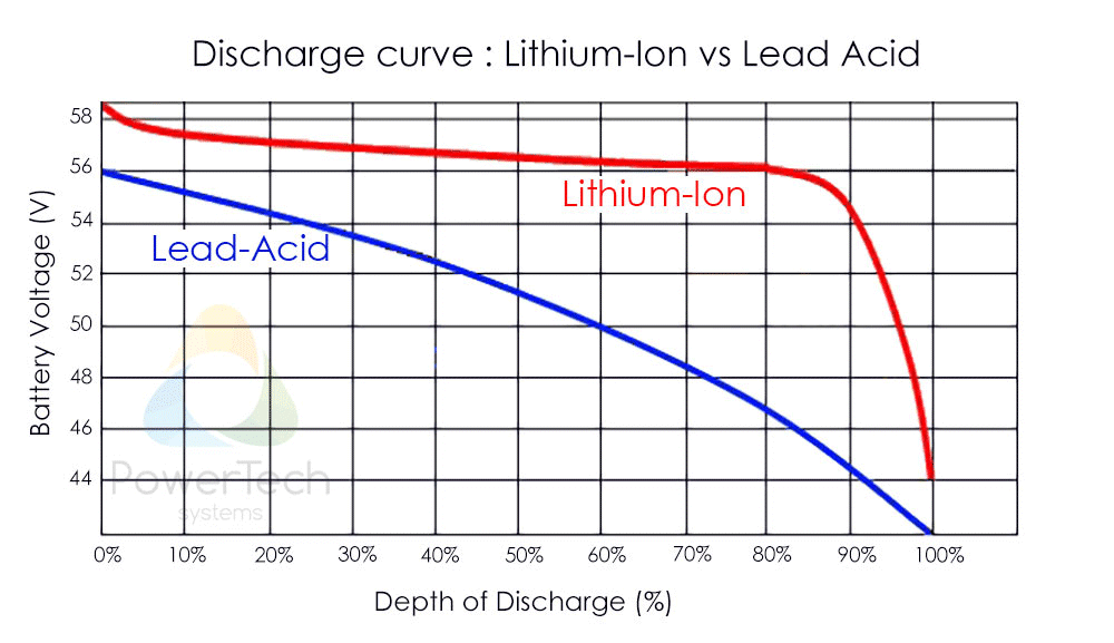

The default answer is two 22Ah 12v lead acid AGM batteries. They are relatively heavy and take up a lot of space. They require maintenance, generally by keeping them at a stable temperature and preferably plugged into a charger providing a maintenance charge. If you don't do that, they will self-discharge at about 4% of capacity a week. They have a relatively short life cycle ie they will probably need replacing in the life of your tank. There are plenty of examples on this Forum of owners having to replace lead acid batteries.
The world is moving away from lead acid into lithium based chemistries. Be very careful here. Not all lithium batteries are suitable. The MUST AVOID is lithium polymer. Suffice to say that in the wrong hands, LiPo batteries can self-destruct with catastrophic results. They should only ever be charged outdoors and with constant supervision. If you want to see what can go wrong:
LiPo is old hat anyway. The safe chemistry for our models is Lithium Iron Phosphate (LiFePO4). Most of these come with a Battery Management System (BMS) built in. The BMS will prevent over-charging and over-discharging and will also trip a thermal cut-out if the battery is approaching an unsafe temperature. Compared with lead acid, they are more expensive but last twice as long. They are much smaller and lighter and don't require continuous maintenance. They can be stored for long periods as long as they are not fully charged.
If you're looking at the economics over the life of the battery, LiFePO4 wins. It costs more upfront but lasts longer. If you don't intend to use the tank much, lead acid is probably the better economic choice.
Some may argue that extra weight is a good thing for our tank models in that it makes them more realistic. I don't buy that argument. It only means the battery expires more quickly.
When Lithium Iron Phosphate first came out, I believe there was a concern that the regenerative power system in the Armortek motion pack might cause problems with exceeding the maximum charge rate but as long as the LiFePO4 battery has a BMS, this can be discounted. The one remaining issue is the concern that some may think all lithium batteries are the same. They are not. To be clear, for safe use, only an LiFePO4 battery with integral BMS should be considered.
There is one crucial operational difference between lead acid and lithium iron polymer. They have very different discharge curves. In simple terms, lead acid will start to fade quite early and will gradually run out of steam until you can run no more. So you only get full power in the early part of a running period. Lithium Iron Phosphate has a "cliff-edge" discharge curve. The battery will continue to deliver nearly its full voltage until it suddenly doesn't:
The BMS will shut the battery down as it approaches its minimum discharge voltage and the tank won't run no more. This point however is reached much later in the discharge cycle than with lead acid. By a large margin. This is a crucial performance advantage of lithium iron phosphate. It's simplicity itself to fit a voltage monitor in the motion pack circuit.
To illustrate this advantage, I've run my Centurion pretty hard over four days of TankFest without the need for any charging. The battery still had lots of life left to get the tank home. I've only had one occurrence of the BMS shutting down the tank. It was at the end of a long day of running in very hot temperatures and I was attempting to turn sharply on longish grass. The tank simply stopped. I checked the battery temperature and it was within limits. I let the tank cool for 15 mins and the BMS was reset without fuss.
The other advantage of Lithium Iron Phosphate is size. They take up considerably less room than lead acid and therefore allow you a lot more freedom in where you put them. In my Cent, the battery sits in the driver's cab, leaving the rest of the hull free. This freedom also helps with getting the centre of gravity right.

the life time prognosis was made by the manufacturer, not by me. My shown CALB batteries (40 Ah) are three years old. This type will be used in manned aircrafts (CALB = China Aircraft Lithium Battery) and has the necessary specifications.
A BMS is helpful but not necessary to avoid overcharging when used in tank models, because LiFes can endure much higher currents than lead acids. I use battery sets with and without BMS. With BMS it may be charged and discharged like a lead acid battery (including lead acid charging device), but is more expensive and has a little lack of capacity. When the set is at its end of capacity, the BMS will shut down it immediately, and your tank will stop in the field without warning.
Without BMS you have to monitor the set permanently and automatically while being discharged (e.g. via telemetry, which makes my RC equipment). So I can see (and hear warning levels) at any time if my tank must be returned to its base in a few minutes. You need a charging device with balancer which is more expensive than a lead acid charger, but becomes economic when using more sets of LiFes without BMS in your tanks. LiFes are chargeable with much higher current than lead acids; some cell types up to 4 C, what means that a cell of 40 Ah can be charged up to 160 A in less than 20 minutes, if your charger is able to do that! The shown cells can be charged with 40 amps in about an hour, perhaps in the lunch hour of a prolonged mission. My charger has 2 channels with up to 40 amps output each.
