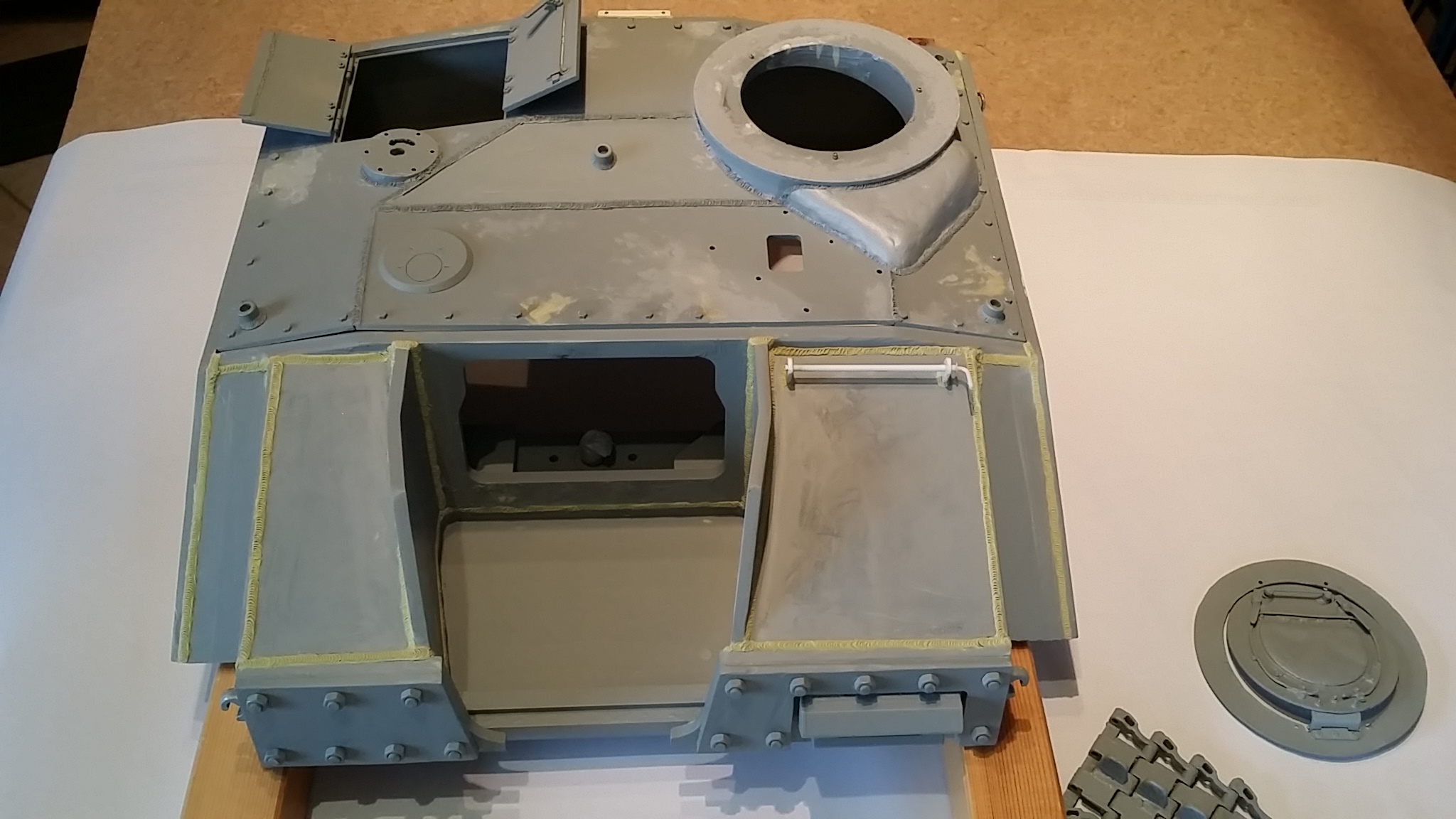

Before the new StuG III comes onto the market, I would like to introduce you to my Sturmgeschütz III from 2013. Perhaps one or the other will feel like doing a StuG III.
I was able to acquire the StuG in December 2018 through an exchange deal, and it arrived shortly before Christmas.
It was already assembled and painted. Motors, controls, etc. were not yet installed, but were included.
At the beginning of January 2019, I started dismantling the vehicle and then stripped the paint from the components.
Then the new building started. Unfortunately, I did not take a lot of photos in the individual construction phases.
For the detailing (which is very important to me) I used some components from Armorpax. Thank you Dave for your beautiful components!
Regards Michael
Here are a few pictures of the start of my construction:
Regards Michael

Re: StuG III (no. 24/2013)
Nice to see you are (re-)building a StuG, the progress already looks very nice.
Was the gunmount from Armorpax as well or did you make it yourself?
Have you decided on the colour scheme already?
Hello!
Thank you for the kind words!
@Roy: The gunmount on the roof and the connection plate is selfmade (3D print).
I designed some parts in CAD and then printed them. For this I will add pictures.
Because of the colour scheme, I'm already thinking about it. Possibly a colour scheme like that used in Normandy. It will depend on my painting skills.

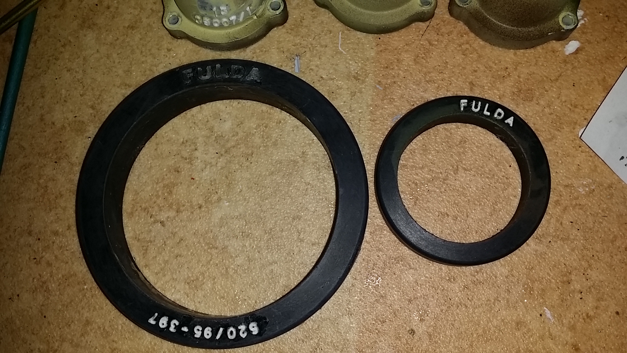

It goes on:
Next I want to show you how I worked on my sprockets. I found some inspiration for this here in the forum.
I processed the surfaces with the dreml, installed screws and added lettering.
The last picture shows test lettering for the wheel rubbers.
Hi Michael, very nice work. How did you make the lettering on the sprocket and on the tires?
Kind regards,
Roy
Roy
- Posts: 136
- Location: GERMANY
- Has liked: 79 times
- Been liked: 113 times
Hello Roy!
For the lettering, I used 2 mm and 3 mm plastic letters from the model building trade. Since these letters are very expensive in my opinion, I printed the letters and numbers for the other components myself with the 3D printer. The lettering on the wheel rubbers shown here was only a test. I then did the lettering of the wheel rubbers on the model with various tire manufacturers. More pictures will follow.
I glued the lettering onto the components.

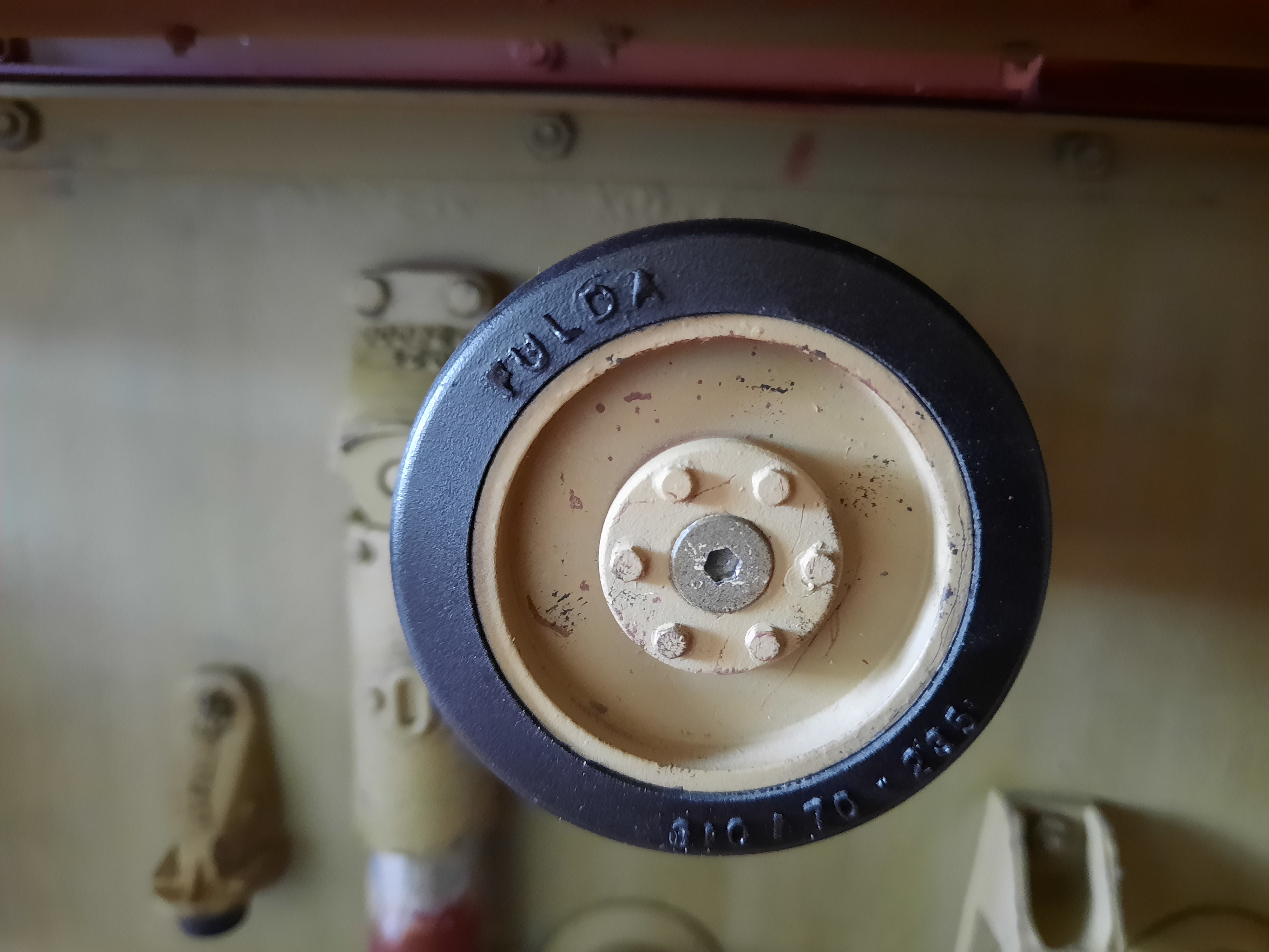

Hello!
Here are some more photos of my DIY-lettering.
The weathering of the wheels is not yet complete.
I have also attached a picture of the finished sprocket.
Thank you for the "likes".

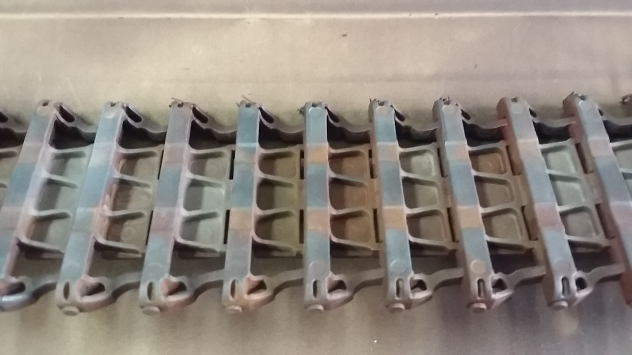

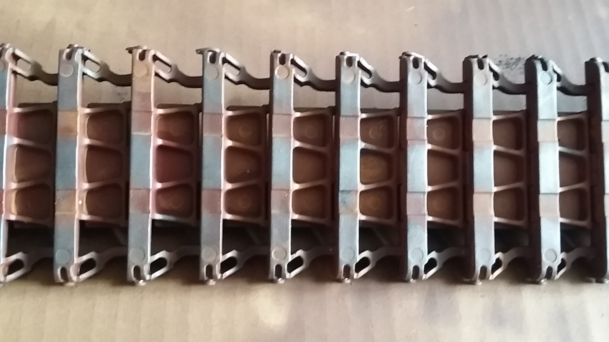

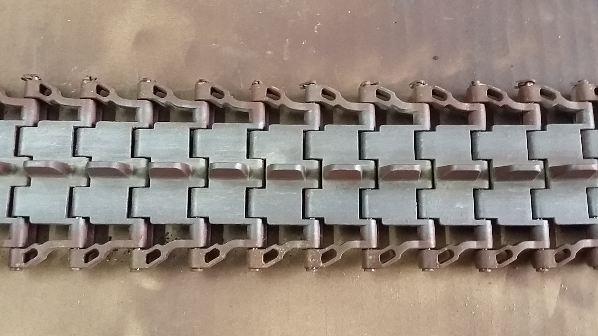

Hello!
I have now dealt with the chains and pimped them up a little in color. Even if the paintwork is damaged or changed again by driving. But I can look forward to it during the construction period.
