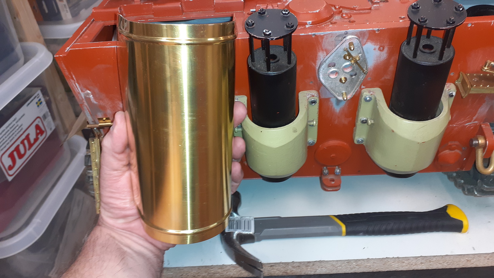

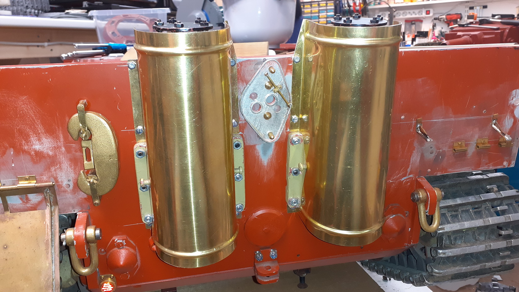

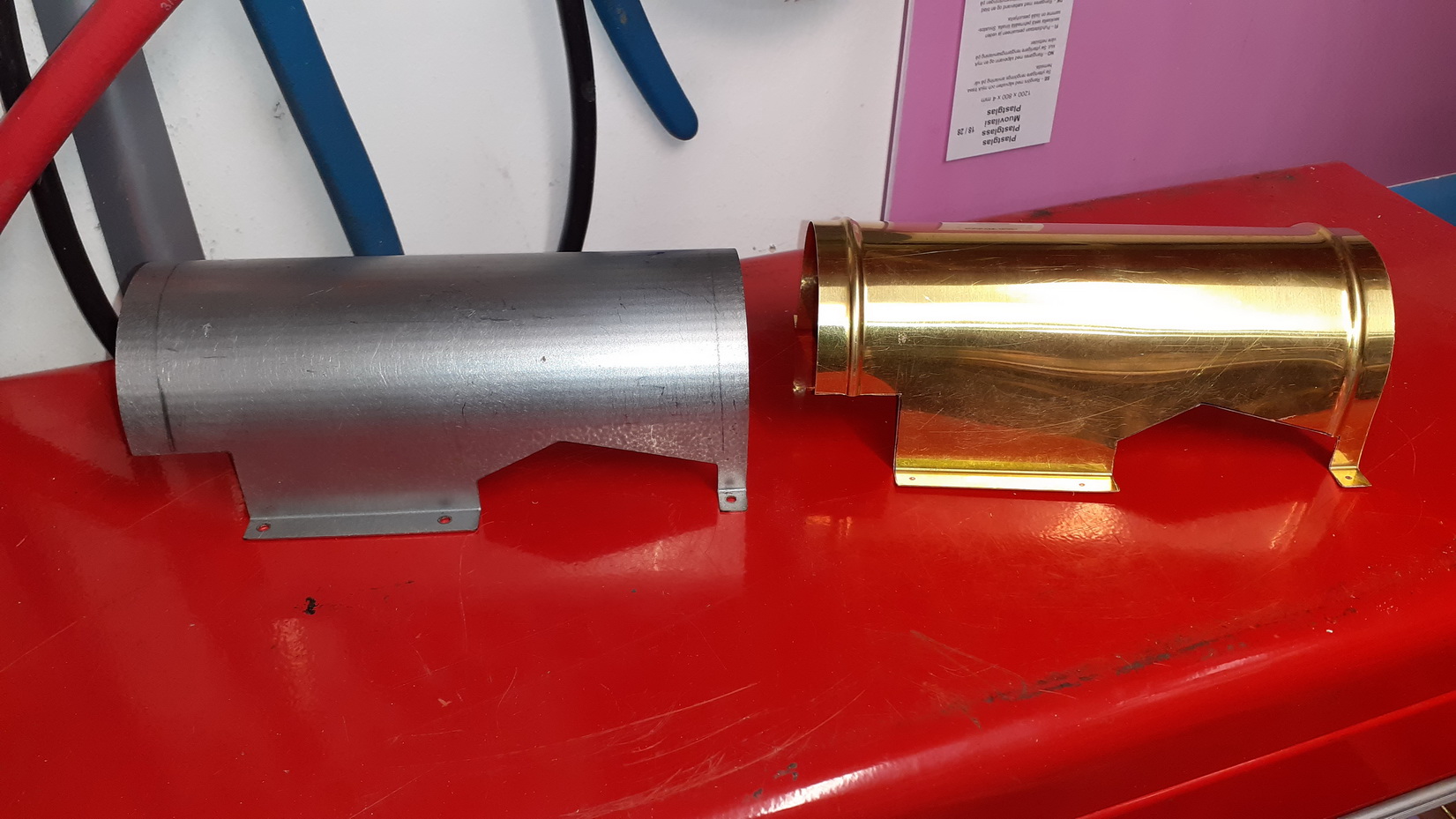

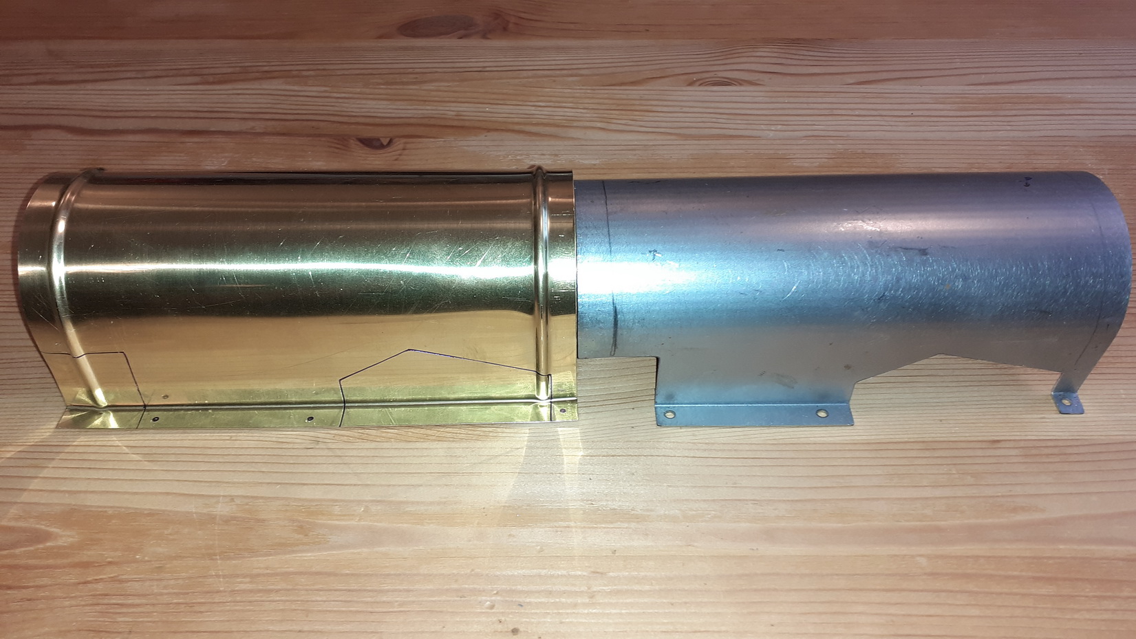

Started to press brass plates, to new heat shields for my Tiger One.
Hope it's ends well. :lol:
Robert

Never a good sign when the closest tool to the model is a hammer :lol: :lol:
The heat shields look good. Did you use a swaging wheel or a press ?

The hammer is for when I have things that not fit as I want. :lol: :lol: :lol:
I use a press.

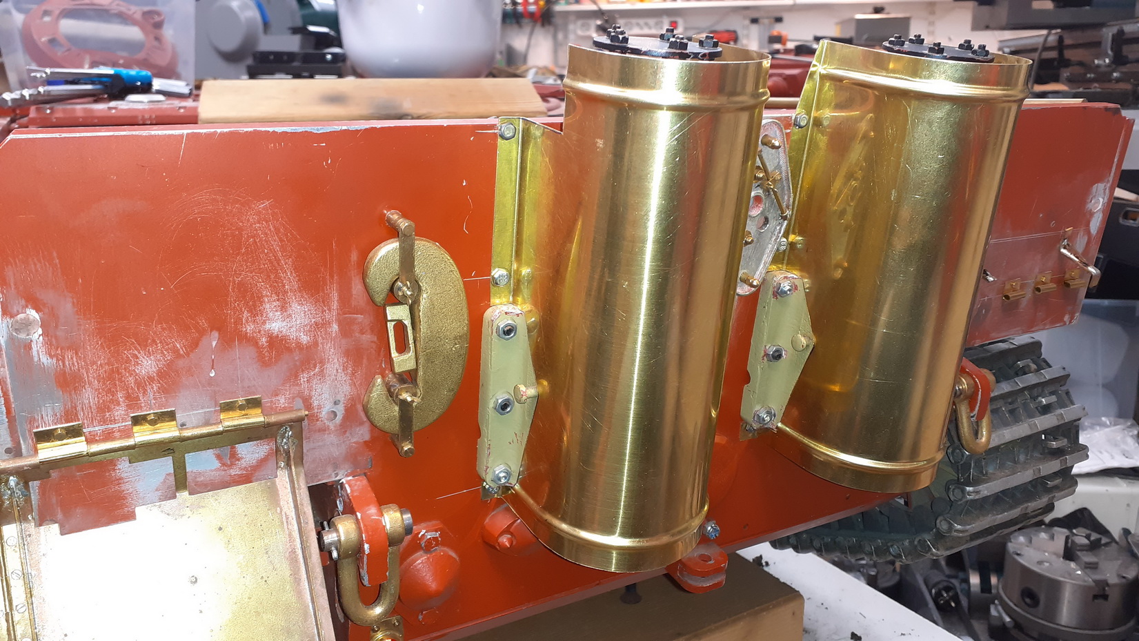

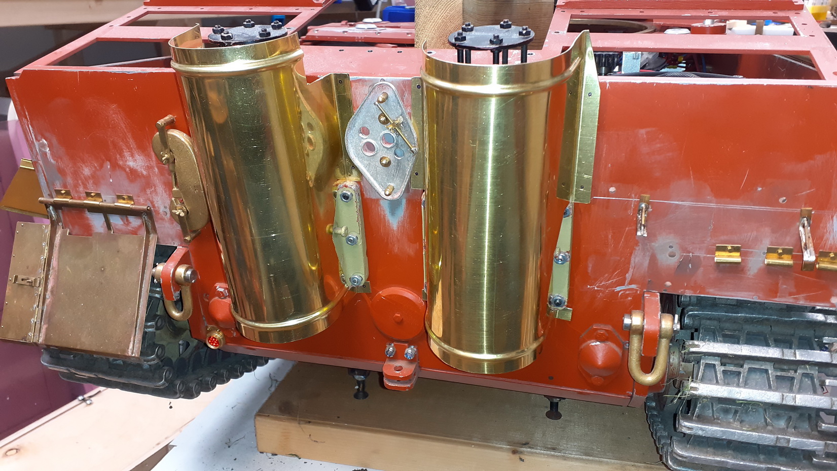

Hello

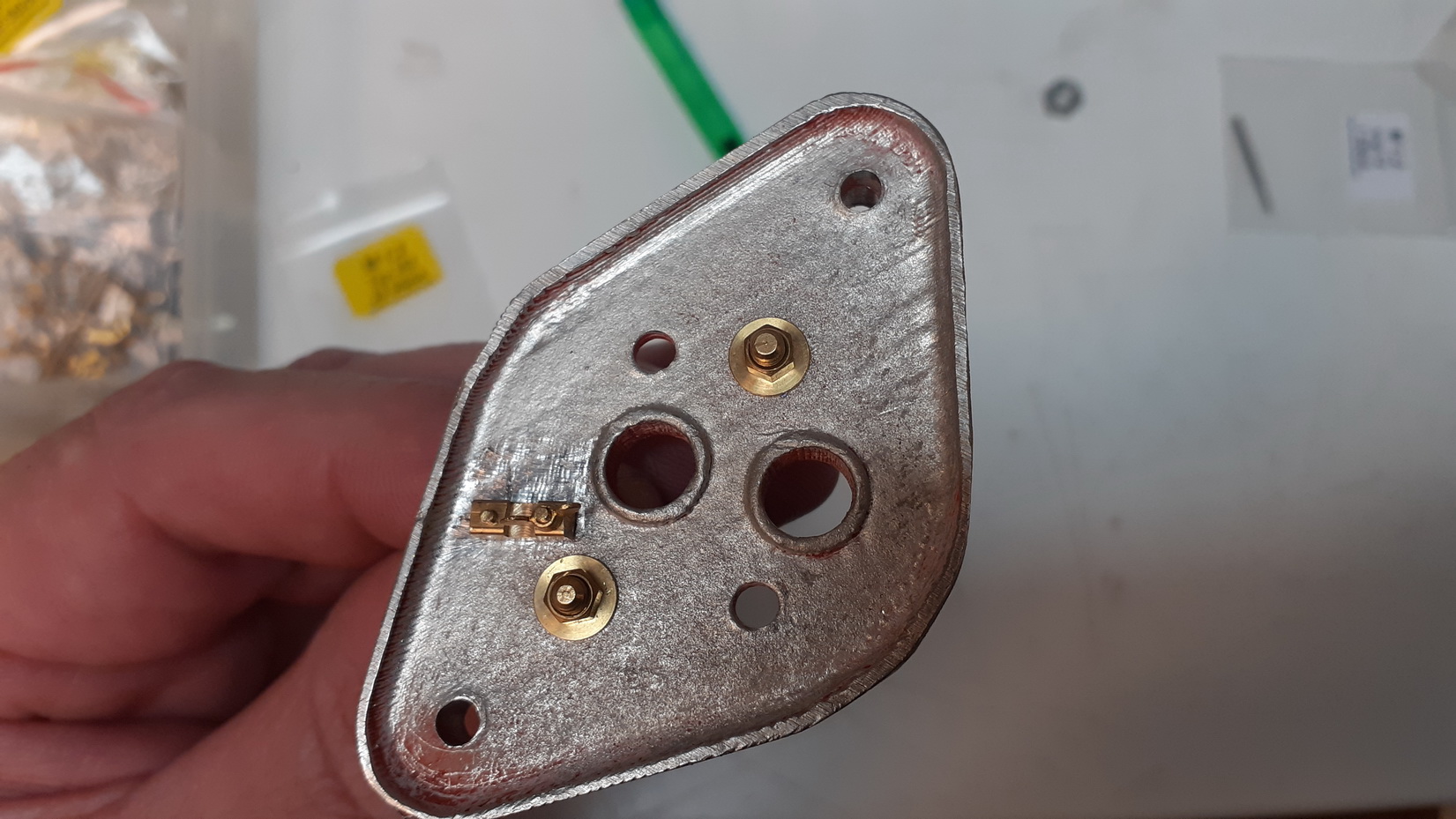

I was not 100% happy with the first I did.
So try, try again. Made these with 0,5mm Brass.
I did use a hydraulic press to do them.
Now it will be cut and shaped according to the original, and put in place.
Stay safe and have a nice day.
Robert

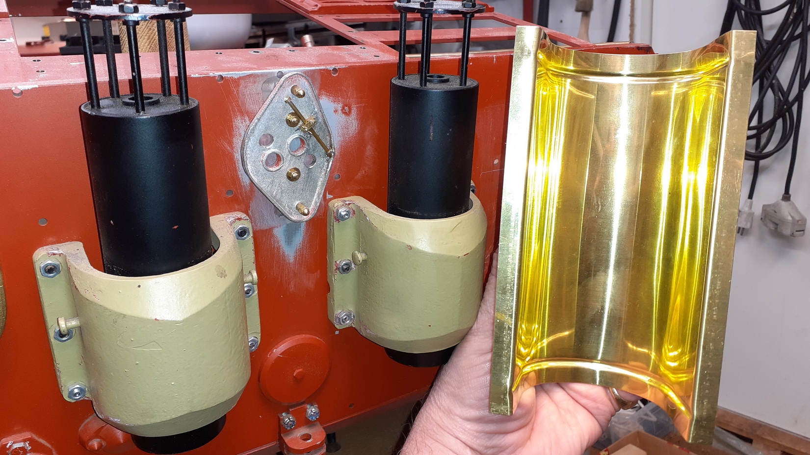

Post by Robert Tanzer »

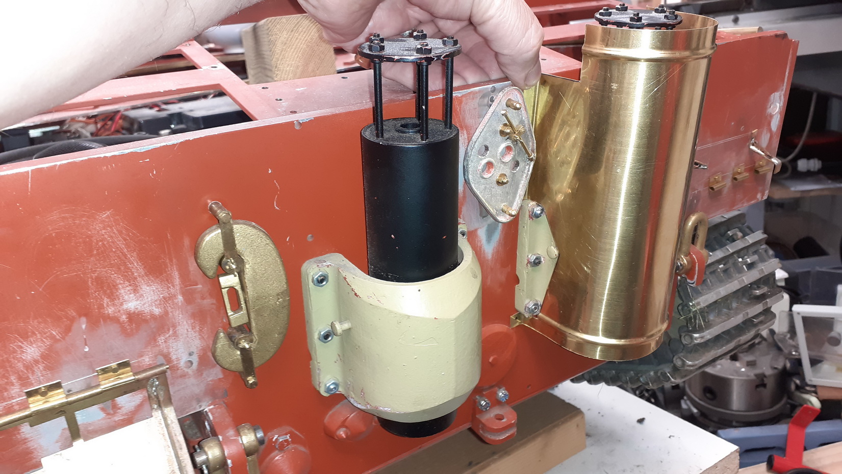

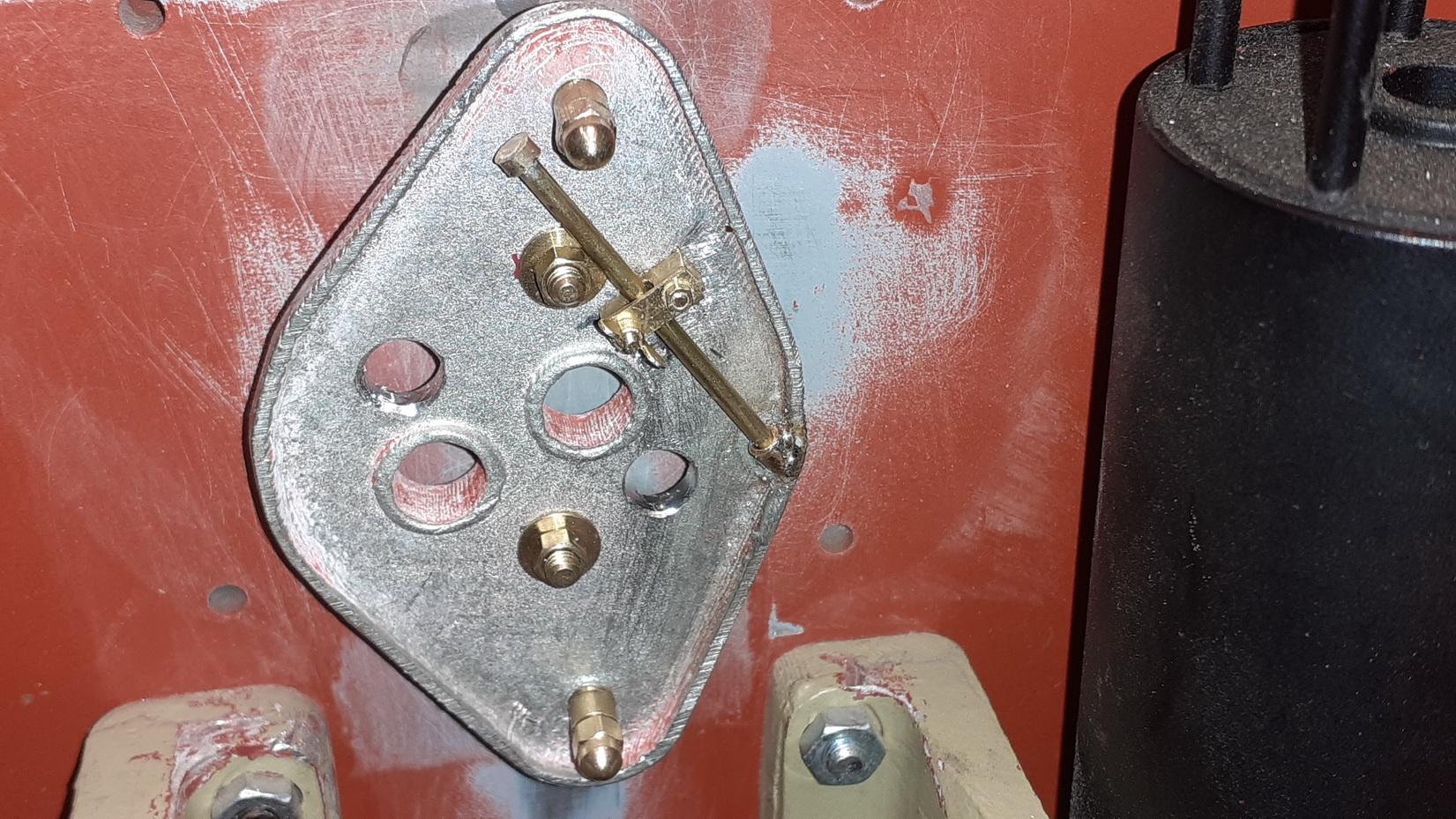

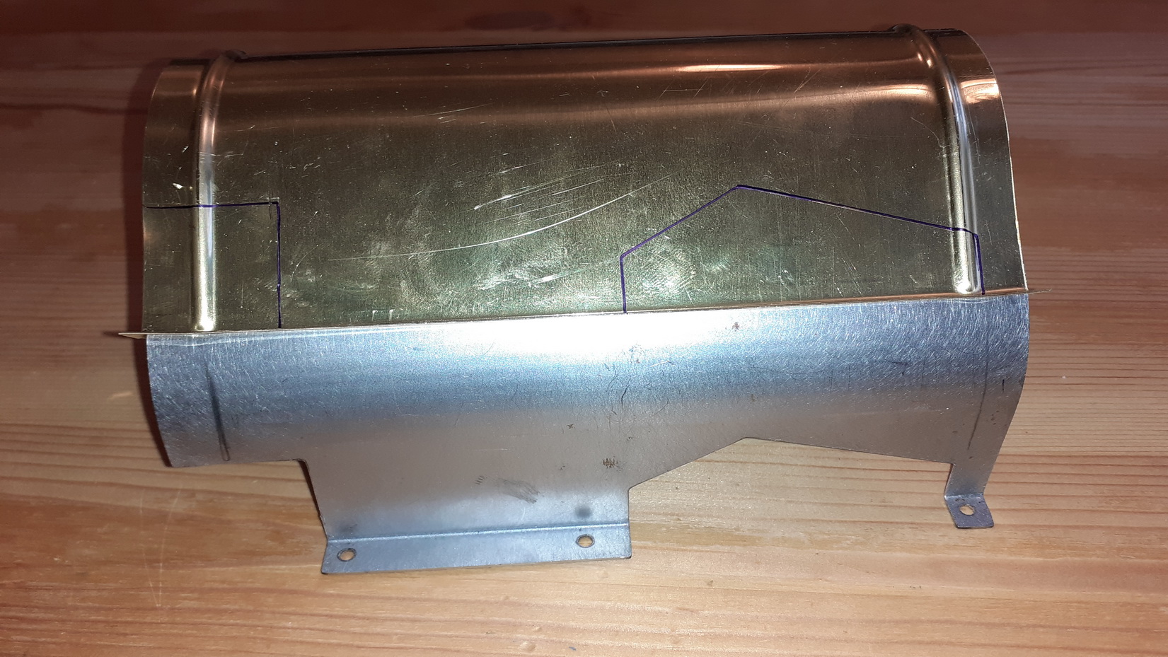

A bit more today, take it slow and nice.
I really want it to be nice pieces. Lot more to do.
Lots of grinding to do.
But I will get there. 😉
Dont forget: Stay safe.
Robert
Re: RT Late Tiger One
A tricky little job that Robert, looks well done from here, regards simon manning.

Thank you Simon, I had to think more then twice.
Before I started with these parts.

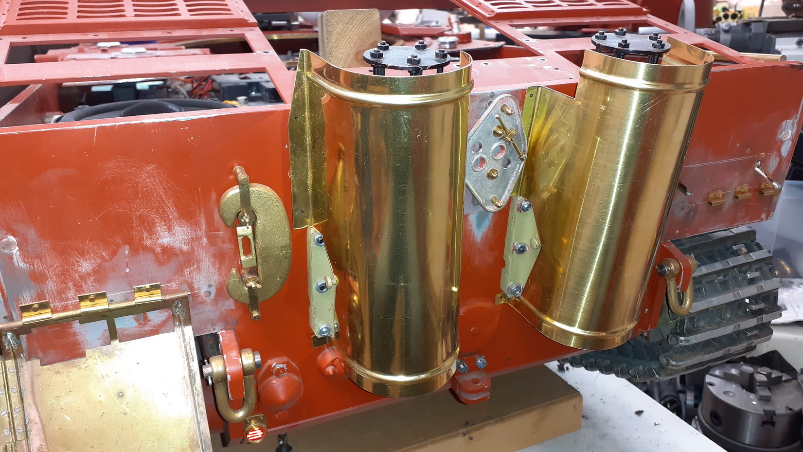

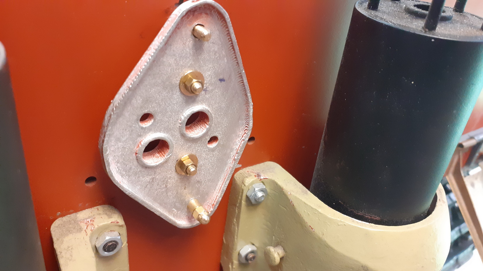

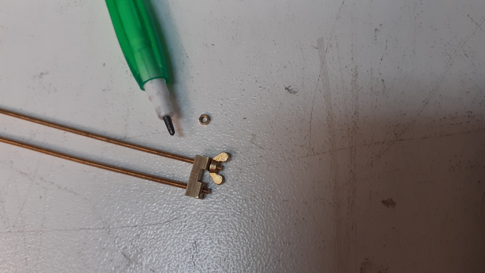

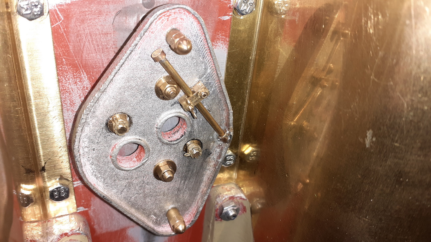

I had a nice weekend in my cave.
Some more work on the exhaust shields, abit more to do. Grind, grind and grind.
Next I will do the square washers to the bolts.
But we have a very nice hobby and understanding wives. :D
Have a nice day and stay safe.
Robert
Post by Christoffer Ahlfors »
Perfect fit - what a beauty! :D

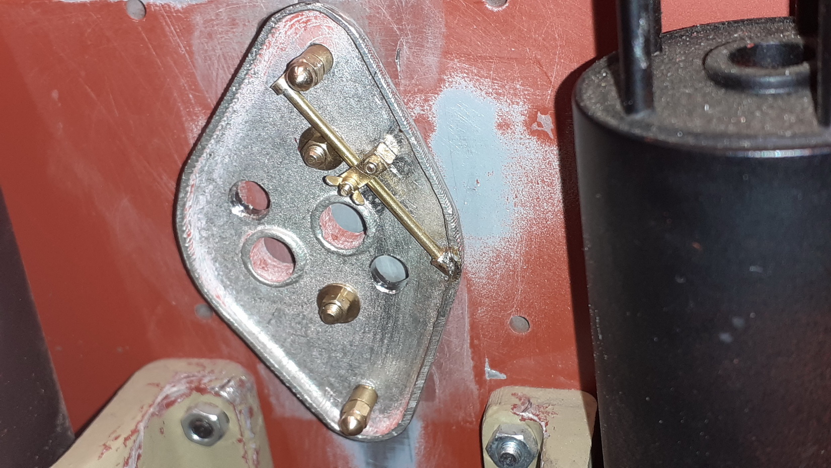

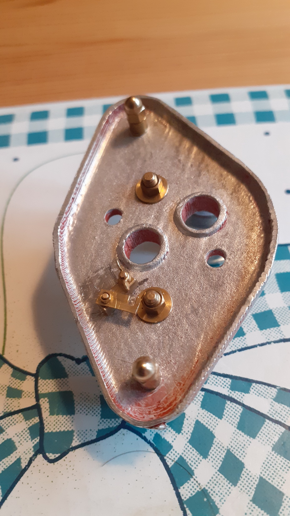

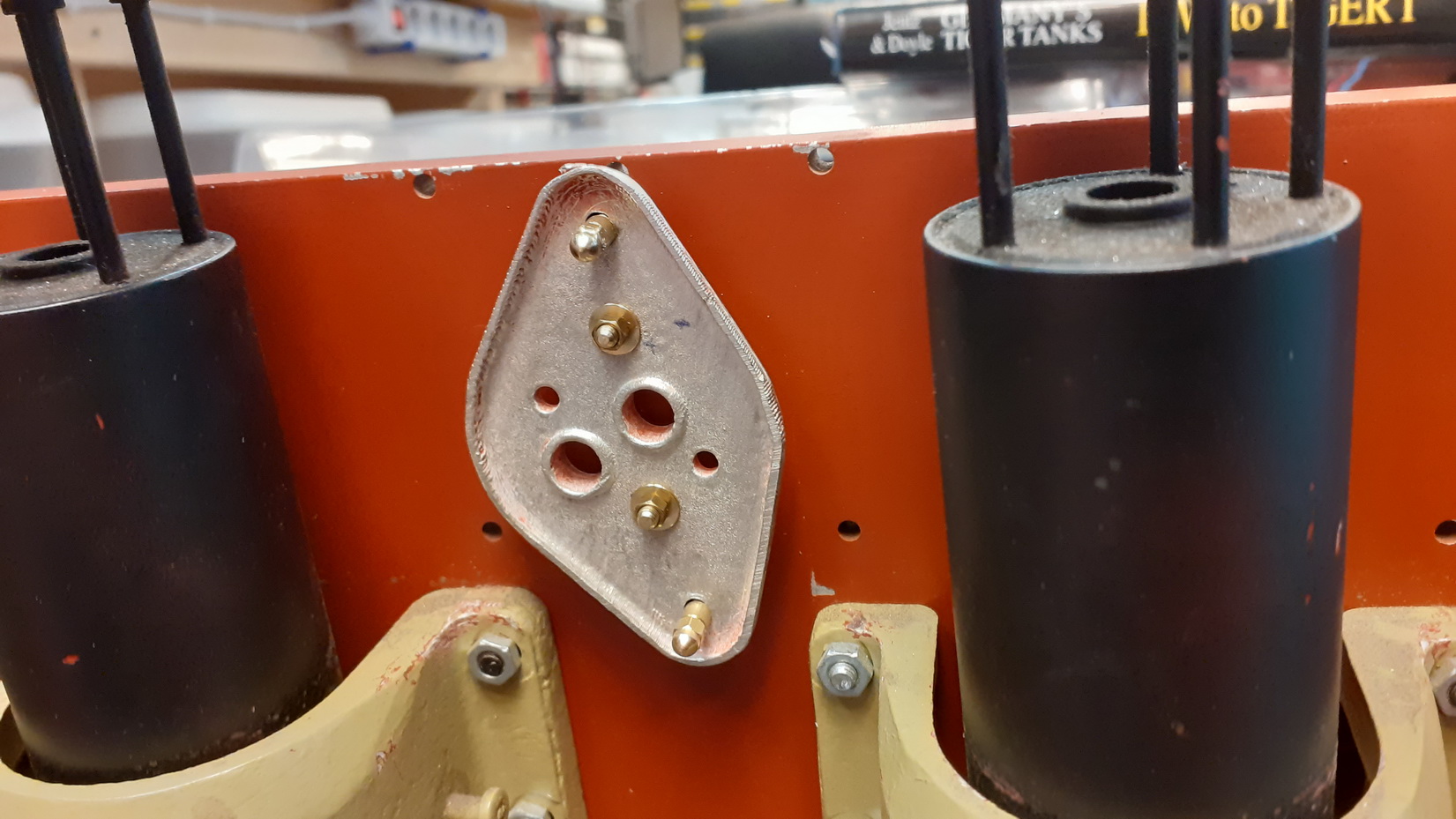

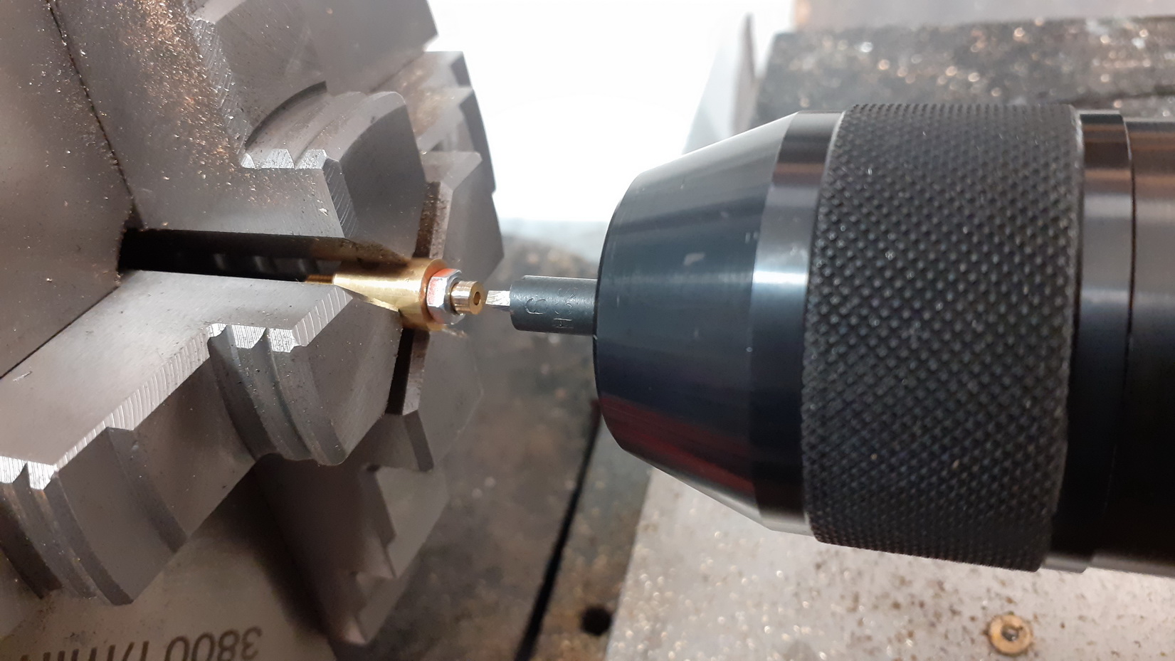

First time for everything,

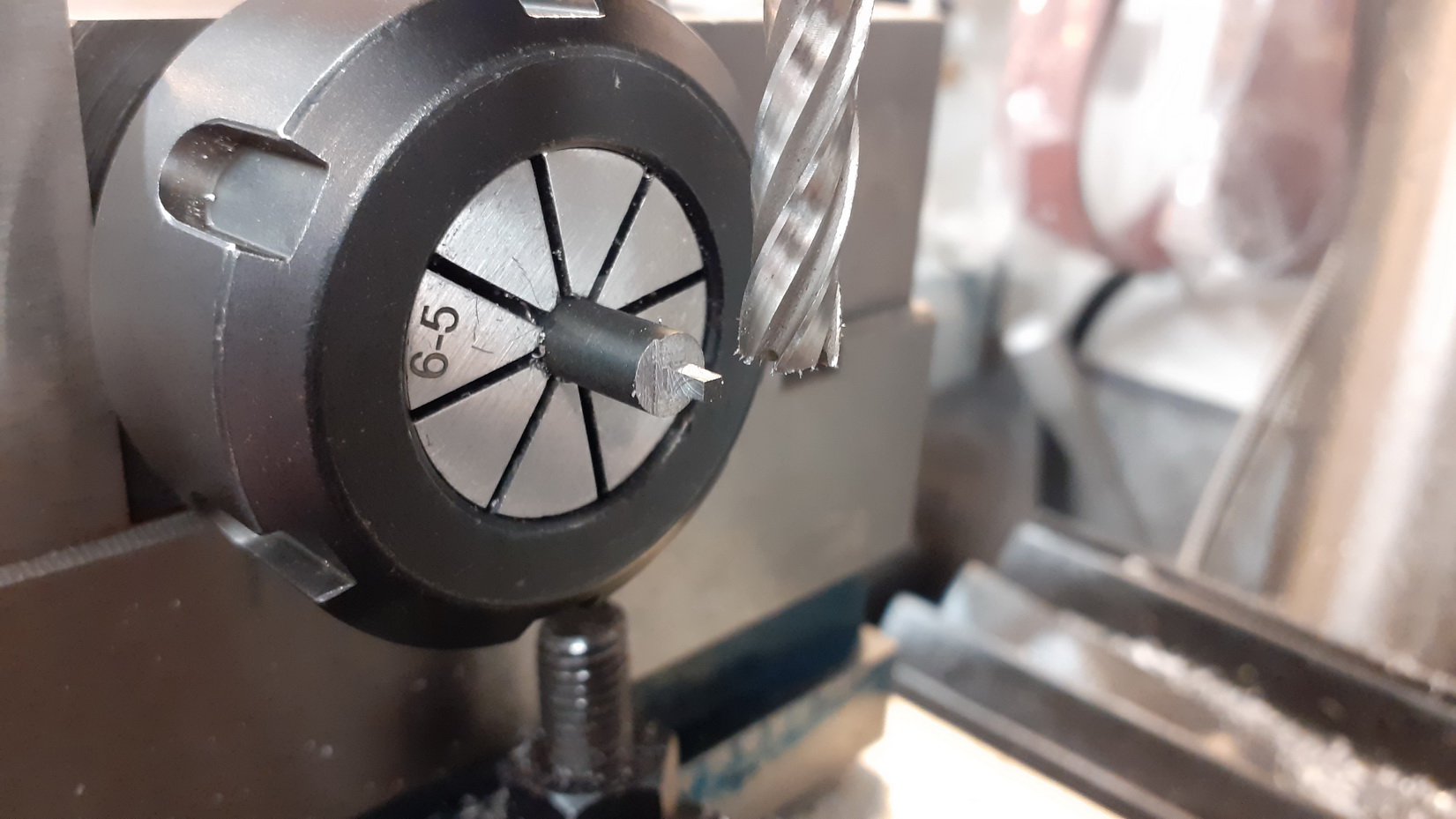

I try to make square holes on bolt heads to my enginedeck.
Glad to have learned something new today. :D
Robert

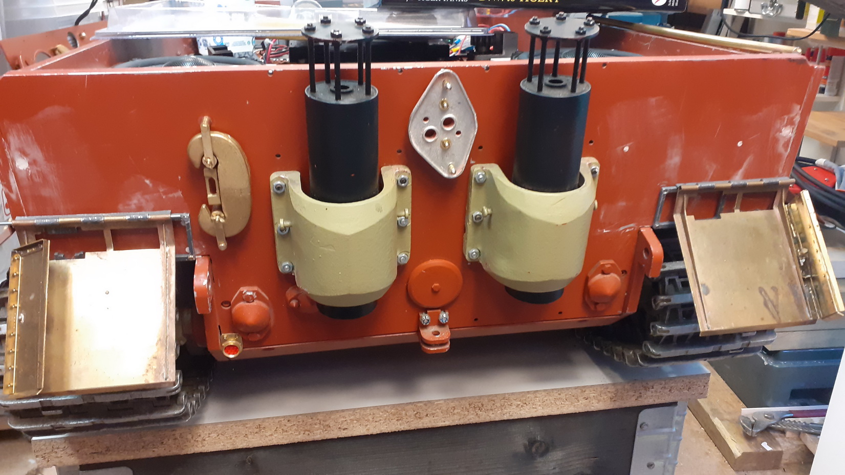

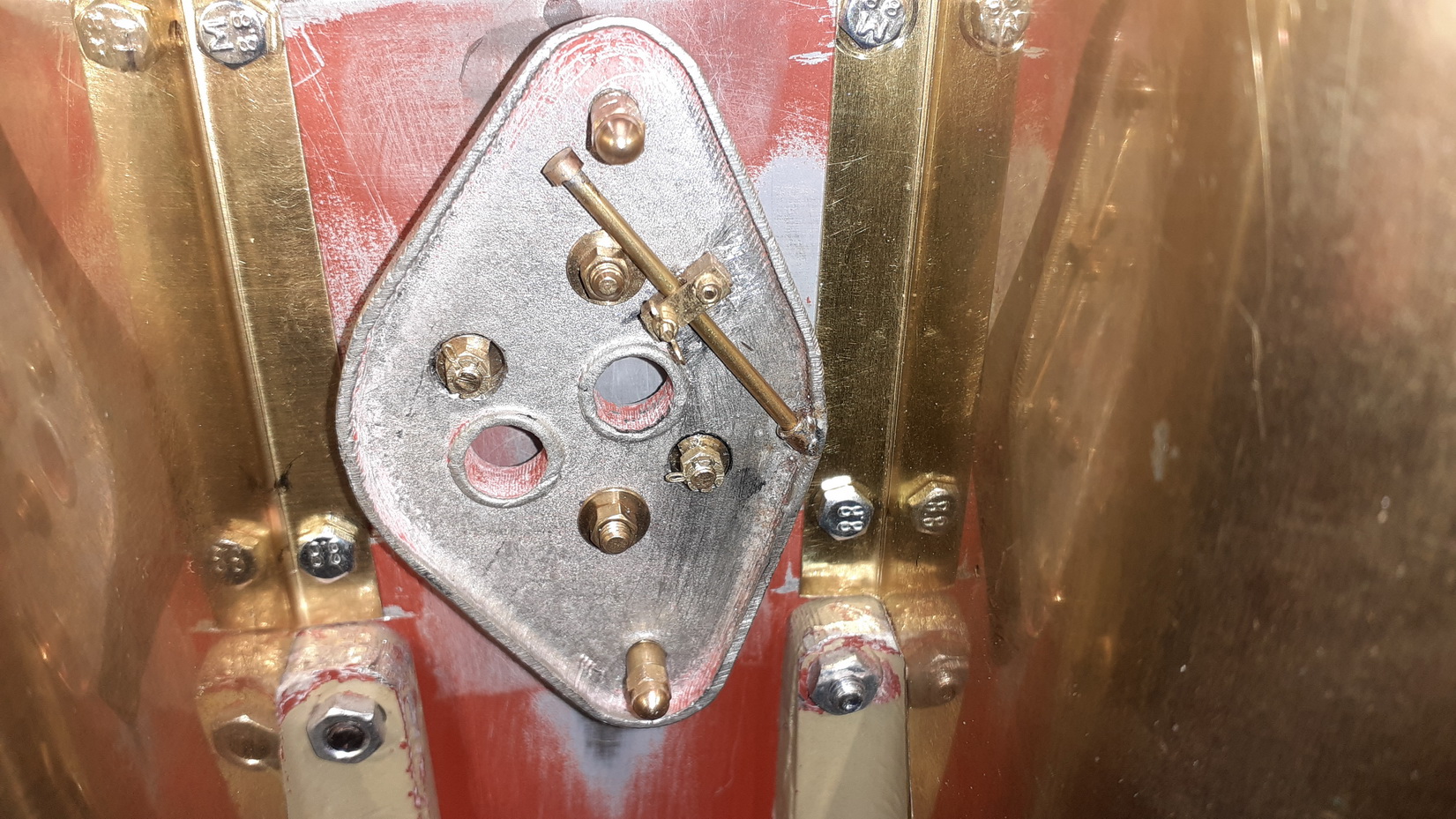

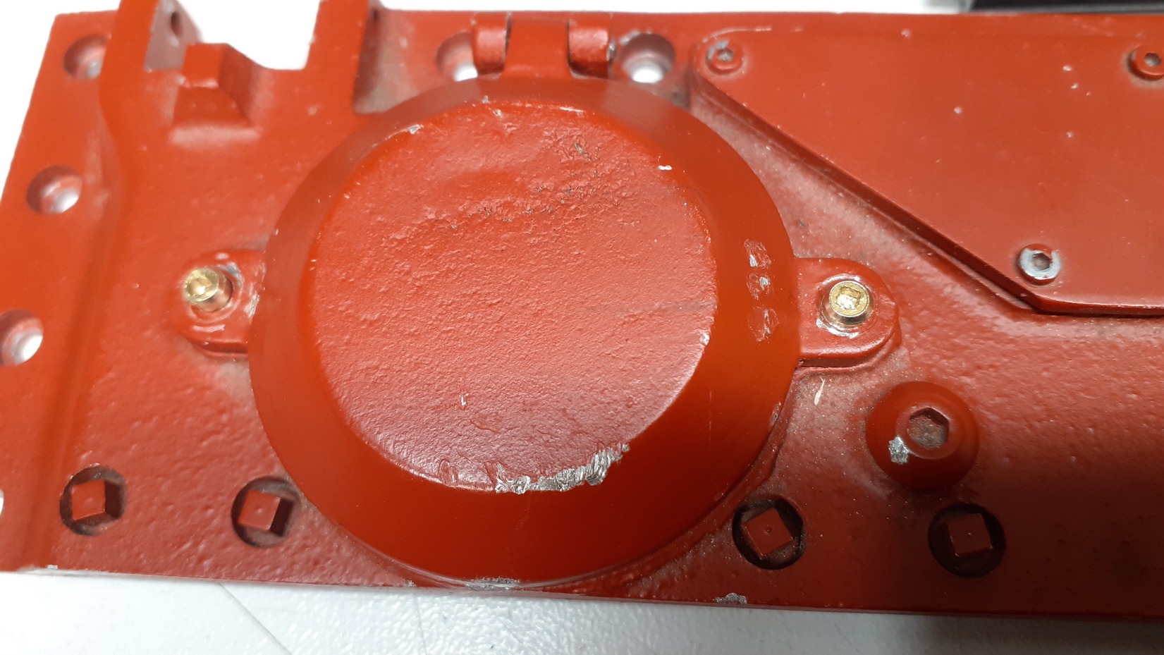

I am finally done with the starting block on my Armortek Tiger One late.
Had to redo a bit, made some mistakes first.
I've said it before, brass is a wonderful material.
Robert
Posts: 2349
Looking Good Robert. Your heat shields are excellent! Nice work.

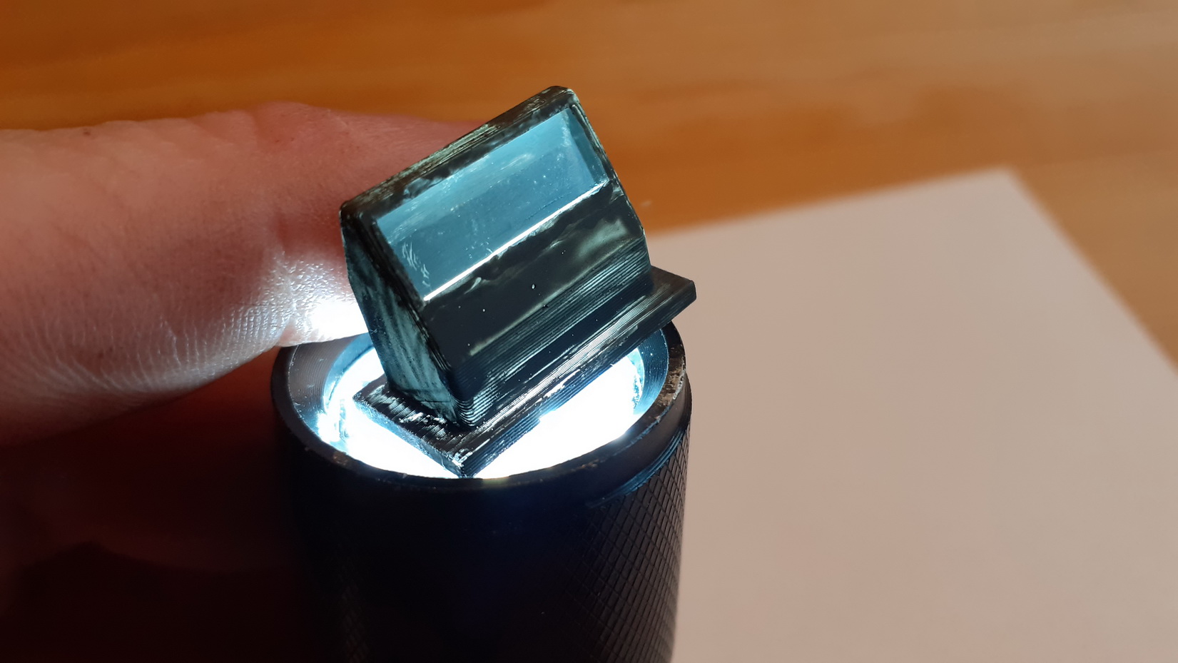

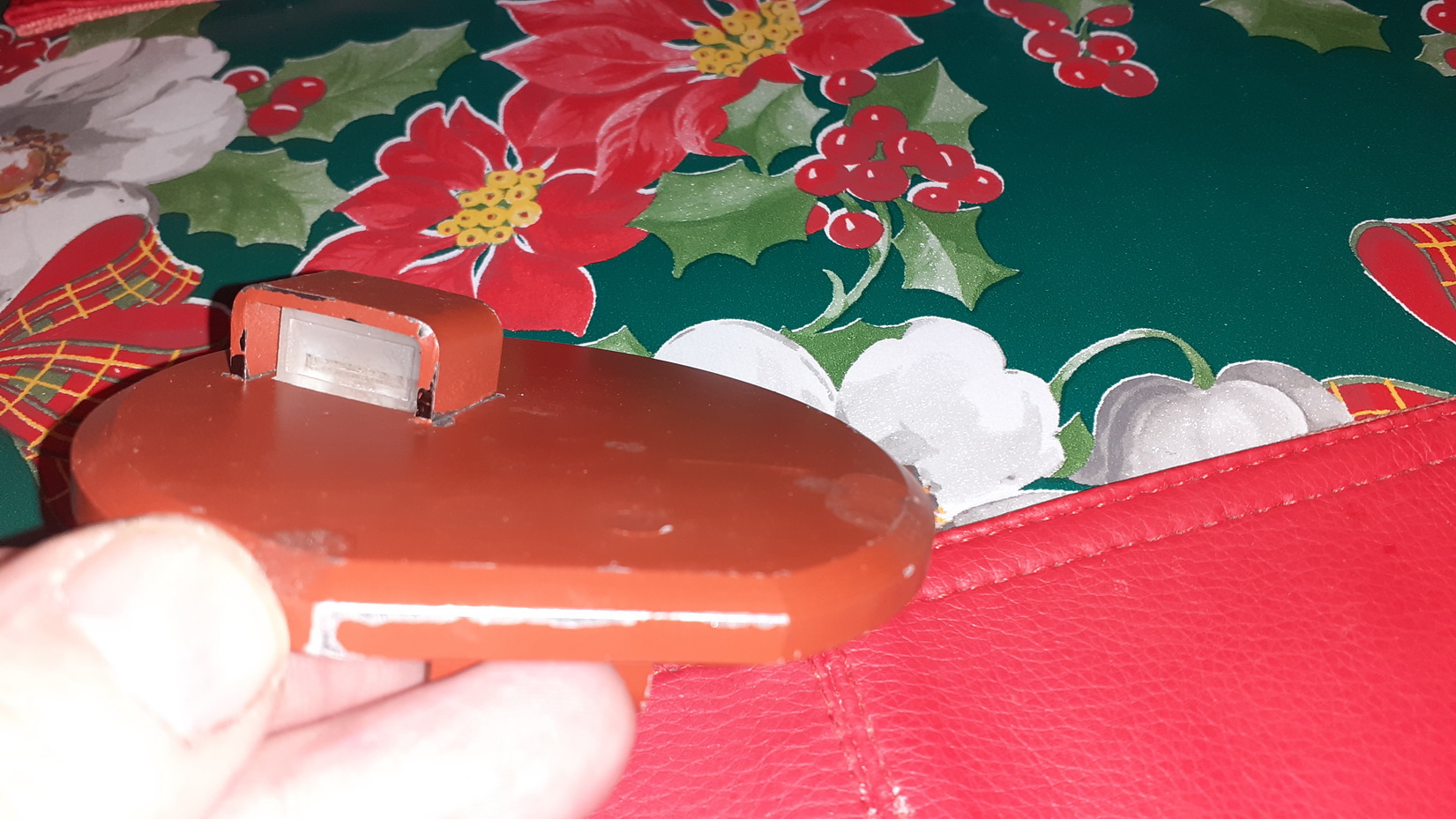

Got an idea that I wanted to try with my resin printer today.
Became pretty good, but have only put on a layer of German Panzer Grau yet.
