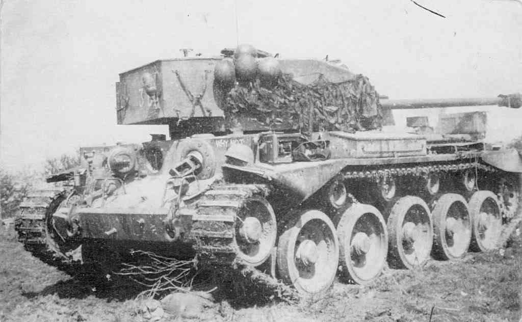

So far I have found 2 pictures off the comet that I believe is Why worry.
Not having much more to go from leafs me a bit of artistic freedom, and a lot off questions.

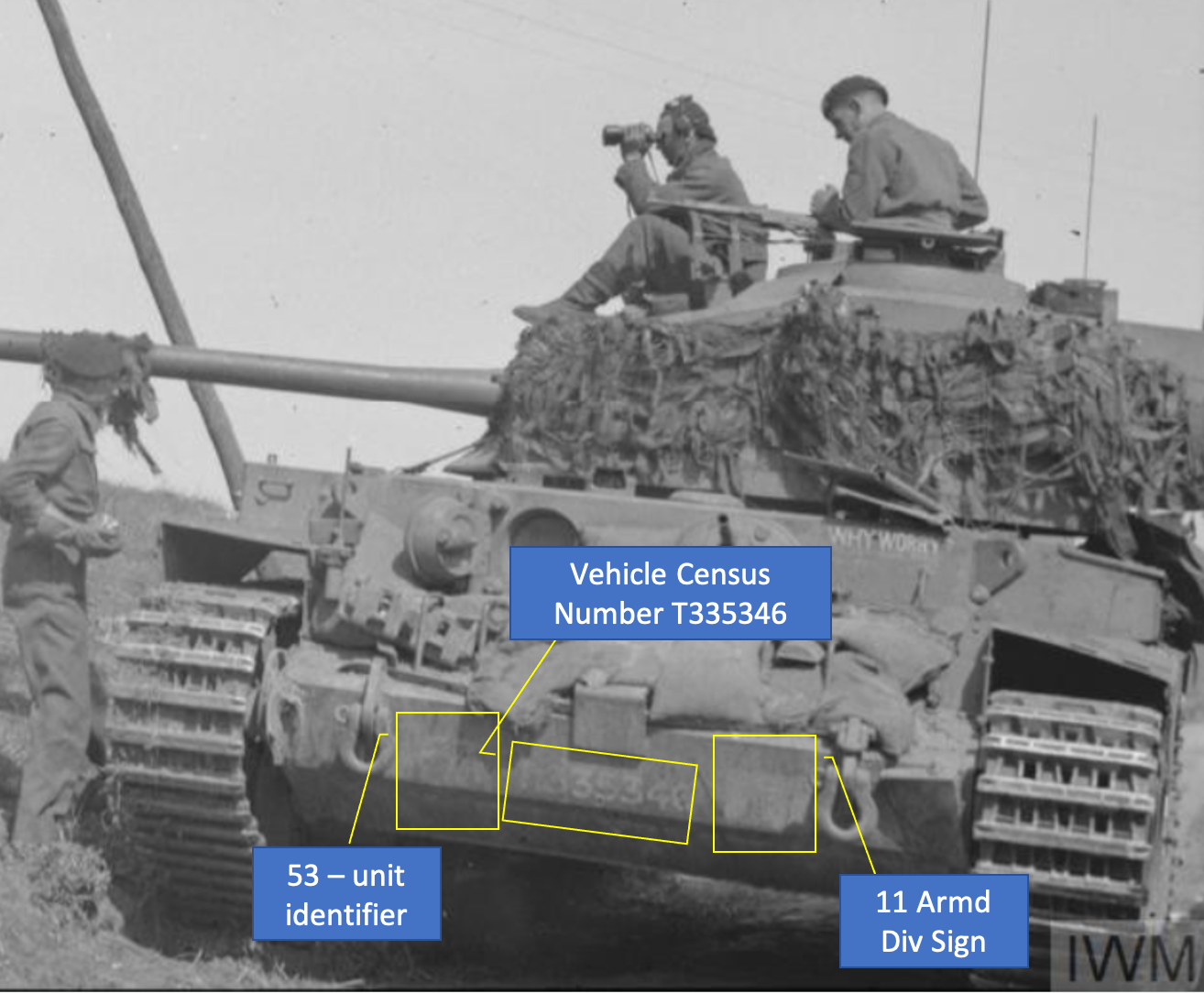

"Why Worry" is a great choice. I'll see if I can find any more photos but the two you've found are the most well known. I can add some detail about the tank. It served with 3rd Troop, B Squadron, 2nd Fife and Forfar Yeomanry, in 29th Armoured Brigade, 11 Armoured Division. The other tanks in the Troop were probably named "Why Hurray" and "Why Not". Why Worry carried the Army Census Number T335346, which would have been painted on the toe plate of the front hull and on the rear (3 1/2inch white letters on a black background).
This photo shows Why Not. On the rear of the turret bustle, the callsign is painted ("3?"), the second letter/digit looks as though it's C. The tac sign for B Sqn was a 12inch square in red but if it were painted on, it's obscured by the camouflage net. The census number can just be seen on the toe plate.

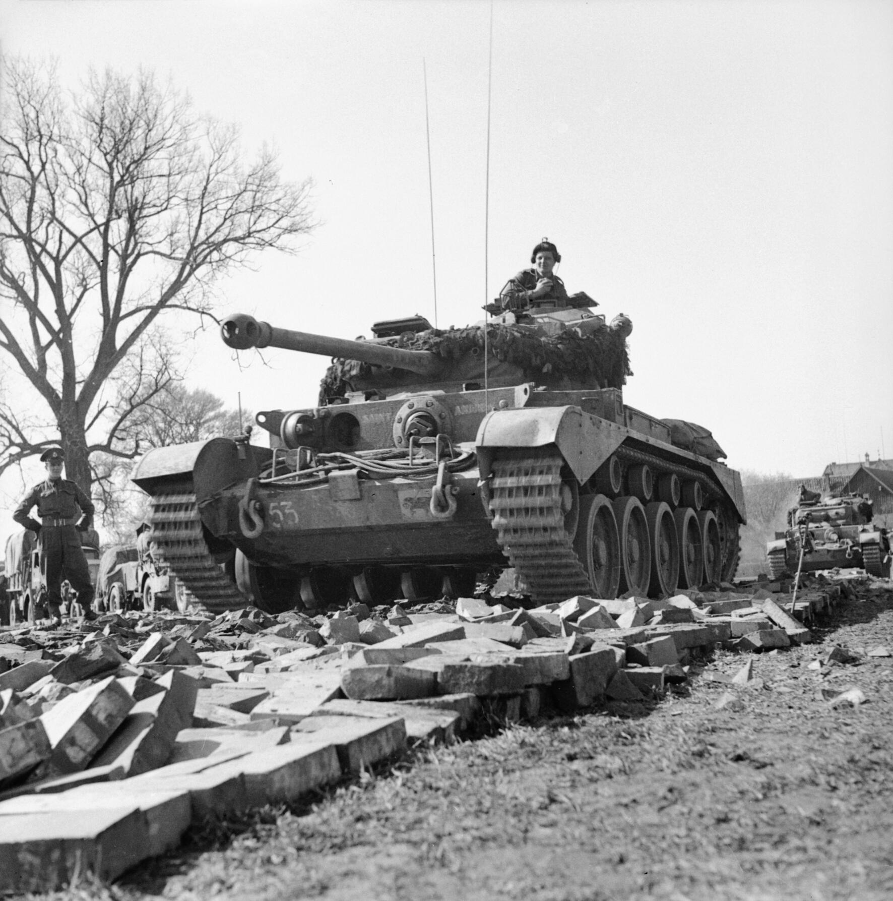

This photo shows a Fife and Forfar Yeomanry tank at Petershagen on 7th Apr, 1945. It carries the Raging Bull Divisional sign and the regimental indicator 53.
Comet_tanks_of_the_2nd_Fife_and_Forfar_Yeomanry,_11th_Armoured_Division,_crossing_the_Weser_at_Petershagen,_Germany,_7_April_1945._BU3200.jpg
On the IWM picture you posted, you can see the Census number, Unit Identifier and Divisional Sign on the toe plate. The Unit Identifier in the Fife and Forfars looks as though it was crudely hand painted.

Interesting to see that "why worry" has the late type idler and "why not" the earlier type.
Also having trouble making out if it is fitted with normandie call's. It wouldn't be fitted with the fish tails yet.
Would the "3C" on the back of "why not"mean that "why worry"would have the same?
Thank you very much again.

No Tim, each tank in the Troop would have a different callsign. I don't know from my records which applied to Why Worry. The possibilities are:
3 - Troop Leader
3A - Troop Sergeant
3B - Troop Corporal
