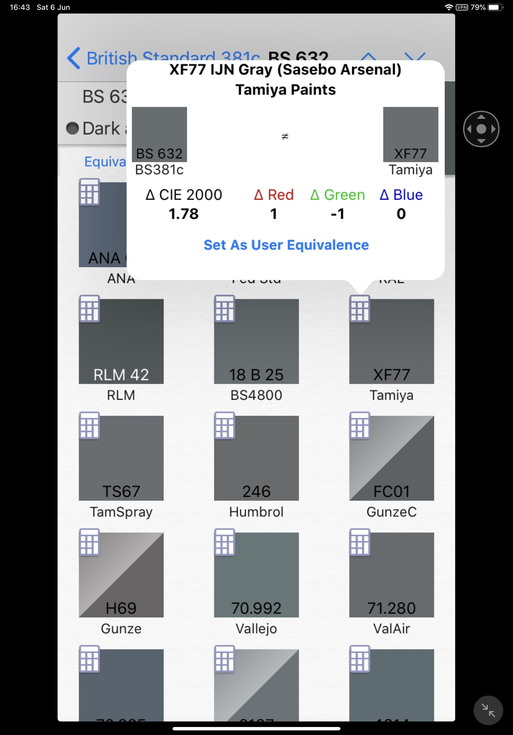

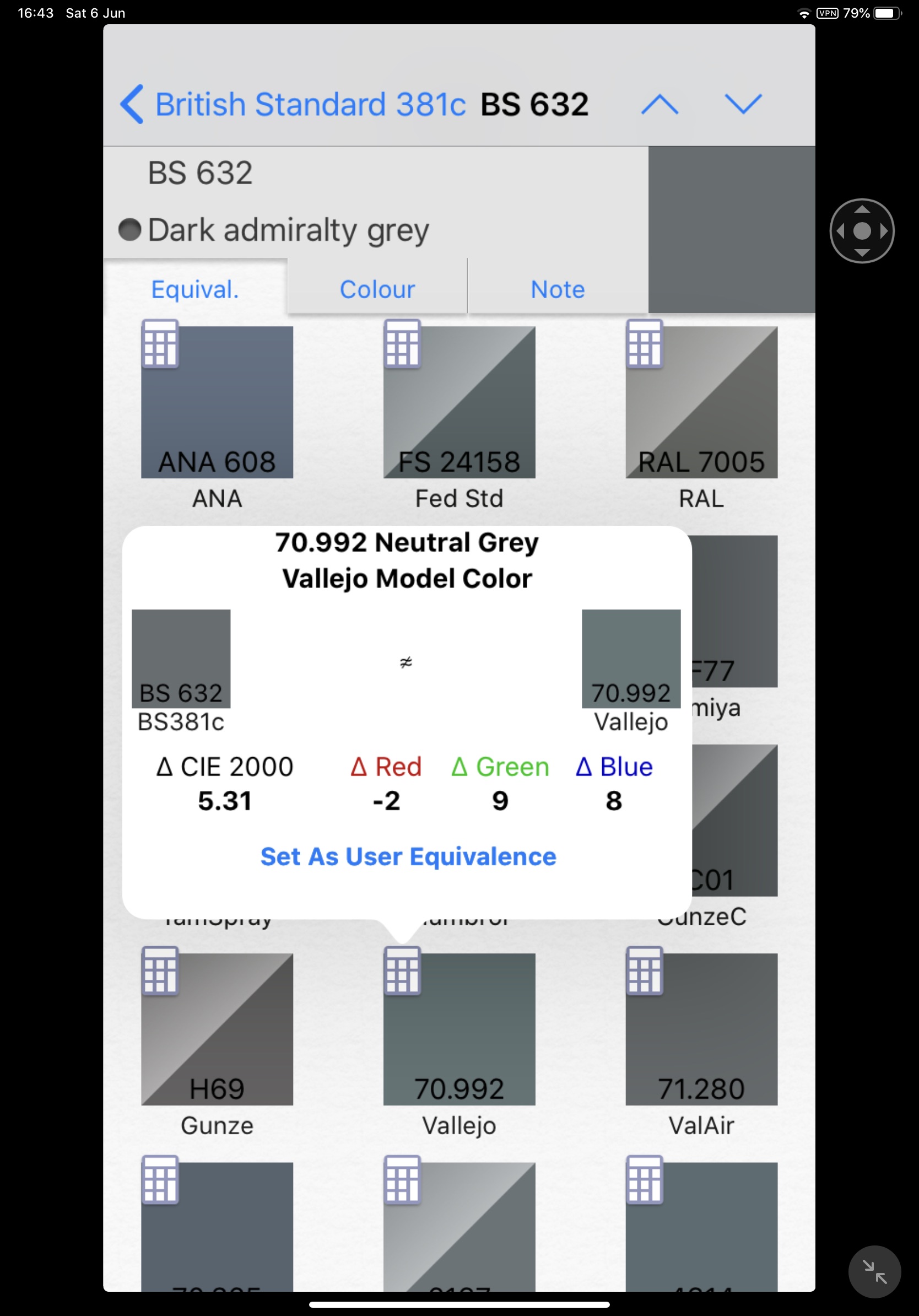

- Who makes an accurate Dark Admiralty Grey? Using iModelKit, we can find a match. We select the BS381c colour palette from the paints menu and get a chart of possible matches:
We can see that Tamiya XF77 is a match, as is Vallejo 70.992. To check this, we can tap on the calculator icons to give us a direct measure of how good the match is, using the CIE notation. (Any figure Delta figure under 10 is a close match, any under 1 is undistinguishable to the naked eye).
We can see that Tamiya XF77 is an excellent match. The Vallejo colour is close and you could use the iModelKit paint mixer to work out an exact match. Let’s do that with the third Berlin colour, Service Brown.

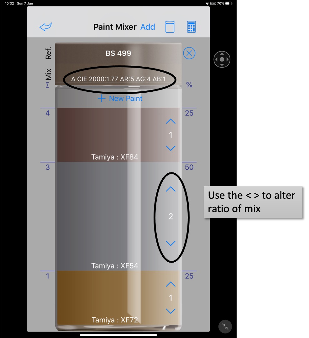

Service Brown is BS381c 499. We select this in the top section (Choose Reference). We then tap on + New Paint. The app asks us to choose a paint type. Sticking with Tamiya, we get a list of colours, in descending order of match. Against each is a measure of how close the match is, in CIE notation. We add XF84:
We see that the overall match has a delta of 8.46 and that we particularly need more green (delta of -20). Tap on + new paint and select the top paint, Tamiya XF54 and now the match is closer, delta 5.87 but now we have too much blue (+9).
Three colours is about the maximum you would want for a mix but by adding XF72 we get a delta of 3.82, which is close. Note the arrows on the side.
These allow you to vary the proportions of paint, which up to now have been equal measures. It’s worth playing around with these. Better still, press the calculator icon and the app will select the best match for you. In this case, if we now double the proportion of XF54, we get an almost perfect match. Result. The final mix is two parts XF54 to one part each of XF84 and XF72.We might have found that there are easier mixes using a different manufacturer’s products but this example shows the power of this tool.

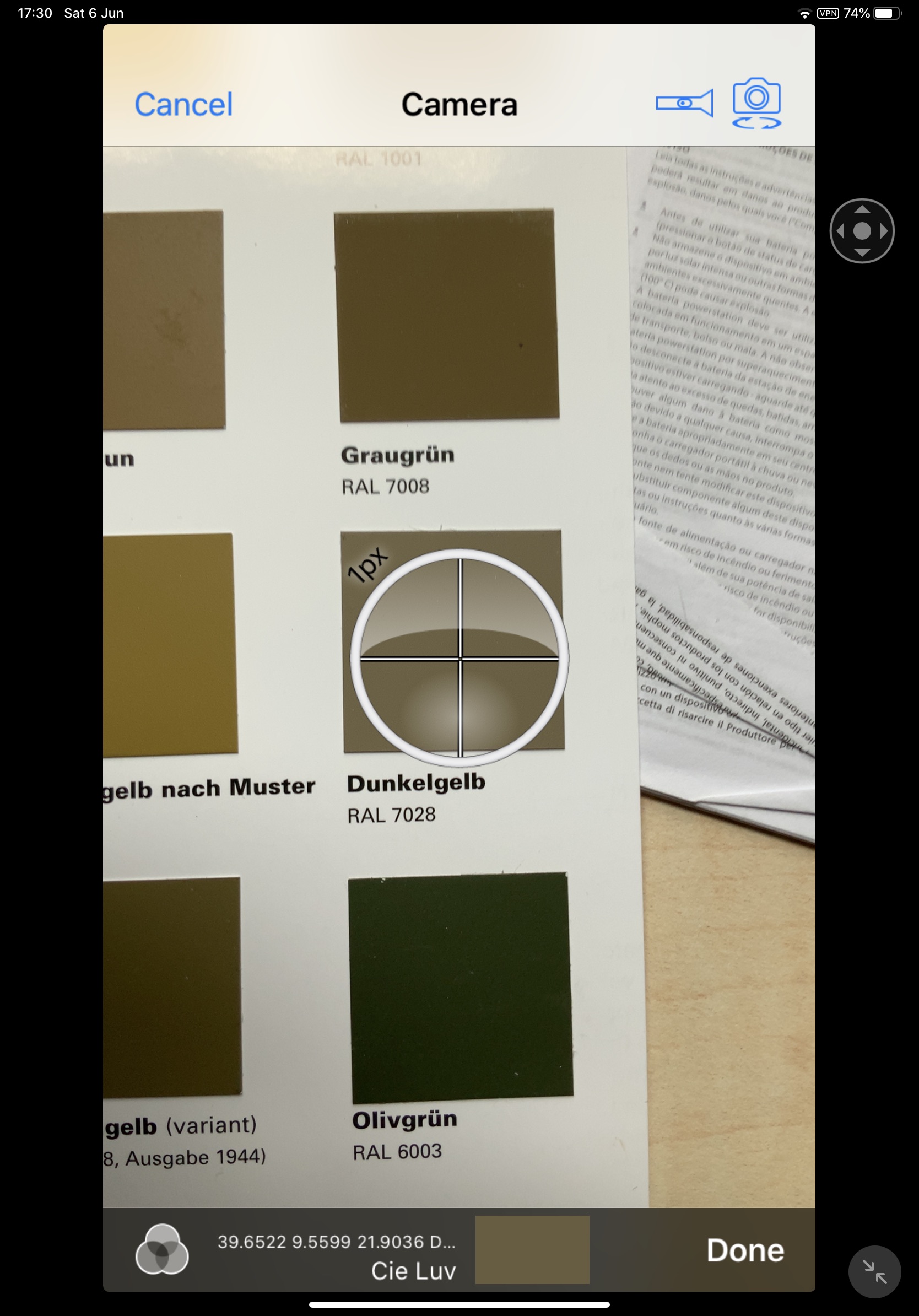

I’ve cautioned about the inaccuracies of digital representations but there is one tool in both apps which, if used with caution, can be useful. It’s the colour picker, linked to your tablet or phone camera. The apps will allow you to use a photo of a colour chip to establish the colour notation for that colour. If, for example, you have an authoritative colour chip, this can be a way of checking the accuracy of a so called authentic model colour, using the colour comparison tool in iColorKit. You could use the colour picker photo tool to compare an authentic chip with a sample of model paint. You have to be careful to avoid artificial light and photograph both colours in the same light.
AK-Interactive offer a range of colours based on originals. We can compare AK753 Dunkelgelb (Initial) with the equivalent colour chip presented by the widely respected source Tomas Chory.
From iModelKit, we establish a description of AK753 in CIE notation.

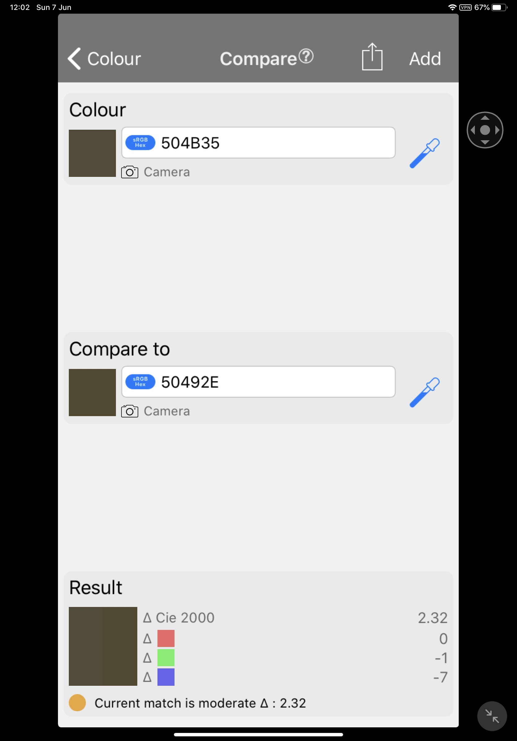

We then use the colour picker camera in the Compare Tool in iColorKit:
Entering the two values into the compare tool, we get a not unsurprising result, which is that the colours are not a good match:
Of course, we could then use the colour mix tool in iModelKit to refine the colour but a better option might be to find an alternative model paint. This method has to be used with caution but can be a useful check.

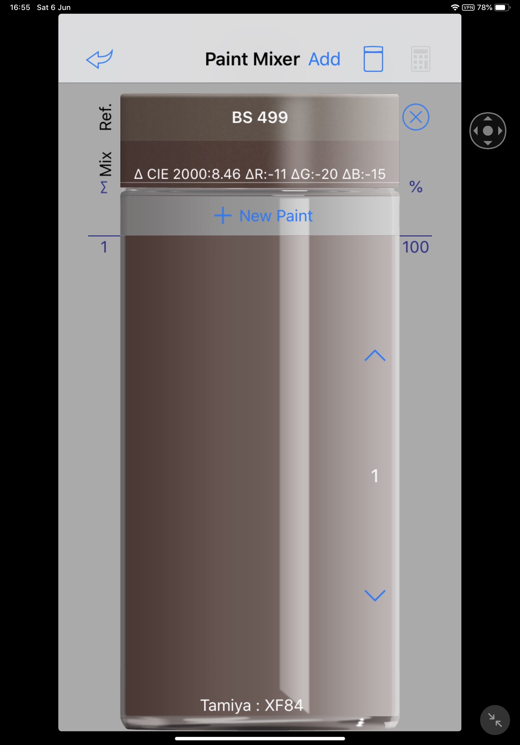

So far I've relied on BS381 colours produced in rattle cans but, for my Quad, I struggled to find the Khaki Green No.3 that I wanted. I have recently taken the plunge and delved into airbrush territory and have been using AK "Real Colours". These have apparently been developed in collaboration with Mike Starmer, amongst others, which (to me) should make them "reliable" in keeping with my approach to these things.
For reassurance (while heeding your cautions) I thought it would be interesting to compare the AK paint to Mike's colour chip in his camouflage books - but iModelKit doesn't include the "real colour" range. Furthermore, reference your comment on operating platforms, it seems that iColorKit wont even work on iPad - only the iPhone.

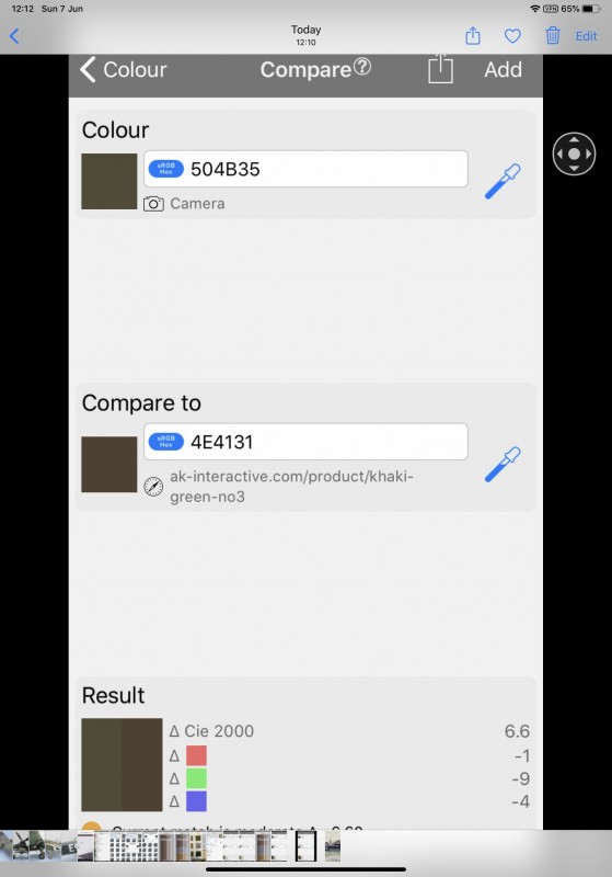

Re AK and British Khaki Green No 3. (Health warning - printed media). I have Mike's colour chips and thought I'd compare his Khaki Green with the colour chips in the AK Book, Real Colours. Interesting result (notwithstanding that the Real Colour chips are printed and may therefore not be representative of the paint AK sells). The match came out as Moderate, which is probably a good result. Top figure is Starmer, bottom is AK:
This is a comparison with the colour swatch on the AK website (Khaki Green No 3 bottom):
Again, a moderate match, which is under 10 and therefore probably close enough.
I've seen people having some reservations about the AK Real Colour range but at least they are trying hard to be authentic. For aircraft, I've seen great praise for the Mr Paint products. I've just used them for a Fairey Barracuda model I've just made for the Fleet Air Arm Barracuda restoration project and I'm full of praise. The colours are smack on (as measured) and they spray beautifully. I get them direct from source. They do a British Khaki Green No 3:
