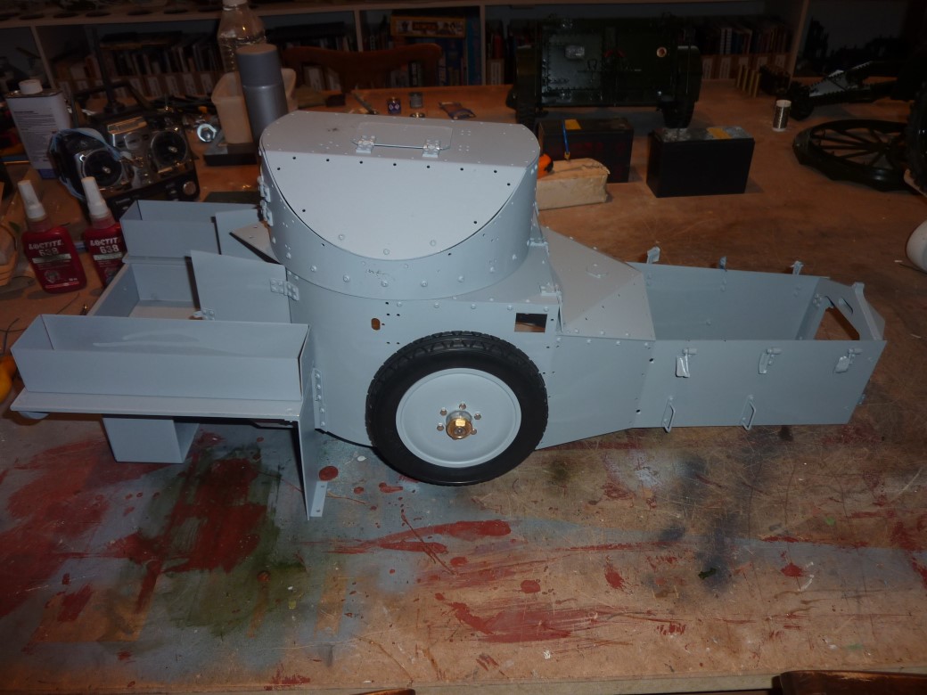

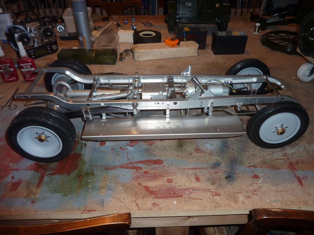

When Armortek first brought the Rolls-Royce out I was entranced by it. But I just didn't have the funds, and had too many projects on the go already, so I just admired it from afar ....... until last December, when Steve Ford put his part-built one on the 'For Sale' section. What's a man to do, especially when his wife says "you can have that one" ? So a deal was done, including shipping from the Wild North to Wiltshire, and it's now next on my to-do list (after the Quad et al, but regretfully pushing the Burma Lee and Flaming Fire II back down again :oops:).
Steve has done a fine job so far:
so it's a shame he decided not to finish it. I think the spoked wheels got to him - a challenge to us all ! I shall, of course, be standing on the shoulders of the Giants on this part of the Forum :).

I've never bought a second-hand, part-built model before ! So I thought a good way to start would be to go through the instruction book, page by page, and work out what had been done. And the answer is ...... an awful lot has been done, and very well too. Thanks to Steve Ford ! I think starting from scratch would have been quite ...... intimidating :?.
So the only changes from the above photos are:
  • I've fitted the bulkhead. That is actually a disappointment. It's not the part, or the kit - it's the bits that you can't fit due to the Armoured Car body ! In particular the klakon is lovely, but would get in the way of the bar that opens the radiator doors, so it can't go in. And photographic evidence says that they weren't mounted externally so, with deep regret, it's for the spares box. As is the coil box, and that lovely plate that goes over the gearbox :(. And that excludes all the nice dials etc. that are for the chassis kit only, so are not even supplied. But that's my choice - I want a model that will drive around and look (and sound) like an AFV, rather than a display piece. That's the joy, and the sadness, of this model - so many choices !
  • Following advice from the Giants who have gone before me (mainly Chris, Mick and Pete :)) I've wrapped the leaf springs with tape to represent gaiters. Clearly this would have been much easier before assembly ! But I didn't want to do too much disassembly, and it wasn't too difficult. It's also good to keep all the individual leaves from separating. Etch Prime and paint should finish the job nicely.
  • I've found the radiator parts, which will be a 5 minute job to fix.
That's pretty well it for the chassis. If I can find enough primer and paint (I'm not counting on the mail order services right now), and the weather holds up, it's good for painting. Then on to the Armoured Body, where it's largely a case of fitting all the blank rivets. So there's really not much to do - I'll be on to those spoked wheels much sooner than I'd planned ..... (looks desperately for a Fear emoji).
