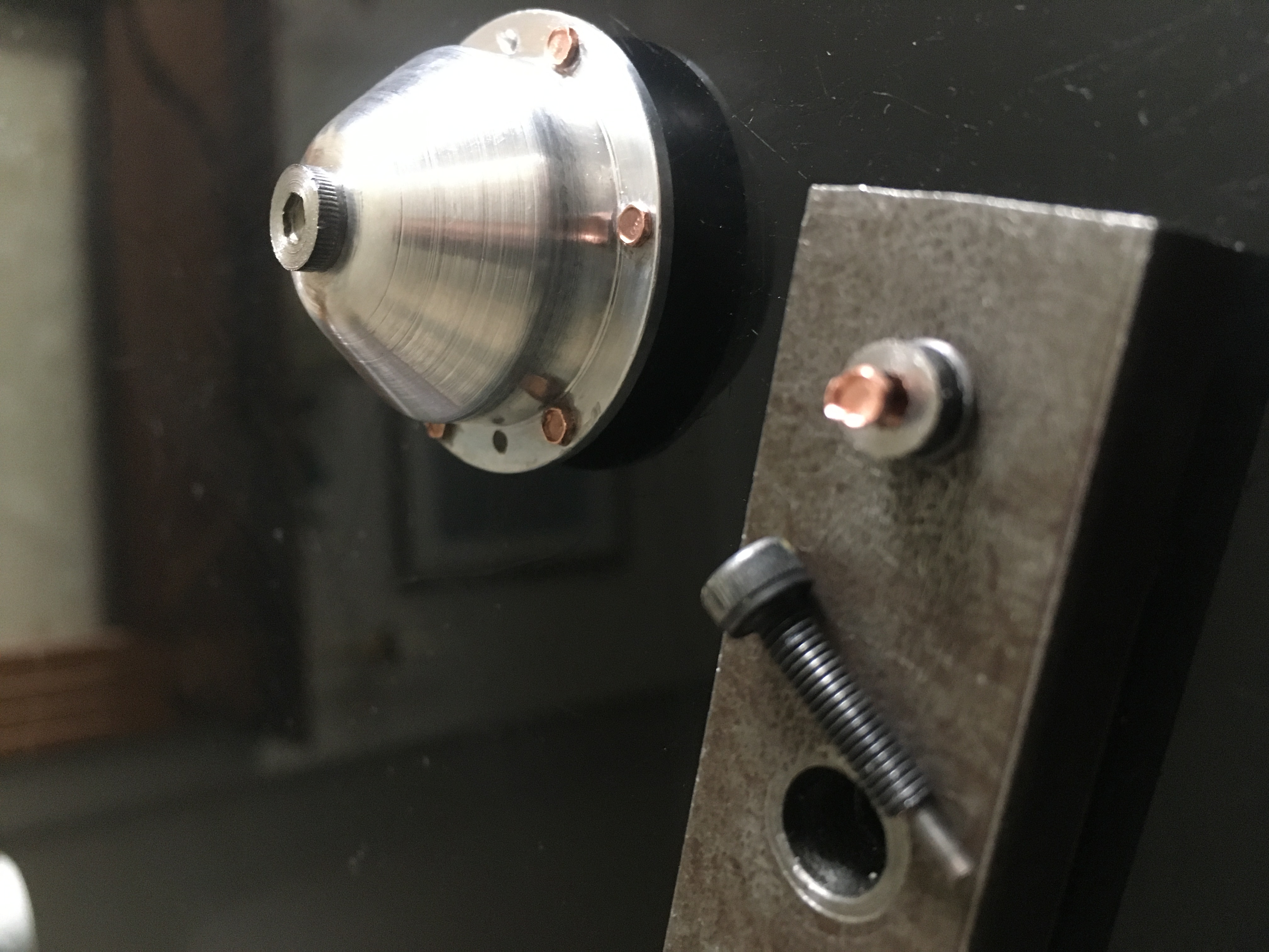

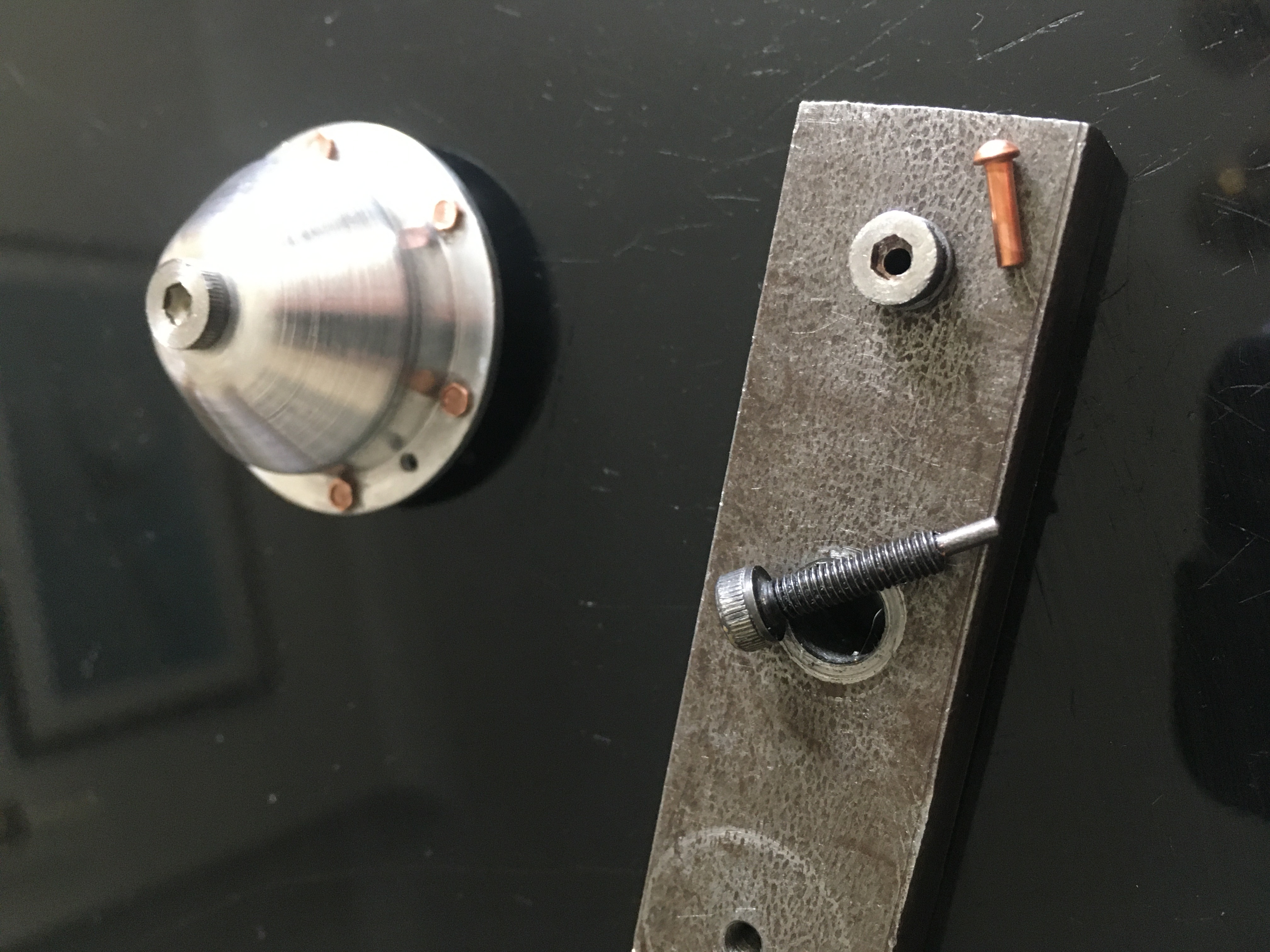

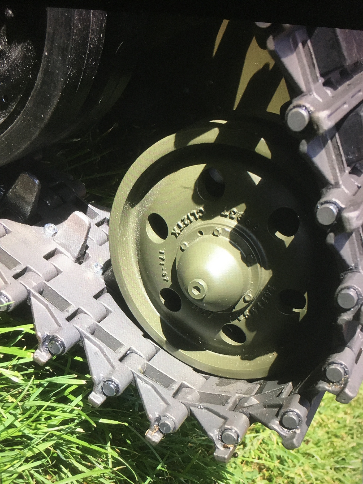

As with other builders, slow progress on the Chieftain, but I thought sharing a method of turning the rivets supplied in the kit to something more representative would be useful, as the thought of mutilating expensive tiny bolts to be glued in ,is madness .
Drilling and tapping M3 in a piece of scrap steel, drilling a clearance hole for the rivet in an M3 cap head screw, tap the rivet to form a hex, make an M3 extractor bolt with a pin or broken drill (I have many) to push the rivet out from the opposite side.
There could be other tight fisted forum members out there, hope it helps .Dave W

Re: Dave’s Borrowed Chieftain #47
That's certainly a cunning way to make hex heads :D
Though I'm going to stick to using BA hardware :lol:
Cool! Great idea, the hub caps look great.

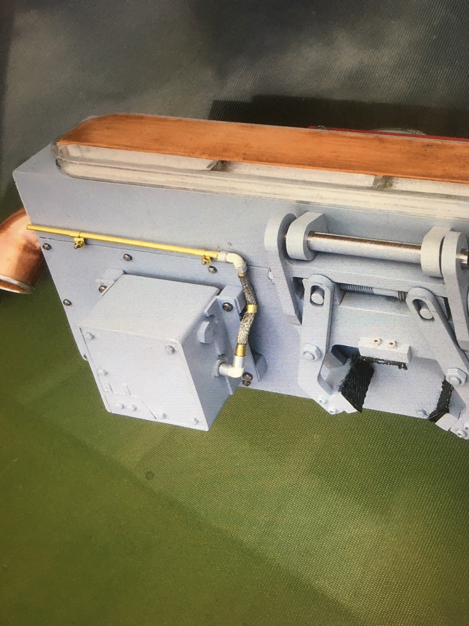

Update on a super slow build, the idlers have now had their cosmetic coatings and painted, the last 6 months have been spent on the exhaust box machining and detailing.
Unfortunately this will be the last post on the Chieftain, as the tank will be passed on to the next owner to carry on the build, I’ve enjoyed the project challenge, but the next part involves playing around with the heavy castings of the front armour and turret which I am unable to handle physically . Dave W
