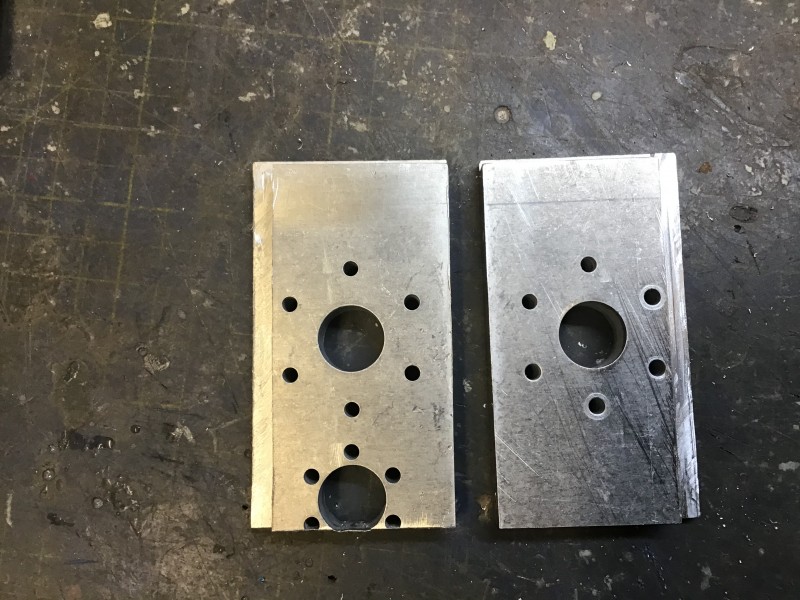

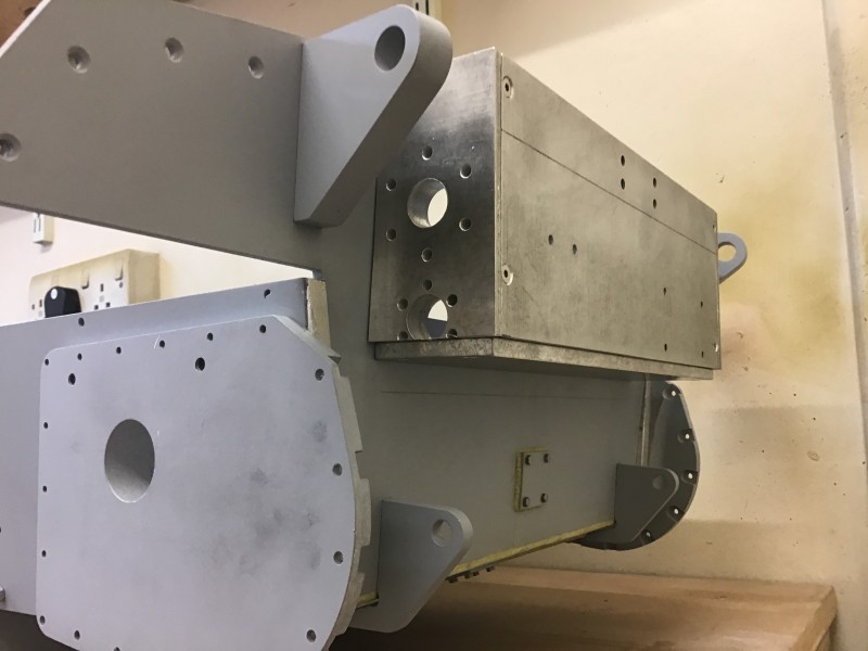

I have been busy working out the best solution to correct the exhaust box height and change it’s appearance to be closer to the real item. I want to do this by minimising the amount of work required and using the supplied parts suitably modified.
First job is to cut 12mm of what will become the bottom of the side plates. Before anyone says I’ve got it wrong and hacked chunks off the top I have deliberately swapped the side plates left to right and right to left, hopefully all will become clean later.

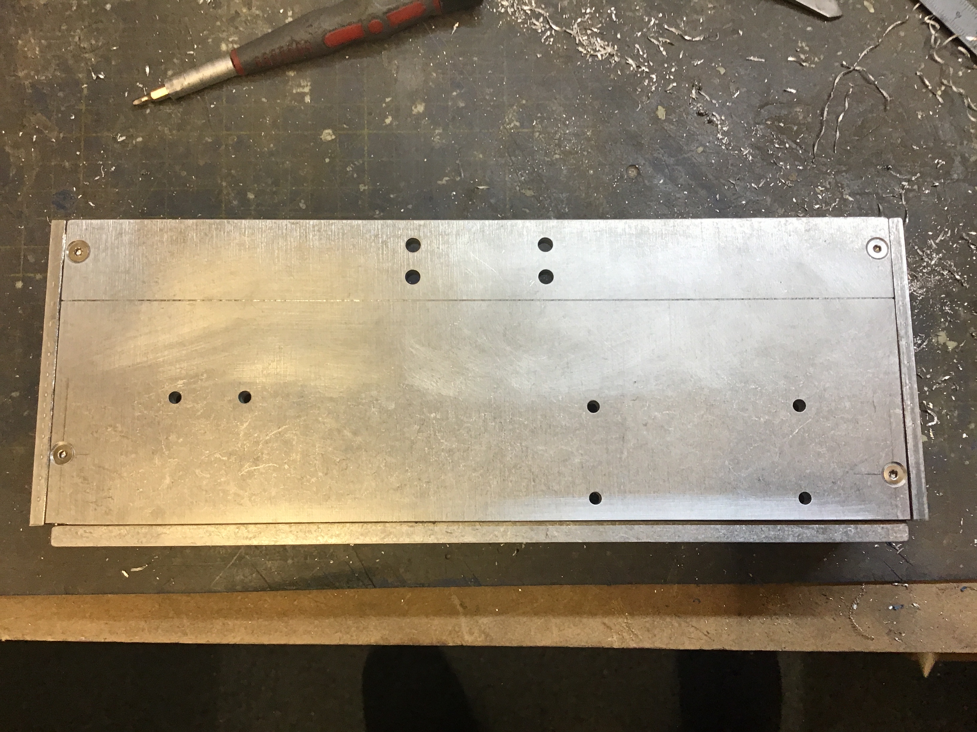

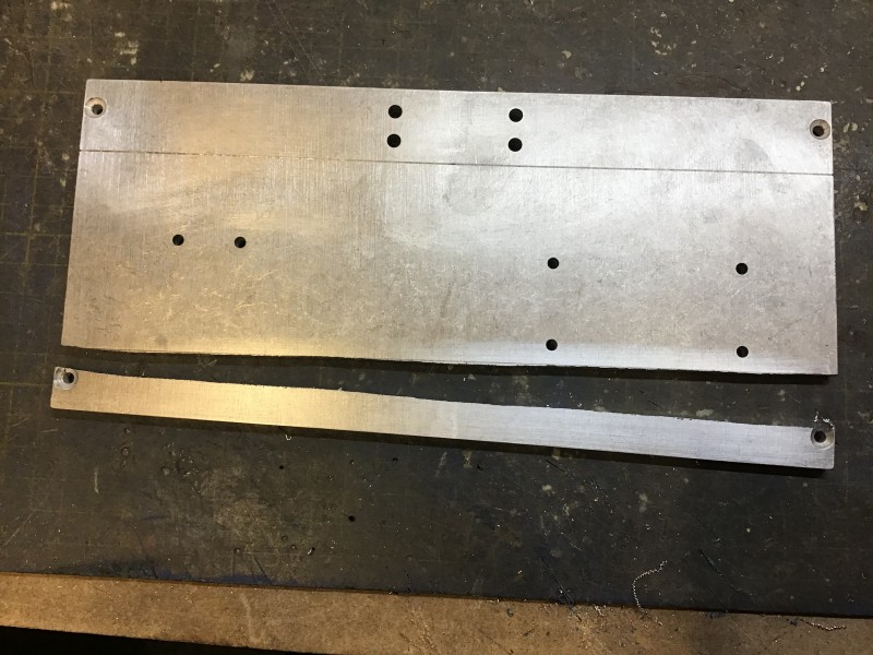

12mm removed from the rear plate and the line for the removable section scored using a p cutter (it’s meant for cutting plastic but does a very good job scoring ally)

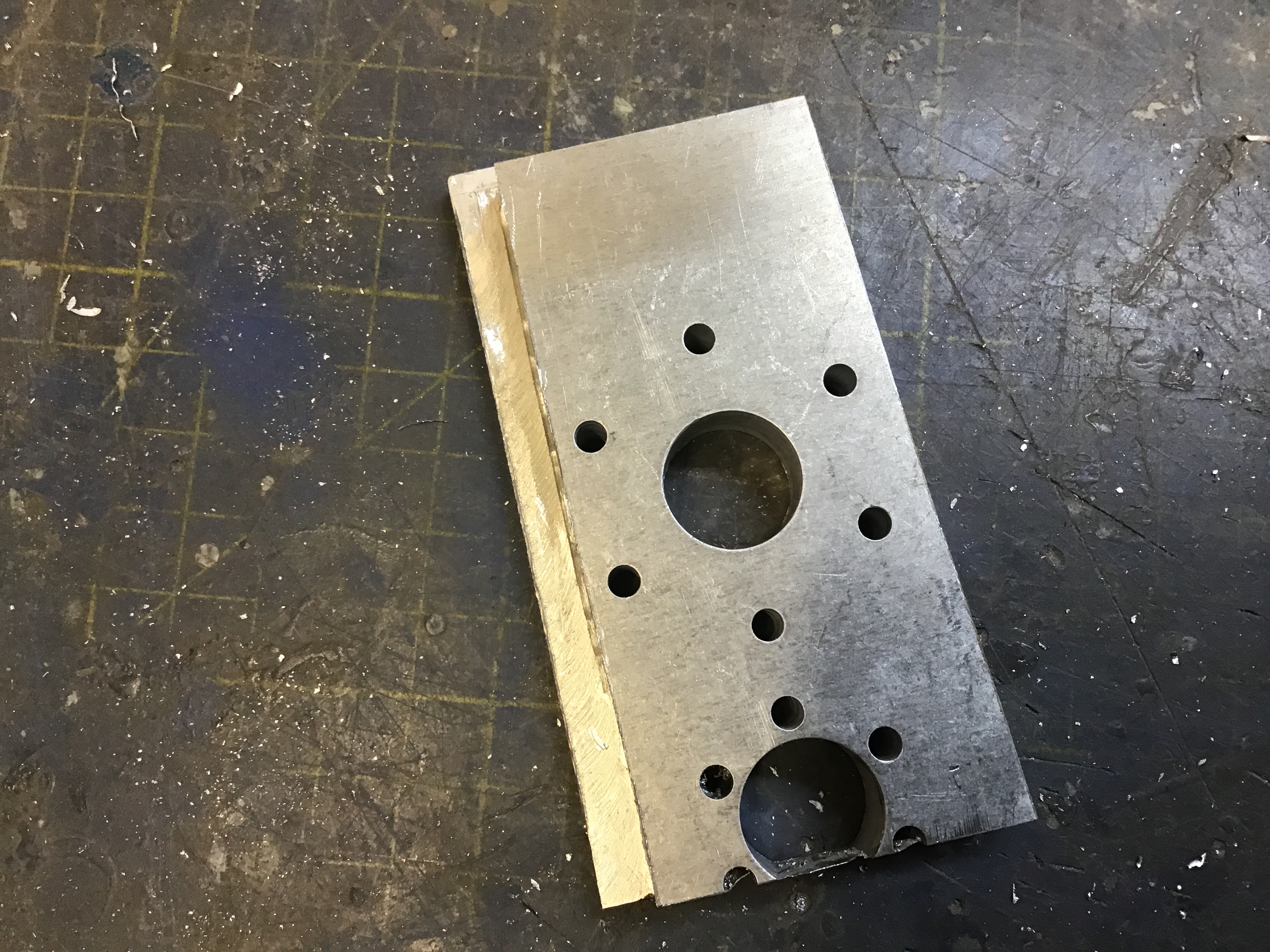

The side plates need tapering to get the rear plate vertical when the box is mounted to the sloping hull rear plate
This is the reason for swapping the side plates over. I wanted to reposition the generator exhaust further to the rear and also rais the height of the main exhausts which would have been to low with 12mm removed from the bottom

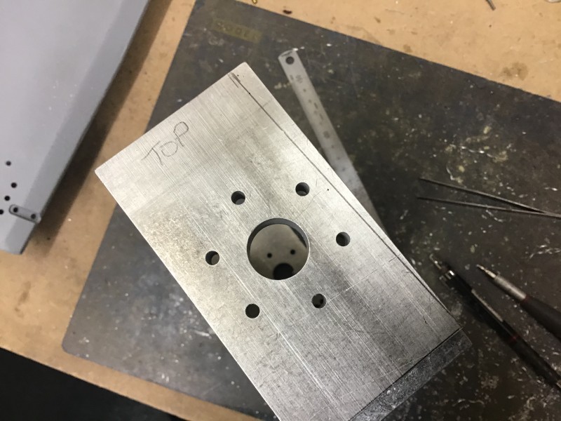

Next job is to increase the depth of the rebate for the rear plate
Now I have a flush fitting rear plate

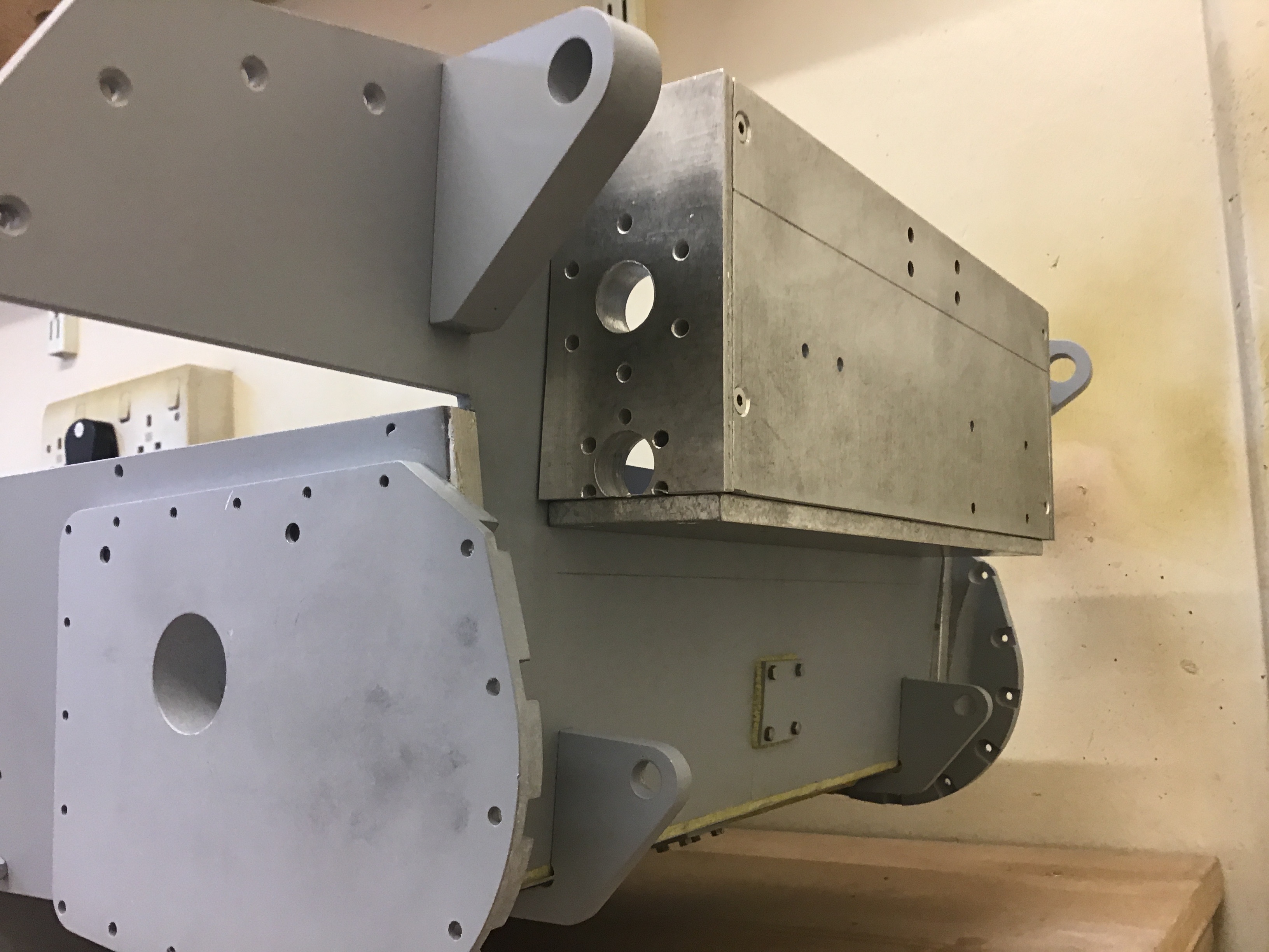

A quick test fit and quit happy with how it’s looking. Below the box you can see the original position of the bottom of the box.

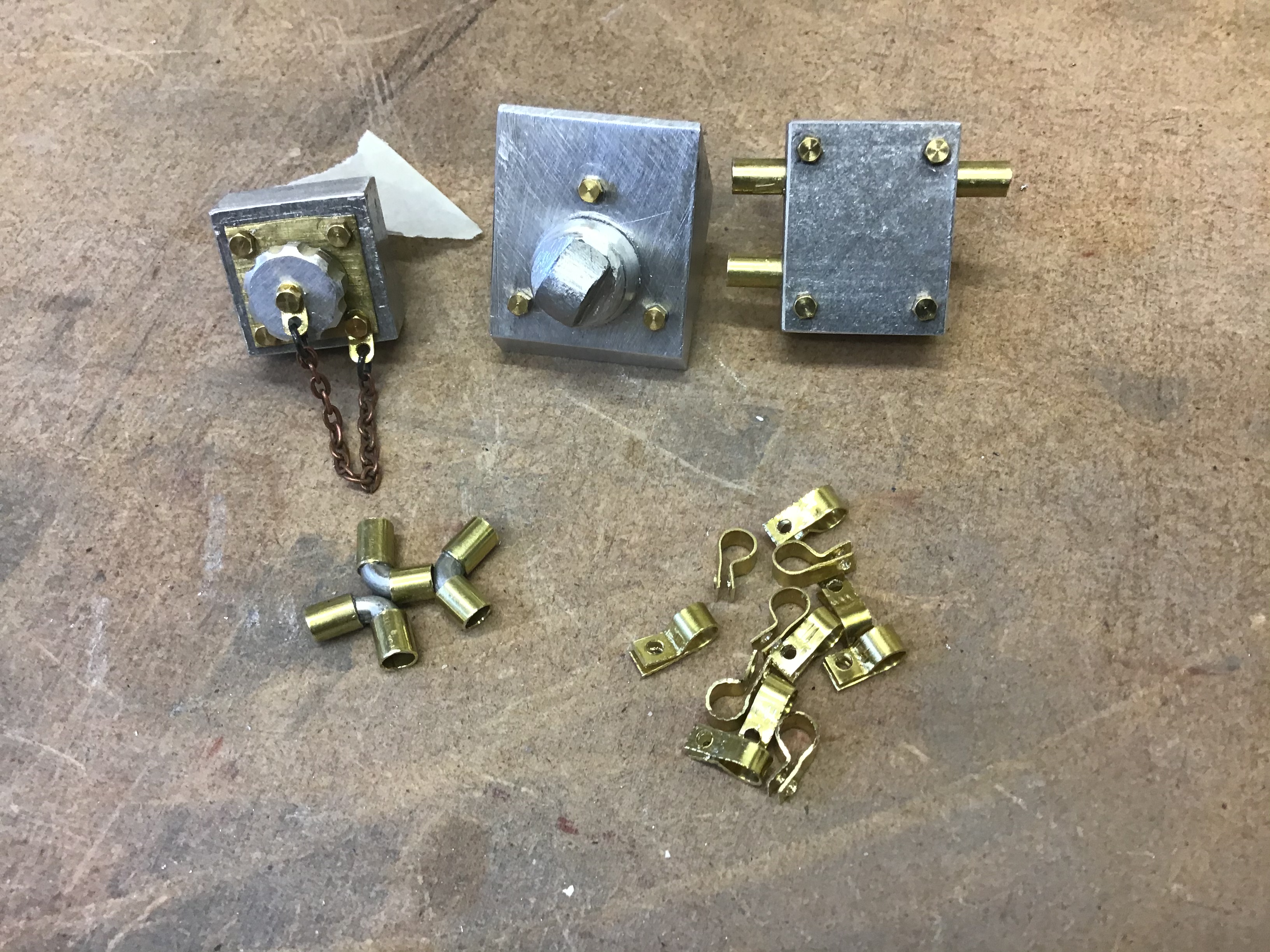

I have got a bit more done over the last week or so, lots of cutting and filling plus plenty of fiddly bits made.
Progress is a bit slow but there’s no rush and the end result is what matters.

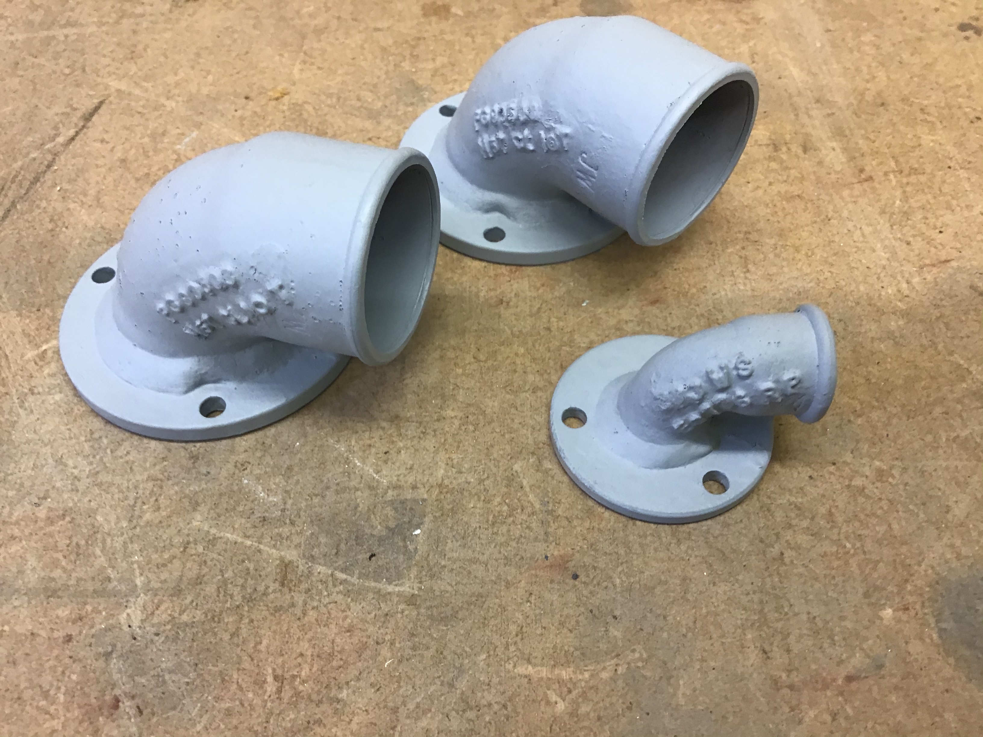

Rear plate fittings ready to install, lots of p-clips and 90 degree elbows
Reworked exhausts
Reworked exhausts

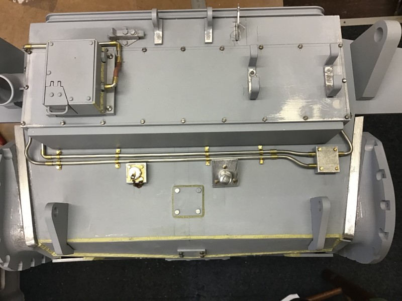

Progress on the exhaust box
All the components in position and the wiring conduits fitted. I still have a lot of weld detail to add before final assembly.
