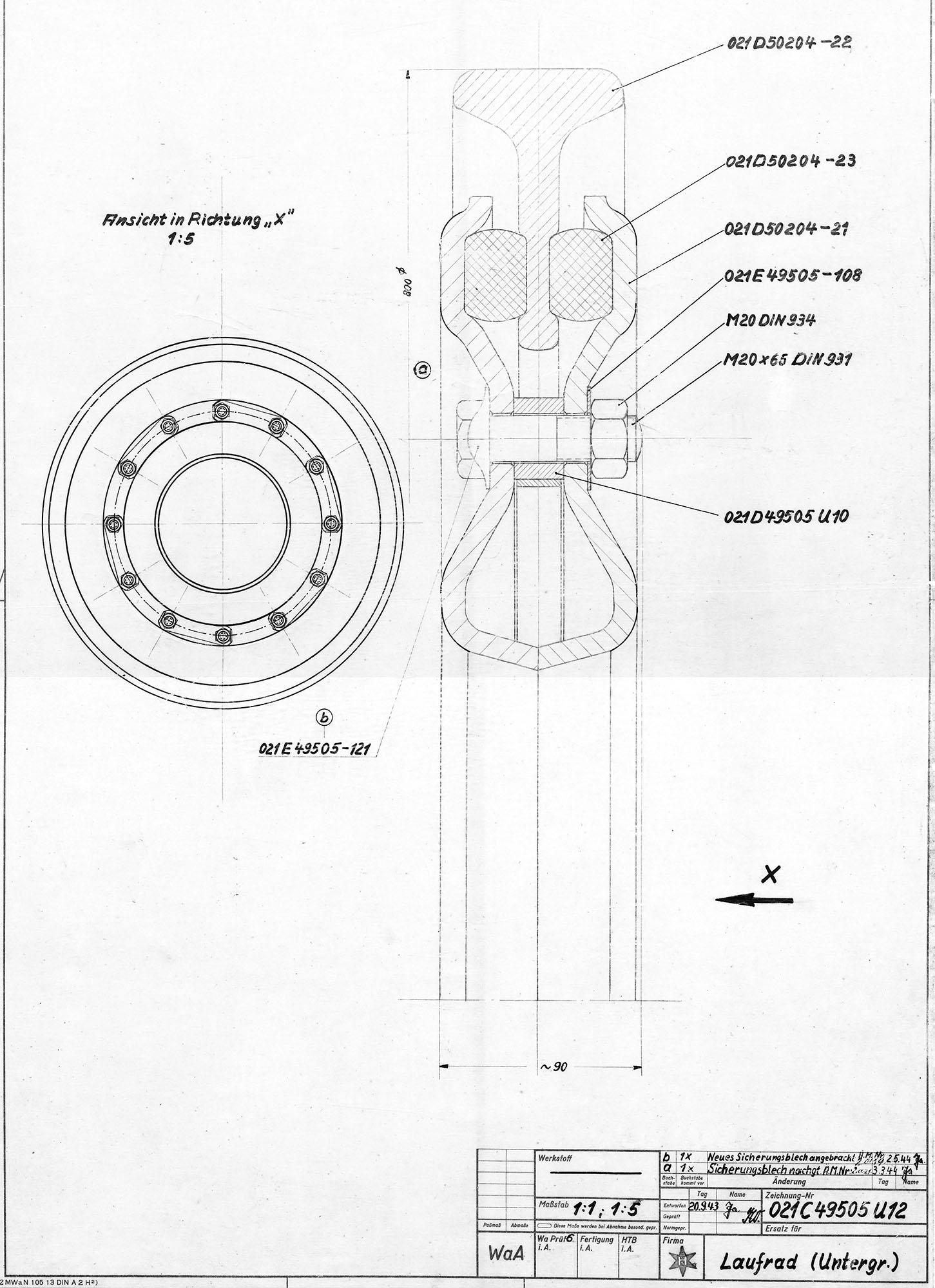

I am going to be fitting the resilient steel road wheels to my tiger. I have been looking at those provided with the kit and compared them to images of the actual ones. The outer bolts, used to secure the steel plates together, are larger than those used on the boss `shells' . Does anyone know what the actual sizes are?

You are correct in noting that those nuts are larger but unfortunately I can't help as I don't have the actual size. Maybe somebody can help with that. What I did was increase the size from M2.5 to M3.

Hi Alastair,
Sorry have no drawings etc from Tiger1 steel wheels but here are 2 of Tiger2 ones from Per Sonnerviks collection at Panzerbasics.
They are supposed to be the same.
Hope this helps you.

Kent,
Just what I was looking for. Thanks :D
