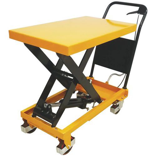

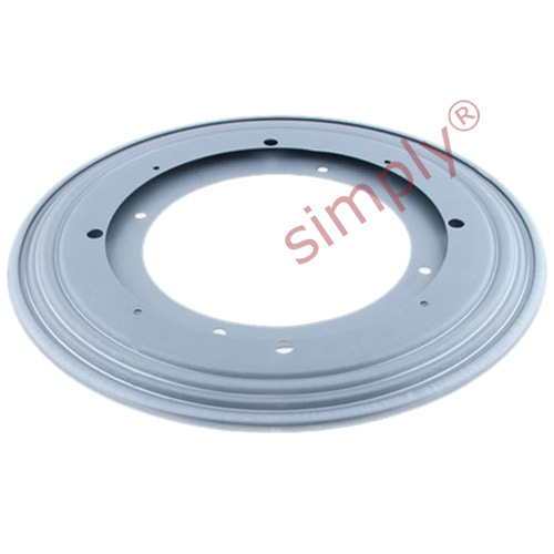

Hydraulic lift table for building, with a motorcycle scissors lift and lazy susan on top. This assembly allows you to work at different heights and once you've got the running gear on, to lift the tracks clear of the table to allow the motors to be run.

where you get this part?

Search your local ebay for motorcycle scissor jack.

Hello Adrian,
thanks for the link.
Unfortunatly I can't buy that in Germany

Hello Florian,
found actually in german Amazon:
https://www.amazon.de/SMX-Motorradheber ... way&sr=8-1
There are much more offers..............

Thanks Gerhard,
ich habe offenbar falsch gesucht. Habe jetzt eine auf ebay gekauft. - dort wars günstiger
