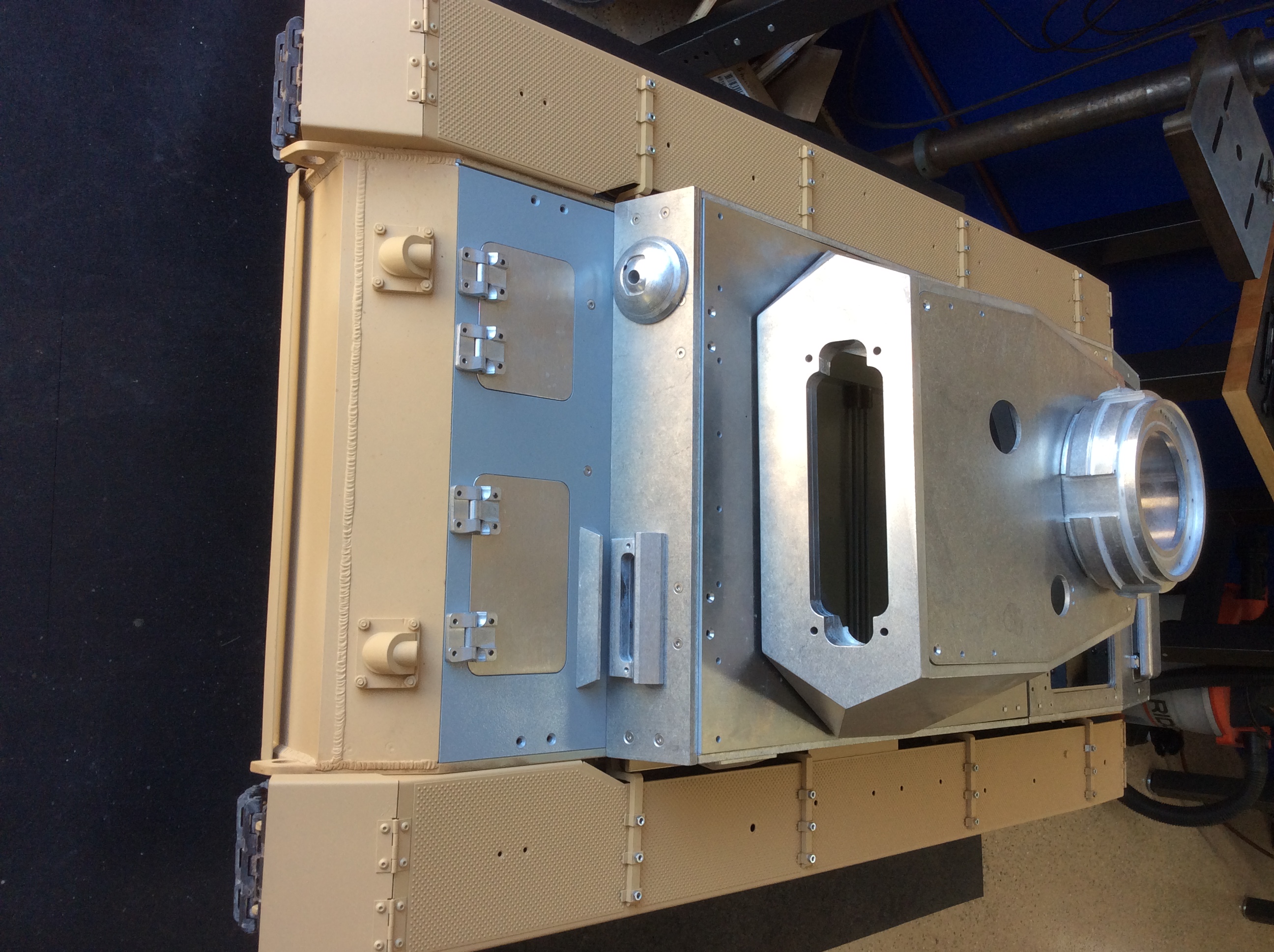

I am building my first Amortek tank. A Panzer 111 ausf L. I have the hull, suspension, tracks, mudguards, etc. all complete and painted. I am waiting for the new option packs to arrive in September before I permanently attach any of the upper hull parts so I have access for installing everything. I am test fitting all the upper hull parts and getting ready to paint them and set them aside until the option packs are installed. My question is, should I allow for some of the upper hull parts to be removed to service the batteries and electronics? If I putty the counter sunk screws that hold the front and rear upper hull parts I will not be able to access them again. If I simulate welds with milliput that also makes them unremovable. Then there is the turret assembly. Should I make some or all of it removable? There is a row of M3 bolts that bolt everything down to a piece of aluminum angle that could be removed for access but they will be rather difficult to access through the hinged hatches on the front and rear upper hull plates. What do all you experienced builders do? Am I over thinking this whole thing?

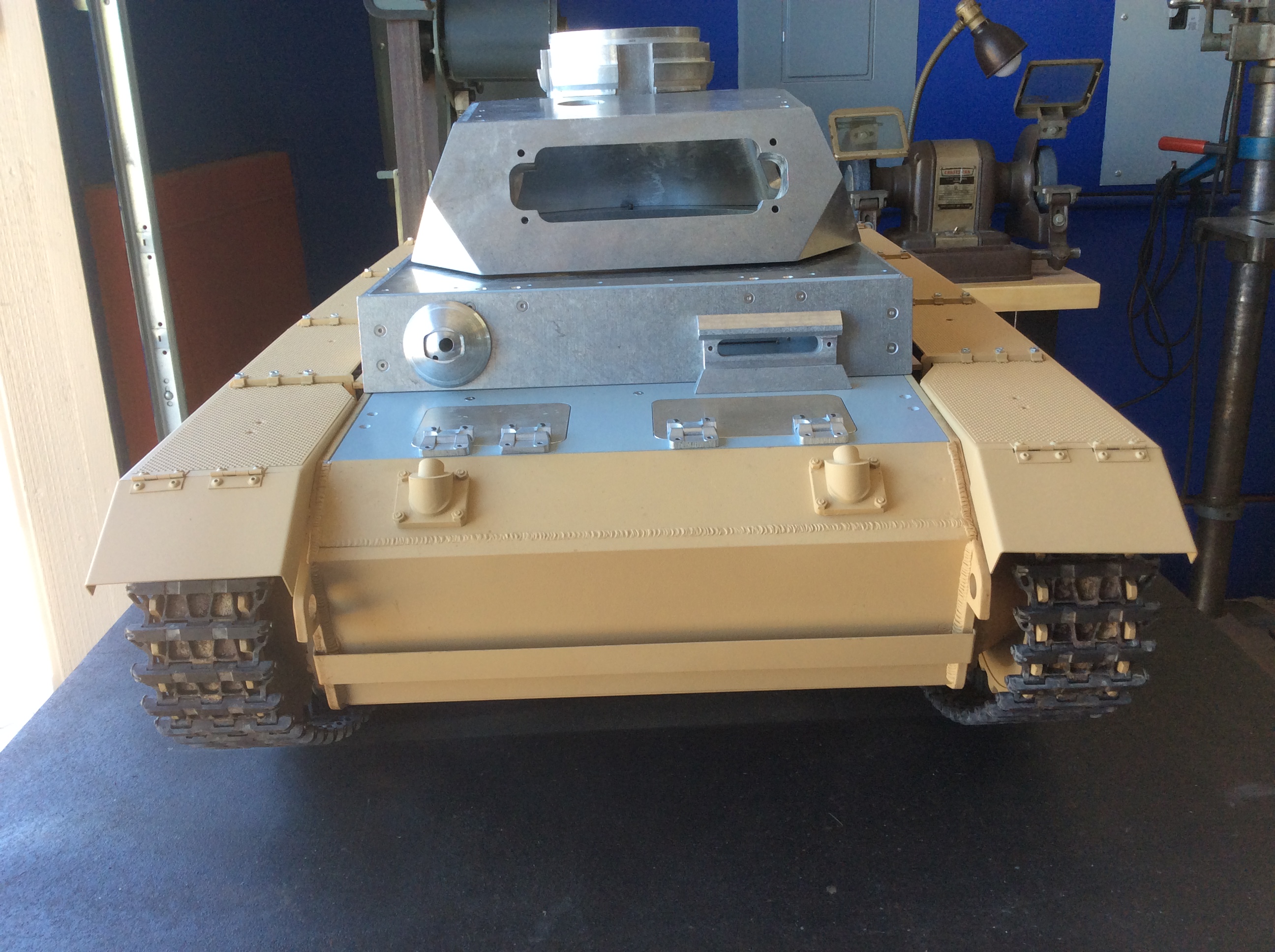

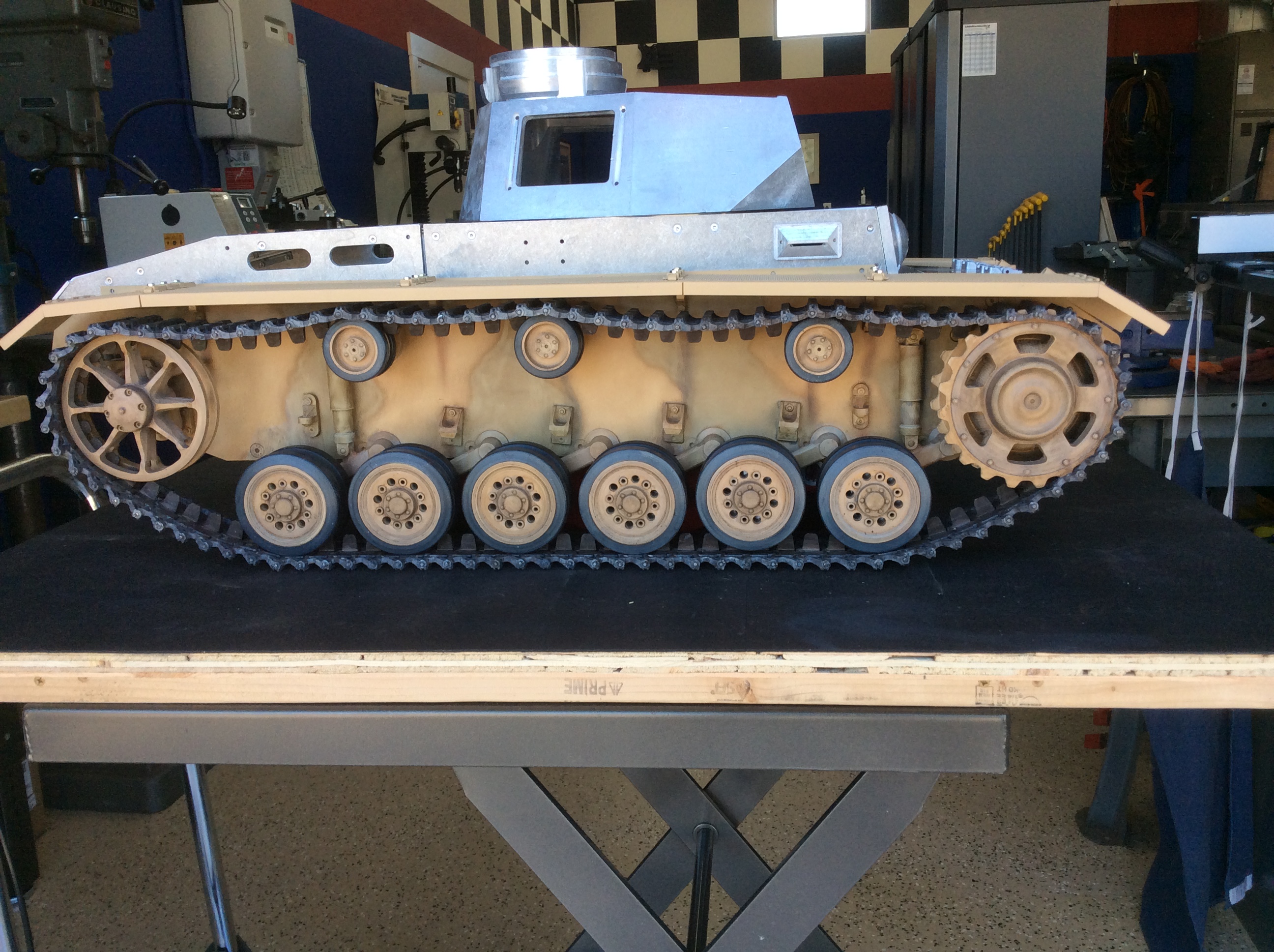

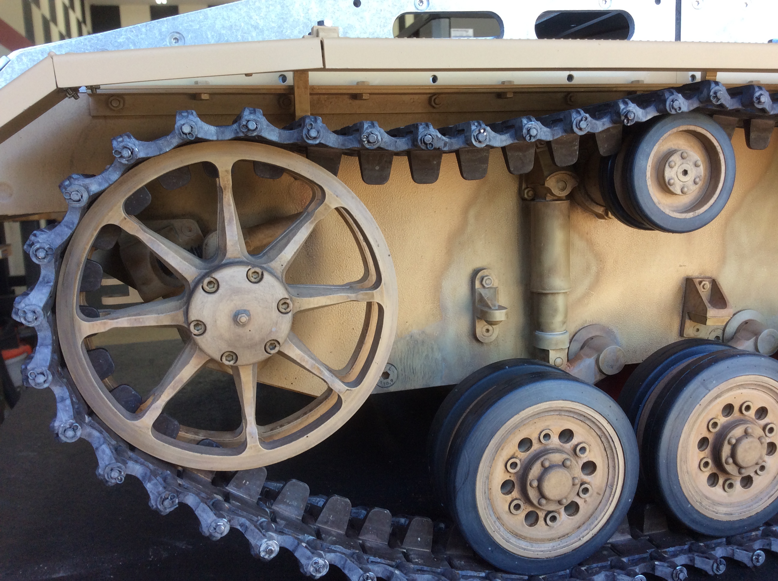

Attached are a few pics of progress so far. I decided to try my hand at weathering and camo on the lower hull sides where it is hard to see. I need to learn all these skills before I have to do it where it really shows. Also tried a few welds using milliput. Not totally happy with any of it but you have to start somewhere. I am studying all the pics in the builds by Peter Nash, Stephen White, Iacopo Di Giampietro, and everyone else for that matter. Maybe someday I can work at that level.

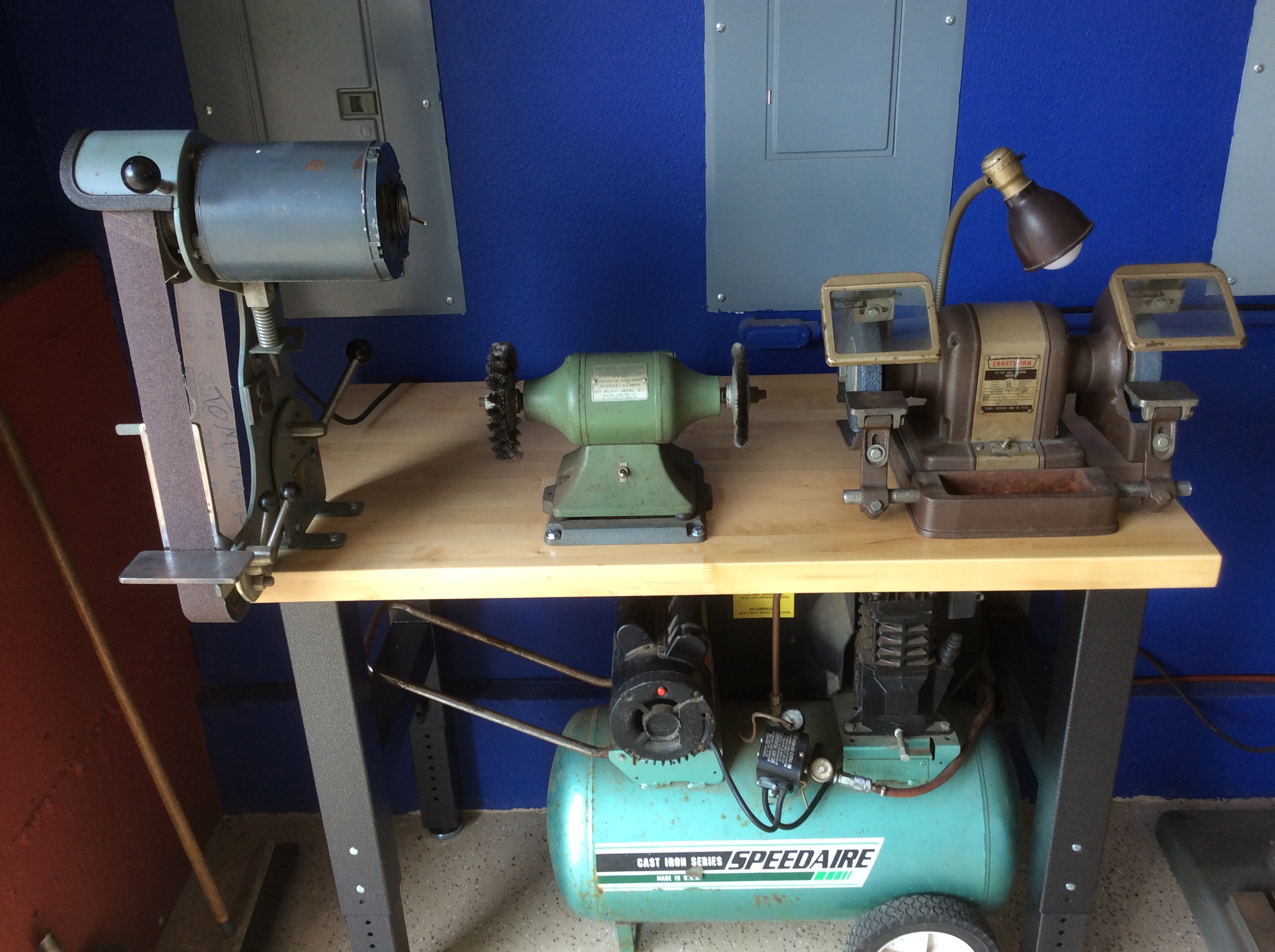

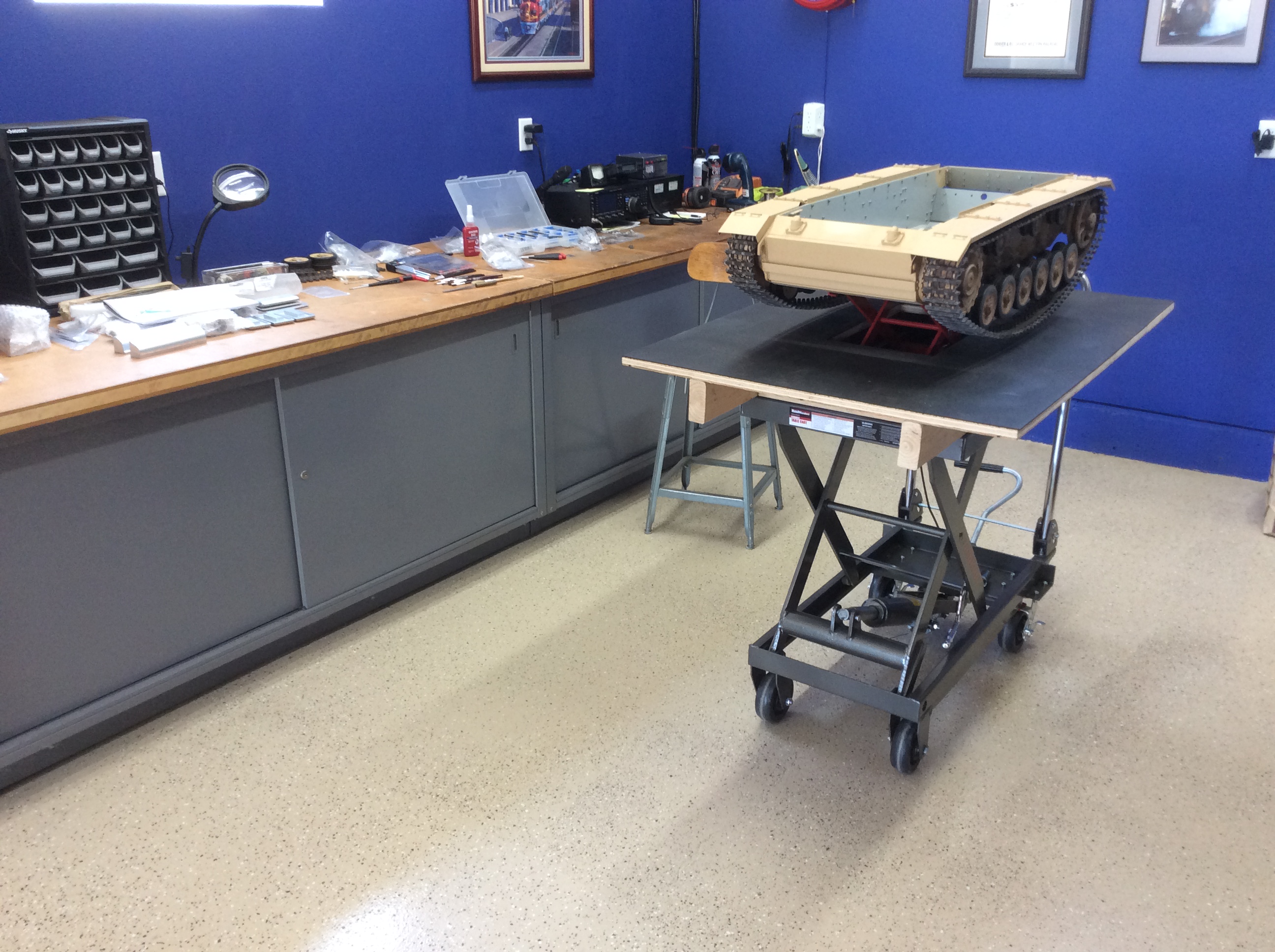

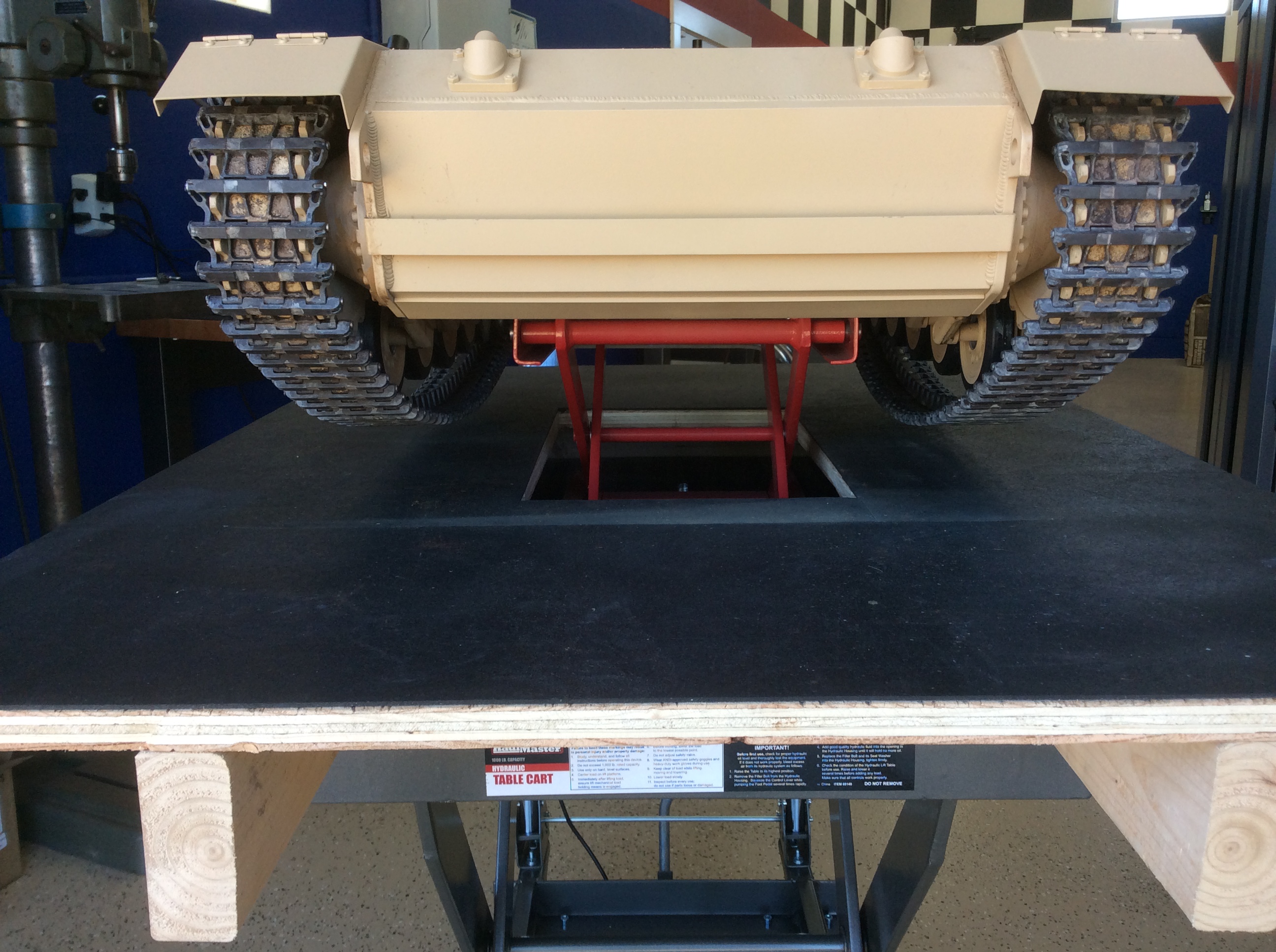

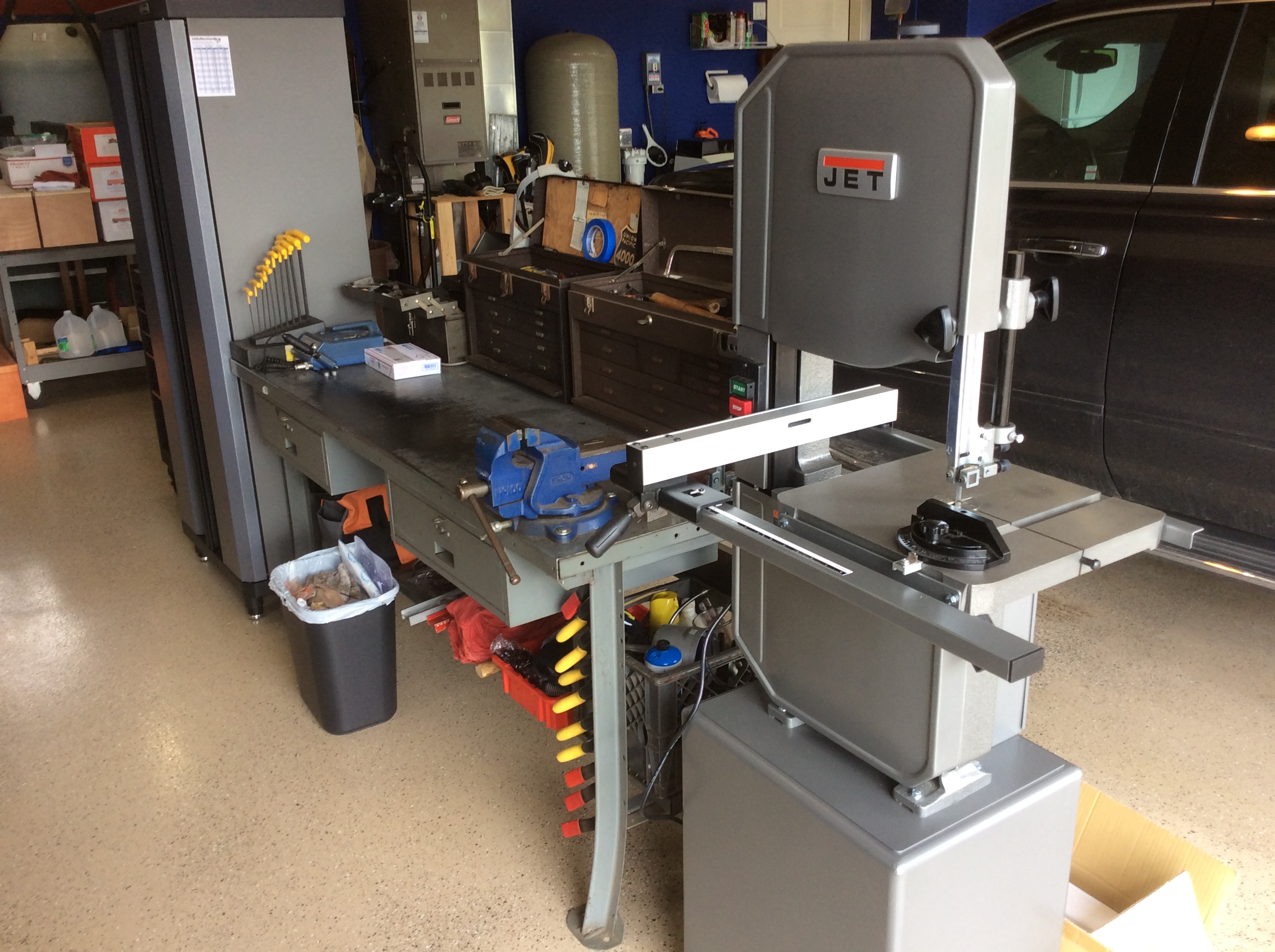

Here are a few pics of my shop.

The obvious place to allow separation on the Panzer III is along the two angle brackets, as that's where the real one came apart, so with a little ingenuity, it should be possible for you to make the whole rear engine deck piece with all the hatches etc removable without needing to leave countersunk screw heads visible or affecting any welds.
Any damage to paint on the bolt heads will then also be prototypical...

Nice Shop. Enjoy the Build.

your P3 looks great, weathering is spot on. Nice shop as well. Perfect for these models. Hope to see your tank sometime at a West coast event.
