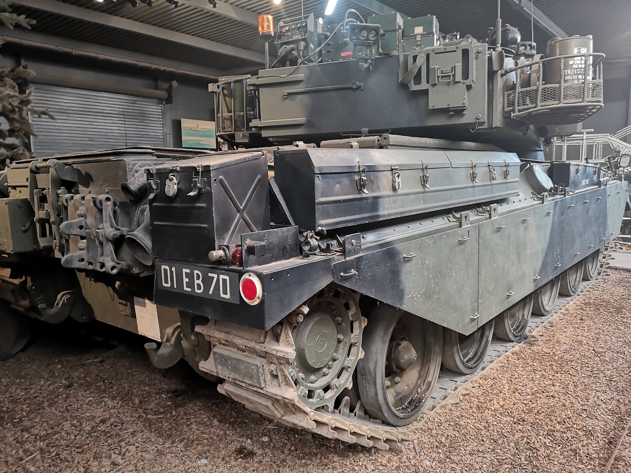

Took some images of 01EB70 at Duxford Today.
Applolgies for poor quality, the inbuilt flash didn't work :(

Who stole the two rear bins off the turret ? :x

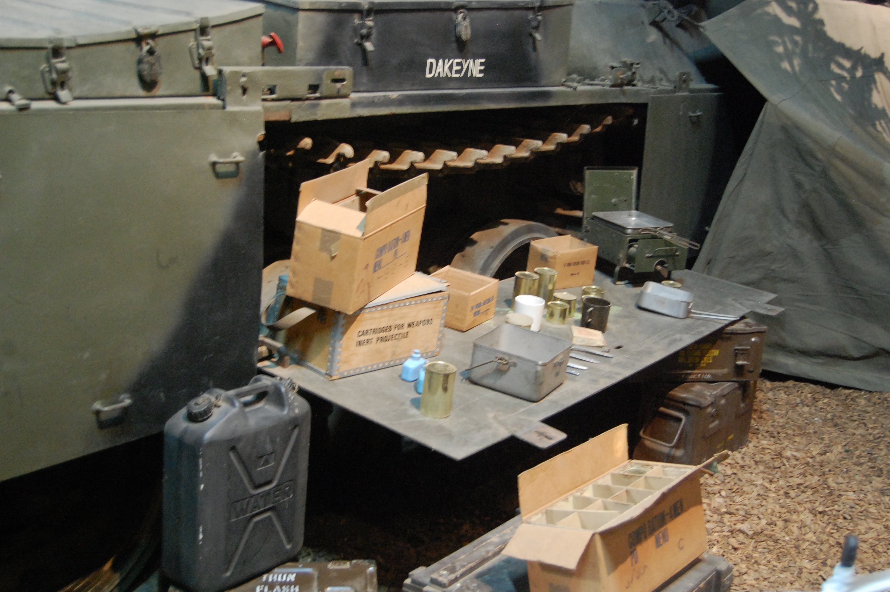

I wonder what mistakes Stephen has found with the exhibit. So far I have spotted the following.
Missing mounting bolt for the "bazooka plate". After dropping down the "table", both securing bolts would have been put back in a couple of turns so you knew where they were.
Ammo boxes supporting the "table". Not needed to support it. The crew would have stowed any ammunition received and the boxes would have been off to one side to be collected by the SQMS.
4-man ration packs correct, 1-man ration packs are in my experience not. If 4-man packs were not available, you got 10-man packs.
Tracks are slack.
Two salt shakers on the table - one of them would have been binned.
Padlocks fitted to the bins.
Culery laid out on the "table"

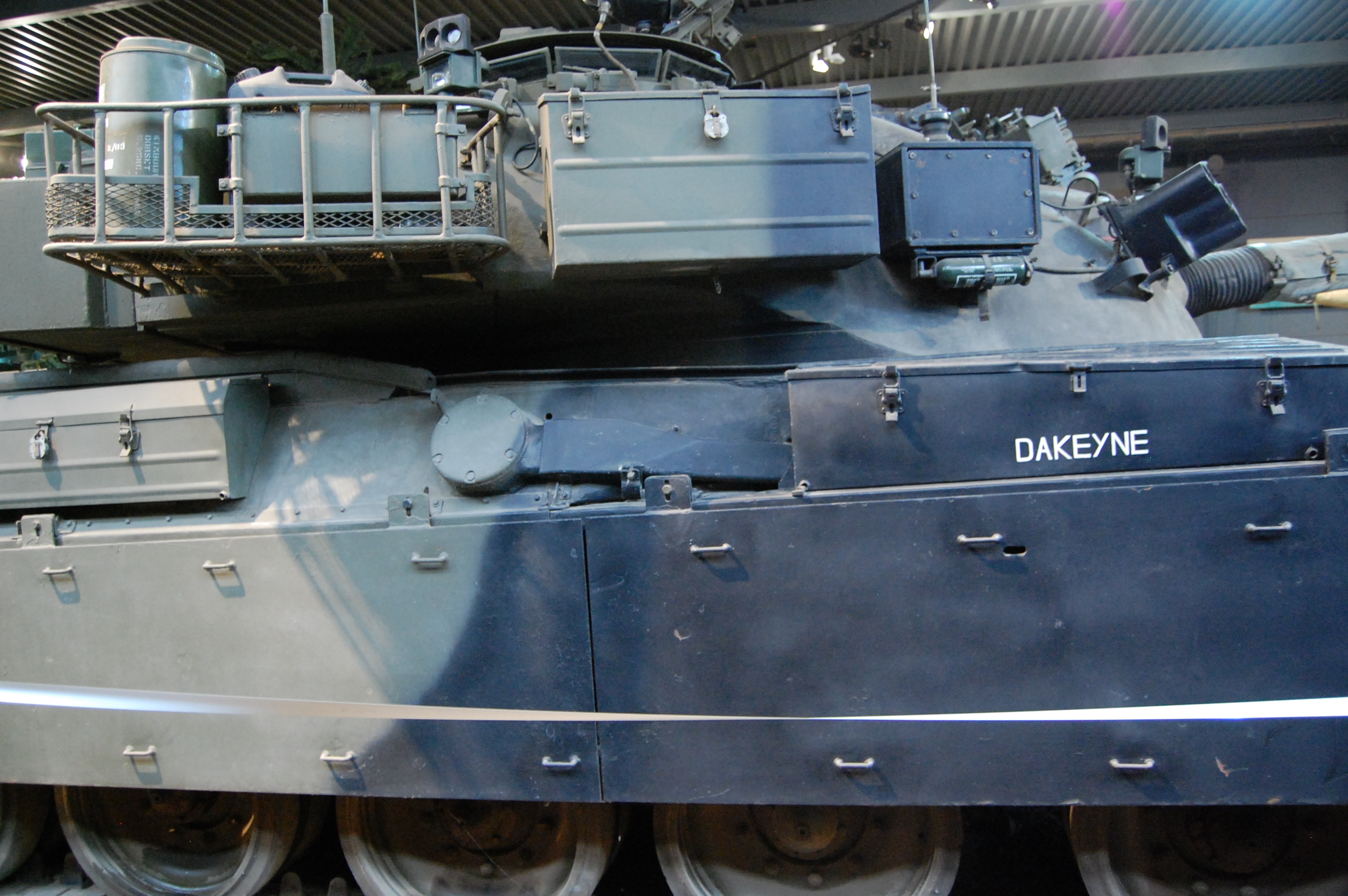

1.Chinese eye wrong location - should be:

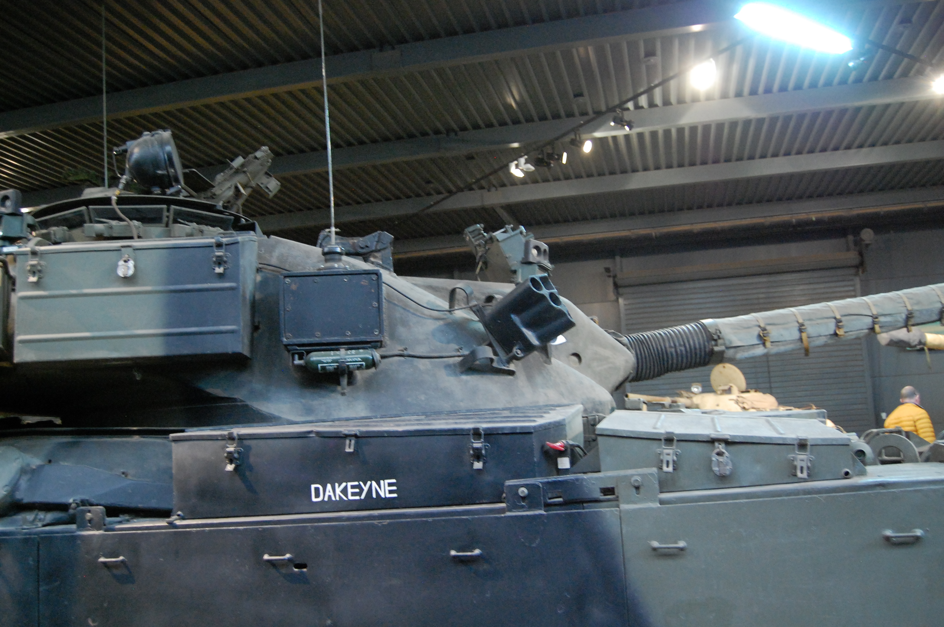

2. Tank name Dakeyne should be either be white on black rectangle or black on the green camouflage
3. Squadron tac sign and callsign missing from NBC pack, turret sides and convoy marking. See below
4. Convoy marking - should either be black and white vertical stripes or should have squadron tac sign and callsign.
5. Unit Identification Signs missing from mudguards

9. The thermal sleeve retaining straps are loose and sleeve is twisted
10. The cooker on the bazooka plate is a small Number 2 Burner. Tank crews were more usually issued with the bigger No 4 Burner. Some crews replaced them with Calor Gas civilian stoves but intense cold affected them and gas would not have been available in war, so the practice was discouraged. The No 4 burner was pressurised by a hand pump and could produce a spectacular firework display if badly handled or maintained. It was the duty of the last man on sentry stag before revielle to light the burner for the first brew of the day.
11. Random boxes on the turret. Not sure what these are doing there. The tank is fitted with the Solartron Simfire tactical engagement simulation system. It was utterly useless (we did the troop trials on it) and was rejected pretty quickly. The wiz-bangs and receivers are fitted but there should also be a whopping great laser projector unit mounted on the barrel. The boxes on the turret are probably the internal control and interface boxes which should be mounted in the turret in place of the ready-round projectile rack.
12. The long stalk fitted to the turret roof is the meteorological sensor for the Improved Fire Control System (IFCS was the first computerised system to increase gun accuracy). It provided temperature, pressure and wind data to the computers to calculate charge temperature and windage and make corrections. I believe it was only issued to one tank in a squadron and I don't think I ever saw it used or fitted.
13. No commanders machine gun.

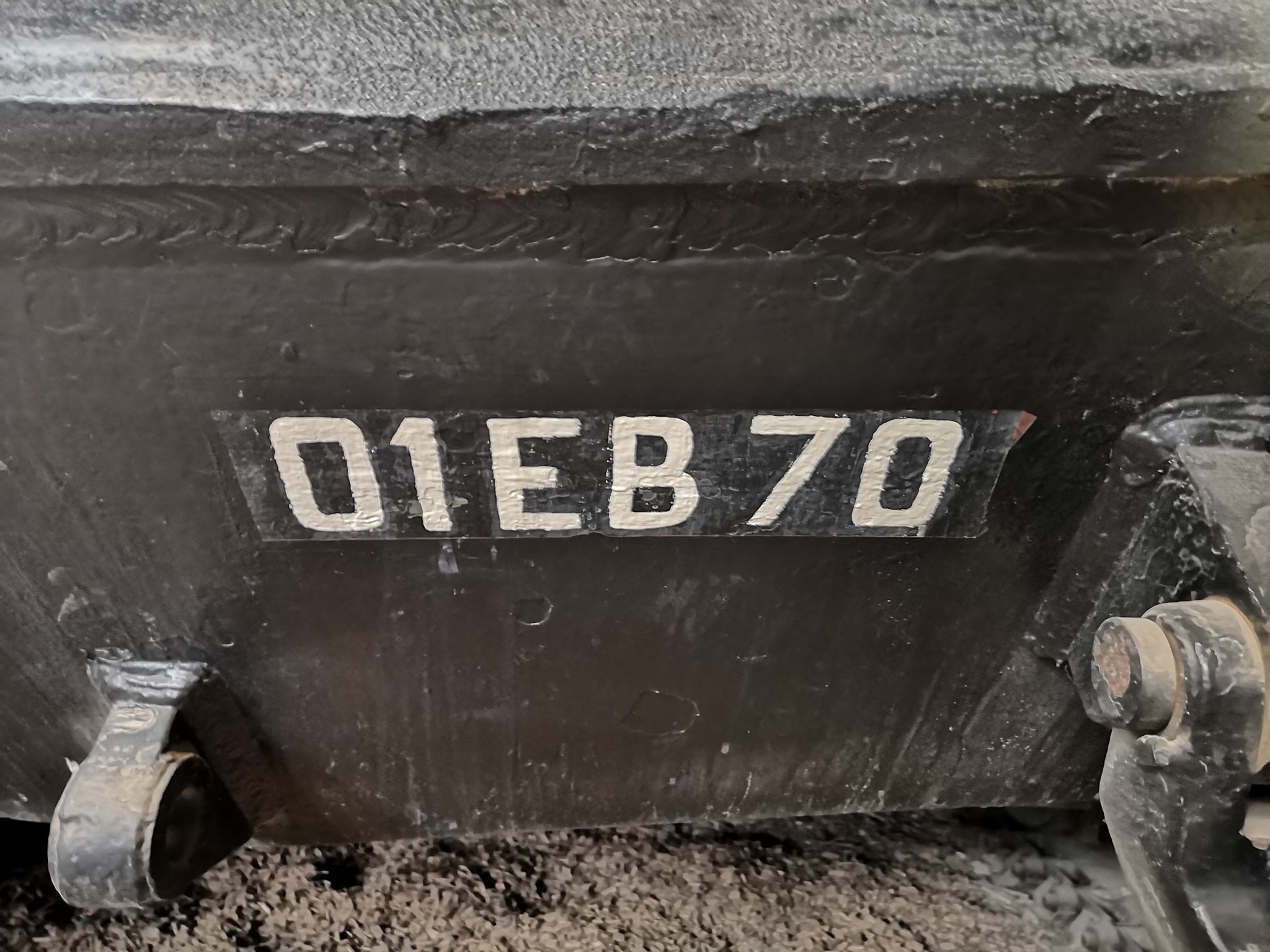

20. The ERM (Equipment Registration Mark or vehicle registration number) is in the wrong font.

Bridge classification sign should be on the hull toe plate and the ERM on the nose of the glacis:

The No 2 burner was the the correct cooker as issued but I'm certain we used the larger No 4.
