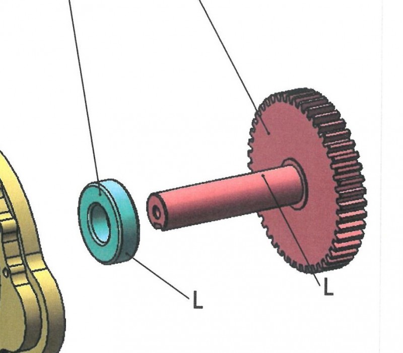

Has liked: 1491 times
Been liked: 1699 times
Re: Wear on hull.
On the Tiger 131 manual, it shows loctite on the outside of the bearings and on the shaft of the main drive gear:
