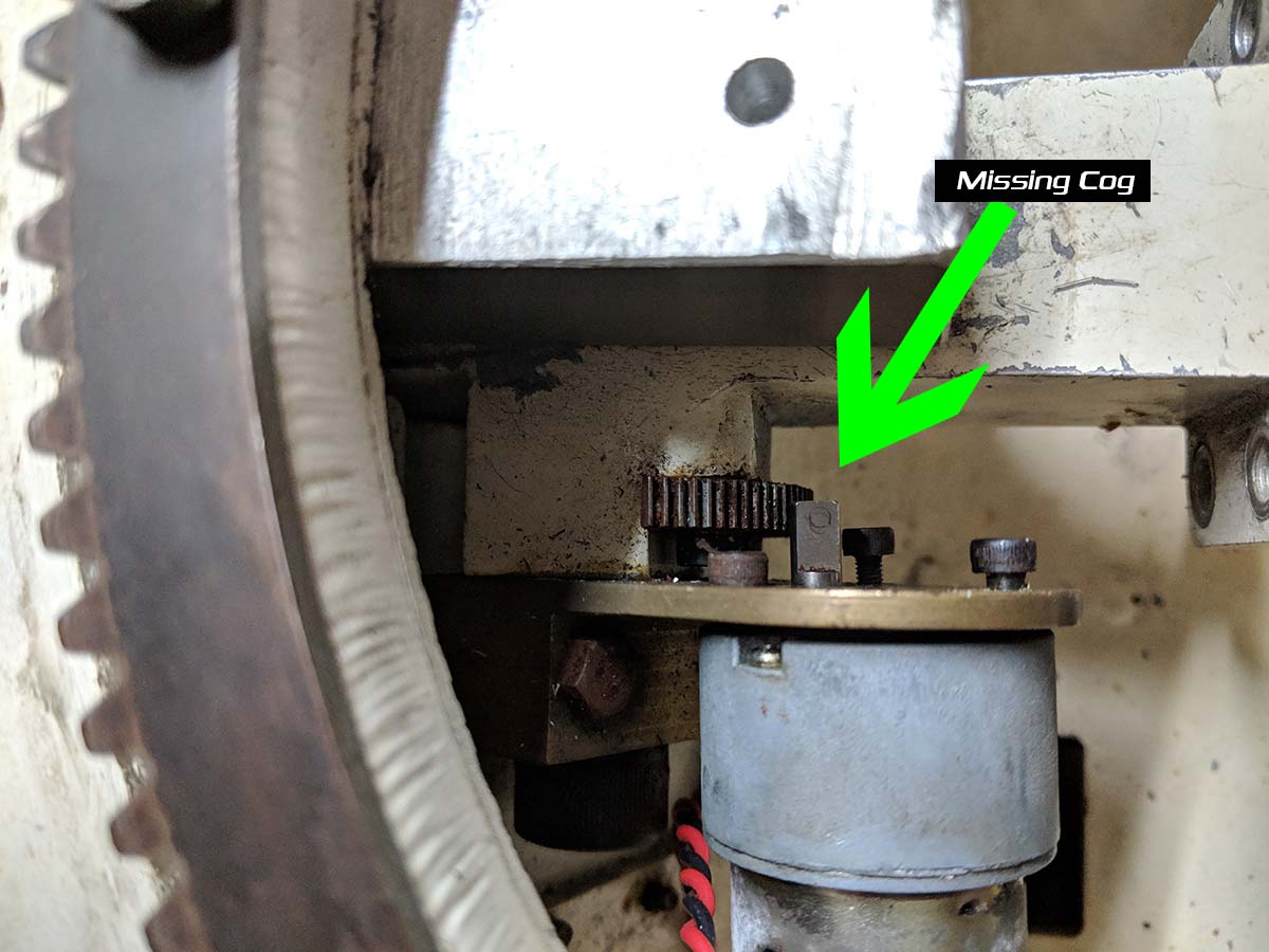

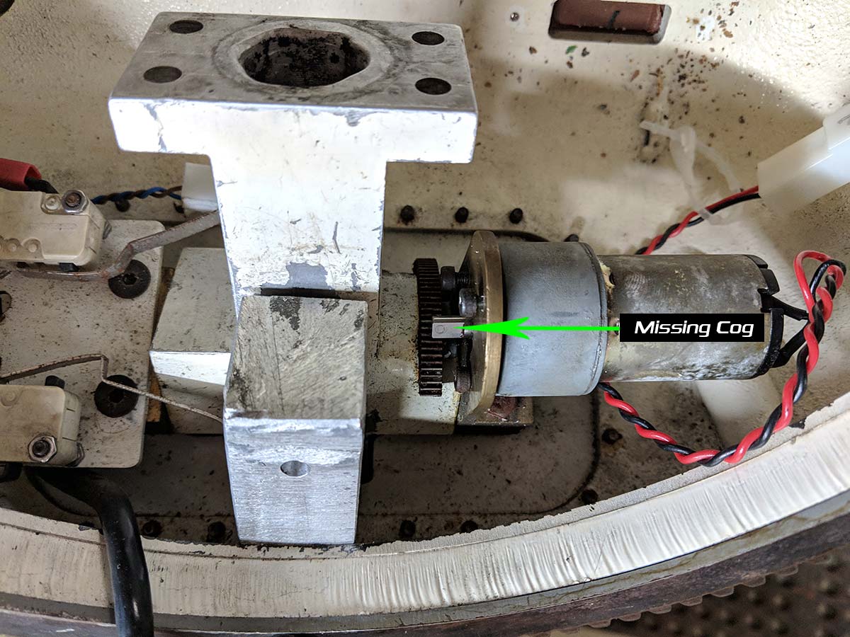

Getting my 1st Generation Sherman M4 back into full working order and need help on the following missing part.
In the turret there is a pinion gear that goes between the motor and the half ring gear teeth, for the elevation.
As per my photos you can see where it is situated.
I am after any info on this part:- size, dimension, any think that might help me find or make one if necessary would be greatly appreciated .

According to the Option Pack manual, it's a 24 tooth 0.5 MOD gear from HPC.
https://www.hpcgears.com/pdf_c33/23.10-23.13.pdf
Looks to me like you need part number G0.5-24, but I would get confirmation from Armortek before shipping one to Aus
