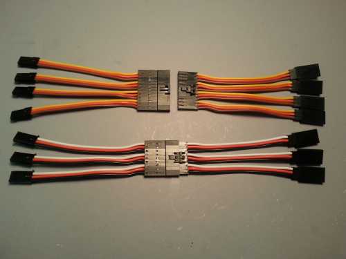

- Steen Vøler
- Posts: 771
- Location: Denmark
- Has liked: 62 times
- Been liked: 500 times
Re: Spectrum Transmitter.
I use these quick connectors for my setup
Its very fast to dismantle and no errors re-connecting the reciever and servo cables.
I use 2 x 4 as I have 8 channels in use and have color coded the connectors with white and yellow so that they can be identified easily
http://www.electrodynam.com/store/102.shtml
- 102_OneClik_MC_web.jpg (13.37 KiB) Viewed 4021 times
